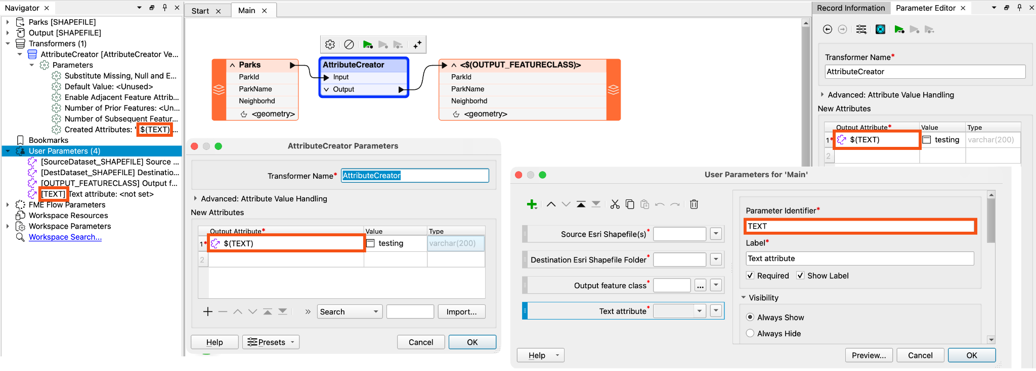

The relationship between the User Parameters node in the Navigator window, the canvas objects that reference the user parameters, and the User Parameters group in the runtime Parameter Prompt. The blue underline highlights one user parameter and where it may appear throughout the workspace.
When a workspace containing user parameters is run, the value specified for each user parameter in the Parameter Prompt is passed to the referencing object parameter during translation. In the screenshot above, the user has entered a value of BigIntTest for the published user parameter NEW_FEATURECLASS_NAME. This value will be subsequently passed to the file geodatabase reader feature type parameter referencing the published parameter. Once the workspace translation is complete, there will be a new feature class named BigIntTest in the written file geodatabase.
A workspace object parameter that references a user parameter will have a value of $(User Parameter ID) when viewed in the Navigator window, the Parameter Editor window, or the workspace object’s Parameters dialog. This User Parameter ID value is specified while creating a new user parameter, as demonstrated in Exercise 1 below.

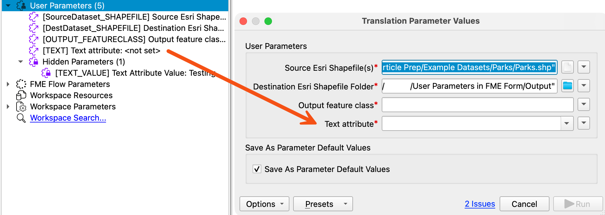

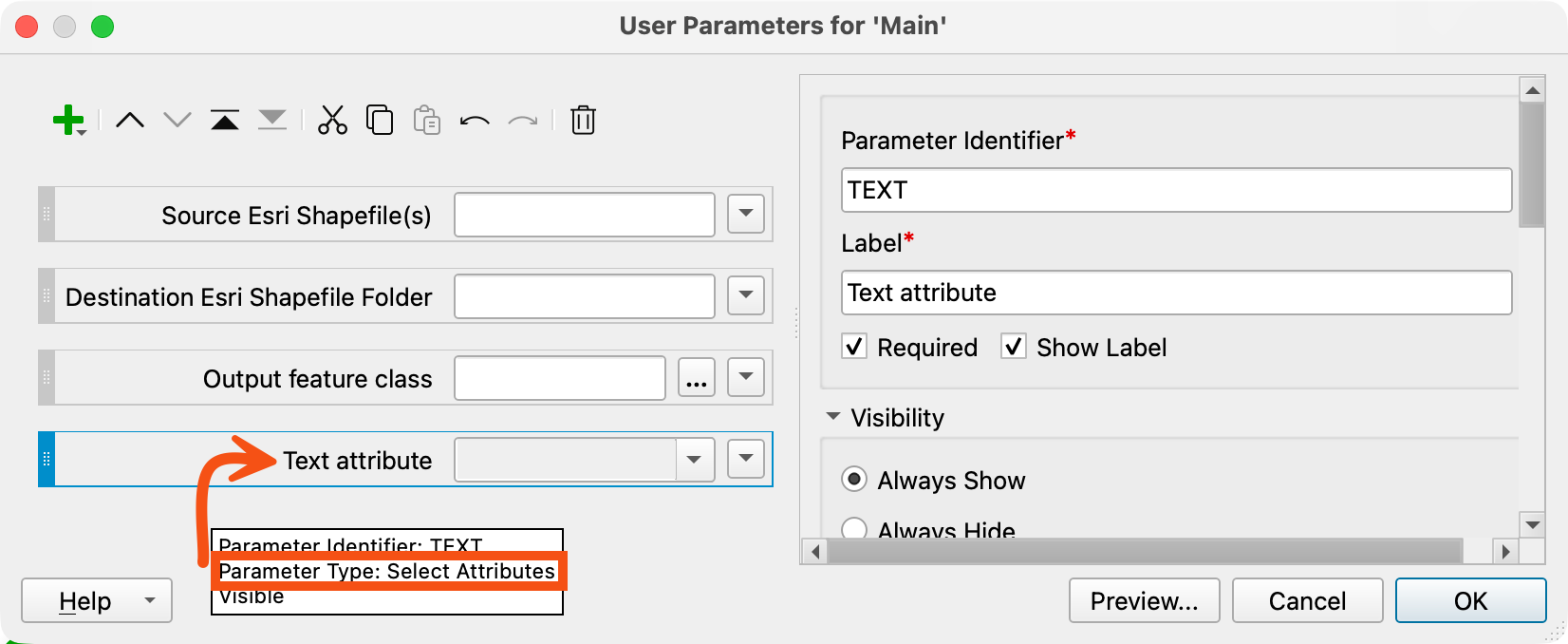

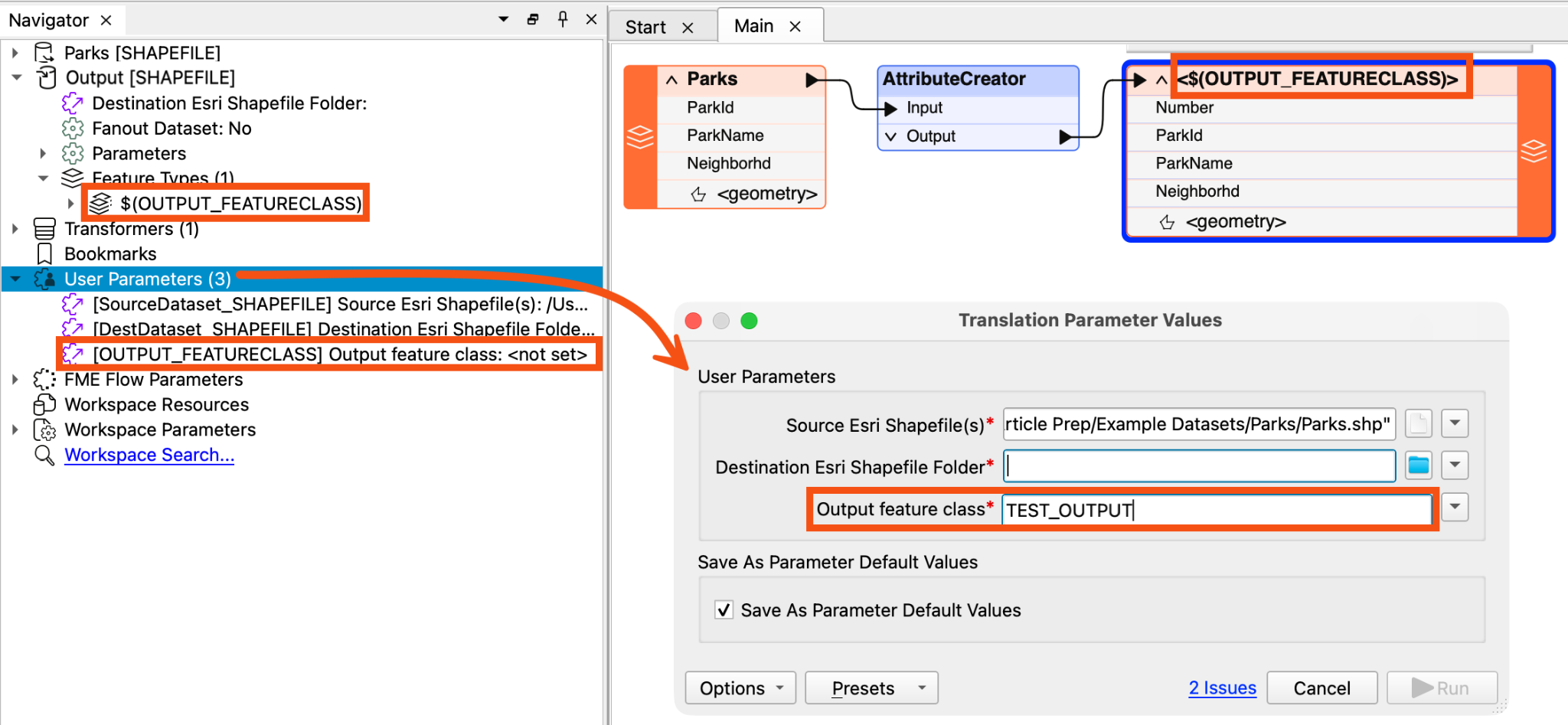

Many types of user parameters are available in FME. This variety is necessary, as each individual workspace object parameter expects to receive a specific type of value, but types will vary between object parameters. For example, the Output Attribute parameter of the AttributeCreator, in the screenshot above, expects to receive an Attribute Name-type parameter. The Value parameter of the AttributeCreator, on the other hand, expects to receive a Text-type parameter. Providing any type other than the expected type for either of these AttributeCreator parameters may result in errors during translation, as the AttributeCreator may not “know” how to handle another parameter type for these parameter values. More details on FME user parameter types are available in the Parameter Types section of this FME documentation
The OUTPUTATTR_NAME user parameter is viewed in the Parameter Manager dialog. It must be of type Attribute Name to function correctly with the Output Attribute parameter of the AttributeCreator, as this is the type expected by the target object parameter

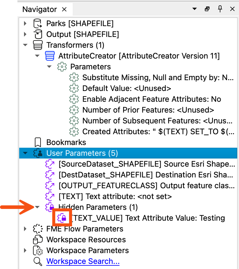

A single private parameter in the User Parameters node of the Navigator window. Note the padlock on the private parameter’s icon, indicating that its value is locked for editing at runtime

Published user parameters will also appear in the User Parameters node of the Navigator window, denoted by the half gear icon with an arrow in lieu of a padlock. These parameters are “published to”, or displayed in, the runtime Parameter Prompt when the workspace is run with Prompt for Parameters enabled.
The OUTPUTATTR_NAME published user parameter as it appears in the runtime Parameter Prompt dialog. The published parameter’s Prompt value is displayed instead of its ID value in the Parameter Prompt dialog. Note the absence of the REPLACE_TEXT private user parameter from the Parameter Prompt dialog
Users can conveniently input a value for each published parameter right from the runtime Parameter Prompt. These user-provided values will then be passed to the workspace objects, which reference each published parameter. In this way, users can control and adjust the parameter values of workspace objects at runtime rather than remaining fixed by the workspace author. This runtime flexibility moves some translation control to the workspace user without authors needing to grant workspace editing privileges to users. Published parameters and their applications will be the focus of the remainder of this article.

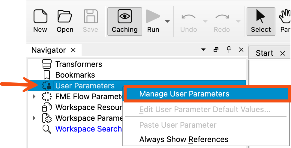

Authors can access the Parameter Manager by:

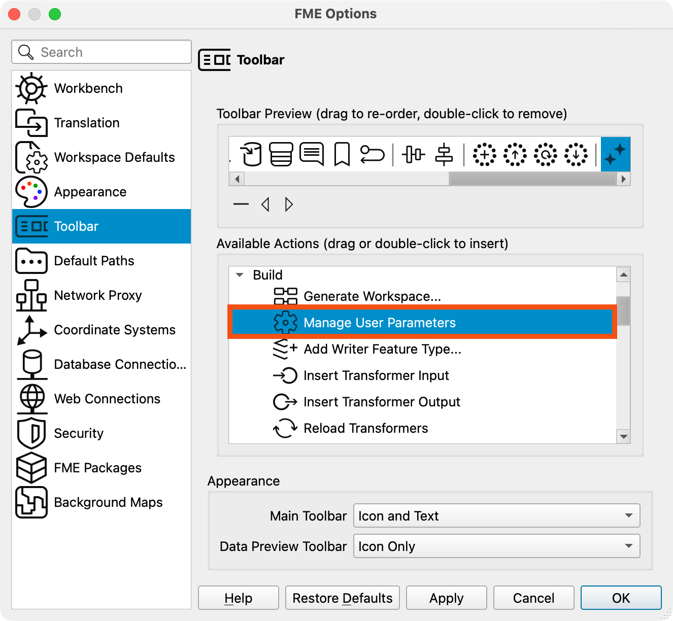

  • Right-clicking on the User Parameters node of the Navigator window and selecting Manage User Parameters; or
  • Adding the Manage User Parameters quick access icon to the main Workbench toolbar, and then clicking on it. This icon can be added to the main Workbench toolbar by navigating to Tools → FME Options → Toolbar, then expanding Tools in the Available Actions options. Double-click on the Manage User Parameters icon therein, and then select Apply to add the icon to the main Workbench toolbar.
Access the Parameter Manager from the Navigator window

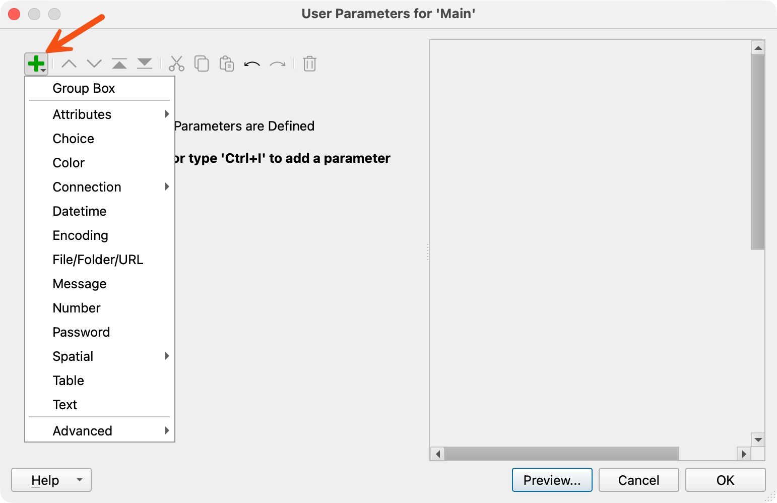

A group of buttons for managing the listed user parameters is at the top of the left-side pane. Authors can create a new published parameter in the Parameter Manager by selecting the green plus icon, and then choosing the type of published parameter needed from the drop-down list.
Selecting a parameter type from this list will add a parameter entry to the left-side pane, whose default definition will appear in the right-side window for editing.

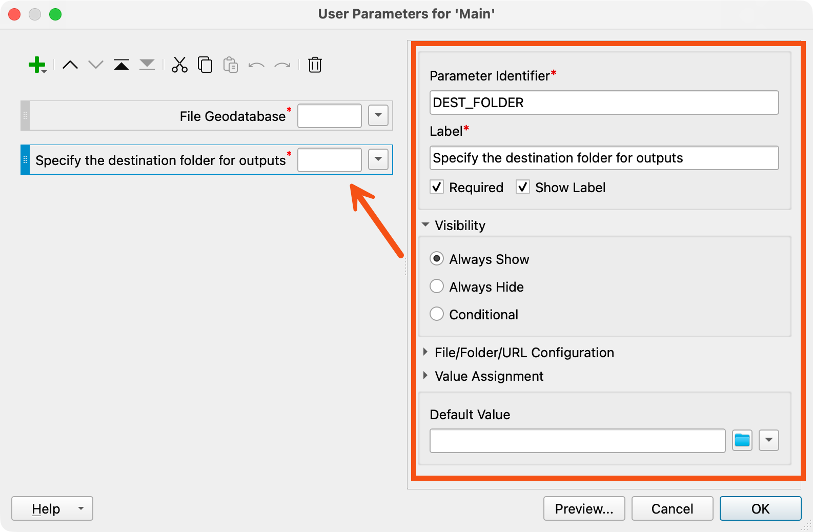

Choose the File/Folder/URL parameter type. A new user parameter will appear in the left-side pane of the Parameter Manager, and its default definition will populate in the right-side pane.
With this new parameter highlighted in the left-side pane, configure the parameter definition in the right-side pane as follows:
  • Parameter Identifier:  DEST_FOLDER
  • Prompt (enabled):  Specify the destination folder for outputs:
  • Published - enabled
  • Required - enabled; with this enabled, the parameter will have a red asterisk attached to it in the left-side list of the Parameter Manager
  • Disable Attribute Assignment - disabled
  • Items to Select: Folders
  • Access Mode: Write
  • Default Value: <leave this blank>
Complete definition of the new File/Folder type published user parameter

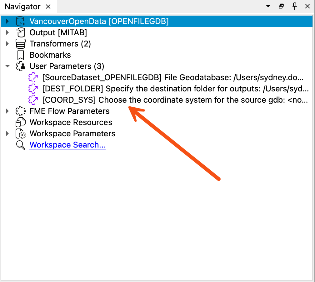

Next, have a look at the User Parameters node of the Navigator window. There should now be a third user parameter listed, DestDataset_CSV2. This new published user parameter is linked to the Dataset parameter of the newly added CSV writer. This behavior is expected; adding a new reader or writer to a workspace will always result in the creation of a published user parameter linked to the format’s Dataset (or similar) parameter.

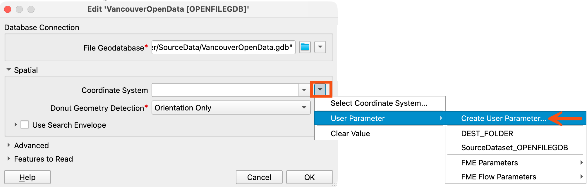

Workspace authors can readily create published parameters from the Edit or Parameters dialog of any workspace object added to the canvas. Most of the parameters in these dialogs have a drop-down arrow to their right. Selecting this drop-down arrow provides access to a variety of options for setting an object parameter’s value.
One of these options is User Parameter. Selecting User Parameter from this drop-down menu will display a secondary set of options, where authors can choose Create User Parameter. Selecting Create User Parameter in this secondary menu will open the Add/Edit User Parameter dialog.

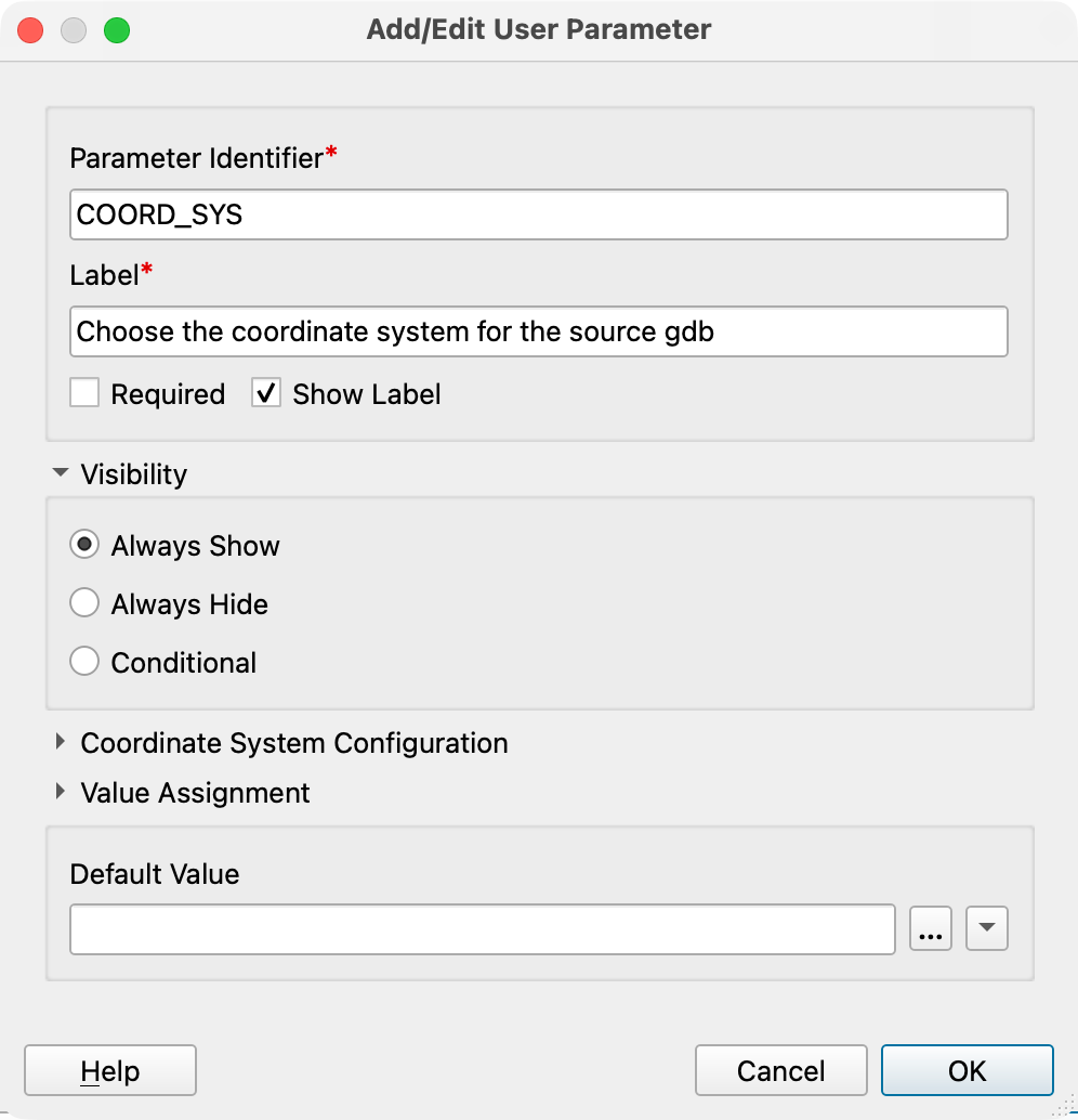

Here, users can define a new user parameter whose type will, by default, match the type expected by the target workspace parameter. User parameters created in this way are published parameters unless the author deselects the Published checkbox. Once a user defines the new parameter and selects OK on both the Add/Edit User Parameter dialog and on the subsequent dialog, a new published parameter will appear in the User Parameters node of the Navigator window.
In the example above, a new published parameter was created from the Shapefile reader’s Edit dialog by selecting the drop-down menu to the right of the reader’s Coordinate System parameter. This new published parameter is by default a Coordinate System type parameter, matching the parameter type that the target Coordinate System parameter of the Shapefile reader expects.

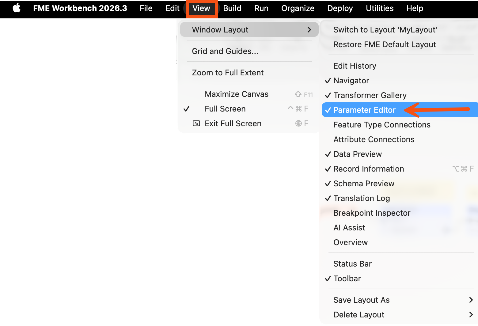

With the Parameter Editor window visible (docked or undocked), authors can select any object on the canvas, and the selected object’s parameters will be available for editing in the Parameter Editor window.

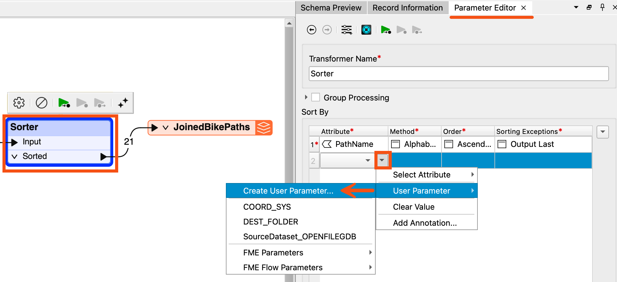

3. Select the CSV Writer Feature Type on the Canvas
Select the CSV writer feature type on the canvas, called JoinedBikePaths, with a single click. Now, have a look at the Parameter Editor window; the parameters associated with the selected CSV writer feature type are now visible and editable therein.
The task is to give users the ability to specify a file name for each written product at runtime. To accomplish this task, a published parameter should be applied to the file name parameter of each writer feature type. For the CSV writer feature type, the published parameter will be applied to the CSV File Name parameter.
4. Create a Published Parameter from the Parameter Editor Window

3. Create a Yes/No Published Parameter from the Parameter Manager
Create a Yes/No published parameter from the Parameter Manager by first right-clicking on the User Parameters node in the Navigator window. Select Manage User Parameters from the options presented. The Parameter Manager dialog will open.
Select the green plus at the top left of the User Parameter editor to view the list of user parameter types available. Choose the Yes/No user parameter type.
Once the Yes/No user parameter type is selected from the drop-down list, a new Yes/No user parameter will appear in the left-side pane of the Parameter Manager. Highlight this new parameter to access its definition in the right-side pane.
