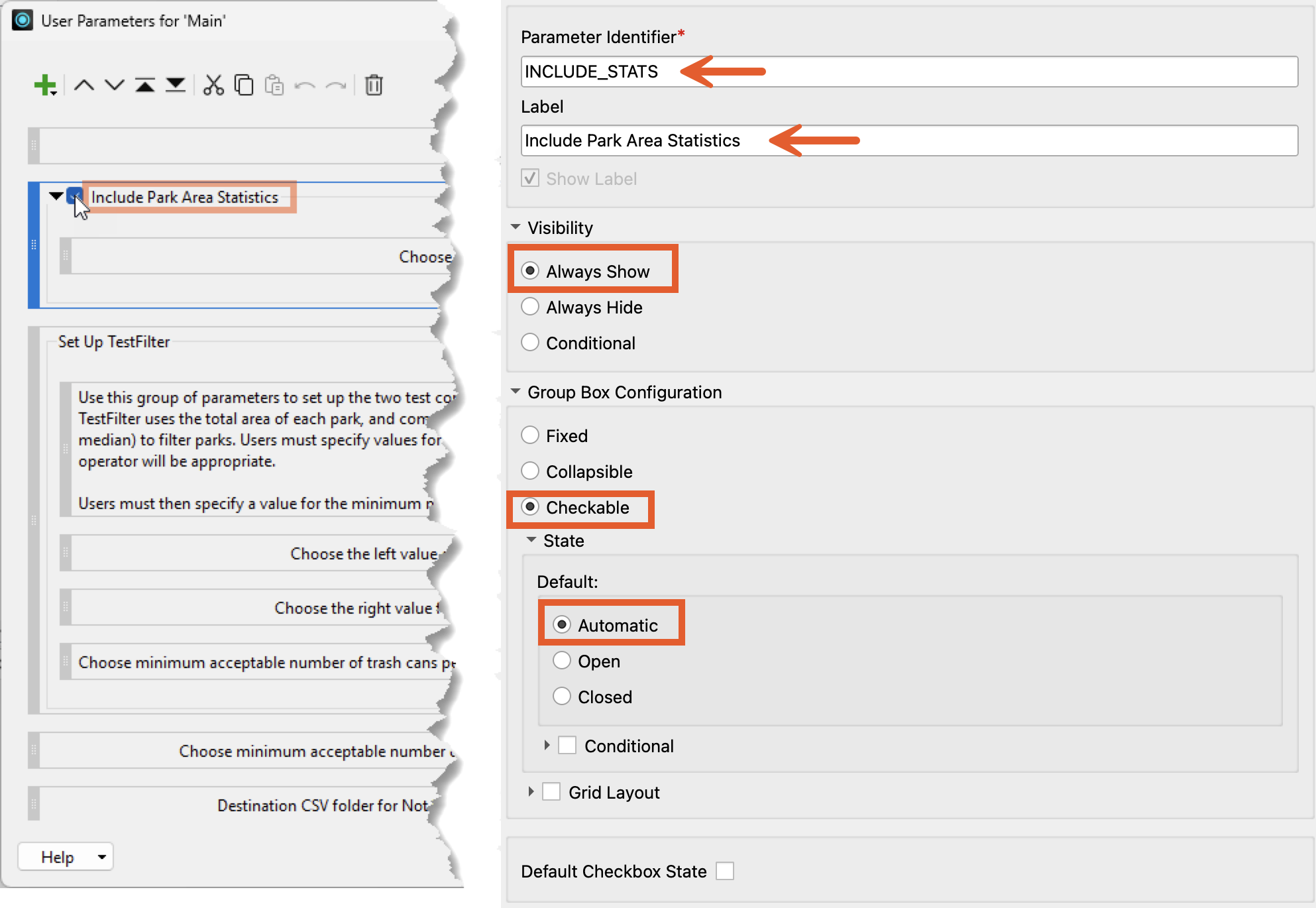

First, select the Include Park Area Statistics group box to view its definition to the right, and notice the following set parameters:
  • Include Park Area Statistics: Enabled
  • Parameter Identifier: INCLUDE_STATS
  • Label: Include Park Area Statistics
  • Visibility: Always Show
  • Group Box Configuration: Checkable
  • State:
    • Default: Automatic
This group box is configured as a checkable user parameter, with its default state set to unchecked. It is used in the first Tester transformer to direct the flow of features based on whether the user wishes to consider area statistics in the downstream calculation.
  • Left Value: $(INCLUDE_STATS)
  • Operator: =
  • Right Value: YES

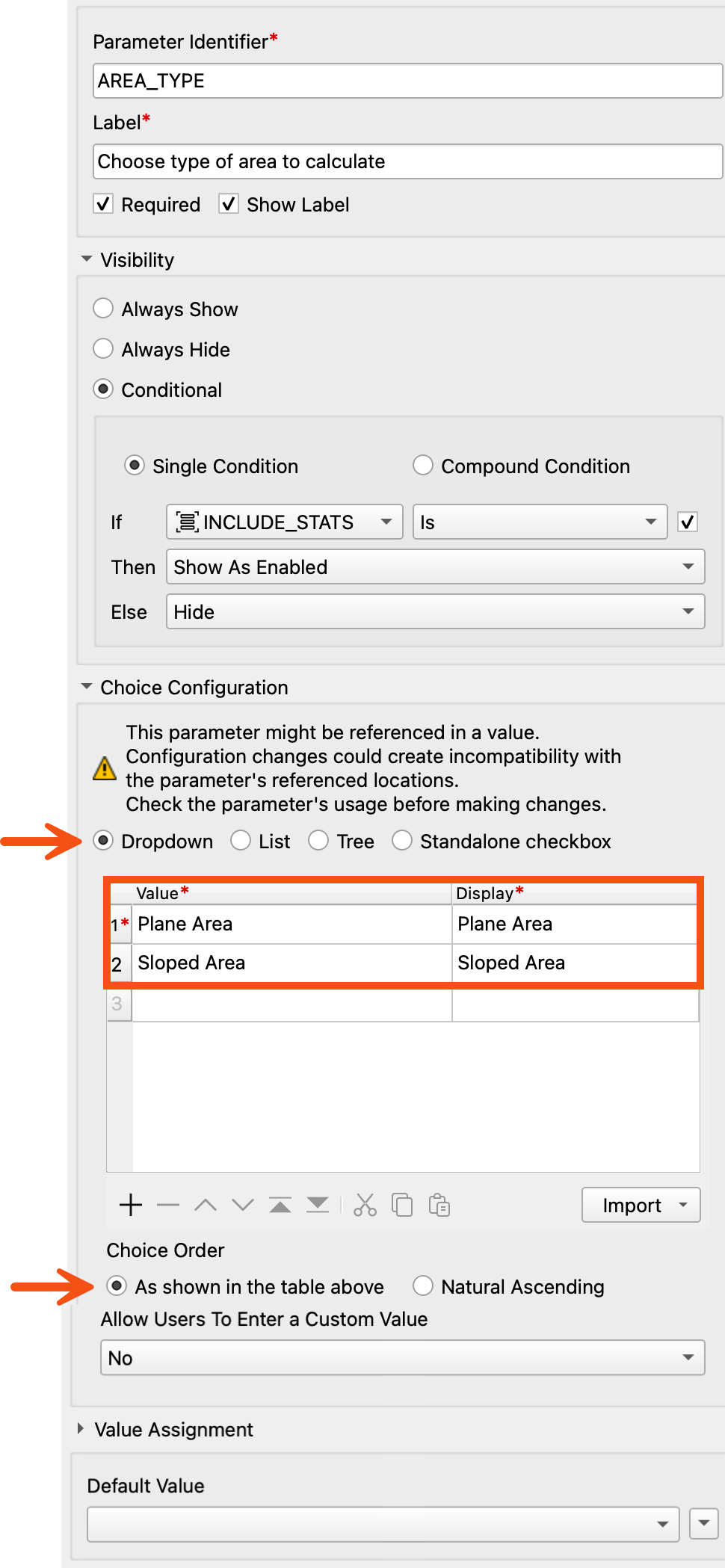

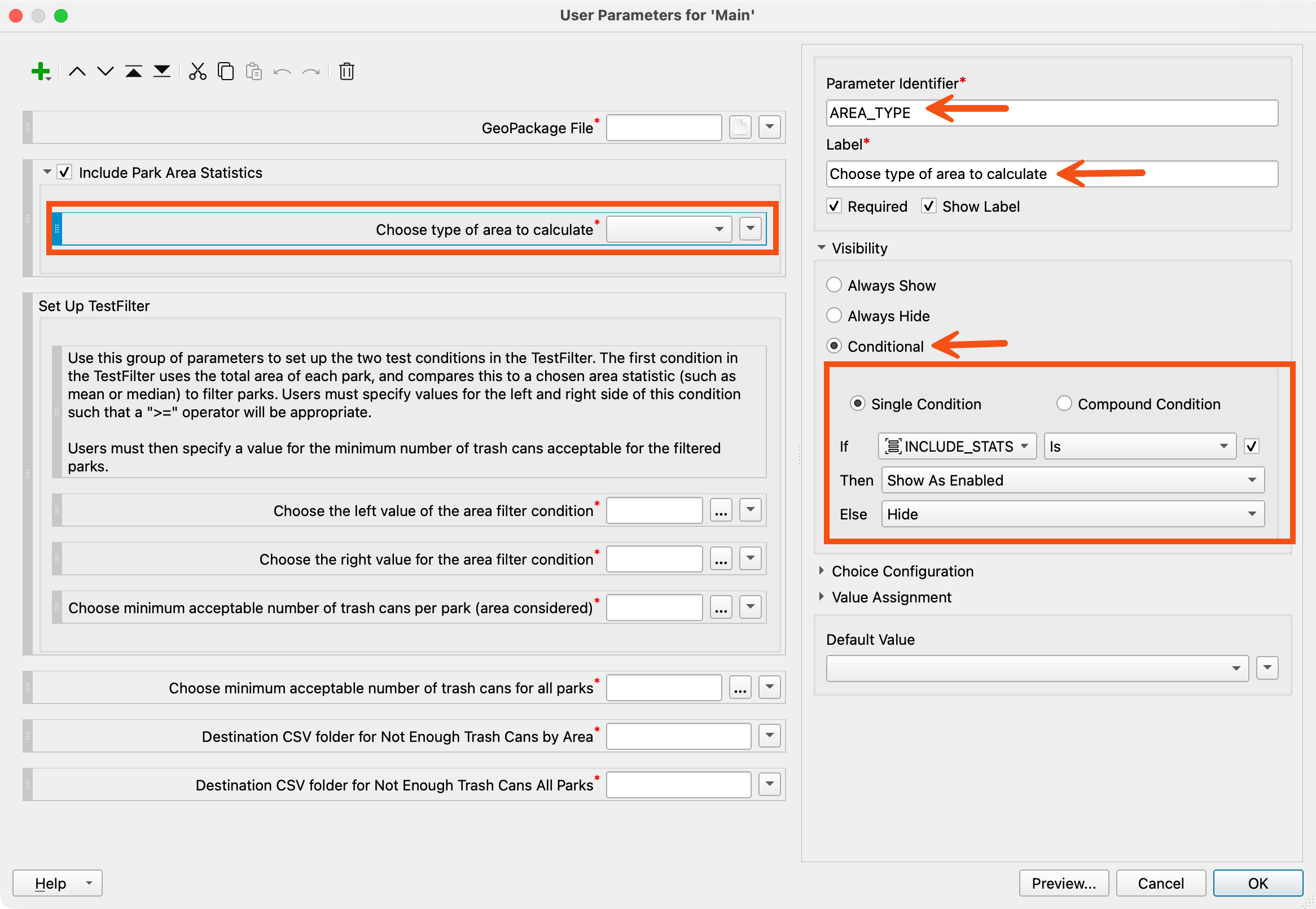

Now, select the user parameter, 'Choose type of area to calculate', within this group box, and view its definition on the right.
The following parameters have been set:
  • Parameter Identifier: AREA_TYPE
  • Label: Choose type of area to calculate
  • Visibility: Conditional
    • Single Condition: Enabled
    • If: INCLUDE_STATS Is <Enabled>
    • Then: Show as Enabled
    • Else: Hide
The Conditional Visibility option is enabled for the Choose type of area (AREA_TYPE) user parameter. A Single Condition is used to control when this parameter appears in the runtime prompt. Specifically, AREA_TYPE is shown only when the INCLUDE_STATS parameter (Include Park Area Statistics) is enabled. If this condition is not met, the parameter remains hidden. Since no default value is set, users must choose an option (Plane Area or Sloped Area) when it becomes visible at runtime. This setup is useful because the AREA_TYPE parameter is only relevant when area statistics are included.
  • Choice Configuration:
    • Dropdown: Enabled
    • Choice 1:
      • Value: Plane Area
      • Display: Plane Area
    • Choice 2
      • Value: Sloped Area
      • Display: Sloped Area
    • Choice Order: As shown in the table above

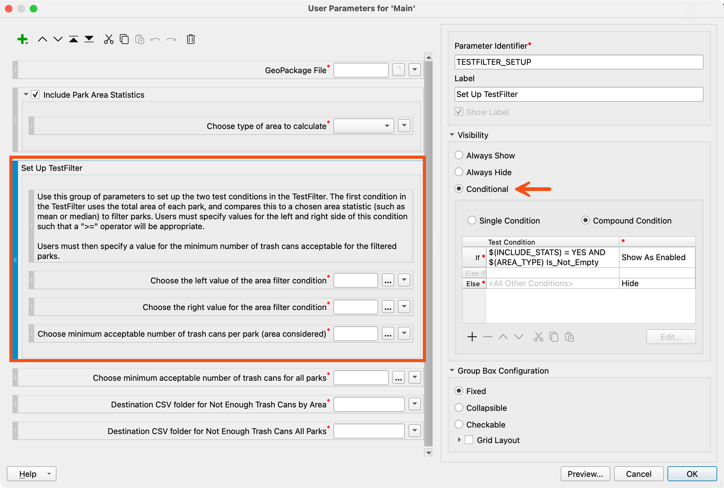

3. Set Up TestFilter Group Box Compound Conditional Visibility
This section requires FME Workbench 2025+. Select the Set Up TestFilter group box to view the TESTFILTER_SETUP parameter definition. Skip to Step 4, for version prior to 2025.

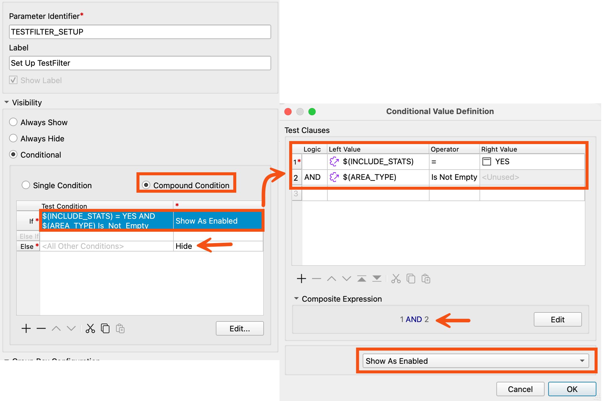

This group box also has Conditional Visibility enabled, but it uses a Compound Condition. Introduced in FME 2025.0, compound conditions allow for more advanced logic, combining multiple criteria using Boolean operators like AND, OR, and NOT, instead of a simple If-Then-Else statement. This type of configuration gives even more control to workspace authors, meanwhile, the Composite Expression section lets you build and manage these complex conditions more efficiently. Authors more comfortable with Boolean expressions may find composite expressions faster and more flexible for controlling visibility.
  • Compound Condition: Enabled
  • If/Test Condition:
    • Clause 1:
      • Operator: =
      • Right Value: YES
    • Clause 2:
      • Logic: AND
      • Left Value: $(AREA_TYPE)
      • Operator: Is Not Empty
    • Composite Expression: 1 AND 2
    • Show As Enabled: Enabled
  • Else: Hide
In this example, TESTFILTER_SETUP will be hidden unless users enable the INCLUDE_STATS parameter and AREA_TYPE is not empty at runtime. The parameters within this group box are exclusively applied to the TestFilter in the workspace, which is only run when users choose to include Area Statistics in the workflow. So it makes sense to hide this group box in the runtime prompt until it’s needed.

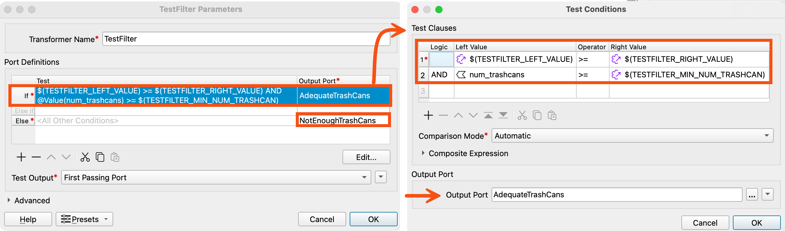

  • If/Test Filter:
    • Clause 1:
      • Left Value: $(TESTFILTER_LEFT_VALUE)
      • Operator: >=
      • Right Value: $(TESTFILTER_RIGHT_VALUE)
    • Clause 2:
      • Logic: AND
      • Left Value: num_trashcans
      • Operator: >=
      • Right Value: $(TESTFILTER_MIN_NUM_TRASHCAN)
    • Output Port: AdequateTrashCans
  • Else: NotEnoughTrashCans
To view how the Set Up TestFilter group box will look in the runtime prompt, click the Preview button at the bottom right of the Manage User Parameters dialog.
The Parameter Preview dialog opens, showing a preview of how the runtime Translation Parameter Values prompt will look when the workspace is run. By default, the Include Area Statistics parameter is disabled. As expected, the dependent Set Up TestFilter group is hidden.
Now select the checkbox to the left of the INCLUDE_STATS parameter in the Parameter Preview dialog and choose the type of area to calculate.
The Set Up TestFilter group box, as well as the parameters it contains, are now visible and enabled in the Parameter Preview dialog.

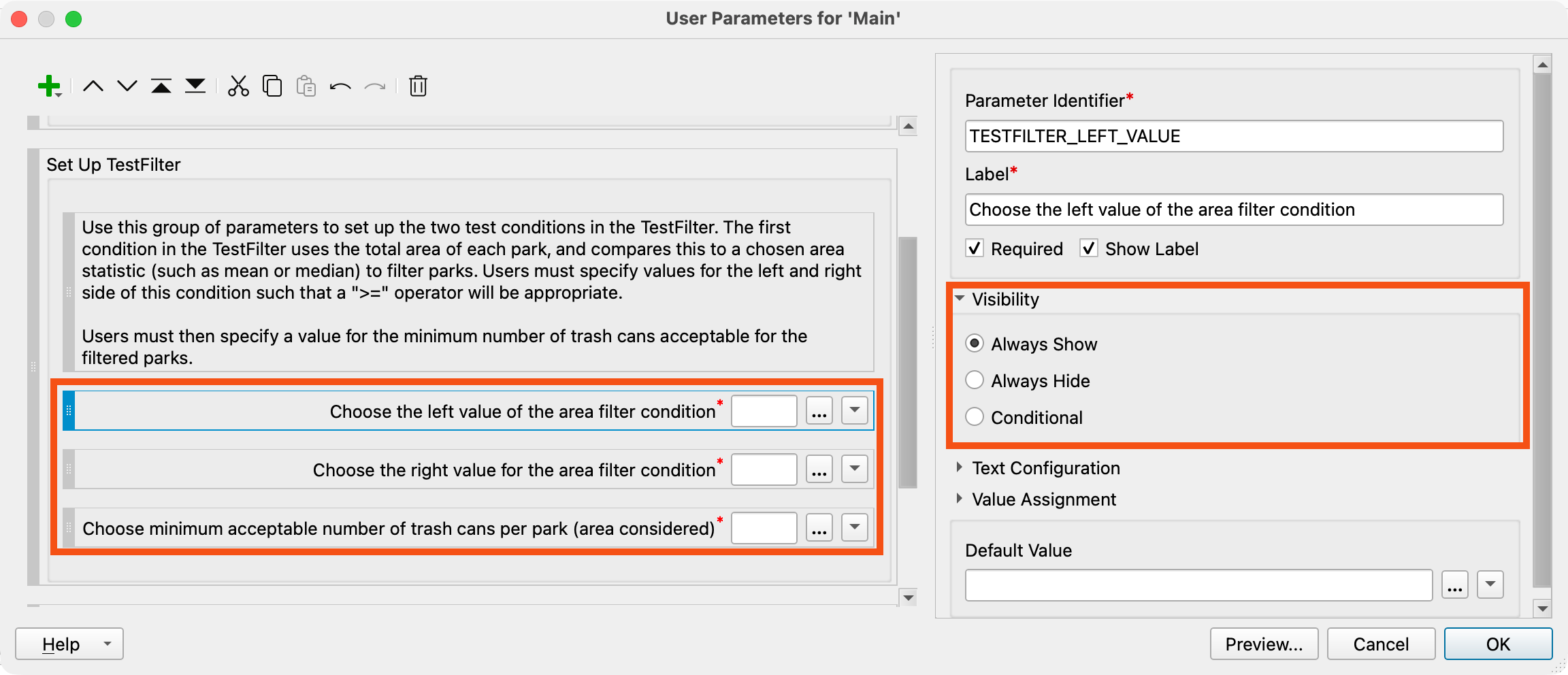

4. Parameters within the Set Up TestFilter Group Box
The conditions on the group box visibility affect the parameters inside. Select each parameter within the Set Up TestFilter group box, one at a time, ignoring the top Message parameter.
Each of these parameters has Visibility set to Always Show. Since these parameters reside within a group box with Visibility set to Conditional, they will behave according to the condition set for the containing group box. They will be hidden along with the group box until the Include Park Area Statistics parameter is enabled at runtime.
If one of the parameters within the Set Up TestFilter group box requires more restrictive visibility, then the Conditional Visibility option could be used on that specific parameter to further control its visibility at runtime. This is an alternative way to implement more complex visibility conditions for one parameter outside of the Compound Condition.

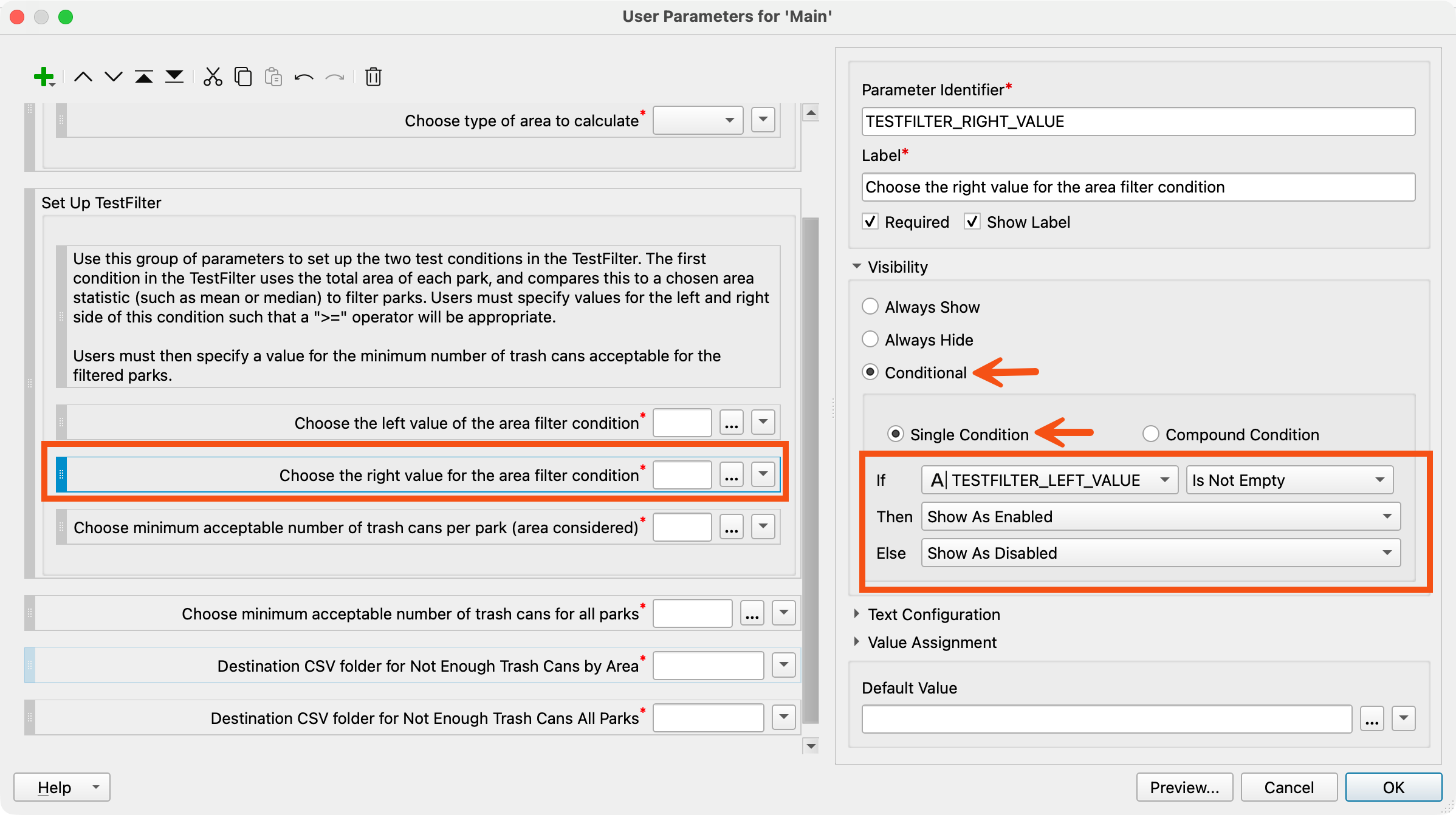

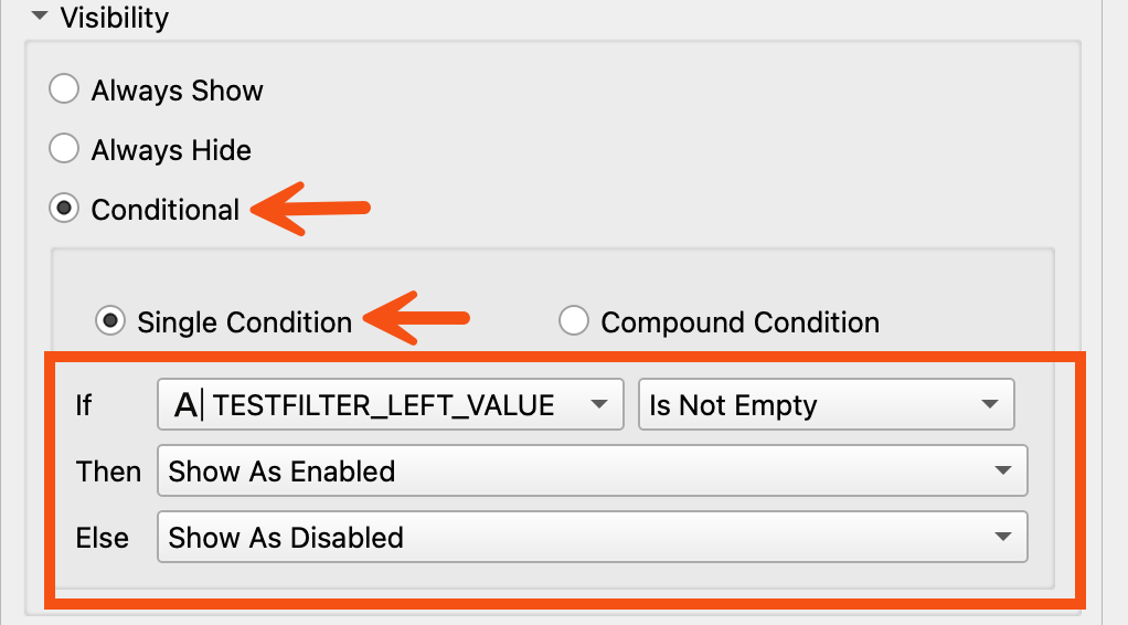

To view this additional visibility constraint in action, select the TESTFILTER_RIGHT_VALUE parameter from the Set Up TestFilter group box. Enable Conditional Visibility for this parameter, then set the Conditional Visibility clause.
    • If: TESTFILTER_LEFT_VALUE Is Not Empty
    • Then: Show As Enabled
    • Else: Show As Disabled
Click the Preview button at the bottom right of Manage User Parameters, enable Include Park Area Statistics, and choose an area type. The right value parameter within the Set Up TestFilter parameter group is grayed out, even though the visibility condition for this parameter group has been met.
The visibility condition set on this TESTFILTER_RIGHT_VALUE parameter must now be met to enable it at runtime.
Type “sometext” into the left value parameter input field.
Now the right value parameter is enabled and ready to accept user input.

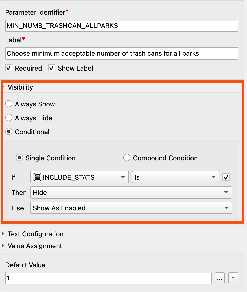

Select the Choose minimum acceptable number of trash cans for all parks parameter, just below the Set Up TestFilter group box, to view its definition on the right. This parameter allows the workspace user to specify the minimum acceptable number of trash cans for all parks in Surrey, regardless of park area.
Note how this parameter has Visibility set to Always Show, and will therefore always appear active in the runtime parameter prompt. Test this out by clicking on the Preview button in Manage User Parameters. Now alternately enable and disable the INCLUDE_STATS and AREA_TYPE parameters while watching the Choose minimum acceptable number of trash cans for all parks parameter. Notice that it is visible and enabled regardless of the park statistics parameter.
With Include Park Area Statistics disabled
With Include Park Area Statistics enabled
This is not desirable behavior, as this parameter is not relevant at all times during translation. It is only needed when the user leaves the Include Park Area Statistics parameter disabled at runtime. To prevent workspace users from inputting values into this parameter unnecessarily, it should be hidden until required.
To adjust this parameter’s visibility, close the Parameter Preview dialog and return to Manager User Parameters.
Select the Choose minimum acceptable number of trash cans for all parks parameter, and set Visibility to Conditional then fill the single condition:
    • Then: Hide
    • Else: Show As Enabled
Complete the visibility If-Then-Else statement as follows:
If INCLUDE_STATS  is <enabled>
Then Hide
Else Show as Enabled
Now, select the Preview button to return to the Parameter Preview dialog once more. Test out the adjusted visibility of this parameter by enabling and disabling Include Park Area Statistics.
The Choose minimum acceptable number of trash cans for all parks parameter is now hidden when Include Park Area Statistics is enabled.

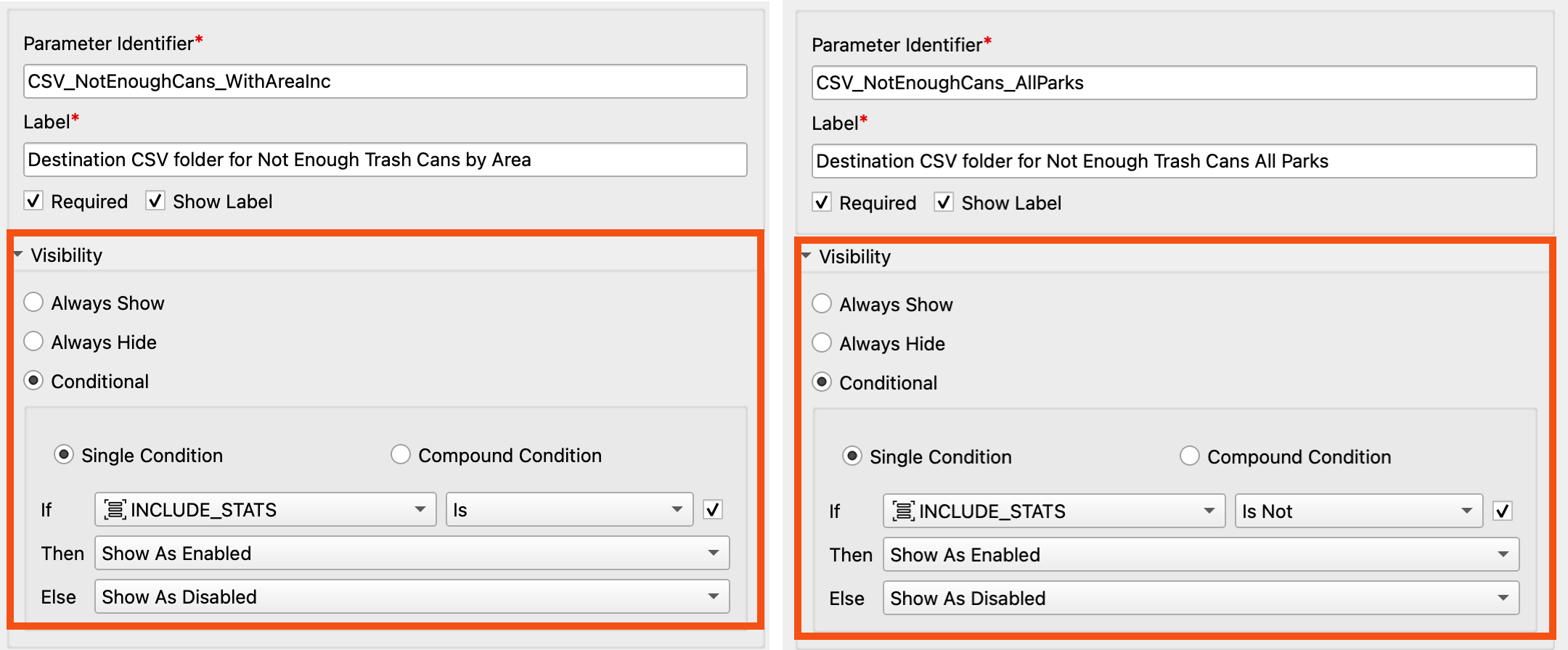

6. Visibility of CSV Destination Folder Parameters
Select each Destination CSV folder parameter to view its definition. Each of these two parameters has Visibility set the Conditional, but with slightly differing If-Then-Else statements.
The first Destination CSV folder parameter will only be enabled if INCLUDE_STATS parameter is enabled. This makes sense, as this parameter is only applied to the CSV writer capturing the area-filtered calculation.
The second Destination CSV folder parameter is only applied to the CSV writer that captures all parks, regardless of park area. Accordingly, this parameter will only be enabled if INCLUDE_STATS parameter is disabled. Both of these parameters will show as disabled (grayed out) when their visibility condition is not met.
