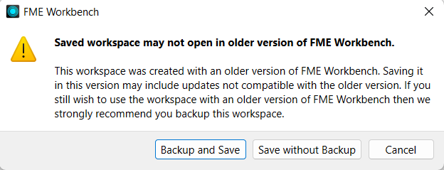

For this reason (and others), when you open, edit, and save an older workspace in a newer FME Workbench version, you may be given an opportunity to save a backup copy in the older version

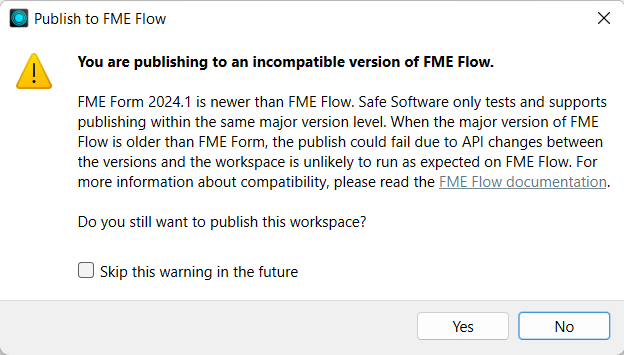

Backward compatibility does not apply to publishing from FME Form to FME Flow. This refers to product compatibility, and the same major versions of FME Form and FME Flow should be used when publishing.

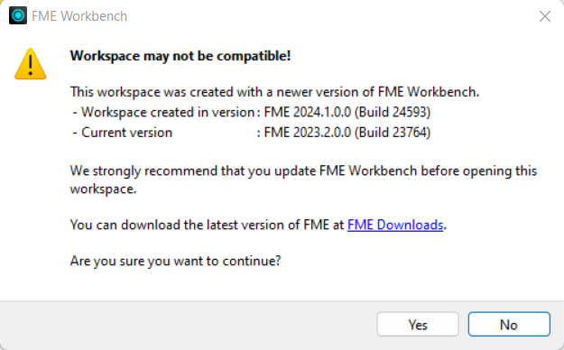

Generally, FME Form and FME Flow are not forward compatible. Therefore, a workspace created in FME 2024 is unlikely to work in FME 2022. This is important to take into account when you are creating workspaces for a client, for example, to use on their own FME installation.
If FME Form is upgraded to the latest version but FME Flow has not been upgraded, newly created workspaces may not run successfully when published to FME Flow on an older version. FME will warn you if you try to open a newer workspace in an older FME version or attempt to publish to an older version of FME Flow.

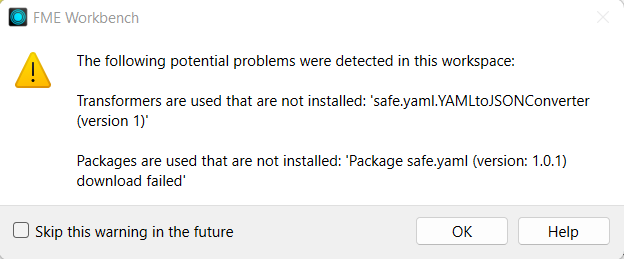

Using a newly released transformer immediately renders a workspace incompatible with previous versions. For example, a 2023.1 workspace with the YAMLtoJSONConverter transformer will definitely not work in 2022.2 because that transformer did not exist. You can most likely still open the workspace, but the transformer will be missing.

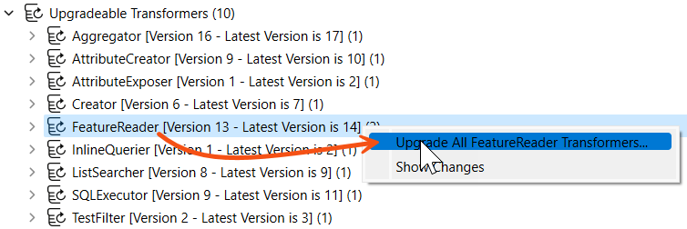

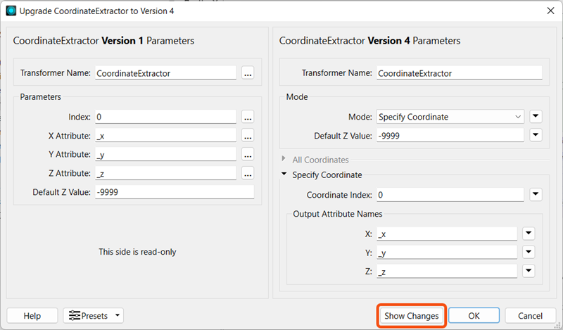

When opening an older workspace in a newer version of FME, any transformers that have been updated will appear in the Navigator pane under Upgradable Transformers. It shows the transformers that have upgrades available, [the version differences], and (how many transformers of that type exist in the workspace).

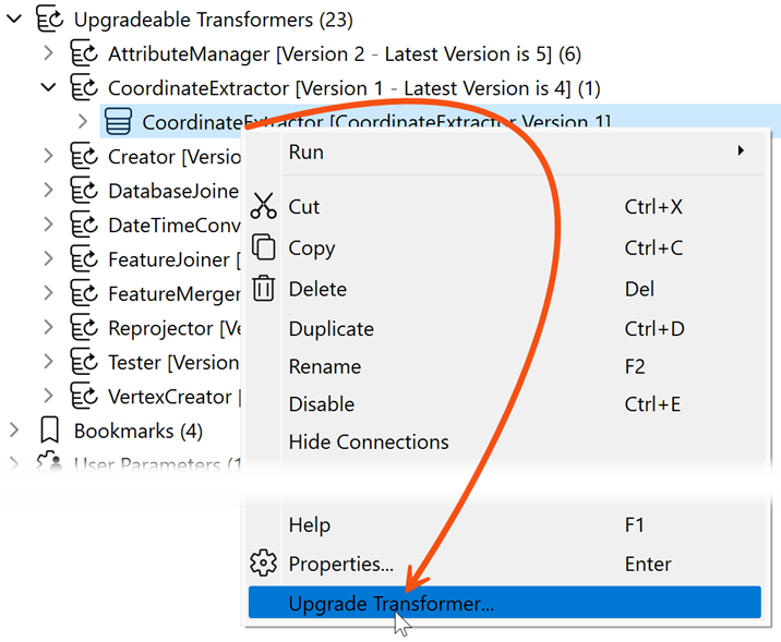

 To upgrade transformers individually, click the arrow next to the transformer name to expand it, and then right-click the specific transformer and select Upgrade Transformer.

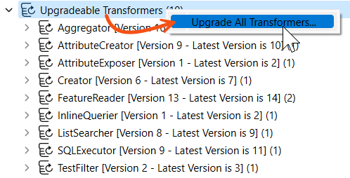

In FME 2024, you can also Upgrade All Transformers by right-clicking Upgradable Transformers, or upgrade all transformers of a specific type by right-clicking the transformer type.
In the Upgrade dialog, FME shows you the differences between the two transformer versions so you can confirm the desired parameters. To proceed with the upgrade, click OK. For more information on what was changed, select Show Changes.
The Show Changes dialog outlines all changes between the two versions.
For some transformers that have undergone drastic changes or had parameters removed, a warning will appear before the Upgrade dialog, outlining the major changes.

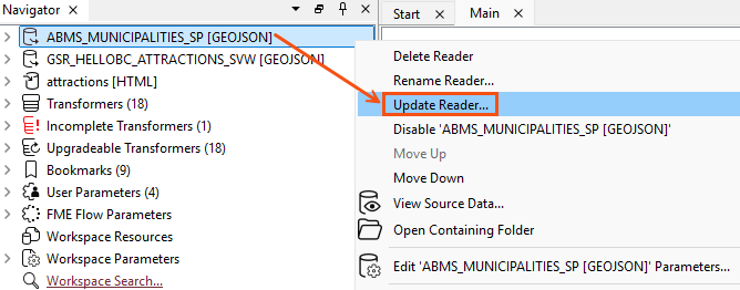

Readers and writers are not updated when a workspace is opened in a newer version of FME. This means the readers and writers will continue to function as they did in the version of FME in which the workspace was authored. This means that new reader and writer parameters will not be visible, and will use a default setting to avoid changing the old reader and writer behavior. To make the new parameters visible, you’ll need to Update the Reader or Writer.
To update readers and writers, right-click on the reader name in the navigator bar and select Update Reader from the menu

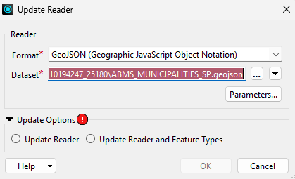

Next, you can select the reader format and dataset. Under Update Options, you can select to update just the reader or the reader and feature types. Updating both the reader and feature types will trigger a schema update and may affect other transformers later in the workflow.
If significant changes are made to a reader or writer, a completely new reader or writer may be created. In this case, the short name format is changed to distinguish between old and new readers and writers. For example, with the OGC GeoPackage format, an old workspace opened in a newer version has the short name GEOPACKAGE. If you add a new GeoPackage reader in the new version, the short name will be OGCGEOPACKAGE, and it will have the new reader characteristics and parameters.

Compatibility between FME Form and FME Flow when publishing workspaces differs slightly from that within FME products. For best results, FME Form and FME Flow should match in versions when publishing. However, publishing is supported if the year and major version match, and the FME Form version is the same or older than the FME Flow version. For example, publishing from FME Form 2024.1.1 to FME Flow 2024.1.2 is supported, but publishing from FME Form 2024.1.3 to FME Flow 2024.1.2 is not supported. See our documentation on Publishing to FME Flow for more examples on FME Form and Flow publishing compatibility.

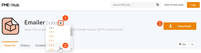

FME will automatically install the latest version of an available custom transformer or package from the FME Hub. This may cause incompatibility with older versions of FME. Older versions of custom transformers and packages can be manually downloaded from their FME Hub pages and installed for use with an older version of FME. To do this on the specific FME Hub page, click the drop-down arrow next to the version number, select the desired version, and then select Download.
