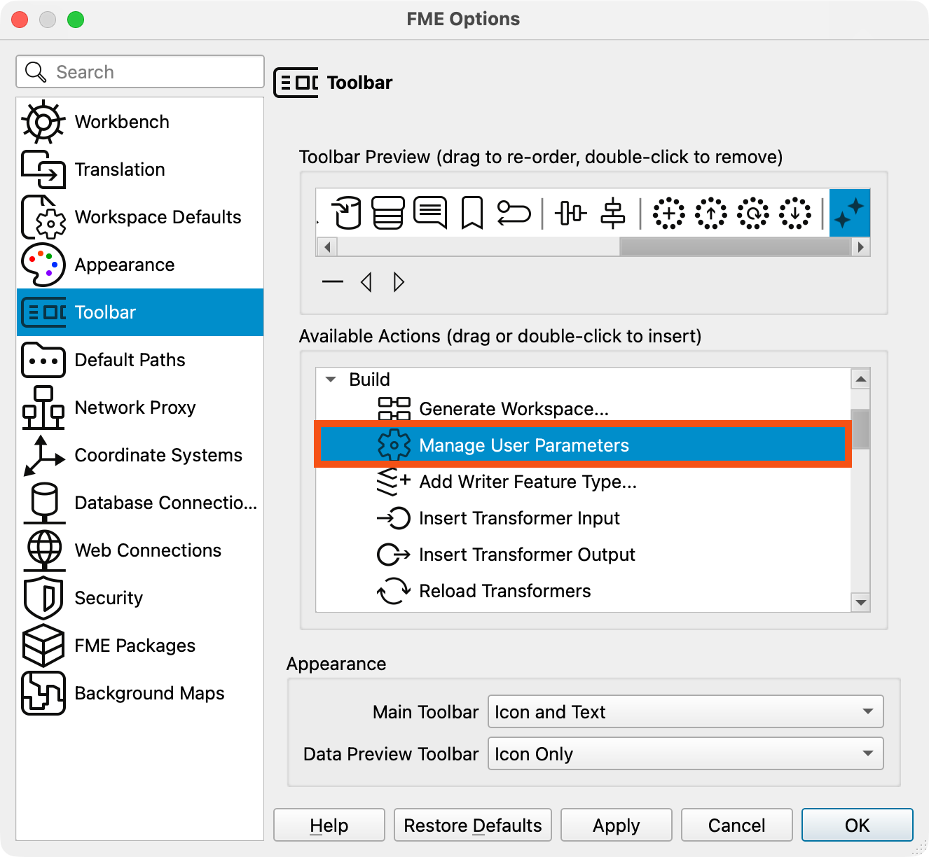

    • Open FME Options > Toolbar > Available Actions > Build > Double-click Manage User Parameters

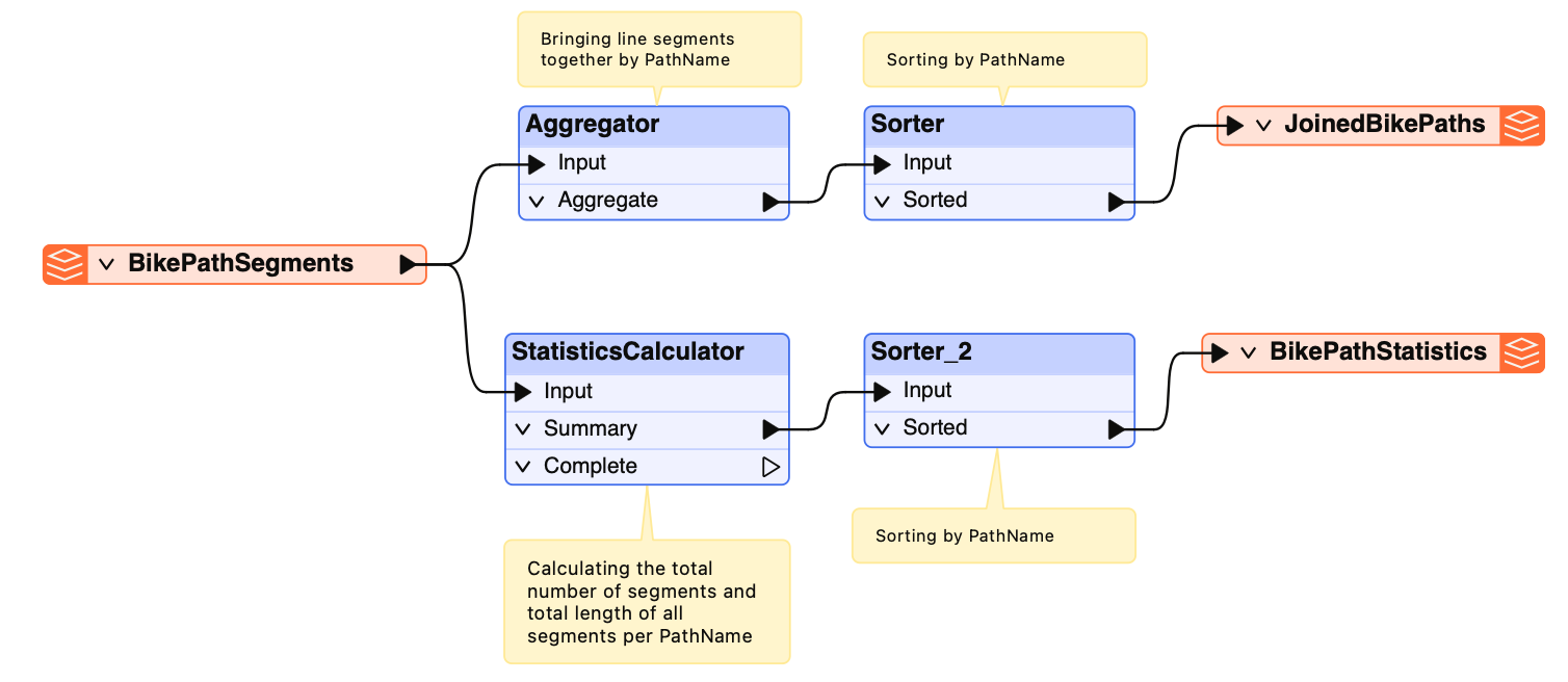

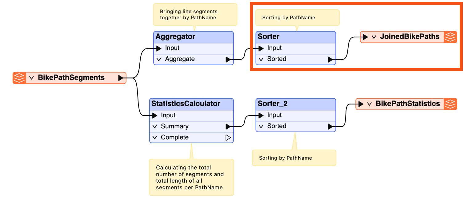

This workflow reads Vancouver bike path line segments into the workspace, then splits into separate branches to generate two outputs:
  • a MapInfo file of bike paths
  • a CSV file of bike path statistics
The workspace template will be adjusted to make use of a visible user parameter applied to the Dataset parameters of a MapInfo writer and a CSV writer. In this way, the written files will be output to a destination folder defined by the user at runtime.

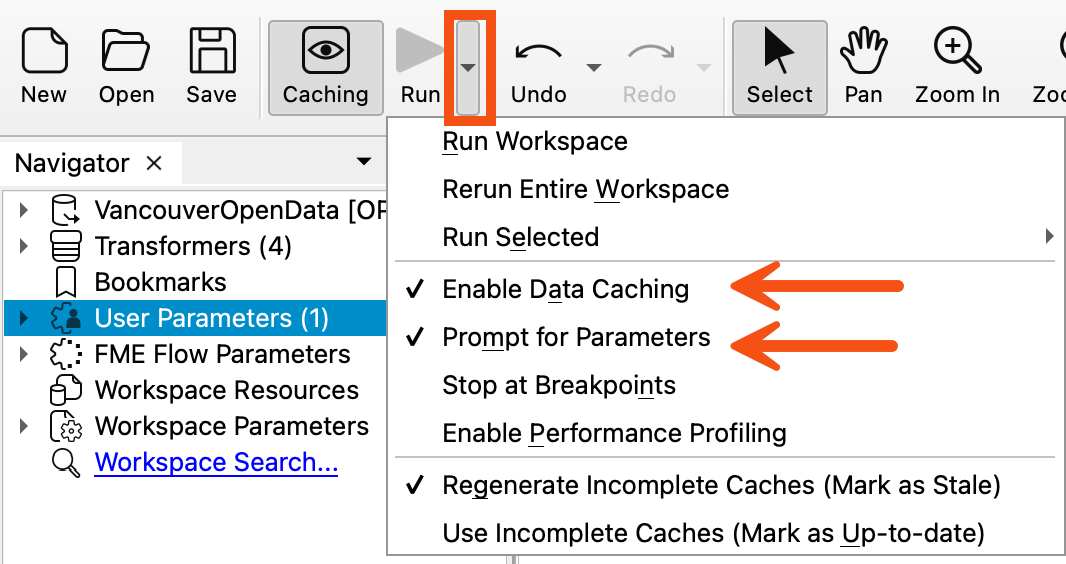

Click the drop-down arrow next to the Run icon and ensure the following settings are enabled:
  • Enable Data Caching
  • Prompt for Parameters

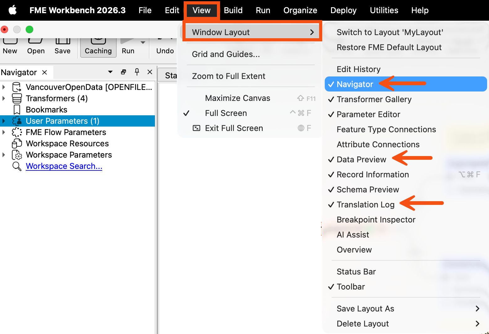

Next, click View > Windows and ensure the following are enabled:
  • Navigator
  • Data Preview
  • Translation Log
These windows can be docked to the Workbench surround, or left as stand-alone windows.

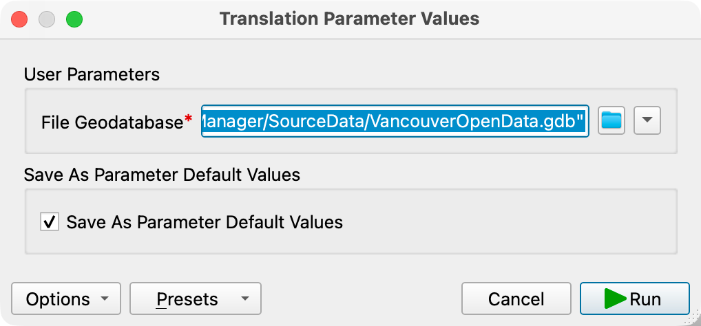

Run the workspace by selecting the Run icon found in the main Workbench toolbar. With the Prompt for Parameters option enabled, the first action that occurs is the display of the Translation Parameters Values dialog with its single visible user parameter.
This single parameter is linked to the geodatabase reader’s File Geodatabase parameter and was created by default when the reader was added to the canvas. FME readers and writers typically create user parameters linked to their source or destination dataset to allow users to point to their target datasets at runtime.

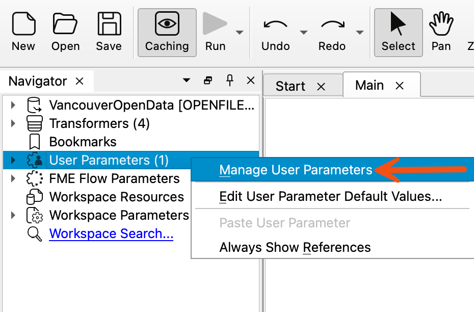

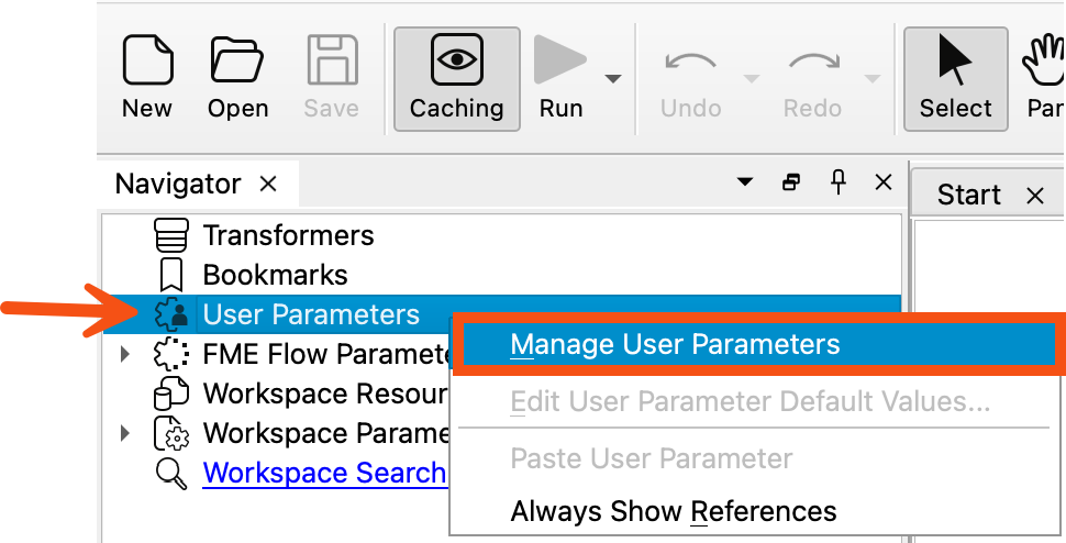

Right-click on the User Parameters node of the Navigator window, and select Manage User Parameters. The Parameter Manager dialog will pop open.

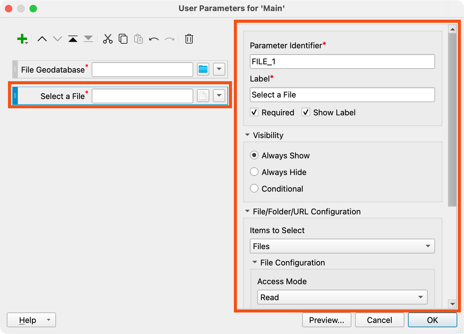

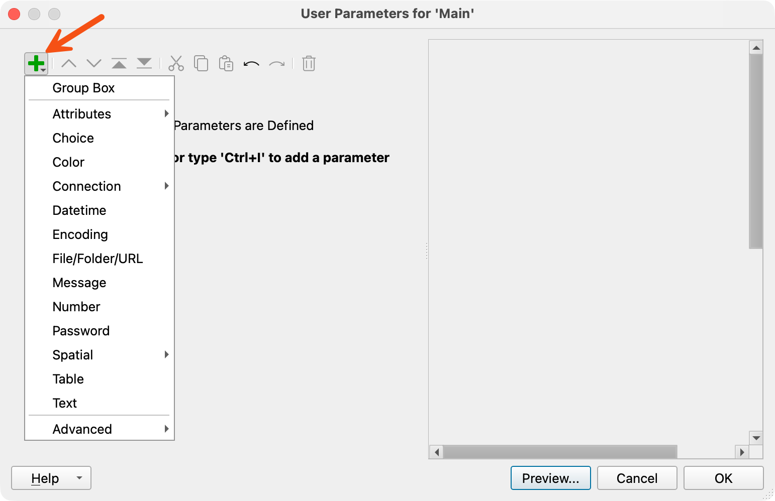

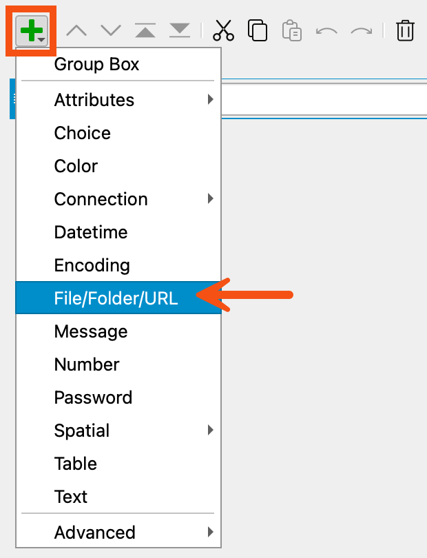

Select the green plus icon at the top left of the User Parameters Manager dialog to access the parameter type drop-down.
Choose the File/Folder/URL parameter type. A new user parameter will appear in the left-side pane of the Parameter Manager, and its default definition will populate in the right-side pane.

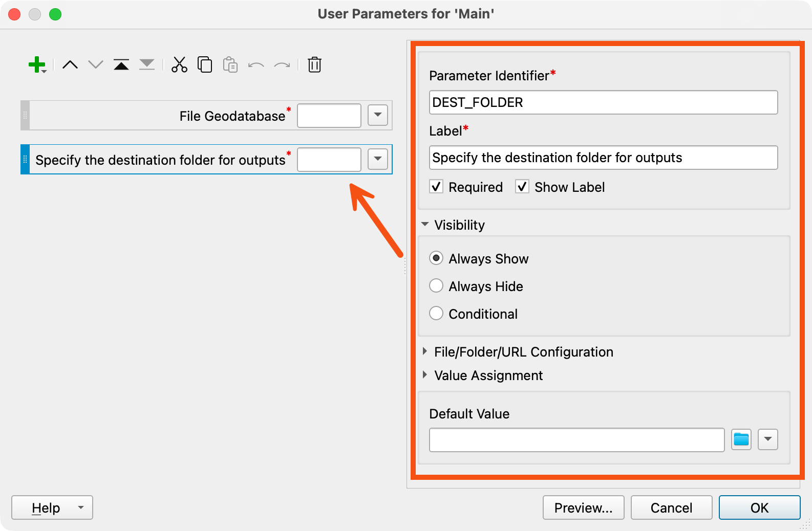

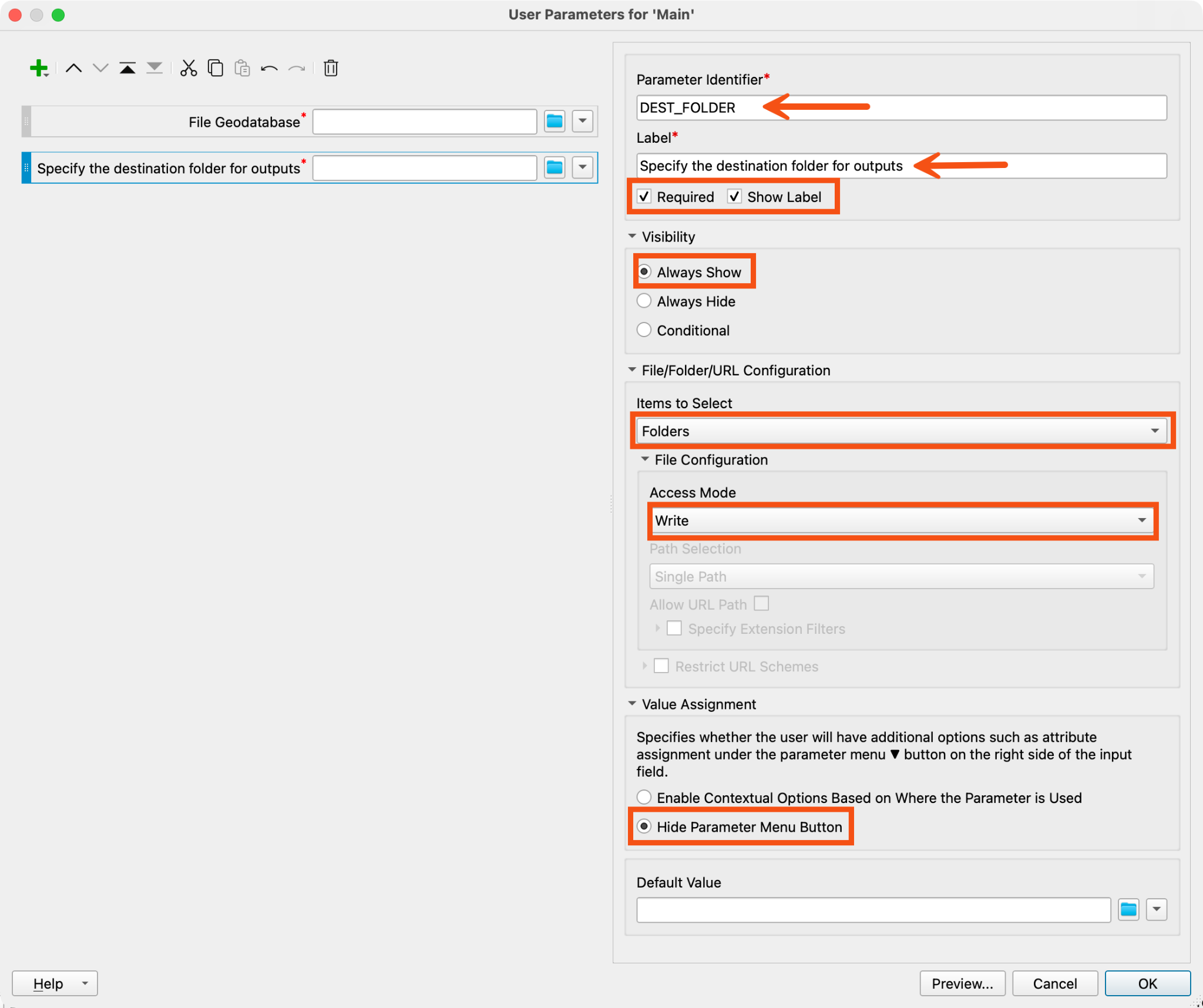

With this new parameter highlighted in the left-side pane, configure the parameter definition in the right-side pane as follows:
  • Parameter Identifier:  DEST_FOLDER
  • Label:  Specify the destination folder for outputs
  • Show Label: Enabled
  • Required: Enabled
    • With this enabled, the parameter will have a red asterisk attached to it in the left-side list of the Parameter Manager
  • Visibility: Always Show
    • With this parameter set to Always Show, we create a visible user parameter that can be configured by users at runtime
  • Items to Select: Folders
  • Access Mode: Write
  • Value Assignment: Hide Parameter Menu Button

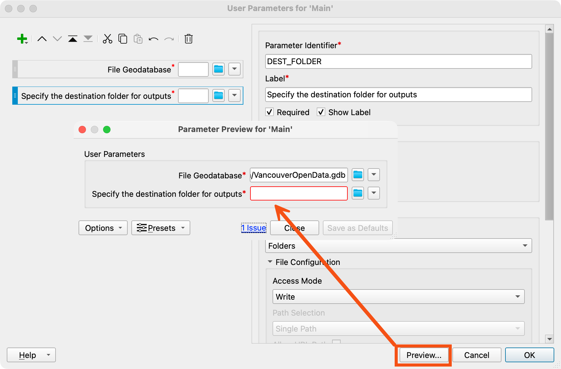

5. Preview Parameter

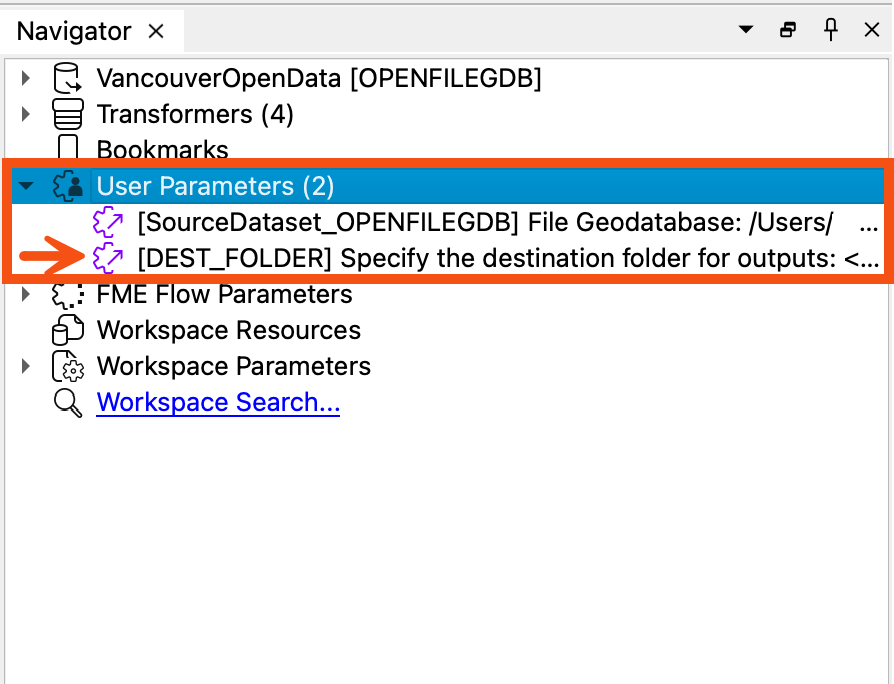

Select the Preview button, at bottom right of the Parameter Manager, to see how this new visible user parameter will look in the runtimeTranslation Parameters Values dialog.
The new File/Folder type published user parameter is denoted in the Translation Parameters Values dialog by its Label value, not by its Parameter Identifier value. The value of this new user parameter shows up highlighted in red, indicating that a value must be provided for it to allow this translation to run.
Try selecting the file folder or drop-down arrow next to the new parameter’s value input box to see the functionality of this published parameter type. Users will be able to navigate to a desired destination folder for the CSV and MapInfo files that will be output by this workspace, right at runtime.

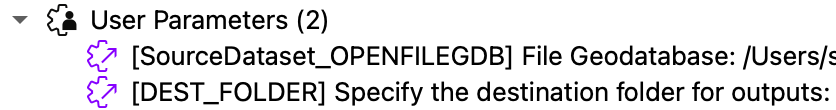

Close the Parameter Manager and return to the main canvas. There should now be a second entry under the User Parameters node of the Navigation window, showing both the Parameter Identifier value and the Label value configured for the new File/Folder user parameter.

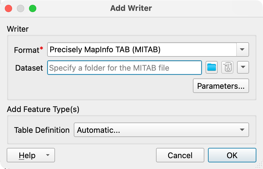

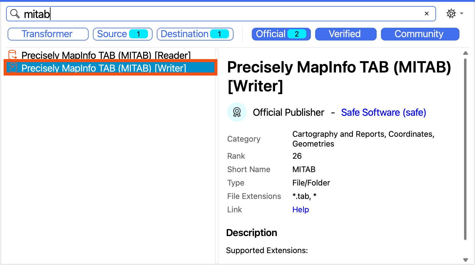

Type MITAB onto the canvas and double-click the Precicely MapInfo TAB (MITAB) [Writer] option.
In the Add Writer dialog that opens, leave the Dataset parameter blank and the Table Definition as Automatic. Click OK.

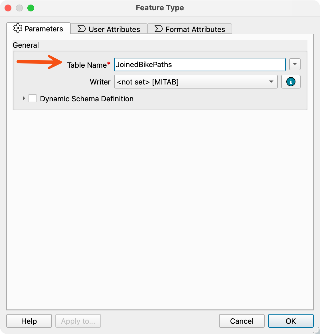

A Feature Type dialog will open. Set the table name parameter:
  • Table Name: JoinedBikePaths

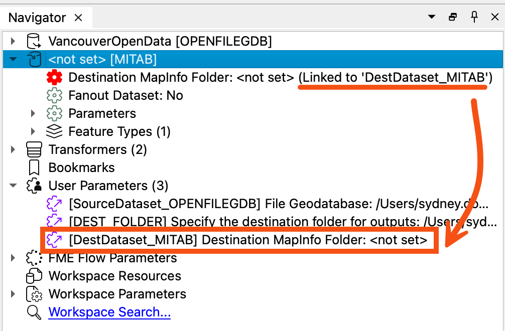

A new MITAB writer feature type will be added to the canvas. Connect this feature type to the top Sorter Sorted output port to have the joined bike path segments written to a MITAB file.
Now, have a look at the User Parameters node of the Navigator window. There should be a third user parameter listed, DestDataset_MITAB. This new user parameter is linked to the Dataset parameter of the newly added MITAB writer. This behavior is expected; adding a new reader or writer to a workspace will always result in the creation of a user parameter linked to the format’s Dataset (or similar) parameter.

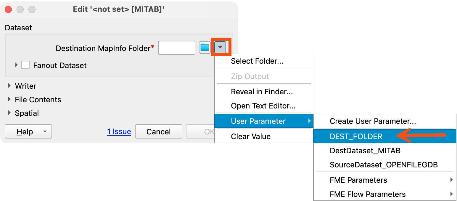

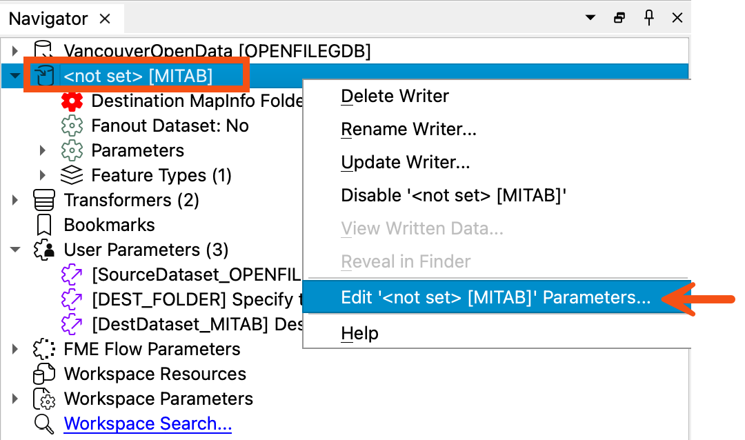

Right-click on the MITAB writer in the Navigator window and select Edit ‘<not set> [MITAB]’ Parameters.
In the Edit dialog that opens, select the drop-down arrow to the right of the Destination MapInfo Folder parameter and choose User Parameter > DEST_FOLDER.
Select OK in the Edit dialog, and watch the User Parameter node of the Navigator window. The user parameter that was auto-created when the MITAB writer was added to the canvas has been deleted, as the writer’s Destination MITAB Folder parameter is now referencing a different user parameter.
This deletion illustrates a key point about user parameter management: if adjustments are made to a workspace such that a user parameter is no longer referenced somewhere in the workspace, the user parameter will be automatically deleted.

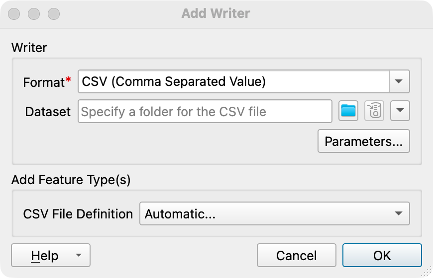

Add a CSV Writer and in the Add Writer dialog that opens, leave the Dataset parameter blank and the CSV File Definition as Automatic. Click OK.

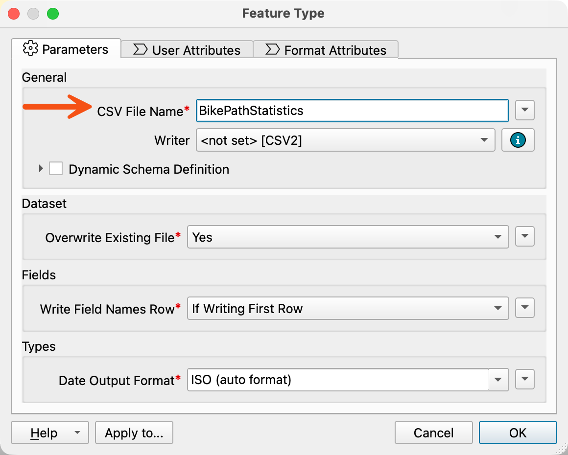

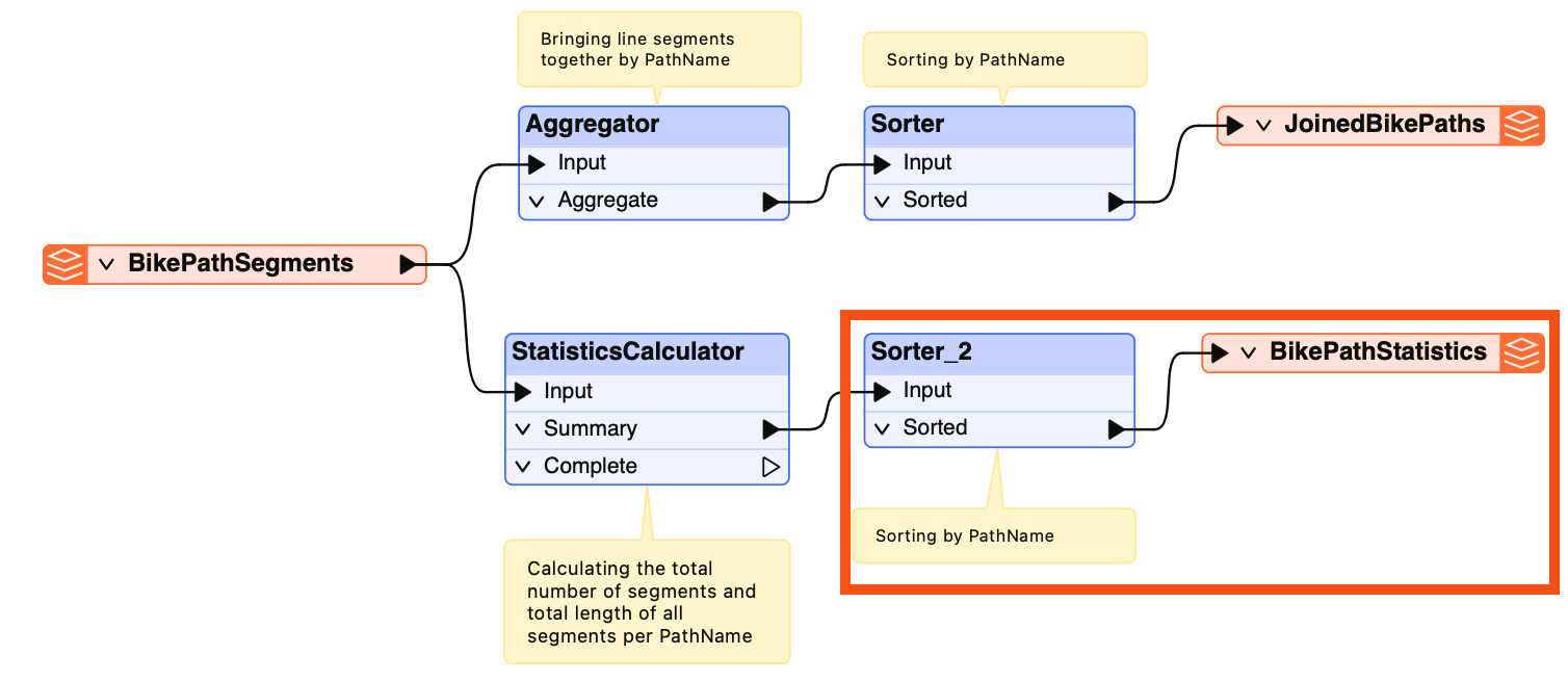

  • Table Name: BikePathStatistics
A new CSV writer feature type will be added to the canvas. Connect this feature type to the bottom Sorter Sorted output port to have the bike path statistics written to a CSV file.

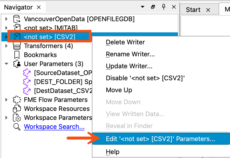

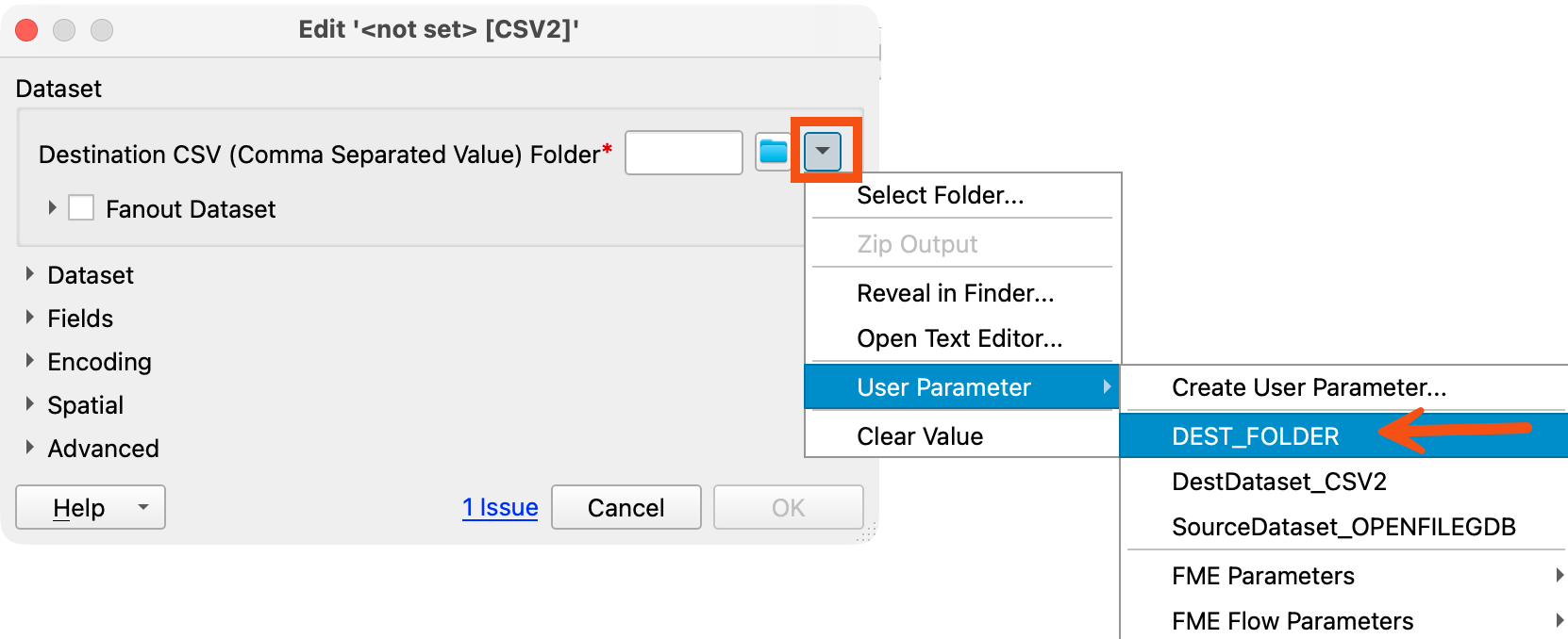

Right-click on the CSV writer in the Navigator window and select Edit ‘<not set> [CSV2]’ Parameters.
Now the DEST_FOLDER user parameter has be applied to two locations, so each output of the workspace will be written to the same user specified folder directory.

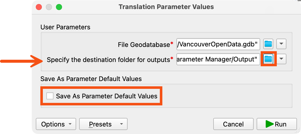

Select the Run icon in the top toolbar to initiate the translation. The Translation Parameters Values dialog will open. Leave the File Geodatabase parameter’s value as-is. Then, click on the ellipsis/file icon next to the DEST_FOLDER (Label: Specify the destination folder for outputs) parameter’s text box. Navigate to and select a folder where the written MITAB and CSV files can be stored.
Optionally, deselect Save As Parameter Default Values in the Translation Parameters Values dialog to ensure the selected folder path does not become the default value for this published parameter. This option is recommended if the workspace will be shared among many users to avoid errors associated with invalid parameter values on different machines/networks.
Now click the Run button at the bottom right of the Translation Parameters Values dialog. Observe the translation log messages in the Translation Log window, watching for the Translation was SUCCESSFUL message. This workspace should result in 21 features being passed into each writer feature type and the MapInfo file and CSV file stored in the location specified by the DEST_FOLDER parameter value.
