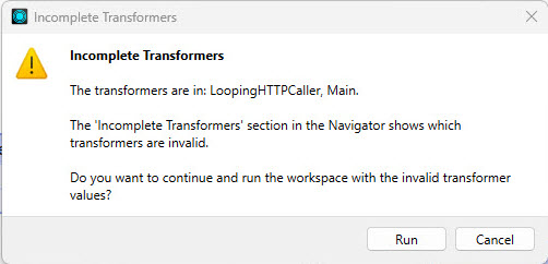

If there are transformers missing parameter values throughout the workspace, and the workspace is run, FME will throw a warning alerting users to these missing parameter values:
The warning mentions by name the affected canvas object, and where to look to quickly remedy the situation. This is FME’s friendly way of telling users that it is missing some key instructions, highlighting just how important these parameter values are to the correct functionality of any given workflow. Providing meaningful values for all transformer parameters in a workspace is thus crucial to obtaining valuable outputs.

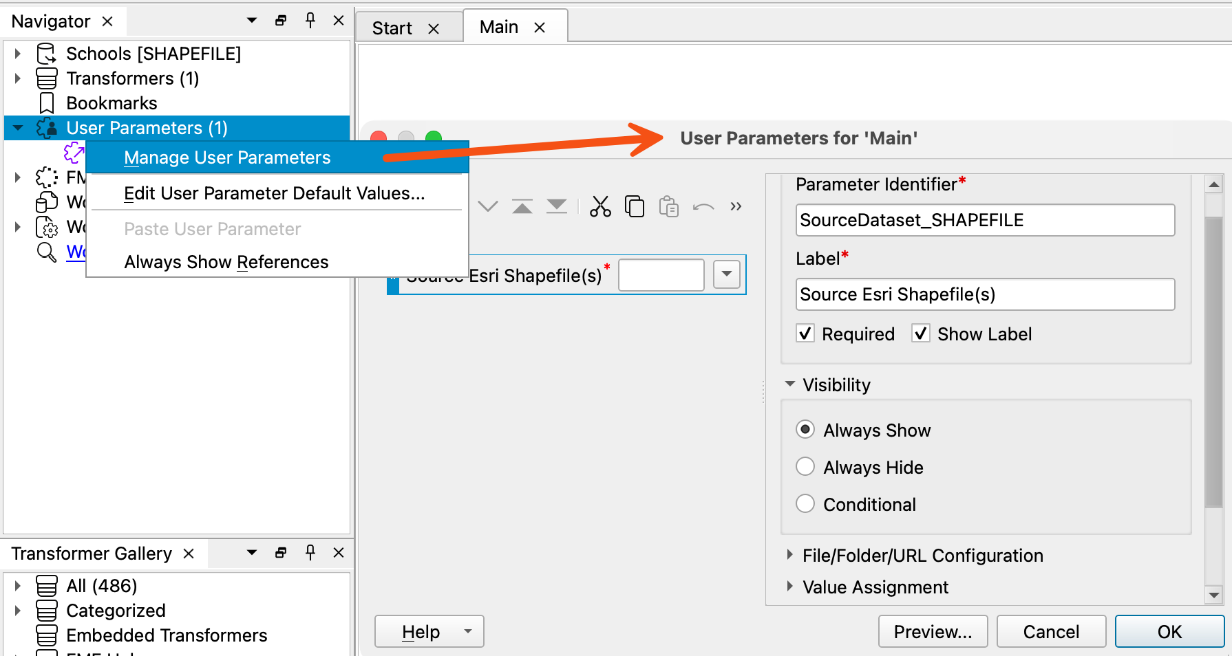

User parameter definitions can be managed from the Parameter Manager. Access the Parameter Manager dialog by right-clicking the User Parameters node of the Navigator window, and selecting Manage User Parameters.
Creating user parameters from the Parameter Manager dialog should be considered an advanced user task. Instead, user parameters are best created from the dropdown menu options available when specifying the target parameter's value. Please see the FME Knowledge Base article, User Parameters in FME Form, for details.
