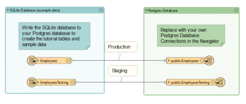

Open DatabaseConfiguration.fmwt in FME Workbench. This workspace will allow us to establish the PostgreSQL database connections and create the employee data.
The DatabaseConfiguration.fmwt canvas

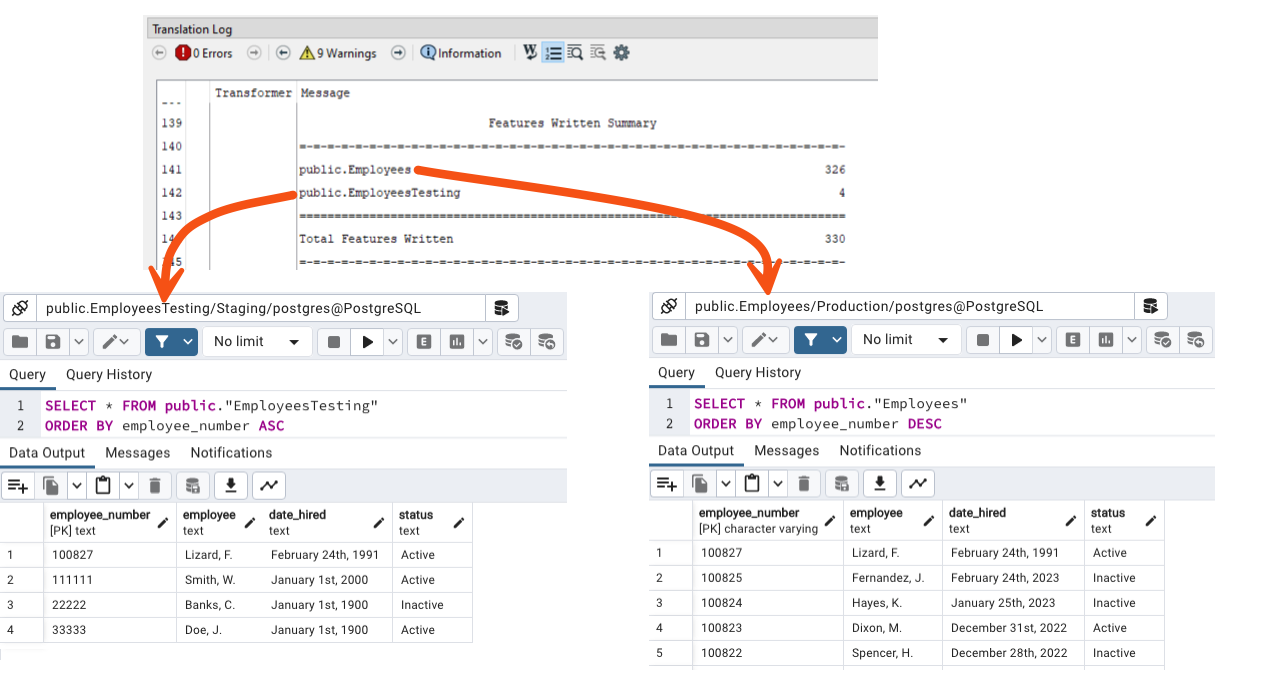

Run the workspace to write the SQLite tables to your PostgreSQL databases. This step tests the connections and creates the example data for the remainder of the exercise.
A successful translation log and the database tables as viewed in pgAdmin 4.

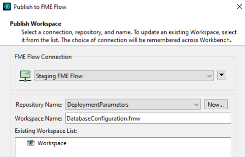

3. Publish the Database Connection to FME Flow

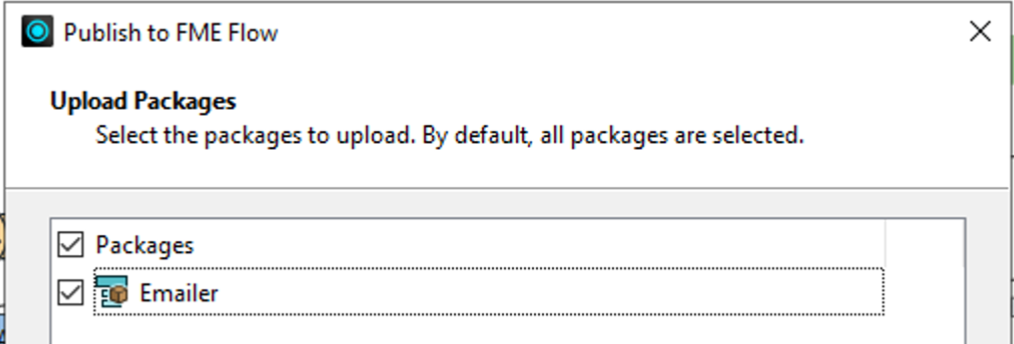

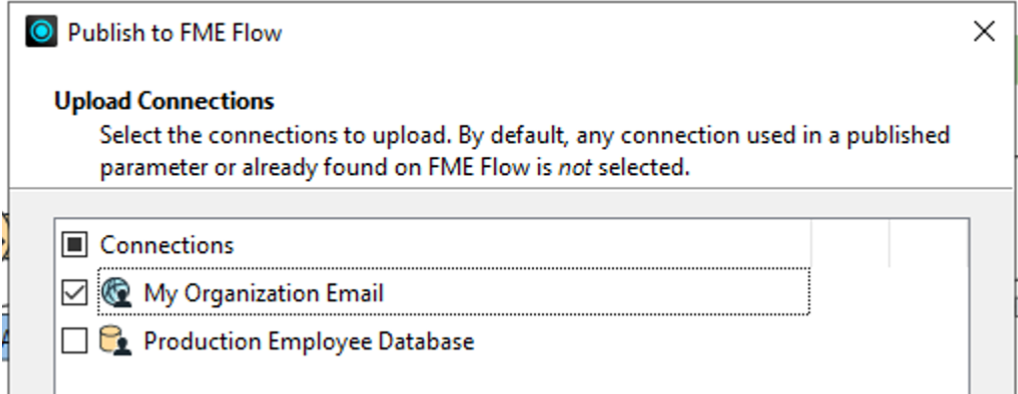

While connected to the “Staging FME Flow”, select Publish to open the publishing wizard. Create a new repository named “DeploymentParameters”.
In the Upload Connections dialog, select only the “Staging Employee Database” database connection.
Recall, in this organization, staging workflows are not meant to write data to the production database. Therefore, we have no reason to upload the “Production Employee Database” connection to our “Staging FME Flow”.
Click through the remaining default settings to publish the workspace.

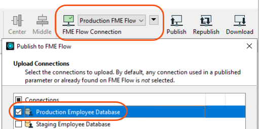

Now, toggle the FME Flow Connection to “Production FME Flow”. Repeat the steps in the publishing wizard to upload only the “Production Employee Database” database connection.

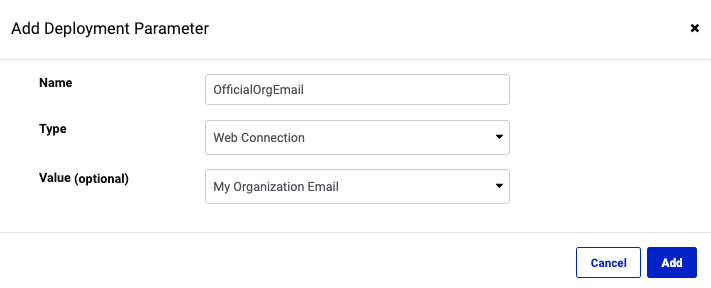

4. Create a Deployment Parameter from a Database Connection

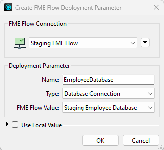

In FME Workbench, ensure you are connected to your Staging FME Flow Connection.

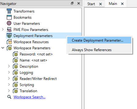

From the Navigator Window, right-click on Deployment Parameters and select ‘Create Deployment Parameter’.
Configure the new Deployment Parameter as follows:
Parameter Value
Name EmployeeDatabase
Type Database Connection
Value Staging Employee Database
Upon clicking OK, the Database Connection will be uploaded to your FME Flow instance if it doesn’t already exist, and the Deployment Parameter is created.

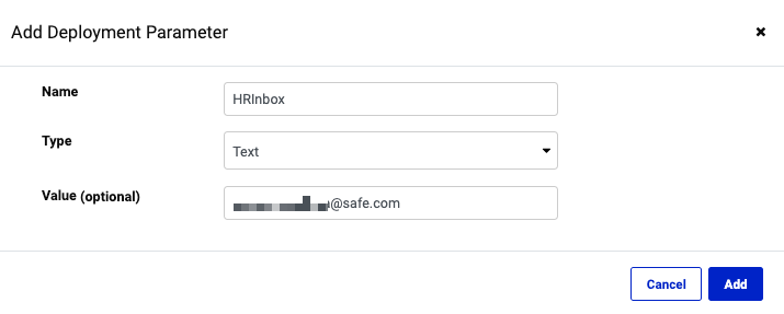

5. Create a Deployment Parameter from a Text Value
In addition to web and database connections, text values can be made into deployment parameters. This lends itself to many different workflow possibilities, such as usernames, API keys, file paths, URLs, storage buckets, email addresses, and scripting values, among others. Conveniently, text-based deployment parameters can be created directly from the Deployment Parameter Store.
In our example, the PostgreSQL staging and production databases use different table names to store employee data. From the Navigator Window, right-click on Deployment Parameters and select "Create Deployment Parameter" again to create a deployment parameter for our database table names.
Parameter Value
Name EmployeeTable
Type Text
Value EmployeesTesting
Select OK.

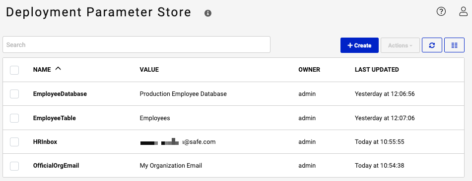

The Production FME Flow Deployment Parameter Store now has “EmployeeDatabase” and “EmployeeTable”.
The Staging FME Flow and the Production FME Flow now each share two deployment parameters with the same name: “EmployeeDatabase” and “EmployeeTable”. However, the values for each of those deployment parameters differ. This allows workflows that reference these deployment parameters to automatically pick up the correct values for the environment.

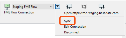

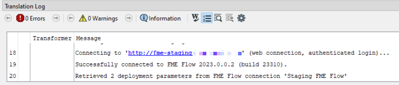

Workspaces can be synchronized with the Deployment Parameter Store at any time.
Toggle the FME Flow Connection to the “Staging FME Flow”. From the drop-down menu, select Sync to retrieve any new or updated deployment parameters. This step is especially important if your workspace is open in FME Form while changes are being applied to the Deployment Parameter Store in FME Flow.
In the Translation Log window, you might spot a new message: “Retrieved 2 deployment parameters from the FME Flow Connection ‘Staging FME Flow’”

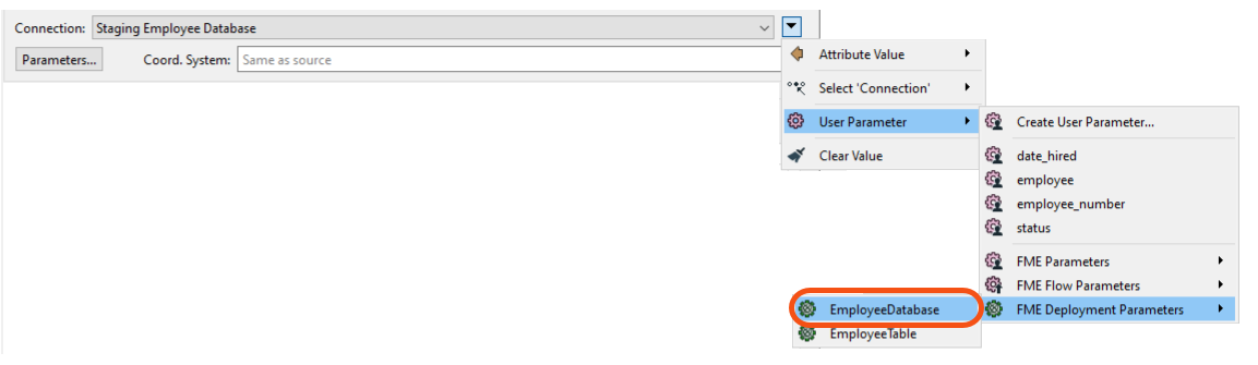

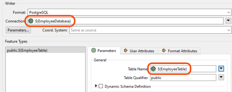

2. Use a Deployment Parameter in a Transformer
Similar to attribute values and user parameters, deployment parameters can be used as parameter values in transformers, readers, and writers.

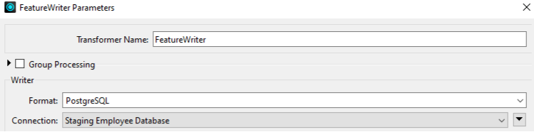

From the canvas, open the FeatureWriter. The PostgreSQL Connection parameter is currently using the standard “Staging Database Database” database connection.
By default, a standard database connection references a locally stored configuration (as we created in Part 1.1). But if the workspace was published to an FME Flow where the connection was not also uploaded or maintained, it would fail to find that configuration.
Deployment parameters are more robust because they allow workspaces to reference the same parameter in FME Form and FME Flow environments. In each environment, the underlying values must still be configured and maintained. But it allows the user to move that workspace between environments and trust that the appropriate parameter values will be referenced.

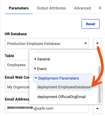

From the dropdown menu next to Connection, select User Parameters > FME Deployment Parameters > EmployeeDatabase.
Deployment parameters are distinguished by a green cogwheel icon.
In this example, our database table names differ across environments. We can account for that with our text deployment parameter, "EmployeeTable". In Parameters > Table Name, use the drop-down menu to select User Parameters > FME Deployment Parameters > EmployeeTable.
The FeatureWriter should now employ our two deployment parameters.
FeatureWriter configured with deployment parameters
Select OK to return to the canvas.

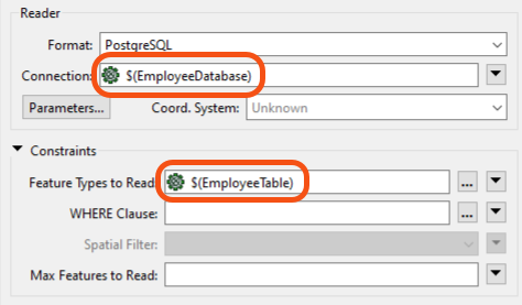

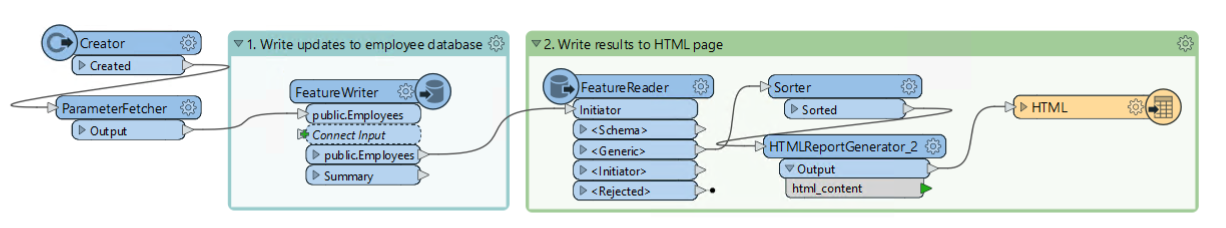

Next, open the FeatureReader. Repeat the steps to replace the standard “Staging Employee Database” connection with “EmployeeDatabase”. Use the drop-down menu next to Connection, and select User Parameters > FME Deployment Parameters > EmployeeDatabase.
Apply the EmployeeTable deployment parameter as a value for Constraints> Feature Types to Read. This completes the configuration.
FeatureReader configured with deployment parameters

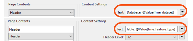

Lastly, this workflow produces HTML, allowing us to quickly confirm the results. Open the HTMLReportGenerator to review. In the Page Contents, there are two Headers with the values:
Text
Database: @Value(fme_dataset)
Table: @Value(fme_feature_type)
HTMLReportGenerator Headers
The final HTML will report the runtime values: the fme_dataset value will contain the database name, and the fme_feature_type value will contain the table name. If our deployment parameters are configured correctly, these values will differ when running the workspace in testing or production environments.
Close the HTMLReportGenerator.

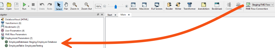

In the Navigator, notice the Deployment Parameters section has now been populated with their Staging FME Flow values.

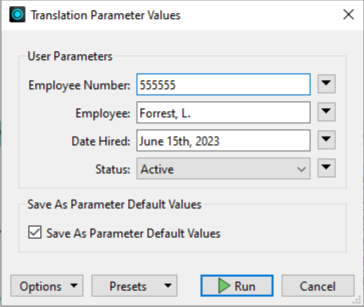

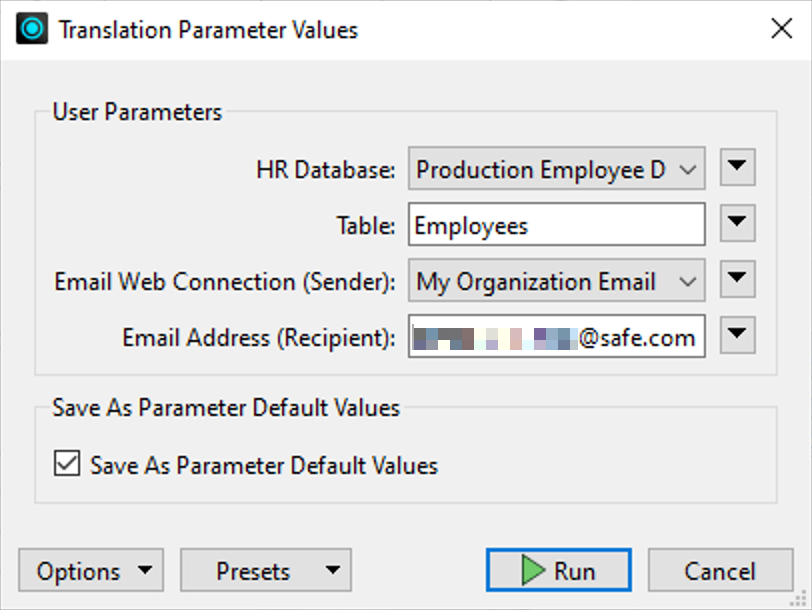

Select Run from the ribbon menu. You’ll be prompted to enter four user parameters. Example data for an update:
User Parameter Value
Employee Number 555555
Employee Forrest, L.
Date Hired June 15th, 2023
Status Active

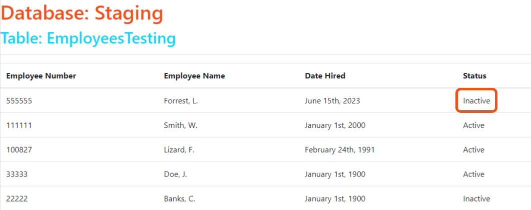

Once the translation is complete, select the folder icon to locate the HTML file.

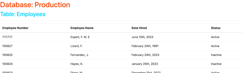

Open the DatabaseVisual.html file in a browser.
In the report, you should see the values for the “Staging” database and “EmployeesTesting” table at the top of the page. Below it, a new or updated employee record should be found in the table.
Feel free to also use pgAdmin to view the results in PostgreSQL. Query the EmployeesTesting table.
Deployment parameters allow users to test their workflows for different environments from FME Form. For example, if you toggled your FME Flow Connection to “Production FME Flow”, the workspace would reference that environment’s deployment parameter values instead.
Staging FME Flow deployment parameter values
Production FME Flow deployment parameter values

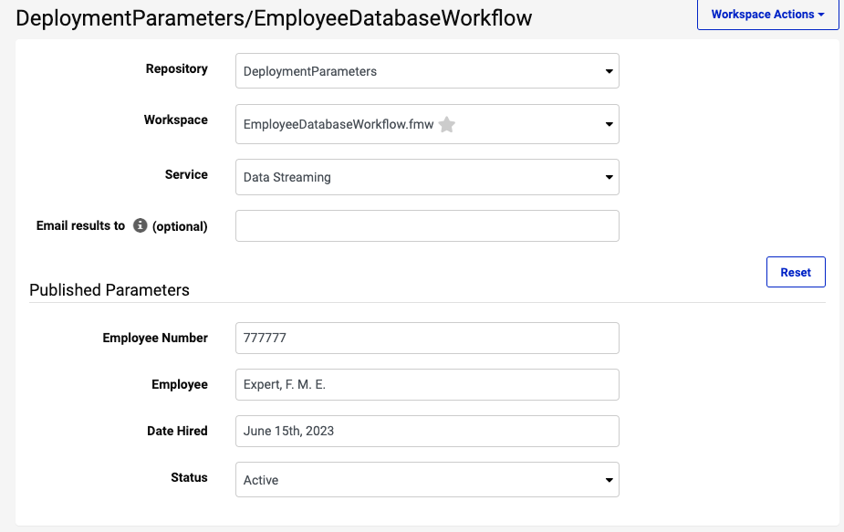

5. Run an FME Flow Workflow with Deployment Parameters

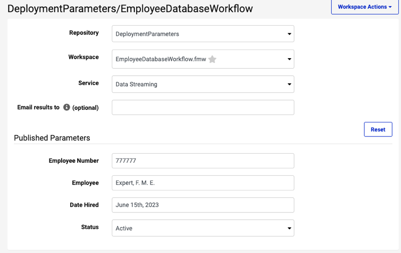

Navigate to the Staging FME Flow in a browser. Open the Run Workspace page and configure the parameters:
Run Workspace Parameter Value
Repository DeploymentParameters
Workspace EmployeeDatabaseWorkflow.fmw
Service Data Streaming
User Parameters:
Status Inactive
Select Run.
An HTML page will be returned in the browser. Because we’re running the workspace from the Staging FME Flow, our deployment parameters have automatically applied the appropriate database and table information. A successful update will display that employee “555555” has been updated to “Inactive”.

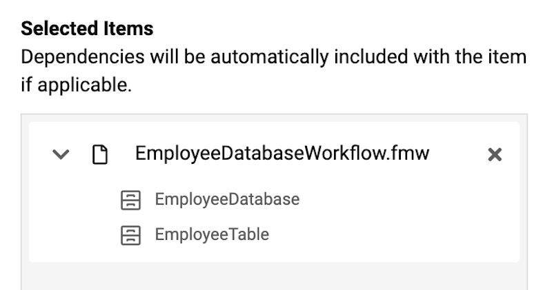

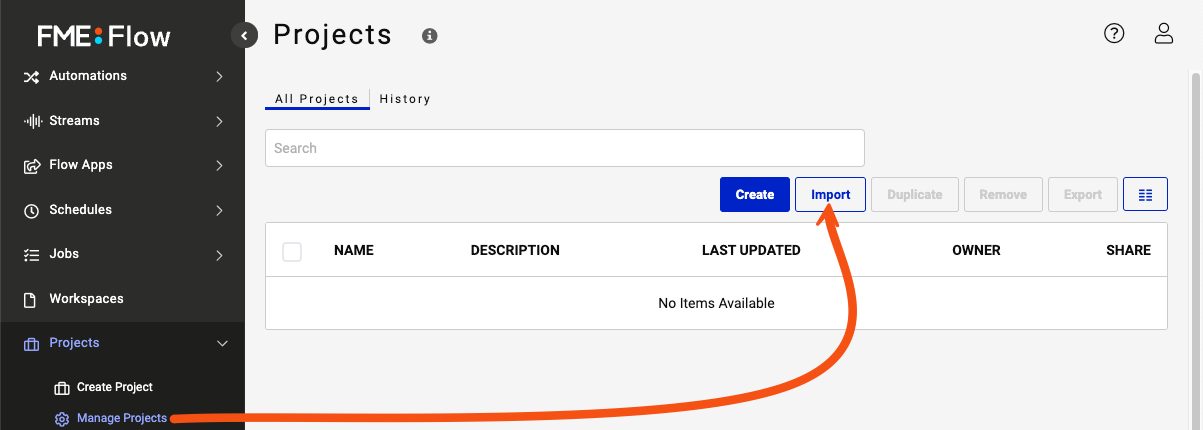

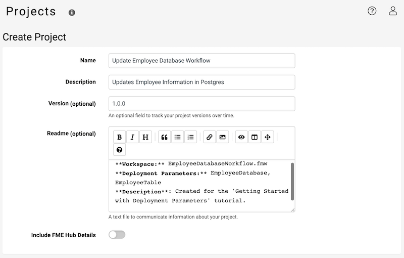

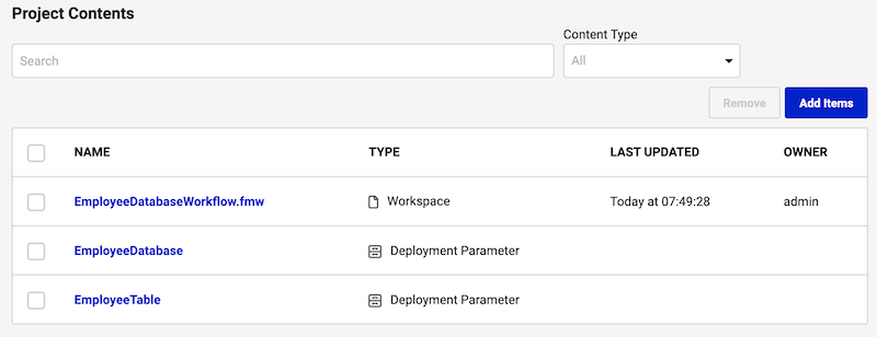

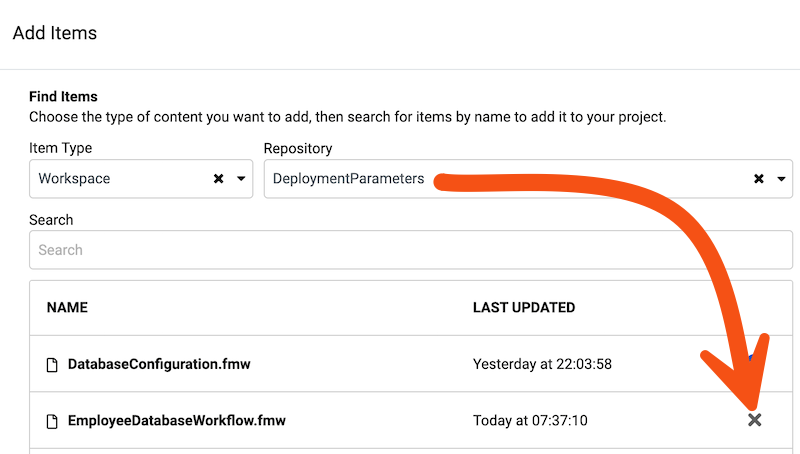

We will now create a project to migrate the EmployeeDatabaseWorkflow.fmw workspace from the Staging FME Flow to the Production FME Flow.
Navigate to the Staging FME Flow in a browser. From the sidebar, open Projects > Create Project. Configure the parameters to describe the employee update workflow.
Project Parameter Value
Name Update Employee Database Workflow
Description Updates Employee Information in Postgres
Version 1.0.0
Readme **Workspace:** EmployeeDatabaseWorkflow.fmw
**Deployment Parameters:** EmployeeDatabase, EmployeeTable
**Description**: Created for the Getting Started with Deployment Parameters tutorial.
In Project Contents, select Add Items to open the dialog.
While scrolling the Item Type list, note the variety of items. These options represent items that can be shared or migrated with a project. Sensitive data, like passwords and connections, can be omitted before export.
For our example, choose Workspace. Select “DeploymentParameters” as the repository and the “+” button next to the EmployeeDatabaseUpdates.fmw workspace.
The Selected Items panel populates with the workspace name. Expanding the item allows us to review its dependencies; i.e., the additional items must be included for the workflow to run successfully in another environment. However, even though deployment parameters are listed, their values are not migrated with projects. Their values are specific to an FME Flow environment and can not be overwritten or migrated with a project.
Select Add Items to return to the project page. The Project Contents now lists the workspace.

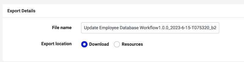

Save the project. From the overview, select Actions > Export.
Review the project export options for reference, but leave all settings at their defaults. We’ll choose to export the project to our desktop, rather than storing it in the FME Flow Resources.
Select Export, then choose a location on your desktop to download the project file (*.fsproject).
2. Import an FME Flow Workflow Using Projects

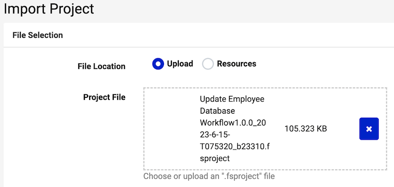

Navigate to the Production FME Flow in a browser. From the sidebar menu, select Projects > Manage Projects > Import.
With File Location set to Upload, drop the fsproject file from your desktop.
Leave the remaining Additional Options at their defaults, then select Import.

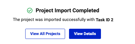

3. Run a Workflow in a Different FME Flow Environment
The project has imported the DeploymentParameters repository and its contents into the Production FME Flow.
From the Run Workspace page, select the repository and workspace. For the User Parameters, enter any sample data, e.g.
User Parameters
Employee Number 777777
Employee Expert, F. M. E.
Status Active
Select Run. If our migration was successful, the workspace will return a familiar HTML page. This time, with the production environment details listed and a new row for the most recently added employee.
The workflow returns the contents of the PostgreSQL ‘Production’ database’s ‘Employees’ table when run from the Production FME Flow
This result confirms a successful workflow migration using FME Flow Deployment Parameters with Projects.

Open EmployeeQuery.fmw in FME Form. In summary, this workspace reads the PostgreSQL "Production" database’s “Employees” table, summarizes the data, writes an Excel sheet, and sends it in an email. The final destination is an HR email inbox.
To run this translation successfully, this workspace requires four parameters. Two parameters that we created in the previous steps:
  • A PostgreSQL database connection (‘Production Employee Database’)
  • The name of the production database table (‘Employees’)
And two new parameters which we’ll create in the following steps:
  • An email Web Connection (sender)
  • An email address (recipient)

From the FME Form ribbon menu, select Publish. Ensure you are connected to “Production FME Flow”. Upload the EmployeeSummary.fmw workspace to the DeploymentParameters repository.
Select ‘My Organization Email’ to upload the Gmail web connection with the workspace.
In the next dialog, select the Emailer package to upload.
Click through to publish the workspace.
2. Create Web and Text Deployment Parameters on FME Flow
Open the Production FME Flow in a browser. Navigate to Files and Connections > Deployment Parameters.  Create a new deployment parameter for the uploaded email web connection.
Parameter Value
Name My Organization Email
Type Web Connection
Value My Organization Email
Next, we’ll create a text-based deployment parameter for the recipient email address.
Parameter Value
Name HR Email
Type Text
Value <recipient email address>
The Production FME Flow now has four deployment parameters.

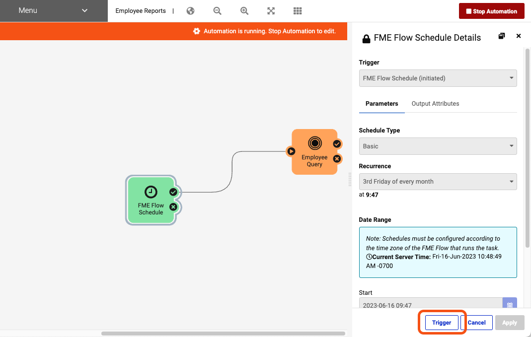

Navigate to Automations > Create Automations. Double-click the Trigger and configure as follows:
Parameter Value
Trigger FME Flow Schedule (initiated)
Schedule Type Basic
Recurrence 3rd Friday of every month
Apply.

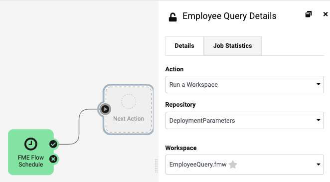

Add an Action to the automation and connect it to the trigger. Configure as follows:
Parameter Value
Action Run a Workspace
Workspace EmployeeQuery.fmw
User parameters become available once the workspace is selected. Beside each parameter, use the drop-down menu to access the deployment parameters. Each will be listed by the name given in FME Flow, prefixed by deployment.*
*Deployment parameters are only available if the type is compatible with the workspace user parameter. For example, connection-based deployment parameters are available for connection-based user parameters, but text-based deployment parameters are not.
Repeat to apply each deployment parameter for all four user parameter values.
Apply to save.

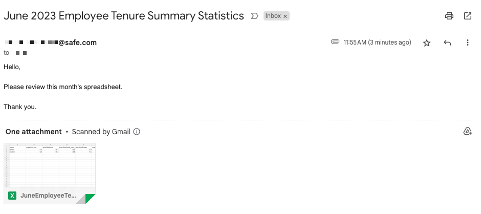

Save the automation as “Employee Reports”. Select Start Automation. Once running, double-click the FME Flow Schedule trigger to open and select Trigger.
A successful workflow delivers an email to the inbox specified in the user parameter, “Email Address (Recipient)”.

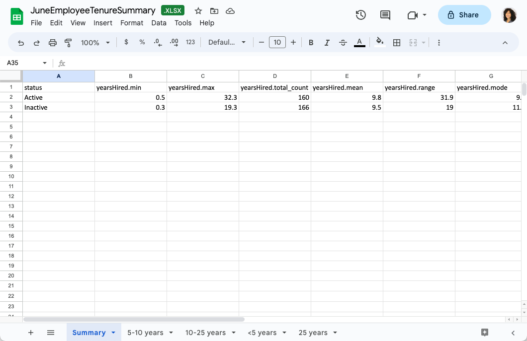

To view the workspace results, open the Excel spreadsheet in a spreadsheet editor. As designed in the EmployeeQuery workspace, the first page summarizes production employee data, and subsequent pages categorize employees by tenure.
An emailed spreadsheet means that we’ve successfully used deployment parameters in an FME Flow Automation.
