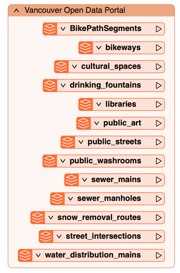

This workspace contains a single Esri Geodatabase (OpenFile Geodb) reader, pointing to a file geodatabase whose feature classes include features related to City of Vancouver transportation, water, and cultural features. The reader is currently configured to read all of the geodatabase’s feature classes into the workspace, as individual feature types. Let’s adjust the reader’s Feature Types to Read parameter so that users can choose to read feature classes from the geodatabase by thematic group, where the thematic groups will include Transportation, Water, and Cultural choices.

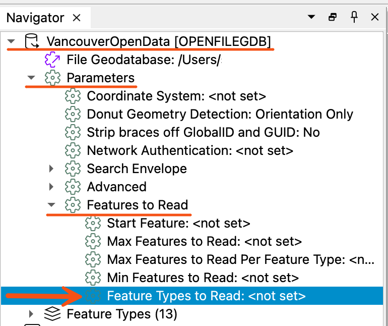

In the Navigator window, fully expand the VancouverOpenData reader. Expand VancouverOpenData [OPENFILEGDB] > Parameters > Features to Read.

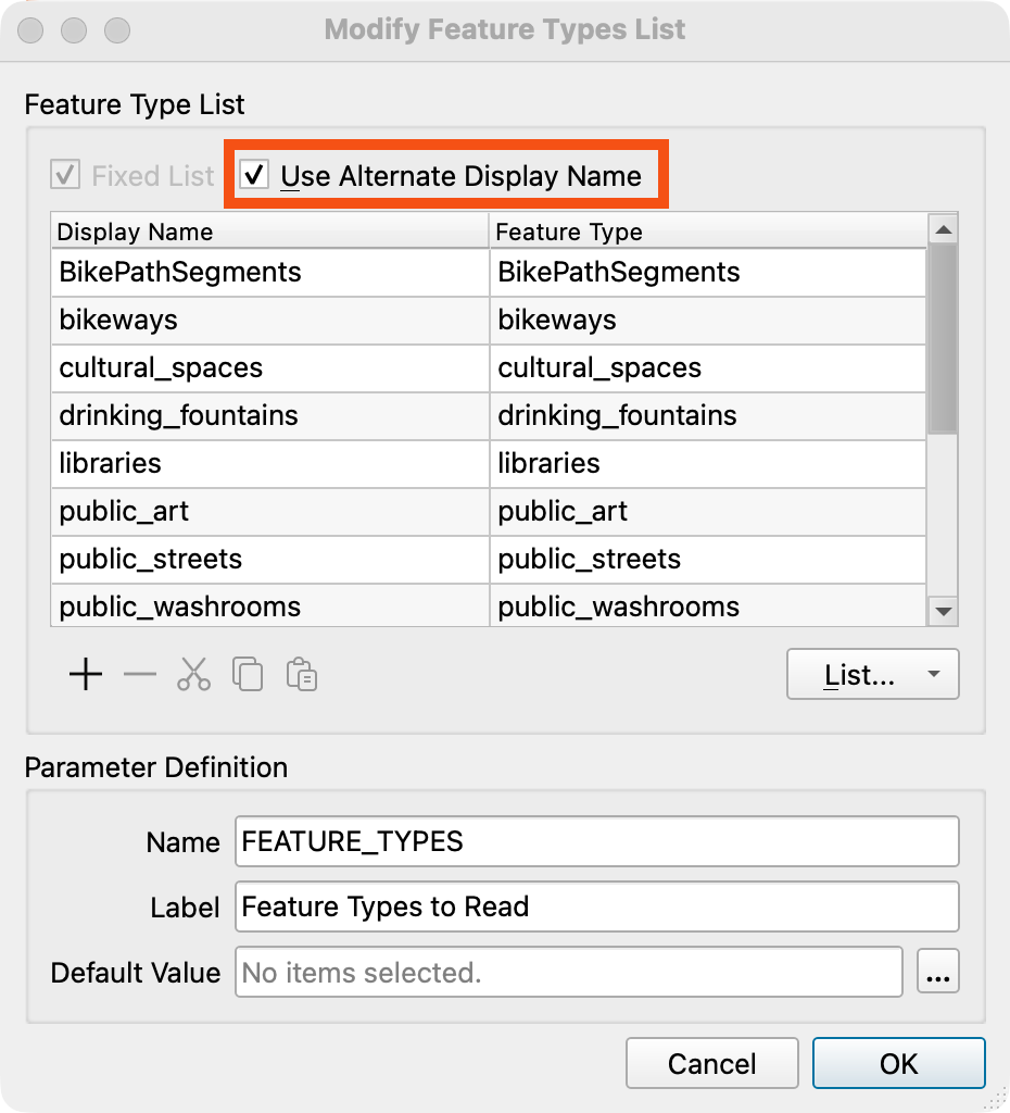

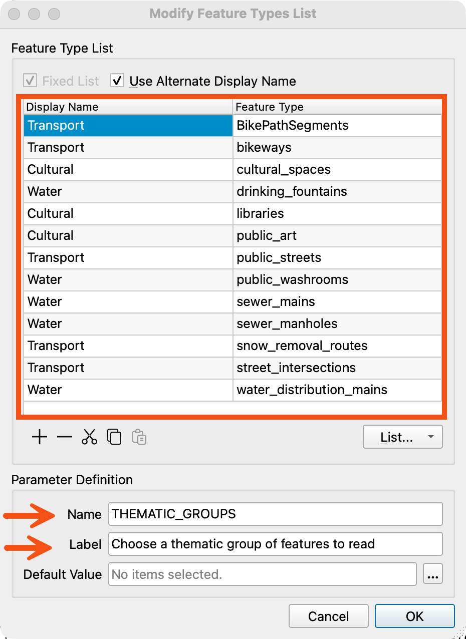

Under the Features to Read node, right-click on the Feature Types to Read parameter, and select Create User Parameter. The Modify Feature Types List dialog will open, and will allow for the definition of a new Choice user parameter.
Enable the Use Alternate Display Name option at the top of the Feature Type List to access a Display Name column.
  • Use Alternate Display Name: Enabled
The Display Name column serves the same purpose as the Display column configured for a typical Choice user parameter. Values entered in this column will be presented to workspace users as choice options at runtime.
The Feature Type column serves the same purpose as the Value column configured for a Choice user parameter. When a user selects a Display Name at runtime for this user parameter, the associated value in the Feature Type column will be set as the value for the user parameter.
One Display Name value can be assigned to more than one Feature Type value. Authors can readily create thematic groups by manually entering the name of a thematic group of interest (e.g. Water) into the Display Name column of each Feature Type associated with the thematic group (eg. Rivers, Streams, Lakes). Essentially, authors can create a 1:M relationship between Display Name value and Feature Type value.
We will create three thematic groups of reader feature types by manually entering the theme into the Display Name column of each Feature Type value.
For the following Feature Types, set the Display Name value to Transport:
  • BikePathSegments
  • bikeways
  • public_streets
  • snow_removal_routes
  • Street_intersections
For the following Feature Types, set the Display Name value to Water:
  • drinking_fountains
  • public_washrooms
  • sewer_mains
  • sewer_manholes
  • Water_distribution_mains
For the following Feature Types, set the Display Name value to Cultural:
  • cultural_spaces
  • libraries
  • public_art
The following table are the parameters to set in the order they are listed in:
Display Name Feature Type
Transport BikePathSegments
Transport bikeways
Cultural cultural_spaces
Water drinking_fountains
Cultural libraries
Cultural public_art
Transport public_streets
Water public_washrooms
Water sewer_mains
Water sewer_manholes
Transport snow_removal_routes
Transport street_intersections
Water water_distribution_mains
Under the Parameter Definition section of the dialog, enter the following:
  • Name: THEMATIC_GROUPS
  • Label: Choose a thematic group of features to read

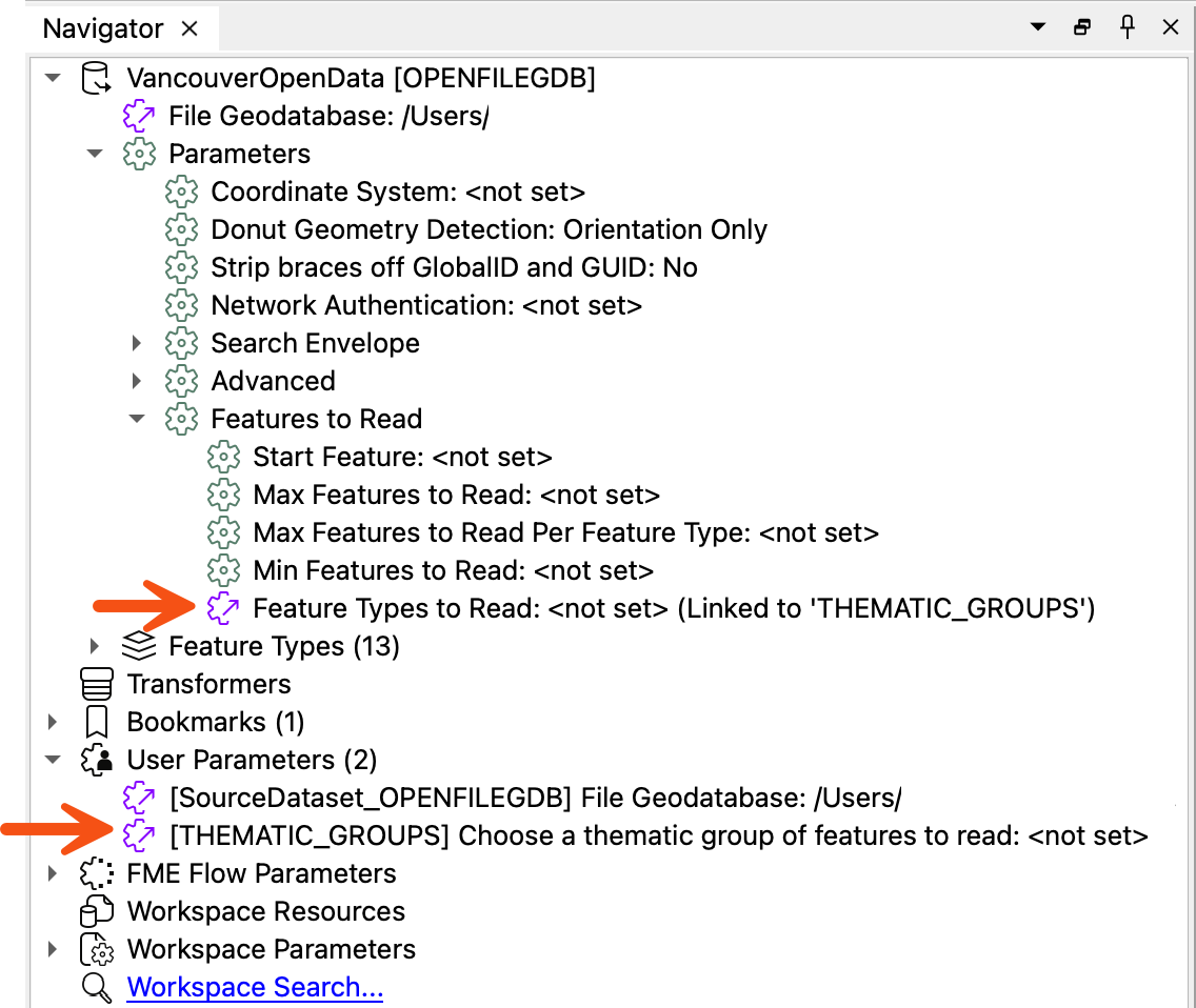

Click OK to accept the definition of this new user parameter and return to the main canvas. The new user parameter, THEMATIC_GROUPS, will now appear under the User Parameter node of the Navigator window. The value of the geodatabase reader’s Feature Types to Read parameter will also now be linked to the value of this new THEMATIC_GROUPS user parameter.
By default, the new THEMATIC_GROUPS user parameter is not a required parameter. In other words, users do not have to choose a thematic group at runtime for the workspace to run. This behavior is ideal for this workspace, as users might not want to filter the geodatabase’s feature types by thematic group.

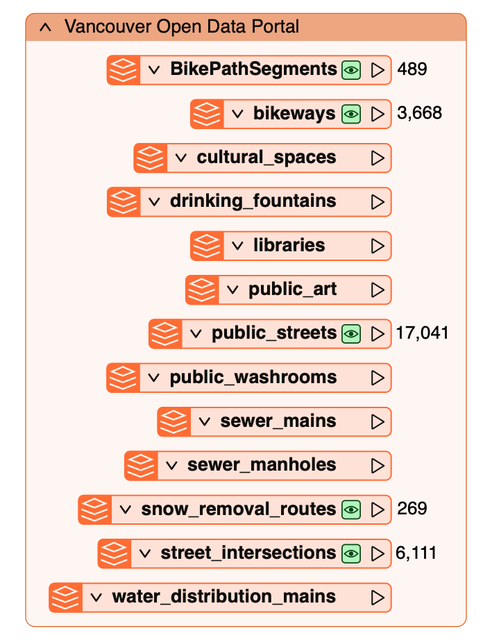

3. Run Workspace

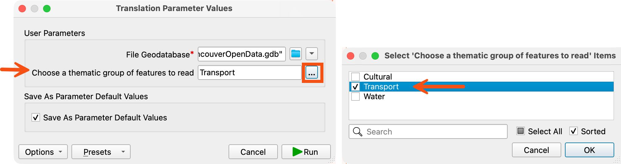

With Data Caching and Prompt for Parameters enabled in the Run menu, click the Run button in the Toolbar. The Translation Parameter Values dialog will appear, showing the Label for the newly created THEMATIC_GROUPS user parameter. Select a thematic group, and then click OK. Click Run.
Watch the data caches of the various reader feature types as the workspace runs; data caches should only appear for those reader feature types associated with the chosen thematic group.
User can now choose which feature types to read by selecting a thematic group created by the workspace author using a Choice user parameter.
