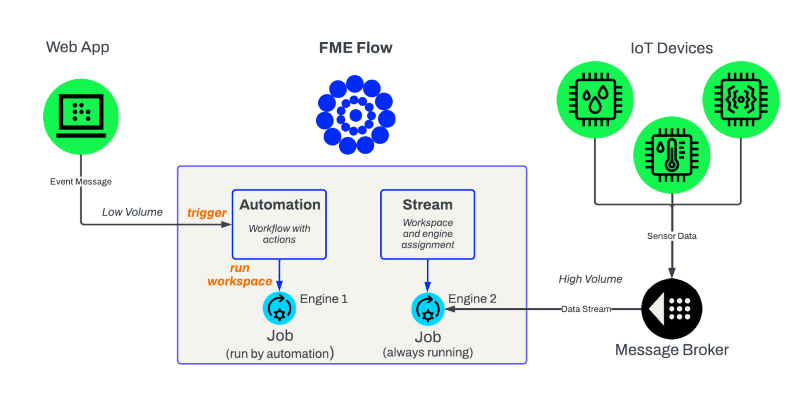

Automations vs Streams
FME Flow provides two powerful solutions for ingesting real-time data: Automations and Streams.
FME Flow Automations can be triggered by event data received from another system via a WebSocket or webhook message, typically in JSON format. This method is effective if events in the source system are well-defined, for example, a form submission, and data throughput is not excessive. With automations, an engine in FME Flow will only be in use when a workspace action is processing a message. Note that webhooks and the FME Flow REST API can also trigger an FME Workspace directly. Please see Automating Workflow Submission from a Third Party Application To FME Flow for an overview of these options.
Suppose the system you are consuming data from can't connect via a WebSocket or webhook. In that case, you can still use other FME Flow Automation triggers to perform near real-time processing by frequently polling. For example, you can poll an email server for new emails or a network drive for new files and trigger an automation when one is received.
If your real-time data is arriving in a constant flow of many messages per second, up to thousands or even hundreds of thousands, then FME Flow Streams are the solution. For example, high-volume data readings from devices like sensors. A stream will allow you to keep a workspace running continuously to receive a data stream from a message broker, such as Kafka, MQTT, or RabbitMQ. Streams can also use WebSocket connections.
The image below illustrates the difference between automations and streams. Watch this video for a summary of event data vs stream data.

Which Approach is Right for Me?
The table below helps you compare and contrast automations versus streams to understand which approach is right for your use case.
  Automation Stream
Data throughput Designed for low-volume data throughput. For non-polling triggers, such as webhooks, up to 1 message per second may be possible, depending on message size and the simplicity of the Automation.  Designed for high-volume data throughput. Can process thousands of messages per second.
Data source Other web applications via webhooks or WebSockets. Message brokers or WebSocket connections.
FME Engine impact Engines are used only when processing Run Workspace actions within an Automation. The engines assigned to the stream are always in use, as they are intended to be constantly processing data. Your server must have at least one engine dedicated to processing the stream. CPU-Usage Engines are recommended for streams that may remain idle for long periods.
Job Logging A job log is created for each Run Workspace Action when the Automation is triggered. Consider that busy Automations will generate many job logs. A continuously running job with one log file that rolls over if it grows too big or the job restarts.
Job orchestration Allows you to build complex workflows composed of several FME Workspaces and other internal and external actions, running in sequence or in parallel. One FME Workspace running constantly per stream. Intended for simple processing due to the high volume of data.
