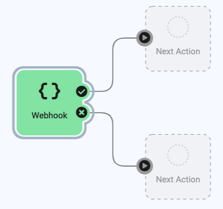

Running Automations by Webhook Trigger
A Webhook Trigger allows applications to send real-time messages and data to an FME Flow Automation. Applications can send messages, data, or notifications to initiate an automated workflow. Webhooks are increasingly supported by many applications and databases. Webhook data can be received in JSON and other formats.
