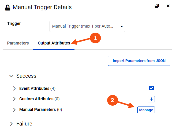

Let’s create a new parameter. Open the Manual Trigger parameters, then switch to the Output Attributes tab. Next, click on Manage to open the Manual Parameters Editor.

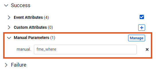

Click OK to close the editor. In the Manual Trigger parameters under Success > Manual Parameters, there is now a parameter called manual.fme_where; click Apply to close the parameters.

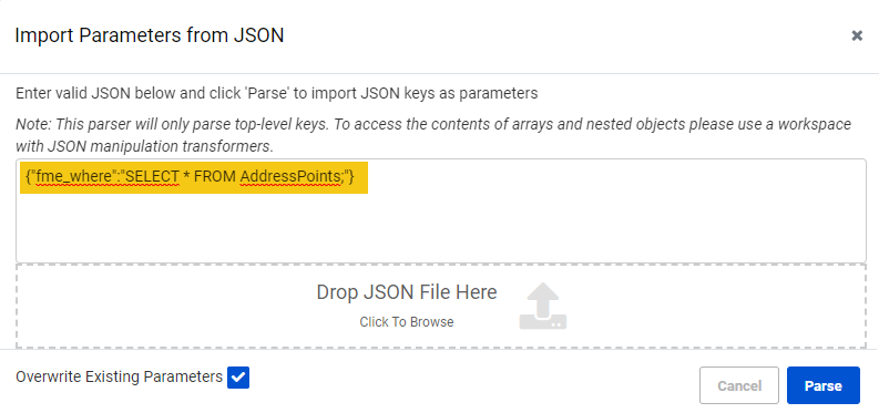

To set this up, open the Manual Trigger parameters, then switch to the Output Attributes tab. Click on the Import Parameters from JSON button to open the popup dialog.
In the popup dialog, enter:
{"fme_where":"SELECT * FROM AddressPoints;"}
Click Parse.
Under Success > Manual Parameters, there is now a parameter called manual.fme_where. Click Apply to close the parameters.
