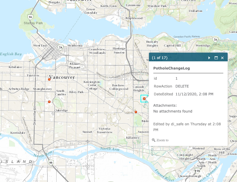

Part 5: Create ArcGIS Online Change Log Feature Service
For this section, we will be using ArcGIS Online to demonstrate a synchronized external application that monitors changes in the database without needing direct access to the database. Log in to your ArcGIS Online account and create a new hosted point feature layer named PotholeChangeLog. In the layer’s Data > Fields, create three new fields:
  • id (integer)
  • RowAction (string)
  • DateEdited (date)
You may find it useful to create a simple ArcGIS Online web app to display the feature service.

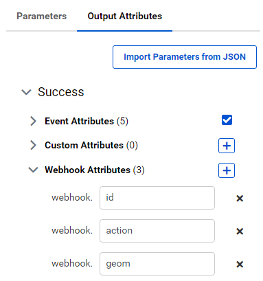

In the webhook trigger, open the Output Attributes panel. Under Webhook Attributes, create three new attributes: id, action, and geom. These attributes are parsed from the JSON sent by the PostgreSQL trigger function and are passed into the logger workspace. Optionally, you can add a Log Action to the webhook trigger and set it to log the webhook message content. Click Apply, save the Automation, and click Start Automation.

Check your ArcGIS Online feature service/shapefile to verify that the edited records were created. Keep in mind that we’re reading the same records from the sample CSV file, so there will likely be overlapping points in your feature service.
