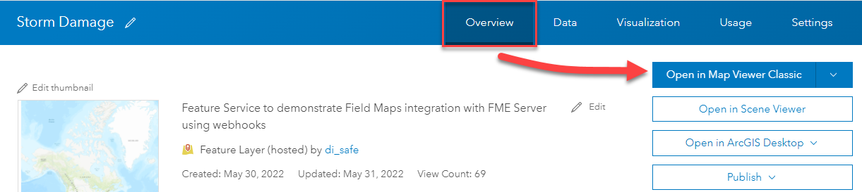

Return to the Feature Layer Overview and click Open in Map Viewer Classic.
AGOL Open Map Viewer Classic
The feature layer is added to a new map. Zoom to a city where damage will be reported in Field Maps, in this example, Vancouver, Canada. Name the map “Storm Damage”, the same as the feature layer, and save.
AGOL Map Viewer Classic

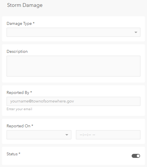

Click Content and then the Storm Damage layer. This will show the Field Maps Form Builder that we will use to design a form for inspectors to add and edit points where storm damage is found. The Form Elements on the right can be dragged onto the form and rearranged as needed.
Add the following elements to the form. Make sure Allow Editing is enabled for all fields (this is the default):
Form Element Display Name Field Name Type Length Required
Choice - Combo box Damage Type Damage_Type String 50 Yes
Text - Multiline Description Description String 1000 No
Text - Singleline Reported By Reported_By String 100 Yes
Date/Time Reported On Reported_On Date N/A Yes
Switch Status Status String 10 Yes
The list values for the Damage Type combo box are:
Label Code
Tree TREE
Sign SIGN
Traffic Light LT_TRAFFIC
Street Light LT_STREET
Power Line PWR_LINE
For the Status switch, the values are simply OPEN (switch off) and CLOSED (switch on). Default the value to OPEN.
Note: ArcGIS Online will automatically create attributes in the Storm Damage Feature Layer for the form elements added.
Save your form. You can add placeholder text and field descriptions if you wish. The resulting form in the Form Builder should look like this:

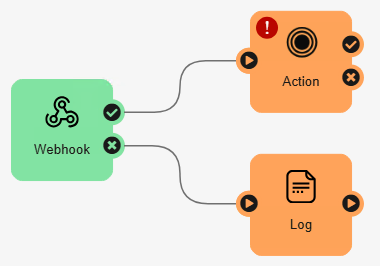

Double-click the Trigger. In the drop-down menu, select Webhook (triggered).
To get a webhook URL, you will need to save the Automation first. Save the Automation as "Field Maps Storm Damage". Click once again on the Trigger and you should now see the Webhook URL. This URL contains a unique token to give our Field Maps webhook the ability to access FME Flow and run the Automation. Leave the parameter open, we will need to copy the Webhook URL when creating the ArcGIS Webhook.

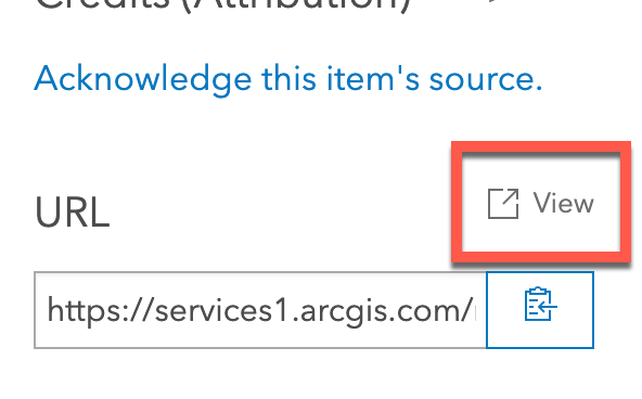

In ArcGIS Online, open the Storm Damage feature layer. From the Overview tab, scroll to the bottom of the right-hand menu to access the REST API URL. Click View to open a new tab containing the Storm_Damage "FeatureServer".
 AGOL View Feature Server
If you receive an Invalid Token error, go back and refresh the page or try logging out out of ArcGIS Online and back in.

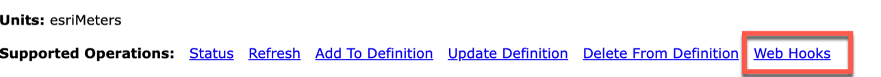

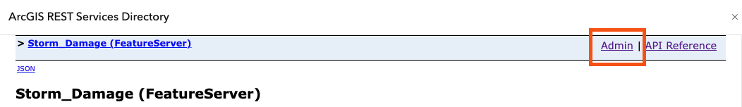

To access the Feature Server Admin REST Services Directory from a browser, click Admin. If you don't see Admin make sure you are in a role that has access, like the ArcGIS Online Publisher role.
Scroll to the bottom of the page and click Web Hooks from the list of Supported Operations.
AGOL Web Hooks Operation
Click Create.

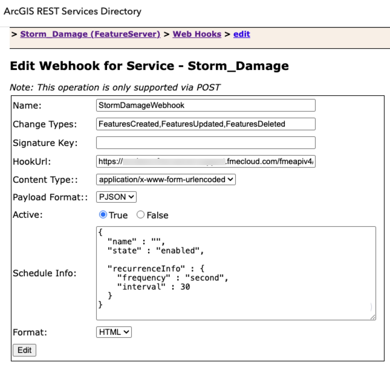

3. Create the Webhook
  • Name: Name the webhook.
  • Change Types: specify what kind of feature layer changes will send messages to our FME Flow Automation. For this article, we will only handle new points, but we’ll enter FeaturesCreated, FeaturesUpdated, FeaturesDeleted, in case you wish to process the other events later. The ArcGISOnlineWebhookDataGetter used later in this article can process all three types of events. Note: Many types of events can send messages to an FME Flow Automation. Review “Trigger event values” in the Esri documentation for all available options.
  • Signature Key: can be left empty
  • HookUrl: Copy the Webhook URL from the FME Flow Webhook Trigger.
  • Payload Format: PJSON (“Pretty JSON”, for better readability).
  • Active: True
  • Schedule Info: can be left as default. Keep in mind that the “interval” key is set to 30. This interval setting hints that our webhook isn’t quite real-time. Instead, ArcGIS Online polls our Feature Layer for changes every 30 seconds. Feel free to increase the polling rate if it’s not critical to get updates ASAP.
  • Format: HTML

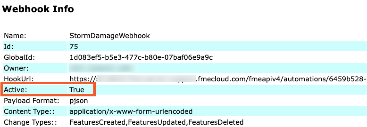

Click the Create button. The webhook is created. Click the webhook's ID to confirm this.

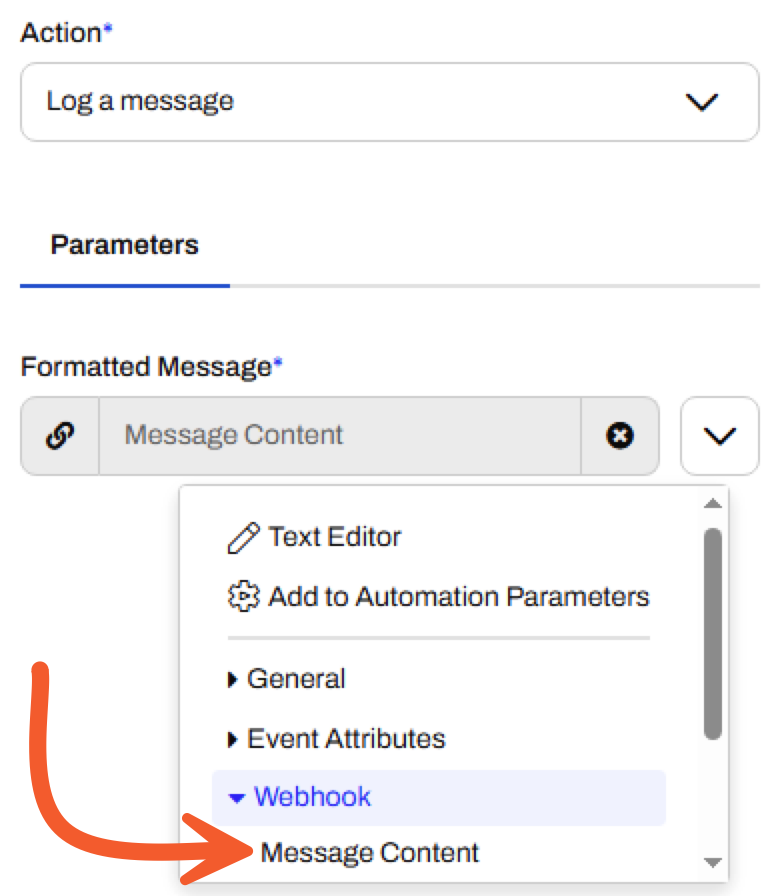

Let’s test the webhook. In the FME Flow Automation, add an Action, connect it to the Trigger’s Action Succeeded port, and then set the Action to Log a message.
Open the drop-down menu next to Formatted Message, expand Webhook, select Message Content, and then click Apply. This will log the entire webhook result message.
Start the Automation in Debug mode.

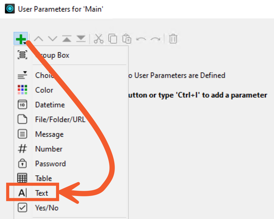

Open a blank workspace in FME Workbench. Save the workspace as StormDamage.fmw. In the Navigator, right-click User Parameters and select Manage User Parameters. Click the Insert button and choose Text.
On the right-hand side of the Parameter Manager, enter the following parameter properties:
  • Parameter Identifier: webhook_message
  • Label: Webhook Message
  • Required: Disabled
  • Visibility: Always Show
  • Default Value: Paste the webhook message from the Automation’s log file, from “payload=[“ to the closing square bracket (see Part 2, Step 5). This will be used for testing our workspace.

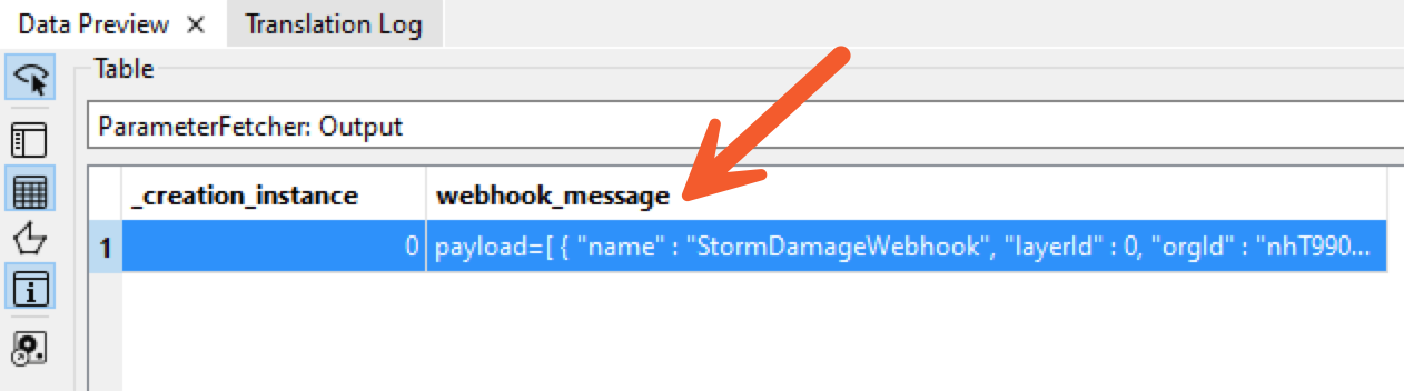

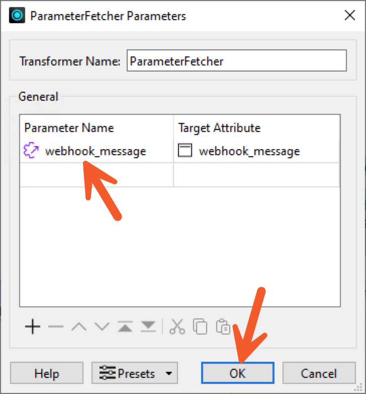

We can grab the webhook message using the ParameterFetcher transformer. Attach a ParameterFetcher transformer to the Creator.
Open the ParameterFetcher parameters. For the Parameter Name, open the drop-down menu and select the webhook_message user parameter that we just created. Name the Target Attribute webhook_message. Click OK.
Run the workspace with data caching enabled and inspect the ParameterFetcher output. A new webhook_message attribute has been created with the response text we pasted into the webhook_message’s default value.

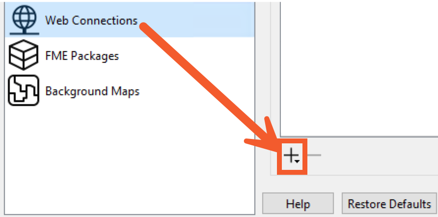

3. Create an ArcGIS Online Web Connection
If you have not created an ArcGIS Online Web Connection before, please follow one of the articles below to create it, depending on your preferred method (OAuth 2.0 or Token):
Please read Web Connections and FME to learn more about the different types of web connections in FME.

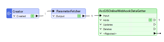

Add the ArcGISOnlineWebhookDataGetter to the canvas. It is a custom transformer from the FME Hub and will accept the ArcGIS Online webhook message as input. Connect the ParameterFetcher to the ArcGISOnlineWebhookDataGetter and open the parameters.
For the Webhook Response Message, choose the webhook_message attribute. From the Web Connection drop-down list, choose your ArcGIS Online Web Connection.
Click OK and run the workspace.

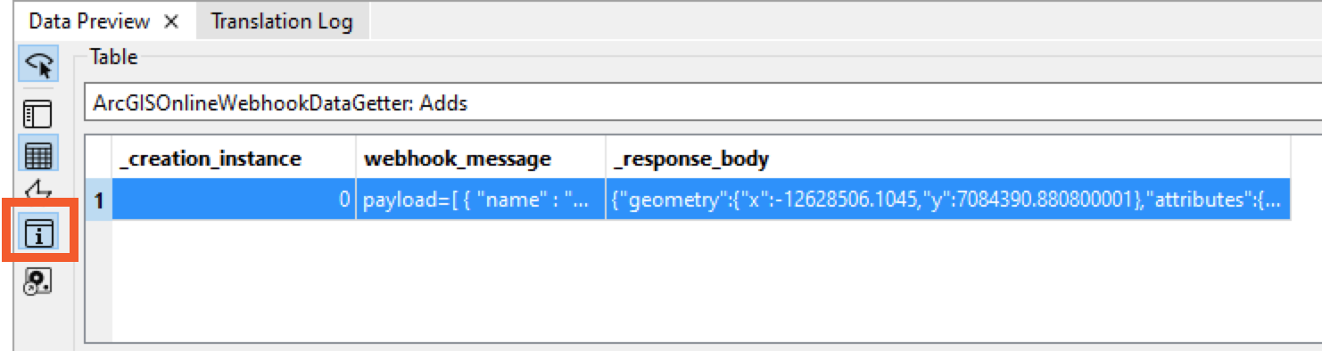

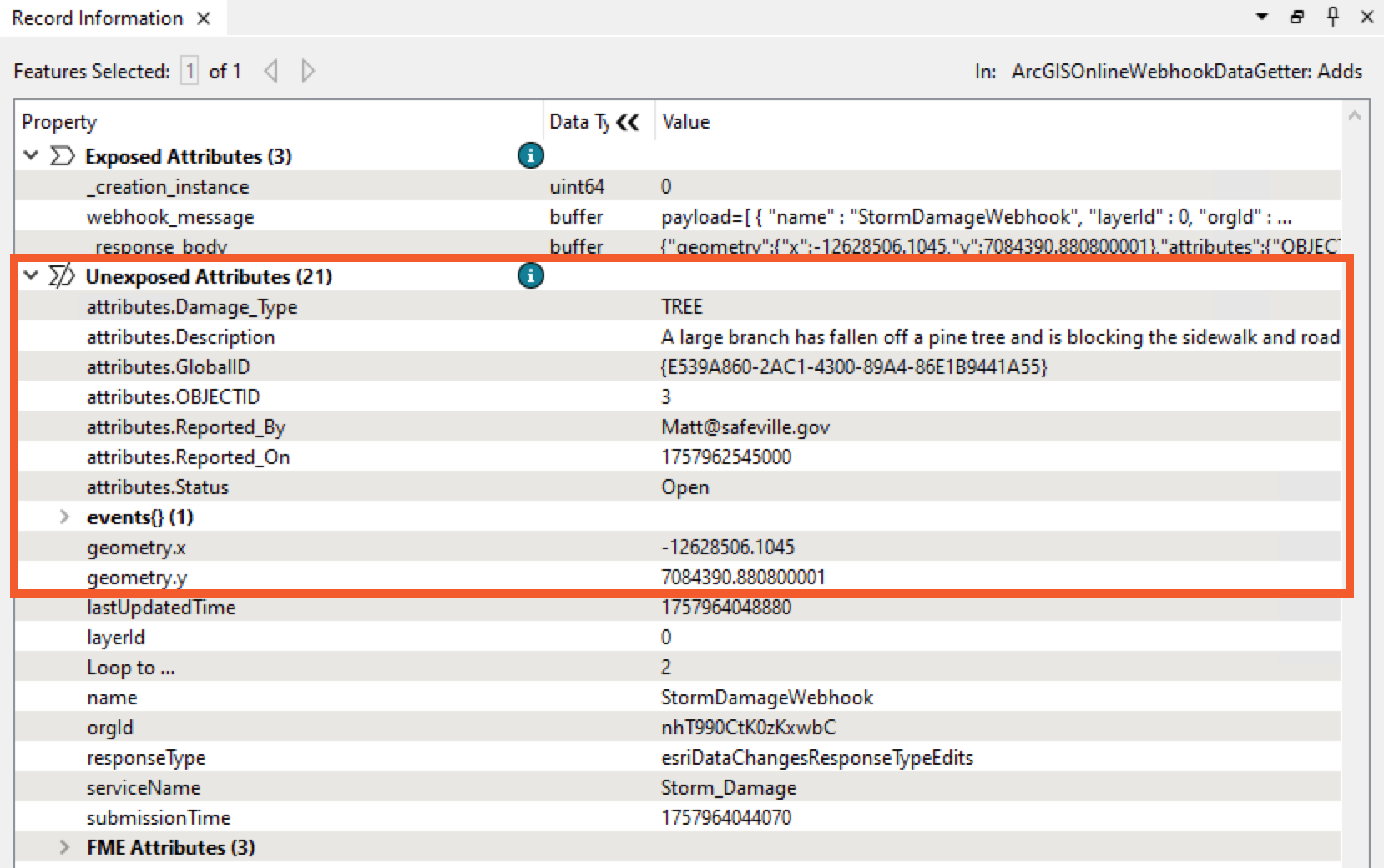

Inspect the ArcGISOnlineWebhookDataGetter output in Data Preview. There is now a _response_body attribute with the test form submission data. To take a closer look, double-click the _response_body value and format as JSON.
The ArcGISOnlineWebhookDataGetter has retrieved the feature attributes and point geometry for us as JSON. We could parse this to create the point feature, but first, let’s take a look at the Record Information in Data Preview. Turn on Record Information if it is not currently visible:
In the Record Information, we see that the ArcGISOnlineWebhookDataGetter has output all of the attributes we need in addition to the JSON, they just need to be exposed. The attributes from each JSON key - attributes and geometry - are prefaced with the name of the key.
5. Expose the Attributes and Create a Point Geometry

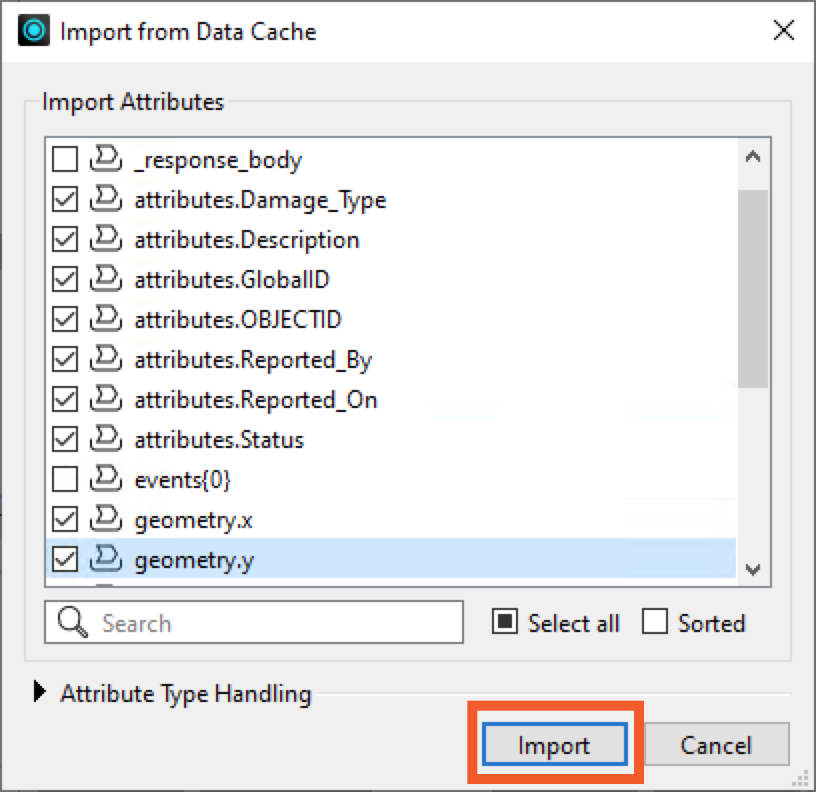

Add an AttributeExposer to the canvas and connect it to the Adds port of the ArcGISOnlineWebhookDataGetter. Open the parameters and click Import > From Data Cache…:

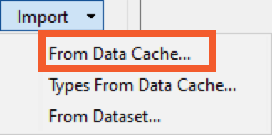

Check off all of the attributes that are prefaced by attributes and geometry, except for geometry.m, and then click Import.
The attributes are imported. Click OK.

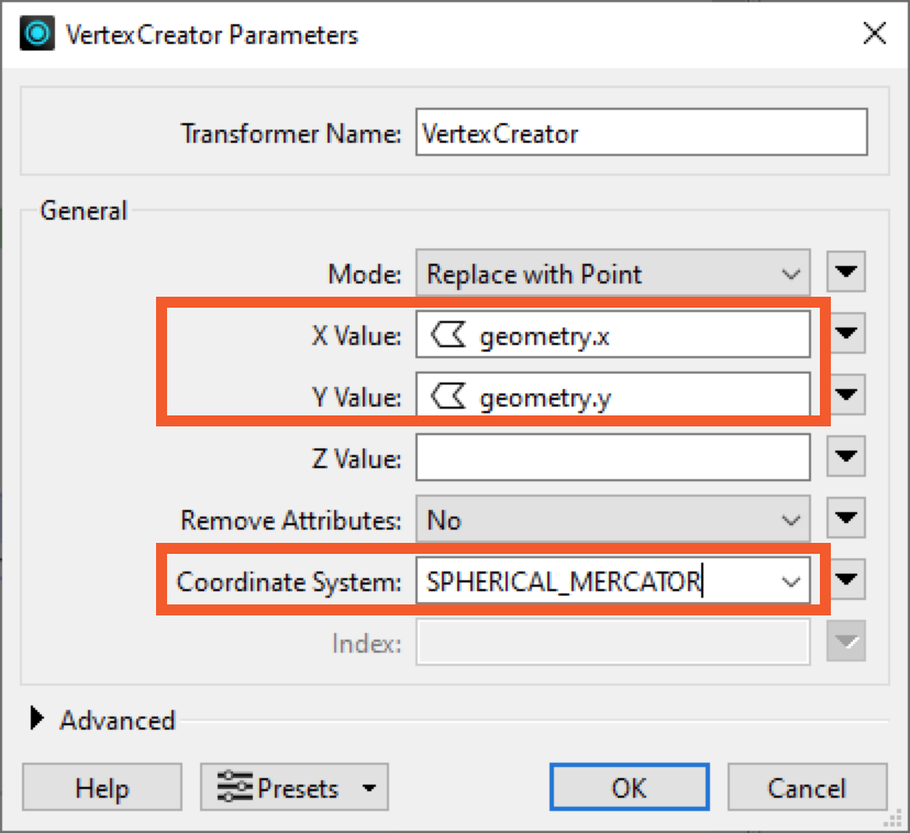

A point geometry needs to be created from the coordinates. Add a VertexCreator to the canvas and connect it to the AttributeExposer. Open the parameters and set the x and y values to the geometry.x and geometry.y attributes.
You may have noticed when we inspected the _response_body JSON earlier that the geometry key contained no spatial reference, just coordinates. ArcGIS Online uses the coordinate system from the basemap, which is WGS84 Web Mercator, by default, otherwise known as Spherical Mercator. We need to manually set the coordinate system, since FME doesn’t have enough information just from coordinates to determine it for us.
Run the workspace and examine the results in Data Preview. We now have a point feature with valid geometry and attributes.

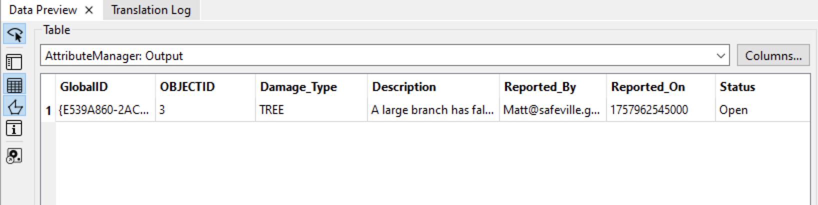

7. Clean up attributes
Time to tidy up some attributes. The period in the attribute names makes them long and may be problematic when writing data. Add a BulkAttributeRenamer to the canvas after the CoordinateSystemSetter. In the parameters, set the Action to Remove Prefix String and then set the String to “attributes.”.
Add an AttributeManager. Remove the following attributes:
  • _creation_instance
  • webhook_message
  • _reponse_body
  • geometry.x
  • geometry.y
Reorder the Output Attributes so that the GlobalID and OBJECTID are first and second.
AttributeManager
Run the workspace and inspect the AttributeManager output in Data Preview. The attributes are much cleaner now.

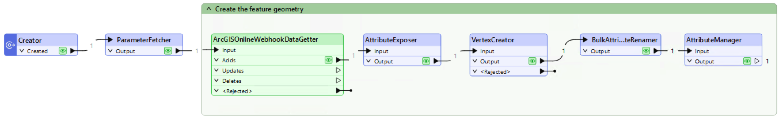

Create a bookmark around all of the transformers added so far, except for the Creator and ParameterFetcher. Name it "Create feature geometry". At this point, your workspace should look like this:

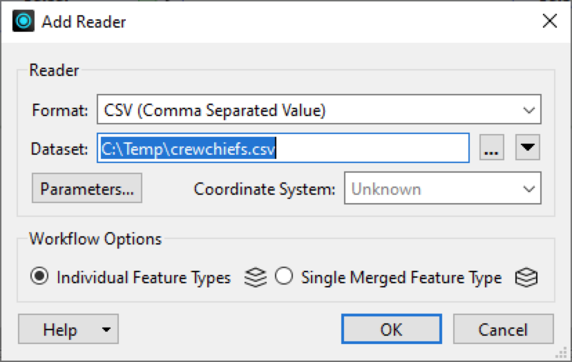

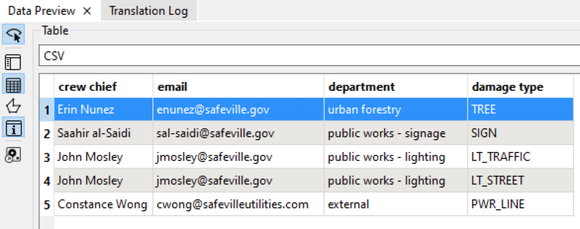

For demonstration purposes, our crew chiefs are in a .csv file found at the top of this article under Files. Download the crewchiefs.csv file and add a new reader to the canvas. Set the format to CSV and the dataset to the crewchiefs.csv file. Click OK.
Note that a new user parameter was automatically generated named "SourceDataset_CSV2". This will be used in our Automation to set the input source in the FME Flow shared resources.
Run the CSV reader to build the data cache. Inspect the results - there are five records, each listing the crew chief, their department and the type of damage their department is responsible for.

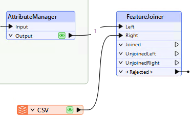

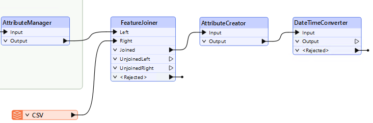

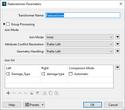

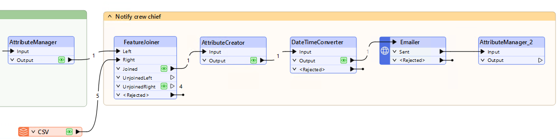

Let’s join the crew chief data to our point feature. Add a FeatureJoiner to the canvas. Connect the CSV Reader to the Right input and the AttributeManager to the left input.
Open the FeatureJoiner parameters. Under Join On, join the Damage_Type from the Field Maps feature to damage type in the CSV file. Click OK.
Run the workspace and inspect the Joined output. The information for the responsible crew chief has been added to the feature.

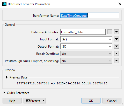

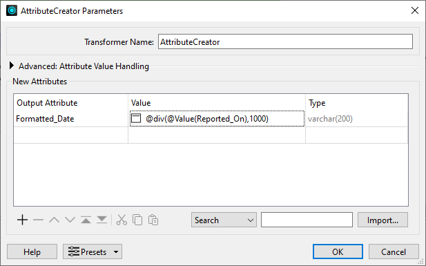

2. Convert the Reported Date
Now that we know who to notify, we can send an email with the information from the Storm Damage FIeld Map feature. Except, there’s a problem, you may have noticed that the Reported_On date is a long number, instead of a readable date. This will not make much sense to the crew chief.

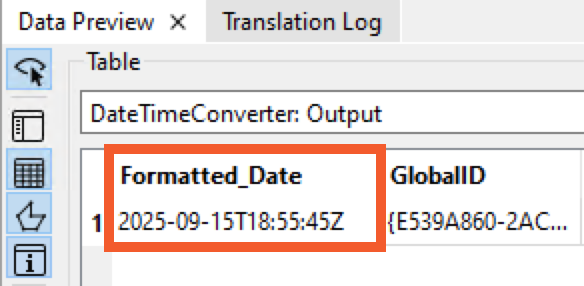

ArcGIS Online stores datetimes in an integer format called Epoch (or UNIX). We can convert this format to a readable format in FME using a DateTimeConverter. But, if we try to do this with the Reported_On number as-is, we’ll get this error:
Date Error
The datetime returned from ArcGIS Online has milliseconds.
Add an AttributeCreator and connect it to the Joined output port of the FeatureJoiner.
Open the parameters. Create a new attribute named Formatted_Date. For the Attribute Value, we’ll use a FME Math Function: click the ellipses (...) to display the Text Editor. Scroll down the function list and find the Math Functions. From the list of Math Functions, double-click div. Enter @div(@Value(Reported_On),1000) to divide the date integer by 1000 and convert the milliseconds to seconds. Click OK on the Text Editor and OK on the AttributeCreator.
Now the date can be converted by FME. Add a DateTimeConverter and connect it to the AttributeCreator.
Enter the following parameters in the DateTimeConverter:
  • Datetime Attributes: Formatted_Date
  • Input Format: %s$ (Epoch Time)
  • Output Format: ISO
Please note: the ISO Output Format displays a Z on the end of the time, for Zulu. This is because the date is in UTC time, which is synonymous with Zulu time. For the scope of this article, we won’t format the date any further, but please read Handling Local Timezones, UTC, Daylight Savings Time, and Leap Units if you’d like to learn more.
Run the workspace and inspect the DateTimeConverter output. There is now a Formatted_Date we can include in our email.

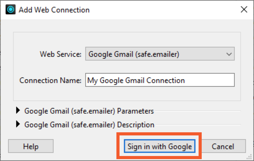

Before we can send the notification email to the crew chief, we need an email service. For simplicity, we’ll use Gmail and the template web service, which uses an OAuth client registration provided by Safe. In a production environment, you would want to register your own client with Google (Google documentation) and create an OAuth 2.0 web service and connection in FME with your own Client ID.
Create a new Google Gmail web connection by clicking Tools/Utilities >  FME Options. In the Options menu, click Web Connections, and then add a New Connection.
Choose Google Gmail (safe.emailer) as the Web Service. Give the connection a name and click Sign in with Google. You will be prompted to enter your Gmail credentials.
Once authenticated, the connection has been created.

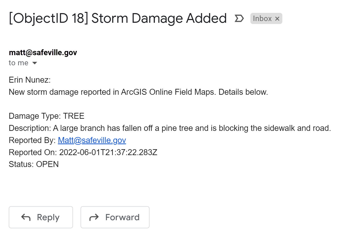

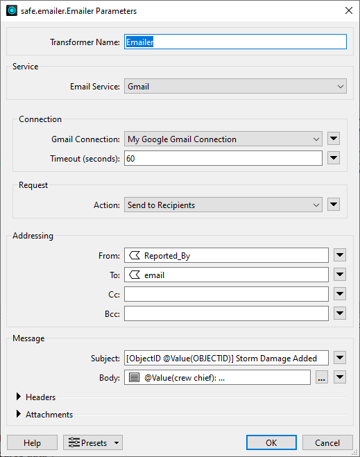

Return to the canvas and add an Emailer transformer. Connect it to the DateTimeConverter. In the Emailer transformer parameters, enter:
  • Email Service: Gmail
  • Gmail Connection: the Gmail Web Connection name you just setup
  • From: Reported_By
  • To: the email attribute (this is the crew chief’s email address from the csv file)
  • Subject: [ObjectID @Value(OBJECTID)] Storm Damage Added
  • Body: click the ellipses (...) next to Body and enter:
    @Value(crew chief):
    New storm damage reported in ArcGIS Online Field Maps. Details below.
    Damage Type: @Value(Damage_Type)
    Description: @Value(Description)
    Reported By: @Value(Reported_By)
    Reported On: @Value(Formatted_Date)
    Status: @Value(Status)
Click OK.
Before running the workspace to test this, replace the fake crew chief email address in the crewcheifs.csv file with your own email address for the damage type you entered in your Field Maps test record. Run the workspace and check your email in a minute or two for the notification email.
Sample Email

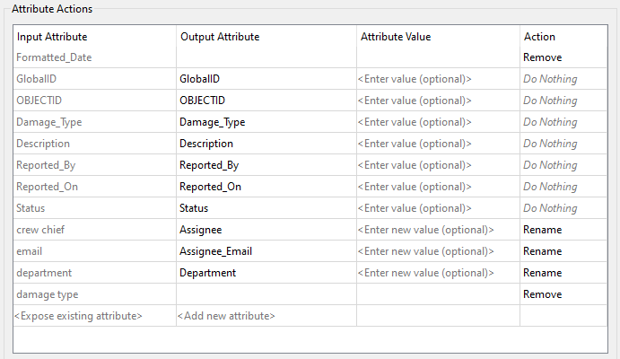

Let’s clean up attributes before writing out to the database. Add another AttributeManager and connect it to the Emailer. Remove and Rename fields as follows:
  • Formatted_Date: remove (this was only needed for the email)
  • crew chief: Assignee
  • email: Assignee_Email
  • department: Department
  • damage type: remove
AttributeManager
Note: SpatiaLite doesn’t have a datetime datatype. It supports storing Epoch Dates as integers, which is the format of the Reported_On field, so we can write it to the database. It is also helpful to store it this way if we need to read from our database and write back to ArcGIS Online, since it will expect an Epoch Date.
Add a bookmark around the transformers from the FeatureJoiner to the AttributeManger_2 and name it “Notify crew chief”.

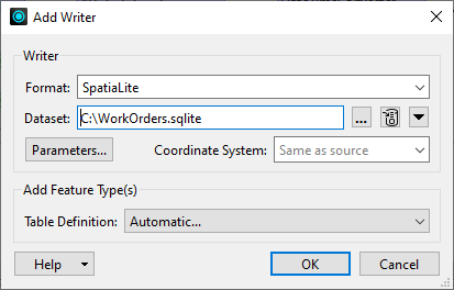

5. Write to Spatialite Work Order Database

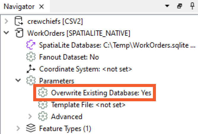

All we have left to do now in this workspace is write the record to the SpatiaLite Work Order Database. So that the crew chief can take further action, reassign the work and eventually close the work order. In the real world, this would likely be a different system, like a solution from a different vendor, with much more detail.

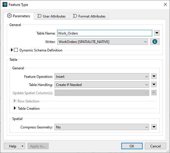

Add a new writer to the canvas. Choose SpatiaLite as the Format, provide an output destination, name the database "WorkOrders," and set the Table Definition to Automatic. Leave the coordinate system as Same as source. Click OK.
In the writer feature type parameters, name the table "Work_Orders". Ensure that the Feature Operation is set to Insert and Table Handling to Create If Needed. Click OK.
Note that a new user parameter was automatically generated named "DestDataset_SPATIALITE_NATIVE". This will be used in our Automation to set the output destination in the FME Flow shared resources.
Connect the AttributeManager_2 to the SpatiaLite writer, and run the workspace. View the output data to verify that it was written as expected.

You may also want to replace the other fake email addresses in the crewchiefs.csv file with your own email for testing purposes.

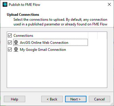

In FME Workbench, click Publish to connect to your FME Flow.
Choose a repository to upload the workspace to (or create a new repository).
We also want to upload the SpatiaLite database and crewchiefs file. Click Select Files and then Add Files. Navigate to your SpatiaLite database and crewchiefs csv file and select them. Then click Select Location. Choose to upload to a shared resource folder. Creating a new folder within Data on FME Flow is advisable. Click OK and Next.
In the next window, select both your ArcGIS Online and Google Gmail web connections to upload them to FME Flow.
Click Next again and upload the Emailer package.
For services, select Job Submitter and click Publish. Check the Translation Log to make sure everything was published to FME Flow successfully.

Connect the Log Action to the Webhook Trigger’s Action Failed Port, instead of the Action Succeeded port. Add a new Action to the canvas and connect the Webhook Trigger’s Action Succeeded port to it.

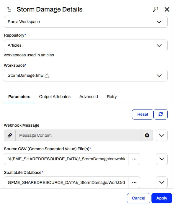

Open the Action and set it to Run a workspace. Choose the repository where your StormDamage.fmw workspace was published. You will notice that the Webhook Message field is already filled in. This is the test payload that we used in our workspace’s user parameter default value, but we want the message content instead. Open the drop-down menu, expand the Webhook Keys, and select message content.
For the SpatiaLite Database parameter, click the ellipses and navigate to the database file that you uploaded to FME Flow. Select it, click OK. The crewchiefs.csv file should already have the correct path, but if not, you may need to do the same for it. Click Apply.
Your ArcGIS Online Field Maps webhook Automation is complete and ready to receive submissions!
