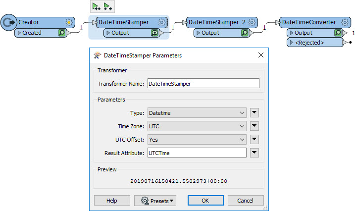

To create a new time stamp the DateTimeStamper transformer is the one to use. There is a parameter to choose whether you require local time or UTC, and another to denote that the time zone offset is required.
Here a user records the current date in UTC. A second DateTimeStamper records the current datetime in the local timezone:
The DateTimeConverter is used to convert the results to a more human-readable format. The output looks like this:
It's easy to see that the difference between local and UTC time matches the offset difference (7 hours).

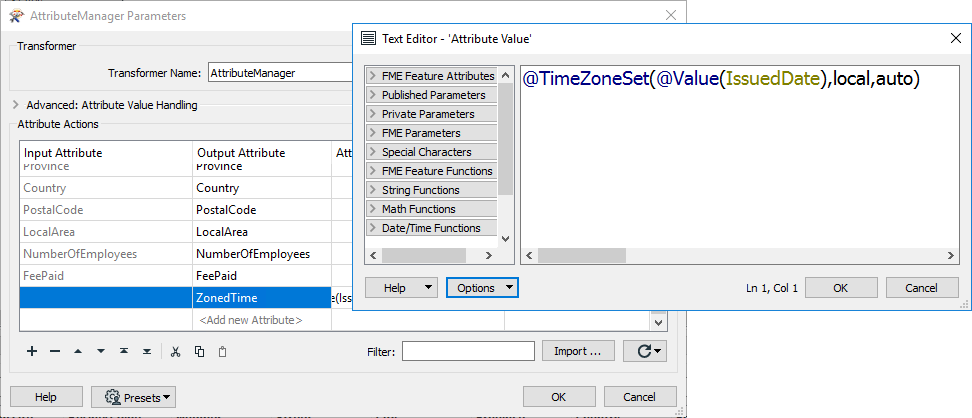

The user wishes to add a time zone to their records. Because there is no specific transformer to carry out this operation, the user must make use of an FME DateTime function.
The user places an AttributeManager transformer to create a new attribute called ZonedTime:
In the Text Editor dialog the user has entered the following content:
@TimeZoneSet(@Value(IssuedDate),local,auto)
The TimeZoneSet function sets the timezone on the IssuedDate attribute. The "local" argument tells FME that this data is in the user's (or their computer's) local timezone.
Where time zone has been added to the date as a UTC offset. Also notice that the datetime has been converted to FME format. A DateTimeConverter can be used to convert back to the prior format.

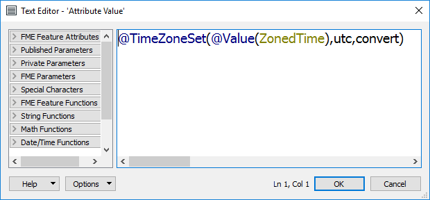

The user places an AttributeManager transformer to create a new attribute called UTCTime and opens the Text Editor dialog:
In the Text Editor dialog, the user has entered the following content:
@TimeZoneSet(@Value(ZonedTime),utc,convert)
The TimeZoneSet function sets the timezone on the IssuedDate attribute. The "utc" and "convert" arguments tell FME that this data should be converted to UTC.
Notice that the offset has been resolved by subtracting it from the zoned time.
Note that daylight savings time differences are taken into account when converting zones in this way. FME has a large database of daylight saving and time zone information that is updated annually, and it will consult this when making the conversion. It will know (for example) that 19900331153143 UTC (15:31 on March 31st, 1990) was before daylight savings started for that year, and that the Canada-Central equivalent is 19900331093143-06:00 (09:31-06:00); whereas 19900401153143 UTC (15:31 on April 1st, 1990) was after daylight savings, so the Canada-Central equivalent is 19900401103143-05:00 (10:31-05:00).

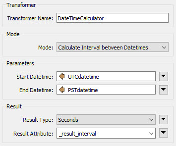

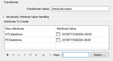

Here a user has two dates. They are being created in an AttributeCreator transformer, but could just have easily been read from a source dataset:
One datetime (16:43pm) is in UTC time. Another (08:42am) is in PST (Pacific) time. A DateTimeCalculator transformer is set up to calculate the interval between the two datetimes:
The resulting interval is just 60 seconds. Although the difference between times (16:43 and 08:42) is eight hours and one minute, the DateTimeCalculator takes the eight hour time difference (UTC offset) into account. The result is that in reality, just 60-seconds separates the two datetime values.
Variations
In the above example, if both datetimes were unzoned (i.e. lacking an offset) then the time difference would be 28,860 seconds. That's because, if no time zones are defined, then no time zone offsets are applied.
If only one datetime was unzoned (for example, one is PST, and the other is unknown), then the feature would be rejected. FME will not assume that both attributes fall in the same time zone. The interval attribute on the rejected feature will be set to <null>.
The order of the attributes in the DateTimeCalculator is important. In this example, if the UTC date is defined as the Start Datetime, then the difference is -60 seconds. If the PST date is defined as the Start Datetime, then the difference is (+)60 seconds.
The FME DateTime function equivalent to the DateTimeCalculator transformer's Interval mode is @DateTimeDiff()

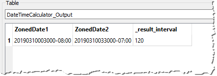

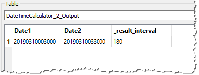

Datetime Arithmetic with DST Applied
Datetime arithmetic can be carried out with FME, but what happens when one date is within daylight savings time, but the other date isn't?
Here, a user has two dates. They are being created in an AttributeCreator transformer, but could just easily have been read from a source dataset:
Both datetimes exist in the Pacific time zone, although neither has the UTC offset applied. Both dates are 10th March 2019. One time is 00:30am and the other is 03:30am.
It's easy to think that the difference between the two times is three hours (180 minutes), and the DateTimeCalculator at first confirms that:
However, daylight savings time began at 02:00am that day, at which point clocks would be turned forward one hour. That means the actual time difference is only two hours (120 minutes).
So, when a UTC offset is applied to these datetimes (using the TimeZoneSet function as described above) then daylight savings time is taken into account to give the correct result:
The output even shows that the UTC offset is different for each datetime.
In short, as long as a UTC offset is available, then daylight savings time is taken into account during any arithmetic operations.

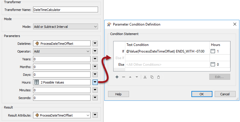

Here, an FME user is examining records from a log of when an overnight FME process started:
They use an AttributeManager to add the UTC offset to the original datetimes. The datetimes that occurred in the summer months have a different offset because of daylight saving time.
However, the user suspects that the task scheduler used to start the process ignored daylight savings time and ran the process at 11:00pm standard time all year round. This means that the process logs are incorrect for the summer months. The datetimes need an hour added to them.
They set up a DateTimeCalculator -using a Conditional parameter - to add one hour to the datetime where the offset ends in "-07:00":

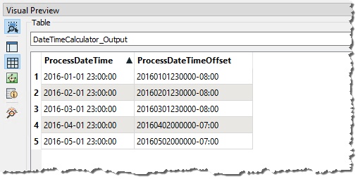

Now the output shows an hour added to those specific datetimes:
Of particular note is that, because the additional hour moved the time to midnight, the date also rolled over; for example, the date used to be 2016-04-01 but is now 2016-04-02.

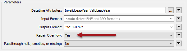

The DateTimeConverter transformer has a parameter called Repair Overflow. Invalid leap year dates can be corrected by setting this parameter to Yes.

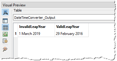

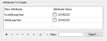

Here, a user has two dates. One is a valid leap year date (2016-02-29), and the other is not (2019-02-29):
The user converts the format of these dates, using the Repair Overflow option:
The result is that the invalid date is counted as an "overflow" and rolls over to the next valid date:
Variations
A leap second (23:59:60) can also be rolled over to its next valid time if desired, which would be 00:00:00
The FME DateTime functions equivalent to the DateTimeConverter transformer are @DateTimeCast(), @DateTimeFormat(), and @DateTimeParse().
Example
Follow these steps to try the attached example.
Open the workspace, ensure Feature Caching is active, and press the Run button.
Inspect the cached results to prove the repair works.
Try turning off the repair option to see what the result is. Also, experiment with varying the input dates; for example, what happens if you try 20190231 (31st February)?

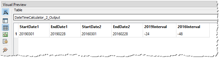

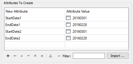

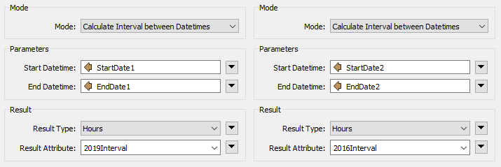

This user has four dates:
Both sets of start and end dates cover the range February 28th to March 1st. However, one range is 2016 (a leap year), and the other is 2019 (not a leap year).
The user calculates the interval between each set of dates - in hours - using the DateTimeCalculator transformer:
For 2019 the difference is returned as 24 hours. For 2016 the leap year has been taken into account, and the difference is returned as 48 hours:
Variations
FME won't calculate time intervals using leap seconds in the same way; i.e. 23:59:59 to 00:00:00 is always one second only, even if a leap second occurred in between. This is for two reasons: partly because there is no standard method to handle leap seconds, but mostly because leap seconds occur simultaneously across the globe, and so are at different times of the day in different locations! For example (thank you Wikipedia), the leap second on December 31, 2005 23:59:60 UTC occurred December 31, 2005 18:59:60 in the US Eastern time zone.
Example
Inspect the cached results to prove the calculation works.
Experiment with different dates to prove (for example) that February 28th 2016 to February 28th 2017 returns an interval of 366 days.
