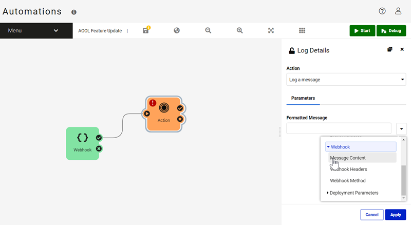

Configure the Trigger to Webhook-Triggered, then select Apply. Attach a Log a Message Action to the Action Succeeded port (the check mark) of the Trigger.
Click the drop-down menu next to the Formatted Message parameter. From the Webhook drop-down, select Message Content. This lets us view the message we receive from our ArcGIS Online Feature Service in our Automation Log.

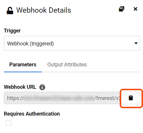

2. Get the Webhook URL
Save the Automation and name it (E.g., “PlantMapping”). Once saved, double-click the Webhook trigger to reopen its Details. Copy the new Webhook URL to your clipboard. Later in the tutorial, this URL will connect our Automation to the ArcGIS Online Feature Service.

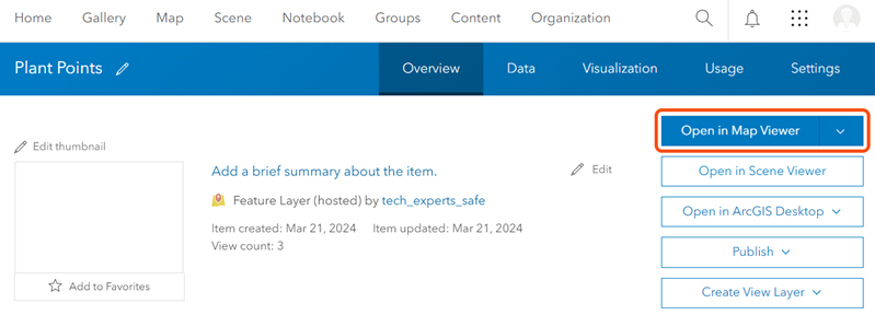

3. Create a Hosted Feature Layer for Editing
From your browser, navigate to ArcGIS Online. Select New Item to create a new Feature layer (or proceed with an existing layer from Step 4).

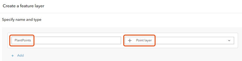

Select Define your own layer. Next, create a Point layer named “PlantPoints”.
Finally, add any relevant tags and save. The PlantPoints feature layer Overview page will automatically open.

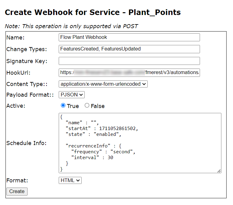

Click Create to set up the webhook for the Feature Service.
Name the webhook.
Change Type specifies which types of feature layer changes will trigger messages to our FME Flow Automation. To send messages about new or edited points on our plant layer, we will enter “FeaturesCreated” and “FeaturesUpdated”.
TIP: Many types of events can send messages to an FME Flow Automation. Review “trigger event values” in the Esri documentation for all available options.
In the Hook URL, paste the URL we copied from our FME Flow Automation Webhook Trigger in Step 2.
Payload Format can be PJSON (“Pretty JSON”, for better readability).You can leave
Schedule Info at the default. Keep in mind that the “interval” key is set to 30. This interval setting hints that our webhook isn’t quite real-time. Instead, ArcGIS Online polls our Feature Layer for changes every 30 seconds. Feel free to increase the polling rate if you don’t need updates ASAP.

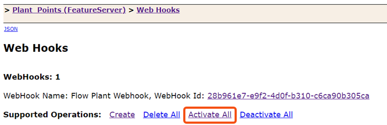

Select Create. From the Webhooks page, select Activate All (leave the default Format as “HTML”).

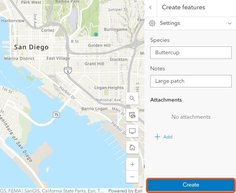

From the Create Features menu, select New Feature. Click anywhere on the map to add a new feature. Add some relevant notes. Selecting the Create button completes the edit, saves the new feature to the Plant Points Feature Service, and sends a webhook message to our FME Flow Automation, as will any subsequent edits.
