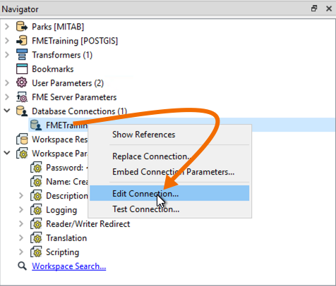

Open the CreateDowntownParks.fmwt workspace in FME Workbench and update the Database Connection. To do this, expand Database Connections in the Navigator pane, then right-click FMETraining. Select Edit connection, then update the credentials to your credentials. If you are using the default FMETraining database, you will only need to update your password.

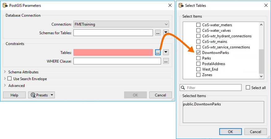

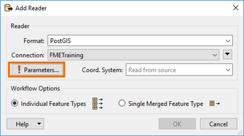

Open a blank workspace in FME Workbench, then add a PostGIS reader. Set the Connection to FMETraining and then open the parameters.
In the parameters, click on the ellipsis next to Tables and then select the DowntownParks table. Click OK three times to finish adding the reader to the canvas.

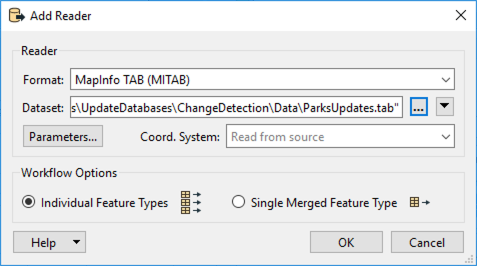

Next, add a MapInfo TAB (MITAB) reader to the canvas and browse to the ParkUpdates.tab dataset. Click OK to add the reader to the canvas.

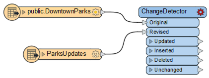

4. Add ChangeDetector Transformer

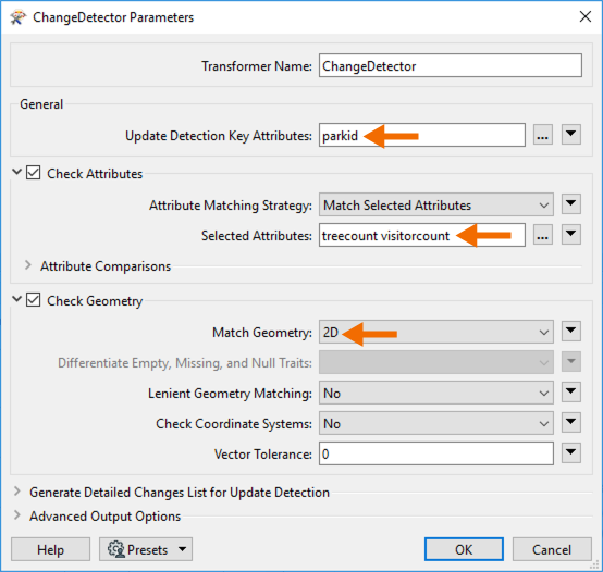

We will use the ChangeDetector transformer to determine the changes between the two datasets. The ChangeDetector creates an attribute called fme_db_operation and, based on the output port, assigns it a value of either UPDATE, INSERT, DELETE, or, if the feature is unchanged, no attribute is created.

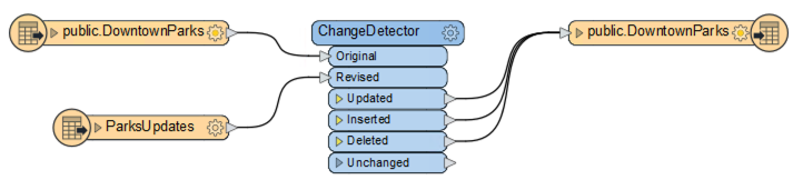

Add a ChangeDetector to the canvas and connect the Original input port to the public.DowntownParks reader feature type and the Revised input port to the ParksUpdates reader feature type.
In the parameters, set the following:
  • General:
    • Update Detection Key Attributes: parkid
  • Check Attributes: enabled
    • Selected Attributes: treecount visitorcount
      • Click on the ellipses to open a list of attributes or copy and paste the attributes above
  • Check Geometry: enabled
    • Match Geometry: 2D
Click OK.

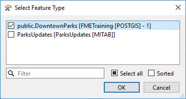

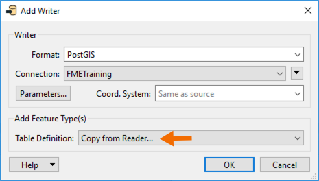

Add a PostGIS writer to the canvas and set the connection to FMETraining. Set the Table Definition to Copy from Reader.
In the Select Feature Type dialog, select public.DowntownParks [POSTGIS] as the reader to copy from. Since we are writing to the same table we are reading from, this method works. If you were writing to a different table that was not already in the workspace, use the Import from Dataset Table Definition when adding the reader.

Connect the public.DowntownParks writer feature type to the Updated, Inserted, and Deleted output ports on the ChangeDetector. Do not connect it to the Unchanged output port; otherwise, duplicate features will be added to the database.

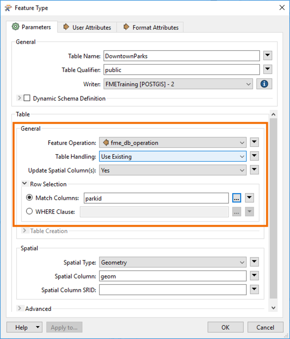

Open the public.DowntownParks writer feature type parameters. Set the Feature Operation to fme_db_operation and ensure that Table Handling is set to Use Existing. Set parkid as the Match Column, then click OK.

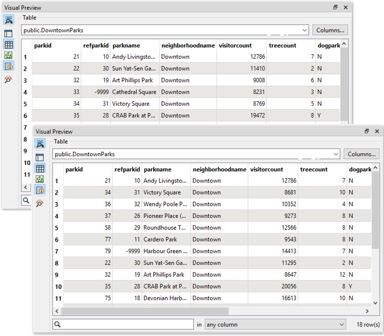

Before running the workspace, inspect the current contents of the DowntownParks table. Make a note of the visitorcount and treecount fields for several records. This will ensure we can compare the results to confirm the update process was successful. Note, if you completed Updating Databases: Filtering Features to set Database Update Operation Type, your numbers will be slightly different, as that tutorial removed Portal Park and doubled the tree count.
