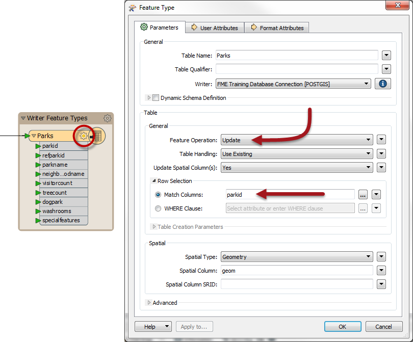

Updating records with a harmonized format is done through the Feature Type (Table) parameters dialog. In basic cases, updates are done with the primary key field:
The user changes the Feature Operation parameter to Update, and in the Match Columns parameter selects the attribute that defines the key in the incoming data.
When run, each feature will overwrite a database record, where its key attribute value matches the database key column.

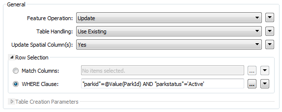

An alternative is to use the WHERE Clause parameter:
Here, the user carries out the same update on "parkid", but only where the record status field is 'Active'

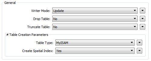

Non-harmonized formats have no consistent interface. Some - like this MySQL writer - have a Writer Mode parameter:

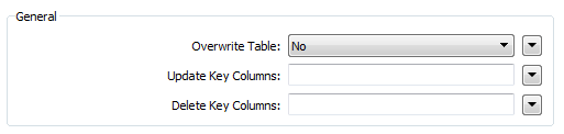

Others - like this DB2 writer - do not:

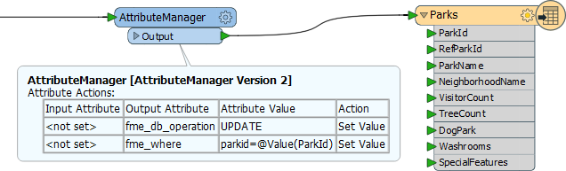

As with harmonized formats, the operation to carry out for each record is defined in an attribute called fme_db_operation, with a value of either INSERT, DELETE, or UPDATE. If all features are to be updated, then all features should be assigned an fme_db_operation value of UPDATE, using a transformer such as the AttributeManager.
The Update Column/Where Clause is similarly inconsistent. The above screenshots also show that the MySQL table has no Update Column parameter, whereas the DB2 table does.
They both support defining this information using an attribute called fme_where:
Here, for example, the user writes to a MySQL database. Features are set to be updated, with the update happening where parkid (the database field) matches ParkId (the feature attribute).
