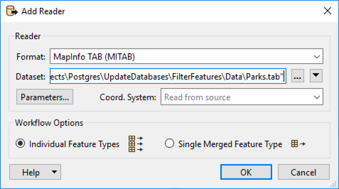

Start FME Workbench and create a blank workspace. Add a MapInfo TAB (MITAB) reader to the canvas and browse to the Parks.tab dataset that is available to download from the Files section of this article.

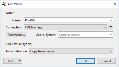

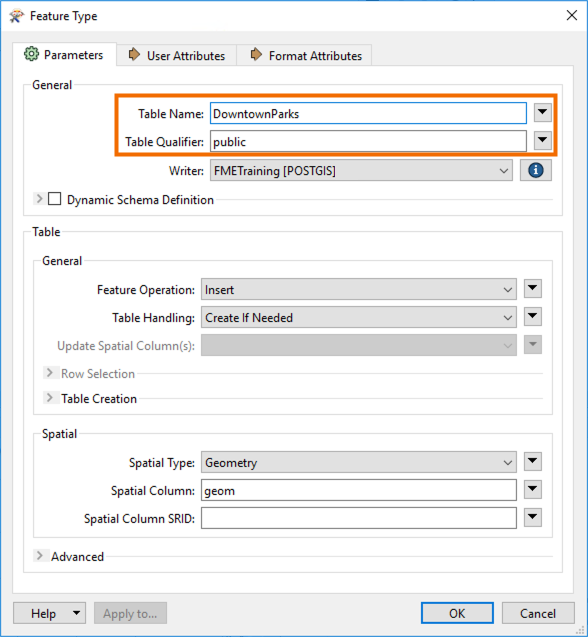

Let's create a new table in the FMETraining database for the Downtown Parks only. Add a PostGIS writer to the canvas and connect to the FMETraining database. Leave the Table Definition to Copy from Reader, then click OK.
Connect the writer feature type to the Tester Passed output port, and then open the writer feature type parameters.
In the PostGIS writer parameters, set the Table Name to DowntownParks, then the Table Qualifier to public.
Since this is a new table, we’ll leave the Feature Operation to Insert and the Table Handling to Create if Needed. Click Ok.

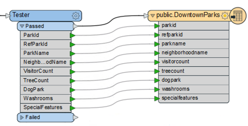

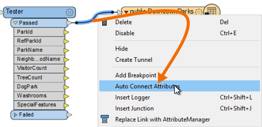

Since PostGIS defaults to lowercase attribute names, we need to map our attributes to match the MapInfo TAB dataset's CamelCase attribute names. You can tell that these attributes are not mapped correctly because the arrow is next to public.DowntownParks is red. If you click on this arrow to expand the attribute names, you can see that all of them have a red arrow. Expand the Tester attributes to see the CamelCase names.
To fix this, right-click on the connection line between the Tester and writer feature type and select Auto Connect Attributes.
All of the attributes should now have a green arrow beside them, indicating they were mapped correctly.

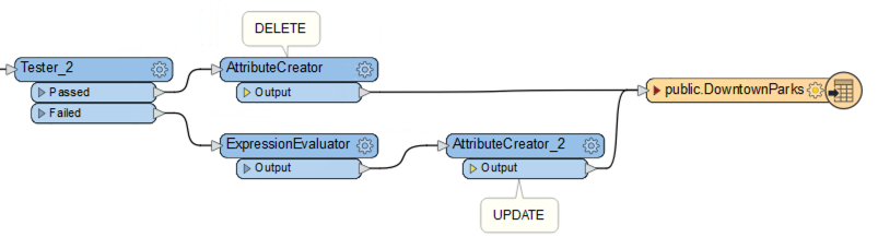

Firstly, disconnect the writer feature type from the workflow, and then add a second Tester transformer. Connect the Tester_2 to the Passed output port on the Tester.

This separates the data into records that should be deleted (Tester_2 Passed) and records requiring updates (Tester_2 Failed).

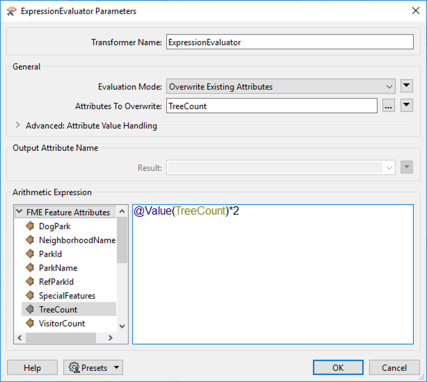

Connect an ExpressionEvaluator transformer to the Tester_2 Failed output port. Set the Evaluation Mode parameter to Overwrite Existing Attributes and select TreeCount as the attribute to update.
Set the Arithmetic Expression to: @Value(TreeCount)*2

Because there are multiple, mixed operations here (some Updates, some Deletes), we must tag each feature individually with its operation.

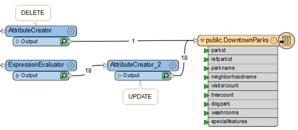

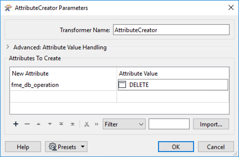

Add an AttributeCreator to the canvas and connect it to the Tester_2 Passed output port. In the parameters, create a new attribute:
  • New Attribute: fme_db_operation
    • Attribute Value: DELETE
Click OK.

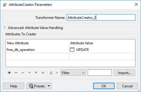

Duplicate the AttributeCreator (ctrl-d/cmd-d) and connect the AttributeCreator_2 to the ExpressionEvaluator. In the parameters, set:
    • Attribute Value: UPDATE
Click OK.
4. Set fme_db_operation
Connect the public.DowntownParks writer feature type to both of the AttributeCreators.

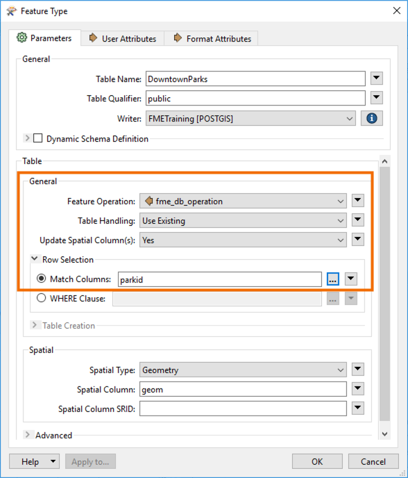

Open the parameters for the writer feature type once more. Set Feature Operation to fme_db_operation and ensure Table Handling is set to Use Existing (FME should set that automatically when you change the feature operation). For the Match Columns parameter, select the field parkid.
This means that parkid is used to match the incoming features to the records in the table. Where there is a match, then the action defined by fme_db_operation will be carried out.
