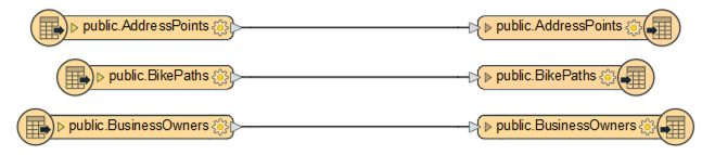

Open the CreatePostgresTrainingDatabase.fmw workspace in FME Workbench. This workspace is available from the Files section of this article. Note that this workspace will be modified as more tutorials are added to the FME Community. The workspace may have more or different datasets than what is shown in the following screenshots.
This workspace reads from the publicly available PostgreSQL database at postgis.train.safe.com provided by Safe Software. This workspace is read-only.

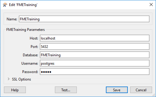

In the Navigator pane, expand Database Connections, right-click on FMETraining, and select Edit Connection.
In the Edit FMETraining dialog, update the connection parameters to match those for your PostgreSQL instance.
Click Test. If the test is successful, click Save, and the database connection is ready to use.

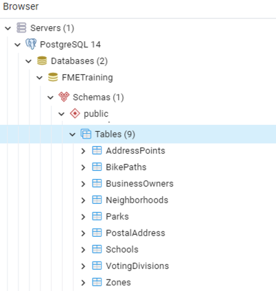

6. Run Workspace
Run the workspace to seed the new FMETraining database. After the translation is successful, the FMETraining database is now ready for use with any article in the Community that requires PostgreSQL read or write access.
If at any time you wish to reset your personal FMETraining database, rerun this workspace; it will drop and recreate the table.
Screenshot from PostgreSQL pgAdmin
