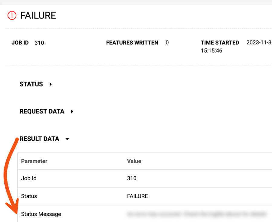

‘The log file for Job ID <n> does not exist’
On the FME Flow job log page, expand the RESULT DATA section (located at the top of the page, before the translation log begins).
Result Data section
The 'RESULT DATA' section expanded on an FME Flow job log page
The Status Message may contain an error such as:
INCLUDE -- failed to evaluate Python script
If you see this error, the Python script is likely the cause of job failure. However, specific Python errors are not written in the job log in FME Flow. Instead, review the fmeprocessmonitorengine.log (in the Engine folder) for a more detailed error message.
If the RESULT DATA contains an error unrelated to Python, please see ‘The log file for Job ID <n> does not exist’ for more possible causes.
