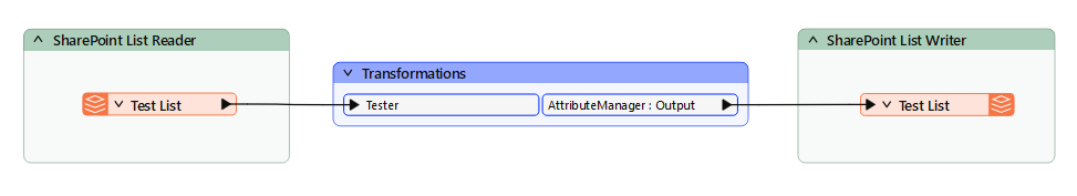

SharePoint List Readers and Writers
The Microsoft SharePoint List Readers and Writers read from and write to lists only. They do not download, upload, or delete files stored in a SharePoint document library. In FME, each list is a feature type. Each row or item in a list is a feature, and each column or field in a list is an attribute.
There are two SharePoint List Readers and Writers:
Microsoft SharePoint Online List Reader/Writer
The Microsoft SharePoint Online List Reader/Writer works with SharePoint Online lists only. Connection is made through a SharePoint Online web connection. This is the recommended transformer when working with SharePoint Online lists because it supports more OAuth2.0 authentication options, like client credentials. It also uses the Microsoft Graph API, instead of the legacy SharePoint API used by the Microsoft SharePoint Server List Reader/Writer, which means better support from Microsoft now and in the future.
Since the Microsoft Graph API is also used by the SharePointOnlineConnector, it's possible to use the same web service definition and connection between the two. See Creating a SharePoint Web Connection for guidance.
The SharePoint Online List Reader/Writer does not ship natively with FME. Users must download and install the SharePoint Online Package from the FME HUB. The SharePoint Online List format requires a minimum version of FME 2024.1.
Microsoft SharePoint Server List Reader/Writer (Legacy)
Before FME 2025.1.3, this format was known as the "Microsoft SharePoint List Reader/Writer"
The Microsoft SharePoint Server List Reader/Writer is intended for working with lists hosted on SharePoint Server on-premises. It offers additional authentication options for on-premises connections:
Basic, NTLM, or Kerberos. It can also read/write SharePoint Online lists using a web connection, but it is recommended to use the Microsoft SharePoint Online List Reader/Writer instead, unless you are on a version of FME that is 2024.1 or older.
The SharePoint Server List Reader/Writer uses a legacy SharePoint API, so a SharePoint Online web connection will not work. Please see the section Create a Legacy SharePoint List Web Connection in Form for instructions.
For more information, including the legacy list types supported, please see the Microsoft SharePoint List Reader/Writer documentation.

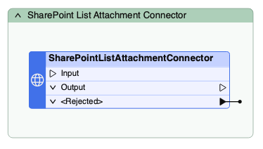

SharePointListAttachmentConnector
The SharePointListAttachmentConnector is a transformer that lets you perform the following actions on list item attachments within a SharePoint Online document library:
- List
- Upload
- Download
- Delete
This connector does not ship natively with FME. Users must download and install the SharePoint Online Package from the FME HUB.
Connection is made through a web connection. Since Microsoft's Graph API does not yet fully support list attachments, you must follow the instructions in Create a Legacy SharePoint List Web Connection in Form, which uses Microsoft's SharePoint API to create a connection.

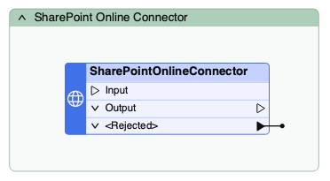

SharePointOnlineConnector Transformer
The SharePointOnlineConnector is a transformer that lets you perform the following actions on files or folders held within a SharePoint Online document library:
- List
- Upload
- Download
- Delete
Connection is made through a web connection. See Creating a SharePoint Web Connection for guidance.

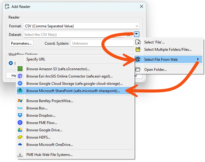

SharePoint Online as a File System
Some FME readers and writers also support browsing SharePoint Online as if it were a file system. This allows you to read from or write to SharePoint Online without needing to add additional SharePointOnlineConnectors to your workflow. When adding a reader or writer, you can select a file from SharePoint: choose 'Select File From Web' and then 'Browse Microsoft SharePoint'.
The same SharePoint Online web service and connection defined for the SharePointOnlineConnector or SharePoint Online List Reader/Writer is used. Users must download and install the SharePoint Online package from FME Hub.
