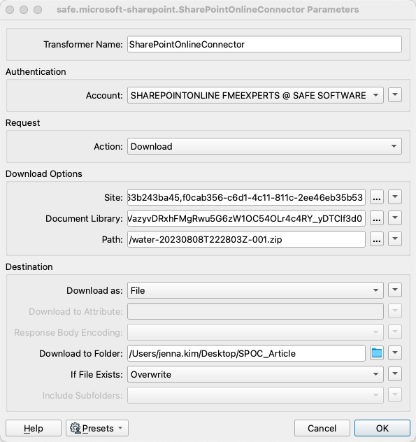

1. Add the SharePointOnlineConnector
Add the SharePointOnlineConnector and attach a Creator to initiate the workflow. From your configured Web Service, choose the Web Connection you've set up, granting access to your SharePoint Site.
Set the Action to "Download". Navigate to your intended Site, Document Library, and file path by clicking the "..." next to Parameters.
Configure the destination for the download as "File" and designate your preferred location.
Execute the SharePointOnlineConnector. You should observe that the file has been successfully downloaded to your designated location.

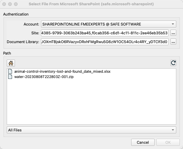

Add a Reader of your choice. Click the dropdown arrow to the very right of the Dataset parameter, Select File from Web, and Browse Microsoft SharePoint.
This will prompt you to choose a functional Web Connection, then proceed to your desired Site and Document Library where the file is stored. Click "OK." You will notice that the Dataset parameter now directly reflects your SharePoint Site.
However, this approach has a limitation: it only allows reading the dataset. If your intention involves migration, deletion, or direct modifications on your SharePoint Site, it's advisable to use the SharePointOnlineConnector.
