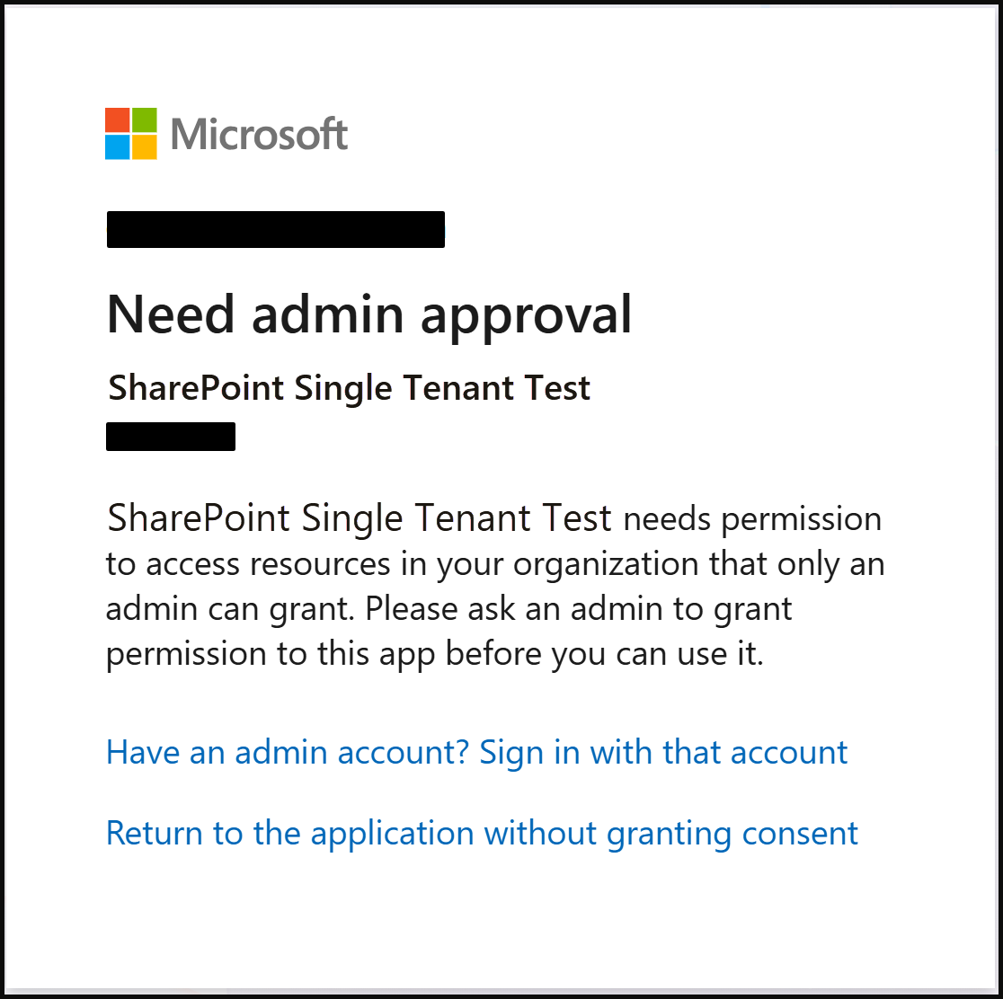

Admin consent required
If your Azure portal requires admin consent, you will receive an Approval Required message when trying to authorize the SharePoint connection. Ask your Azure Administrator to grant admin consent to the app registration's API permissions, then retry the test in FME. Authorizing with an Azure Administrator account should also resolve the issue.
Depending on your organization's Azure consent workflow, you may be permitted to request approval via Microsoft's dialogs when testing your web connection or web service. The Azure administrator can then approve the request.
If you continue to be prompted for consent after approval in Azure, check the &prompt parameter in your web service's Authorization Parameters URL. Try &prompt=select_account and retry. Or, you may need to remove the &prompt= parameter entirely. This will depend on your organization's configuration.
In the Microsoft Graph API authorization URL, the "prompt" parameter specifies whether the user should be prompted to sign in or consent to the requested permissions. See Microsoft Graph OAuth2 Request Parameters.

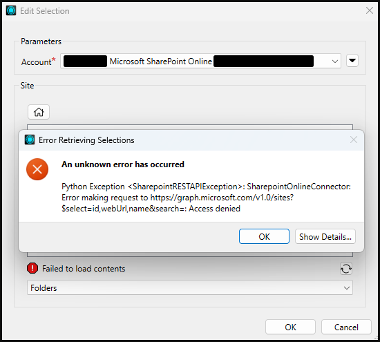

API Permissions: Sites.Selected
If you are using the Sites.Selected API permission in your Azure app registration, you can expect an "Access Denied" message when clicking the ellipsis for the Site parameters in the SharePointOnlineConnector or SharePoint Online List Reader/Writer.
When selecting the ellipsis to the right of the Site parameter, a "search for sites" call is made, as described in this Microsoft Graph API Documentation. However, as noted in the Permissions section, this method does not support the Sites.Selected application permission.
To resolve this issue:
In the SharePointOnlineConnector:
- Open the Advanced Selection Editor for the Site parameter
- For the Object Identifier, hard-code <HostURL>,<siteID>,<webId> with your values. Remove the angled brackets and ensure the values are separated by a single comma with no spaces.
In the SharePoint Online List Reader/Writer:
- Open the Text Editor for the Site parameter
- Hard-code the <HostURL>,<siteID>,<webId> with your values. Remove the angled brackets and ensure the values are separated by a single comma with no spaces.
If you still see an Access Denied message after completing the steps above, you may need to register a new Azure App, especially if your current app was created some time ago.
Please note that both the Sites.Selected application and delegated Graph API permissions require additional configuration in Microsoft Azure that is not required for other Graph API permissions. The Azure app registration must be granted access to each SharePoint site. Safe cannot provide detailed instructions on configuring the Sites.Selected application or delegated permissions in Azure - please consult with Microsoft.
