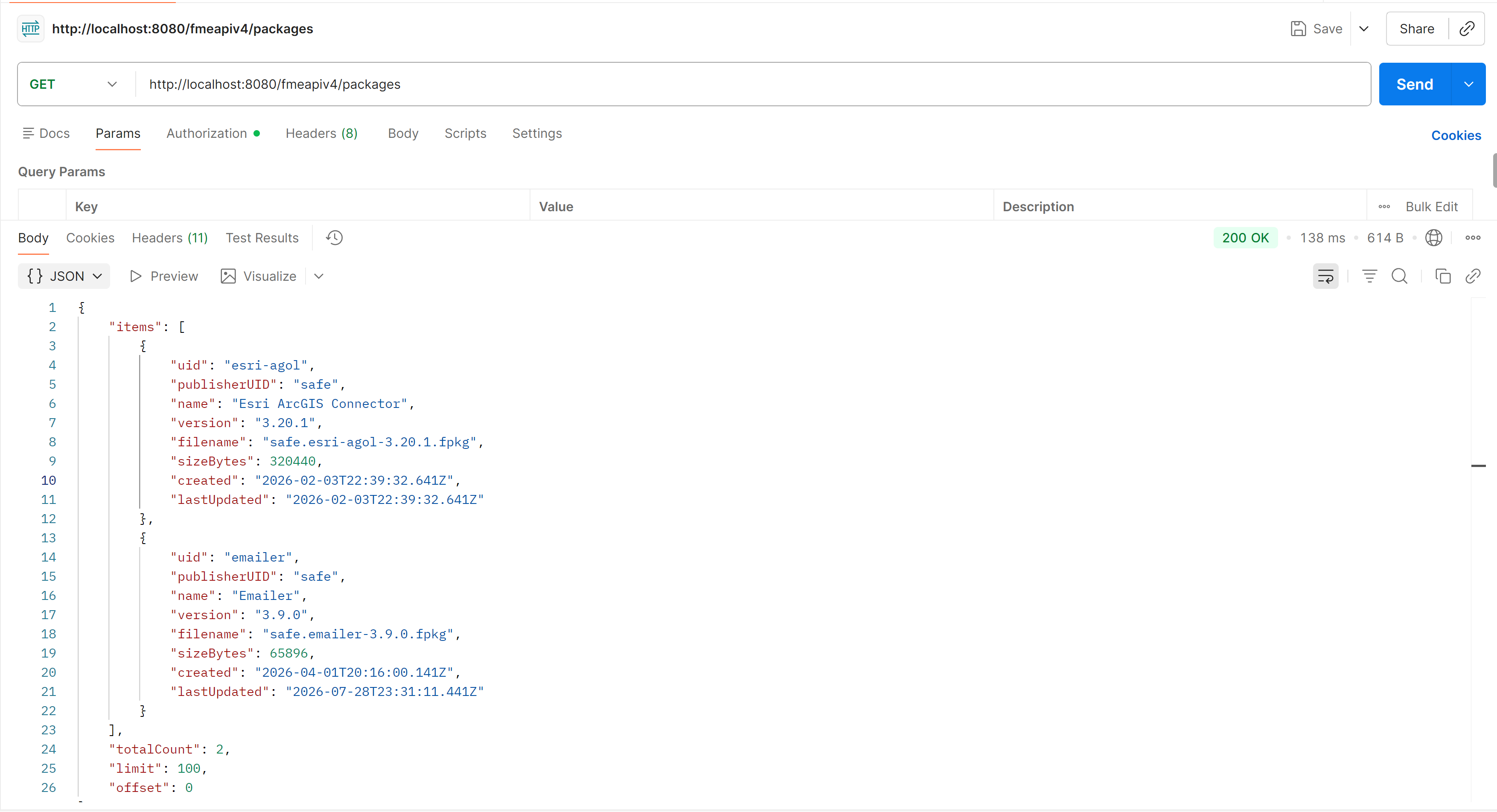

FME Flow does not have a method for checking for available package updates. However, if users keep the installed package versions the same between their FME Form and FME Flow products, they can first check for package updates in FME Form as described above. Then, they can perform package updates for FME Form, followed by package updates for FME Flow as described below.
FME package updates for FME Flow involve the following key steps:
  1. Fully uninstall the package from the build of FME Flow in use; please see the instructions provided in the Uninstalling an FME Package from FME Flow section, below
  2. Publishing the updated package version from FME Form to FME Flow
  3. Extracting the newly published package in FME Flow
After fully uninstalling the FME package targeted for update from FME Flow, users will need to republish the newer package version they wish to upgrade to from FME Workbench. This means the package version targeted for upgrade on FME Flow should first be installed in FME Form. Then, users can simply add and configure the upgraded package's canvas object to a blank canvas in FME Workbench, test the canvas object to verify its correct functionality, and then publish this simple workspace to FME Flow. The Publish to FME Flow wizard will prompt users to publish the package; users should ensure they choose to publish it when prompted.
Once the workspace and package have been successfully published from FME Form to FME Flow, users must complete the FME Flow package upgrade by running a workspace or automation in FME Flow, which uses the upgraded package's canvas object. This final action will fully extract the published package and complete the package upgrade for FME Flow.

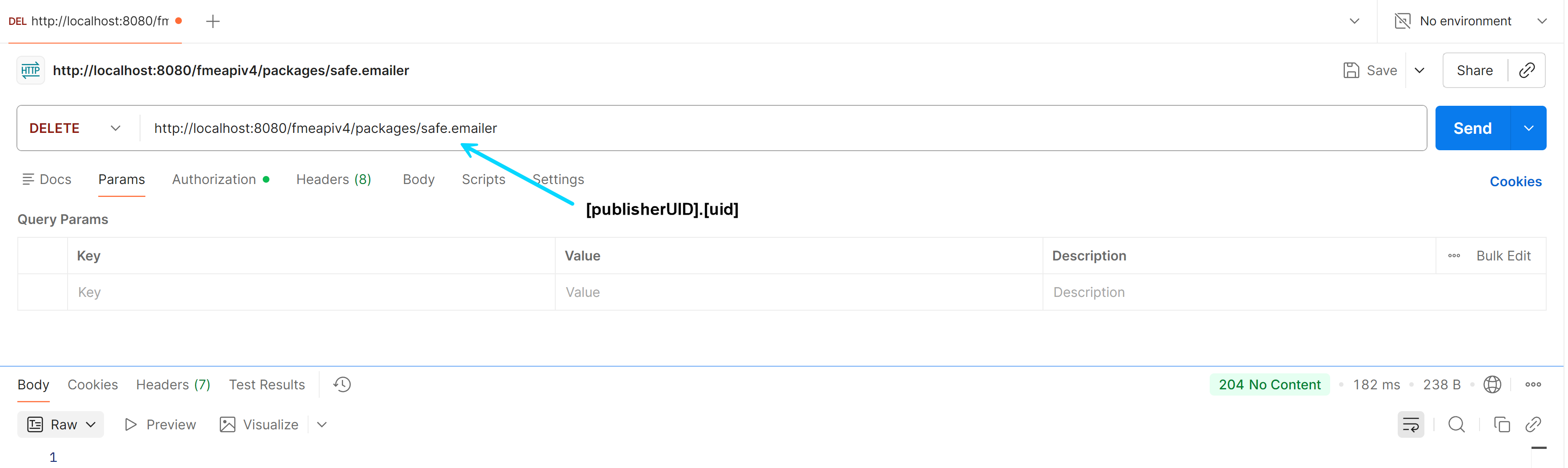

Uninstalling an FME package from FME Flow requires careful attention to the steps described below; if components of an older package are left behind, upgraded packages may not function as expected in the FME Flow environment.
To uninstall a published, extracted FME package from FME Flow, users must first log in to the FME Flow Web UI under the Flow Admin or Superuser role. These roles contain the permissions needed to remove files and folders associated with FME packages.
Once logged in, use the left-side panel and navigate to the following FME Flow Web UI location:
Resources > Engine > Packages > [Flow_Build]
In this location, users will see several subfolders. The subfolders containing extracted FME package components include the following:
  • PackageFiles
  • Python
  • resources
  • transformers
  • webfilesystems
Users should access each of the above-listed subfolders and remove the target package's folder therein using the Actions drop-down.
Once the target package's extracted components have been removed, users should navigate to Resources > Engine and remove the target package's .fpkg file using the Actions drop-down menu.
While removing the target package's .fpkg file, users will see the following warning appear:
Select OK to acknowledge the warning and remove the .fpkg file. This final .fpkg removal will complete the full uninstall of a published, extracted FME package from FME Flow.
