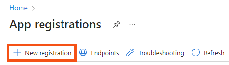

Add a new registration.
New App Registration
If you’re registering a Multitenant application, choose ‘Accounts in any organization directory (Any Azure AD - directory - Multitenant)’. For a single tenant application, choose ‘Accounts in this organizational directory only’. The Redirect URI can be left empty. The example in the screenshot below shows a multitenant registration.
Click Register.

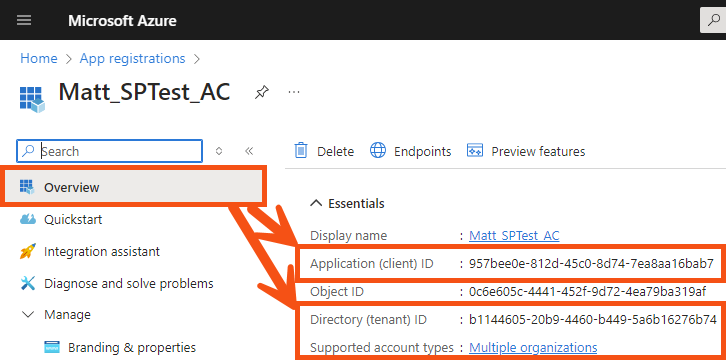

On the new app’s Overview page, take note of the Application (client) ID and the Directory (tenant) ID - these will be used to configure the web connection in FME later.
Note: you can confirm that your app is a mutitenant app if the value of ‘Supported account types’ is ‘Multiple organizations’. If it is single tenant, the value will be ‘My organization only’.

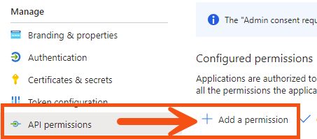

Click API permissions and then Add a permission.
Add API Permission

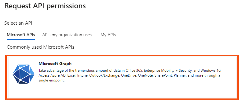

Choose Microsoft Graph from Request API permissions.
Graph API Permissions

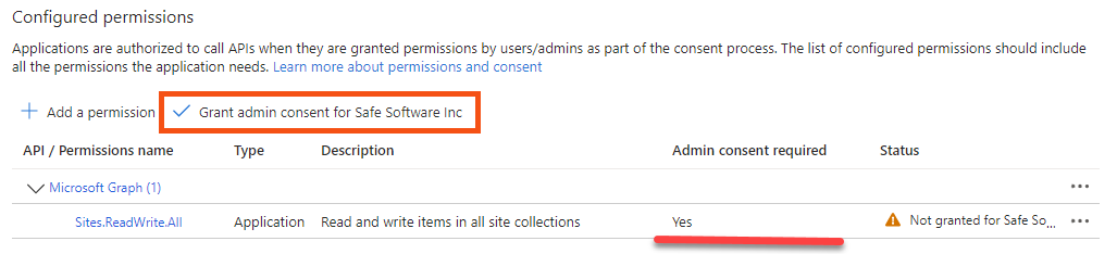

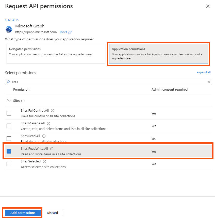

Click Application permissions. Search for and then check off Sites.ReadWrite.All. Click Add Permissions.
Once added, you should see the Sites.ReadWrite.All permissions in the list of Configured permissions. Since this permission requires admin consent, click ‘Grant admin consent…’
Confirm that the Status is now Granted.

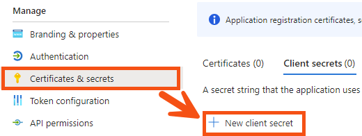

Click Certificates & secrets and then 'New client secret'.
CreateClientSecret

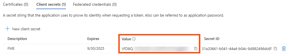

Give your client secret a description and expiry. Click Add.
Add New Client Secret
Once your client secret expires, you will need to create a new one and update your web connection to continue connecting to SharePoint.
After clicking Add, make sure to copy the secret value (not the Secret ID) and store it in a safe place, like a password manager. You will only get one chance to save the secret value! You can create another secret if needed.

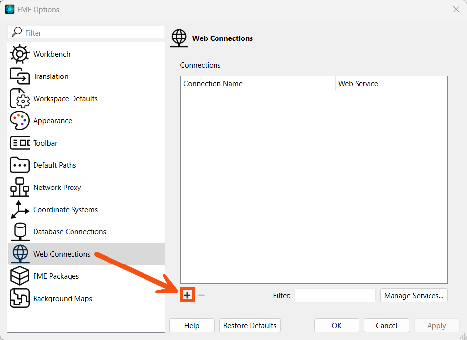

From Web Connections, click the plus (+) button to add a new connection.

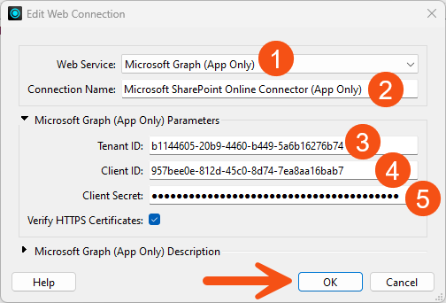

2. Populate the Web Connection
  1. Web Service: choose the ‘Microsoft Graph (App Only)’ web service. This web service comes with the SharePoint Online package from the FME HUB.
  2. Connection Name: provide a unique name. It’s recommended to include the transformer that this web service will be used for and the Azure app registration name, so that you can cross-reference it.
  3. Tenant ID: the Directory (tenant) ID from the SharePoint app registration
  4. Client ID: the Application (client) ID from the SharePoint app registration
  5. Client Secret: the Client Secret value from the client secret you added to the SharePoint app registration
Click OK.

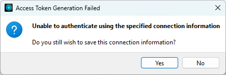

After clicking OK, FME will use the web connection to obtain an access token from Azure. If you receive an Access Token Generation Failed error, like the example below, re-confirm your settings and try again.
If you do not receive an error, then your web connection is ready to use in FME Form.
