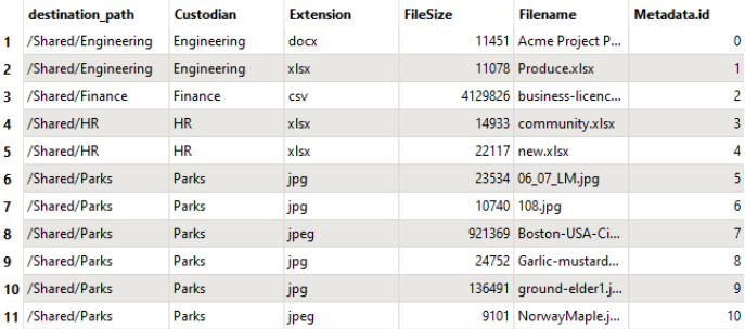

This is an example of how you might upload multiple files from your directory at once using a metadata file with path and file information. For this exercise, we have not provided the actual documents that are being migrated. Instead, we will illustrate the steps required to build the workflow for you as a reference for your own scenario, environment, and SharePoint Instance.

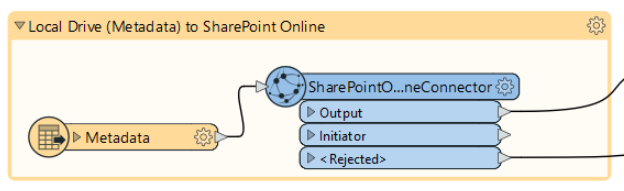

In this example, we’ve initiated the workspace with a reader to read in metadata containing information about the document management system:
The path portion of the metadata is most important; make sure it points to the correct files in your directory.
3. Add the SharePointOnlineConnector
Add a SharePointOnlineConnector to the canvas and connect it to the feature type used to read in your metadata file.
Open the parameters of the SharePointOnlineConnector by clicking on the cog wheel. Fill out all of the fields that appear in red with your own SharePoint Online Web Connection and file system. Set the Request Action to “Upload” and the File to Upload as the “path” attribute you created in your metadata file. Set your upload options by selecting a site, document library, and path from your SharePoint instance. Here, we have chosen to set the “If File Exists” option to Overwrite when importing new files.

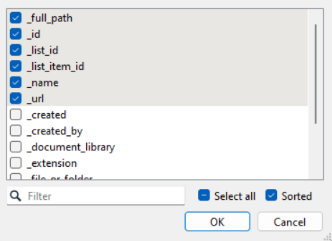

Add the following attributes:
  • _full_path
  • _id
  • _list_id
  • _list_item_id
  • _name
  • _url

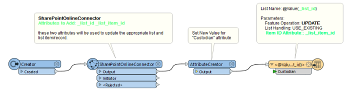

3. Attribute Creation
Add the AttributeCreator to the canvas and create a new attribute with the following:
  • New Attribute: Custodian
    • Attribute Value: Ernie
4. Writing the Output
Add a Microsoft SharePoint List writer to the canvas, then configure it with your SharePoint connection and file system parameters. Make sure to set the List Name to the _list_id attribute and the Item ID Attribute to the  _list_item_id attribute.
  • List Name: _list_id
  • Row Selection:
    • Item ID Attribute: _list_item_id
Set User Attributes to Manual, and configure the Custodian attribute as a choice.
The workspace should look something like this:

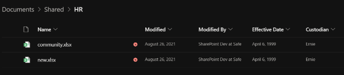

Final output in SharePoint:
