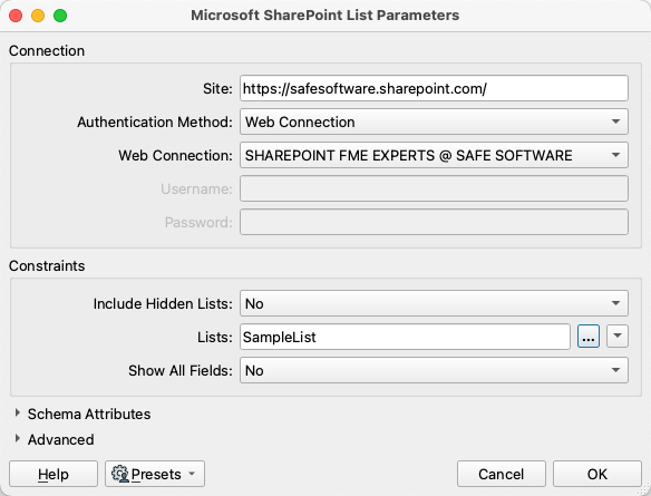

Add the SharePoint List Reader to your Canvas, in the Dataset parameter enter the domain of your SharePoint site (for example, https://safesoftware.sharepoint.com). Click Parameters.
Select your desired Authentication Method. In this tutorial we are using the Microsoft SharePoint Online (Template) Web Service configured to Safe Software’s SharePoint. You can choose either Basic, Web Connection, NTLM, and Kerberos.
Under Lists, navigate to the List you want to read from your existing SharePoint Lists. Click OK to add the Reader to your Canvas.

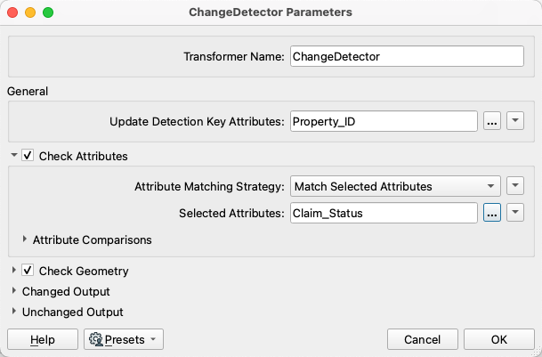

Add the ChangeDetector transformer to your Canvas. Learn more about the ChangeDetector here . Connect the SampleList from the SharePoint List Reader to the Original Port. Then connect the UpdatedSampleList from the CSV Reader to the Revised Port. Open up the Change Detector Parameters.
Set the Update Detection Key Attribute to be Property_ID, and the Selected Attributes to be Claim_Status. Click OK to exit out. Run the Transformer. You should see that we have 6 features that have been updated.

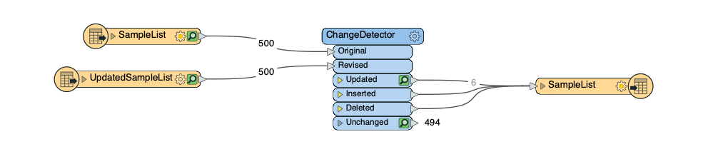

Connect the Updated, Inserted, Deleted, ports from the ChangeDetector to the SharePoint Writer. Double Click the Writer to open up the Feature Type window, Set the Feature Operation to fme_db_operation. Set the List Handling to Use Existing. Click OK to apply changes.
Your Canvas should look like this.
Run the writer to update your List on SharePoint. Feel free to make changes to the UpdatedSampleList.csv to see how the ChangeDetector deals with other operations ie, Inserted, Deleted.
