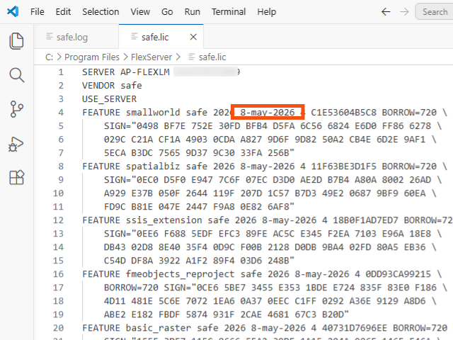

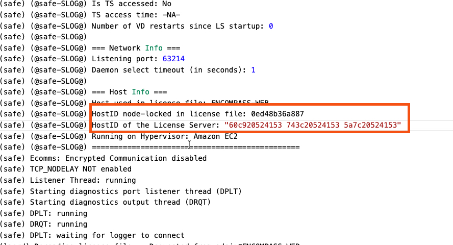

4. Are your hostname and hostid still valid?
There are two places where you can verify this information.
  • Open FlexnetTroubleshoting.html file, under ‘safe.lic Comparison’ heading, confirm that the hostname and hostid of the machine align with the information in the license file.
  • Go to the machine where the floating license server is hosted. Open the log file from C:\Program Files\FlexServer\safe.log folder. Verify that the HostID is present in the list of all the HostIDs for the floating license server. In the example below, HostID in the license file is set to "0ed48b36a887" while the HostIDs for the server are "60c920524153 743c20524153 5a7c20524153."
SOLUTION
Generate a new license file as documented below.
  • Request a new license by visiting https://fme.safe.com/activation/floating/
  • Complete the form by providing HostName, HostID, and SERIAL NUMBER
  • The FME Form version will be indicated in the email containing the updated license file
  • Restart the floating license server with the updated license file

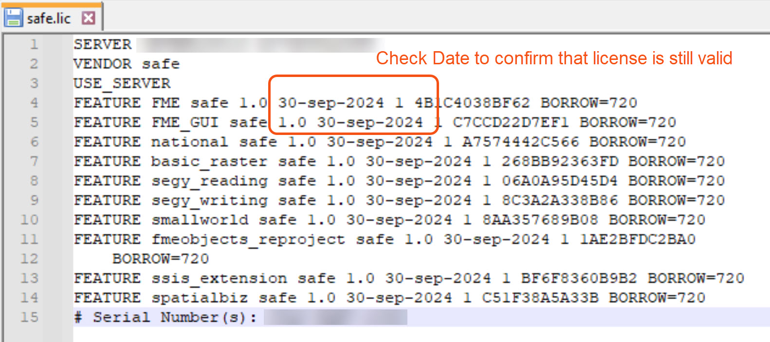

5. Is your license expired (Subscription users only)?
This error is encountered only by Enterprises with Subscription licenses. With the new subscription model, the license file will have an expiry date. Before troubleshooting further, please verify if your current subscription is valid. In our investigation, the floating license server generated an Error code similar to the one below.
“FlexNet Licensing error:-7,10015”

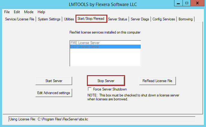

7. Have you tried restarting the floating license server?
If you have recently obtained a new license file or have made some changes to the license server, it is always worth trying to restart the license server (a machine reboot) or at least restarting the license server service through LMTOOLS by clicking ‘Stop Server’ and then ‘Start Server’:
Note the ‘Force Server Shutdown’ checkbox. Please try checking this box if the initial ‘Stop Server’ attempt fails - it may be that there is a rogue lmgrd.exe process that is preventing the server from shutting down. Checking this box will ensure a total service stop.

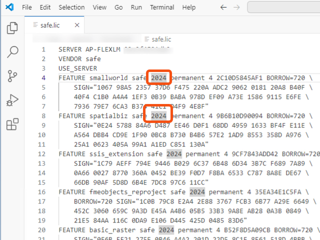

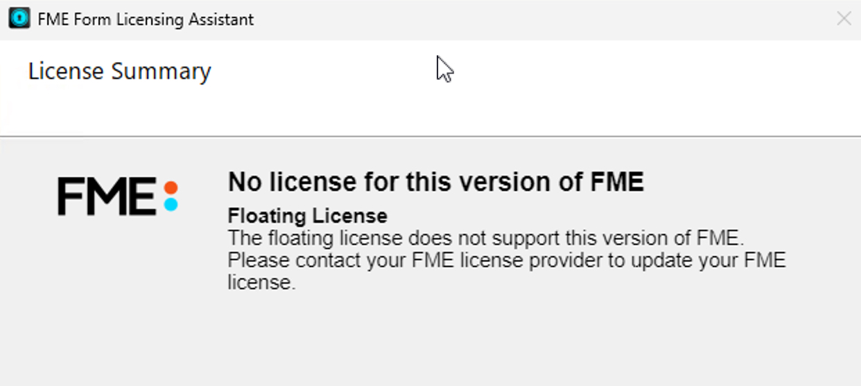

8. After upgrading to the latest FME Form, the following error message appears: "The floating license does not support this version of FME."
Issue:
The floating license server contains the version of FME associated with your Serial Number. It is possible that when you renewed your Annual Maintenance(AM), you did not generate a new license file.
SOLUTION:
  • Complete the form by providing HostName, HostID, and SERIAL NUMBER.
  • Download the license file; the FME Form version will be indicated in the email containing the updated license file.
NOTE: The version of FME Form generated is based on your Annual Maintenance(AM) entitlement. Ensure that you have updated your AM contract.

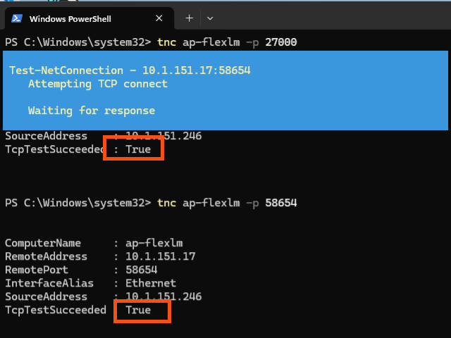

Use TestNet-Connection to confirm ports are open for communication
Even if the server responds to a ping, it doesn't necessarily mean that it is communicating correctly. We recommend using TestNet-Connection (tnc) to test communication between client machines and the license server.
Step-by-step instructions to run TestNet-Connection
  • TestNet-Connection (TNC) commandlets are installed on the machine

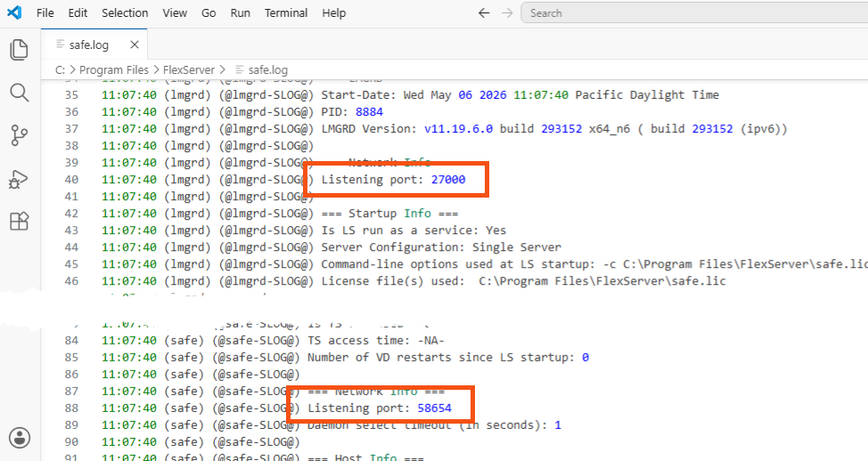

  • Ports used by the floating license server.  -- Open the log file from C:\Program Files\FlexServer\safe.log file to verify ports used by server and vendor daemons.  FloatingLicensePortsLog.jpg
  • Open PowerShell(as administrator) on the machine where FME Form is installed.
  • Now run the following command to extract the ports from the safe.log file.
  • tnc servername.domain.com -p 27000
    tnc servername.doamin.com -p 58654
If you are still facing an error connecting to the floating license server after the successful tnc test. It is possible that your organization have an enterprise-grade network and security software, which is blocking the communication.
In such scenarios, please reach out to your Network/Security team and run a network trace to confirm communication is blocked. Microsoft utilities such as Telnet, TNC, and ping will not help; in such cases, tracert may yield better results.

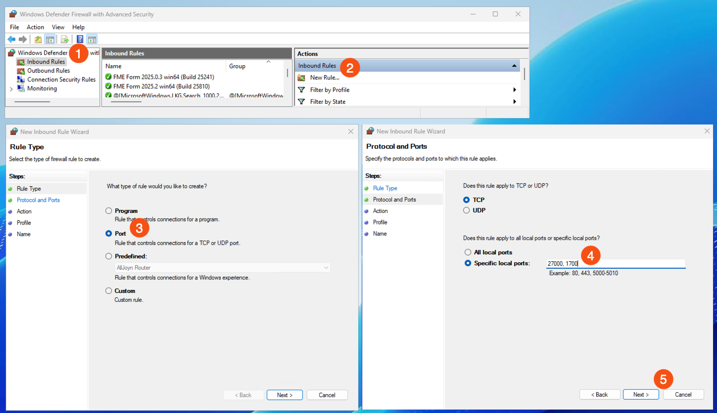

Steps to create Windows Firewall Rule
For Windows Firewall
  1. On Windows, you can open the Control Panel > System and Security > Windows Defender Firewall > Advanced Settings and select Inbound Rules.
  2. Select New Rule (in the right Action Pane)
  3. Select "Port" in the next dialog
  4. In Specific local ports: enter your chosen SERVER and VENDOR ports separated by a comma.
  5. Accept changes.
NOTE: You may require assistance from the IT or the Network Security team to create the firewall rules.
