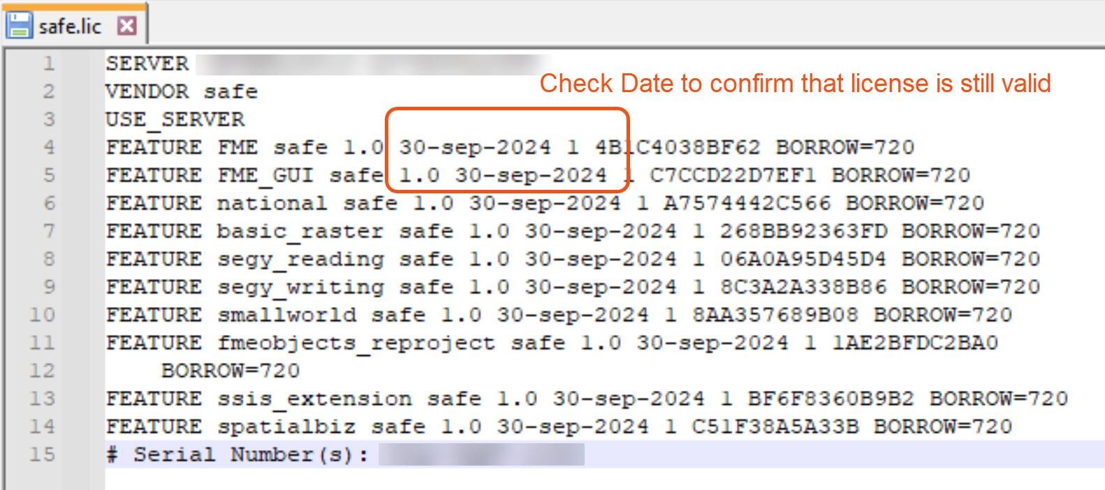

2. Expired license file
If your organization has a subscription-based license agreement, please review the safe.lic file to check if the license is still valid, or else request a new license using the Floating License Request Form
Here is an example of an expired license file.

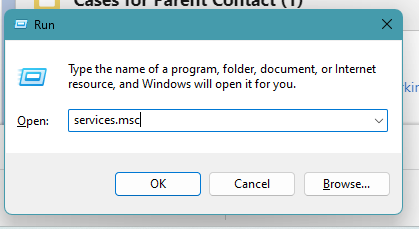

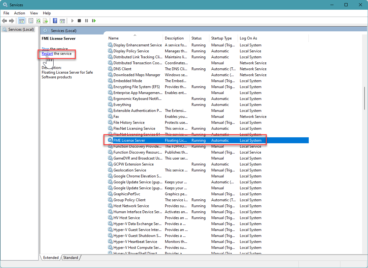

Solution:
In the Windows Search bar, Type "Run" and click OK.
In the run dialog, type "Services.msc" and click OK.
In the next dialog, search for FME License Server and select the item. Click "Restart the service" in the top left panel.

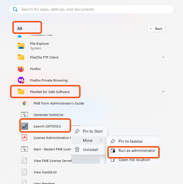

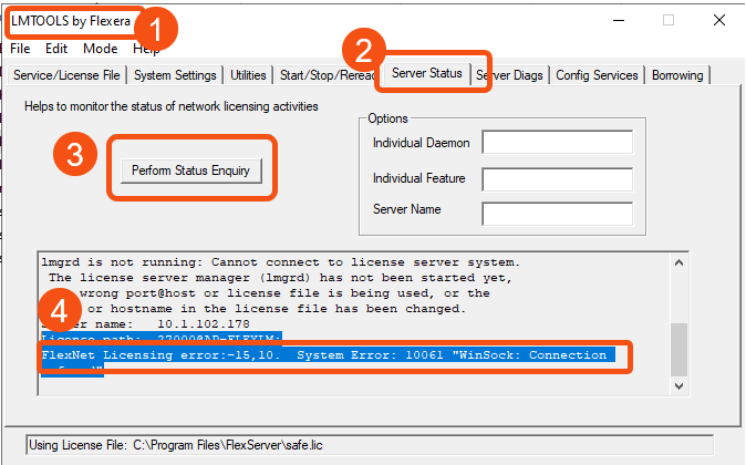

FlexNet Licensing error: -15,10: System Error: 10061 "WinSock: Connection refused "
Issue:
The license file may not have access to the correct ports or have a valid expiration date.
Verify if you are getting the following error: Go to All Programs → FlexNet for Safe Software  → Launch LMTOOLS → As Administrator

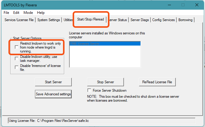

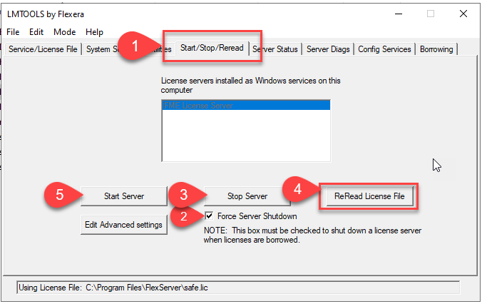

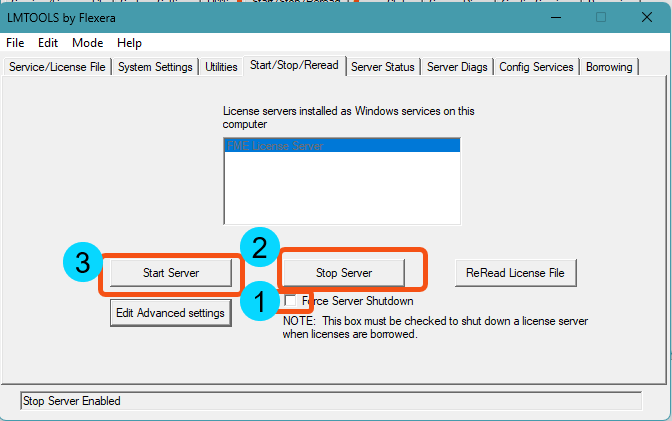

Solution:
Ensure that the safe.lic file has correct ports and a valid expiration.
  1. Switch to the "Start/Stop/Reread" tab
  2. Click on Force Server Shutdown
  3. Click on Stop Server
  4. Click on the ReRead License file
  5. Click on Start Server

If you are still experiencing issues, try restarting the server from the Services.msc
In the Windows Search bar, type "Run" and click OK.
In the run dialog, type Open Services.msc and click OK.
In the next dialog, search for FME License Server, select the item from the list, then click "Restart the service" in the top left panel.

Option 1: Restart the FME License Service 
Open LMTools.exe and click on Start/Stop/Reread table
  1. Click on Force Server Shutdown
  2. Press on Stop Server 
  3. Now Press on Start Server. If it still does not work.  
    Machine generated alternative text:
File Edit Mode Help
Service/Ljcense file I System Settings I Utilities Start/Stop/Reread Server Status I Server Dags I
License servers installed as Windows services on this
computer
Config Services I Bon-owing I
Start Server
Edit Advanced settings
Stop Server
F e Server Shutdown
ReRead License File
NOTE: This box must be checked to shut down a license server
when licenses are borrowed
Stop Server Enabled
  4. Click the  Edit Advanced settings
  5. Then, under the Start Server Options, check the box for 
    Restrict lmdown to work only from node where lmgrd is running
  6. Click the Save Advanced settings button
  7. Click the Start Server button
