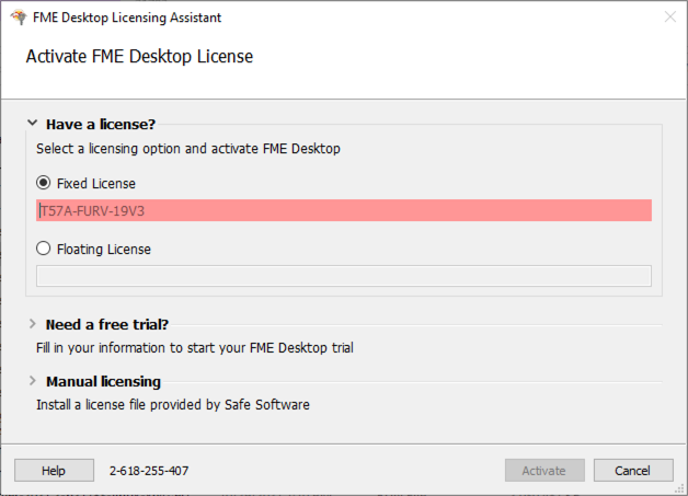

I need to request a license
  • To obtain your license file, run the FME Licensing Assistant*, where you can enter your serial number.

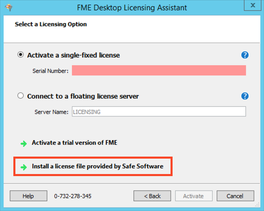

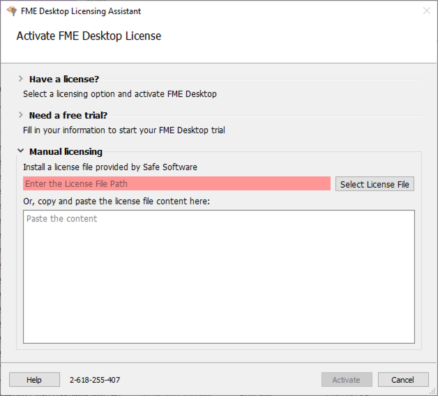

I have a license file, and I need to install my fixed license
To install the license file, run the FME Licensing Assistant.
Expand Manual Licensing,  click Select License File, then browse to where the license file is located or paste in the content of the file.
