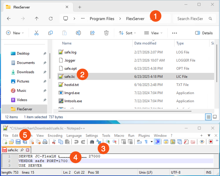

1. Locate and open the safe.lic in a text editor
Your safe.lic file should be in your FlexServer directory on the license server machine. Make a copy of the safe.lic file and open it using a text editor.
By default, the first two lines of a safe.lic file looks like this with no port numbers:
1   SERVER servername 065a942c8ec3
2   VENDOR safe
2. Add the SERVER port (typically between 27000 and 27009) to Line 1
Edit line 1 to replace xxxxx in the sample below with a SERVER port in the typical range (27000-27009).
1   SERVER servername 000c290de0df xxxxx
And the result should look something like this:
1   SERVER servername 000c290de0df 27000
3. Add the VENDOR port (typically between 1700 and 8000) to Line 2
Edit line 2 of the safe.lic file to add Port=yyyy as a VENDOR port that you want to be used for communication to the client machine running FME.  Replace yyyy with a value in the typical range (1700-8000).
2   VENDOR safe PORT=yyyy
So the final result should look something like this:
1   SERVER servername 065a942c8ec3 27000
2   VENDOR safe PORT=1700
Save your changes and replace the old safe.lic file in the FlexServer directory.

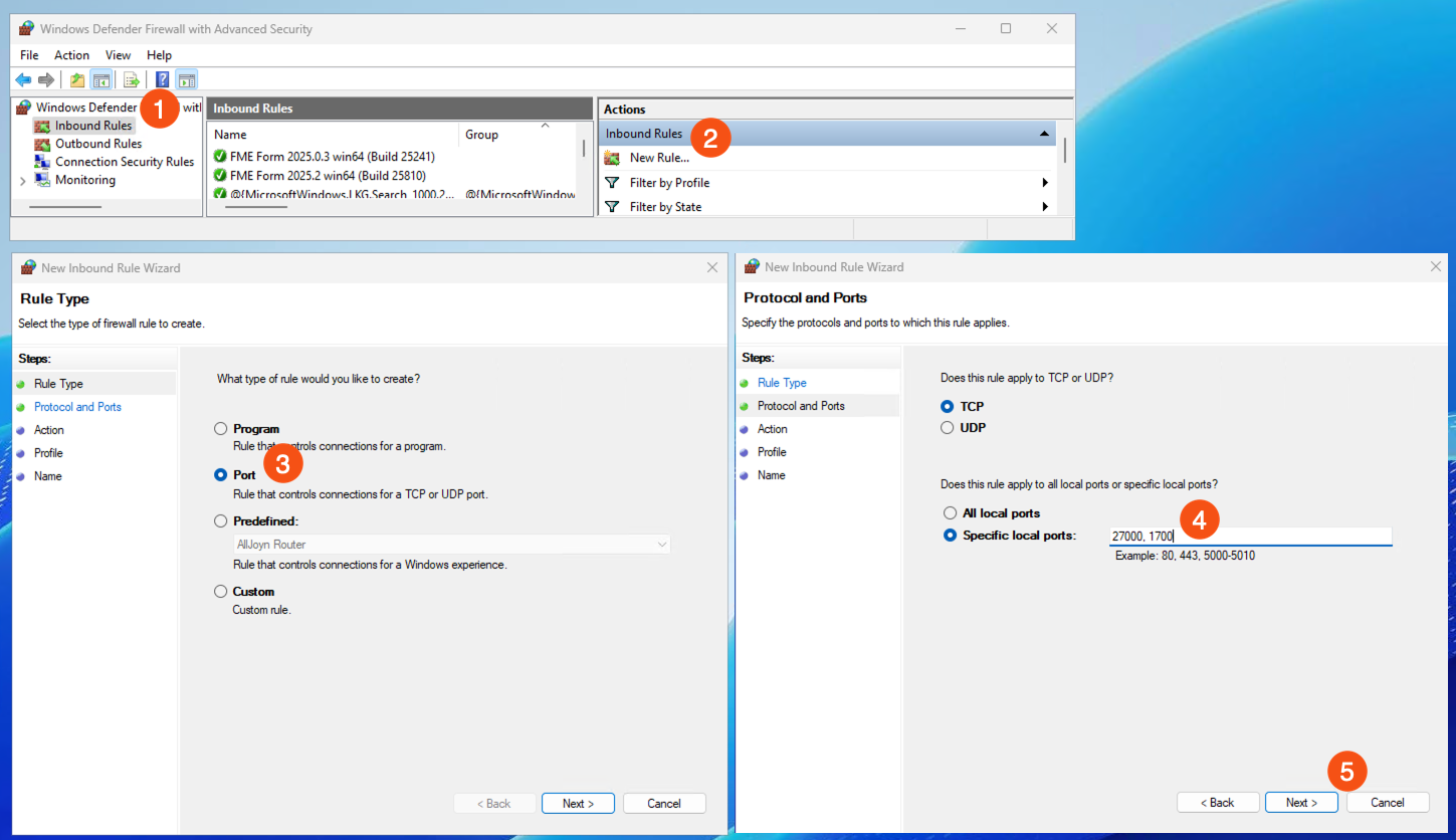

4. Have an IT Administrator set firewall port exceptions for both SERVER and VENDOR ports
On Windows, you can open the Control Panel > System and Security > Windows Defender Firewall > Advanced Settings and select Inbound Rules.
Select 'New Rule' > Port > and in Specific local ports: enter your chosen SERVER and VENDOR ports separated by a comma. Accept changes.

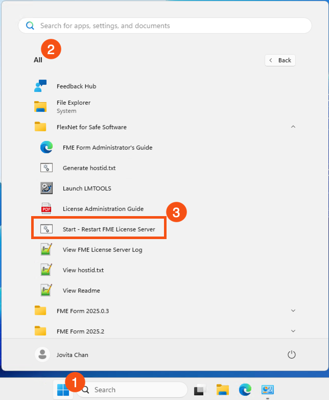

5. Restart the FME License Server
After making the change to the safe.lic file, the FME License Server must be restarted for the port number to take effect. This can be done by:
  • Windows: Start Menu > FlexNet for Safe Software> Start - Restart FME License Server

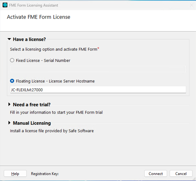

6. Open FME Licensing Assistant on the client machine
If the VENDOR port is specified on the floating license server, FME running on the client machine must also specify this port. In FME Licensing Assistant on the client machine, specify the port number when prompted to "Connect to a Floating License Server," as shown below:
LicenseServerName:xxxxx
(where xxxxx is the port number used in the SERVER line of the safe.lic file).
You should now successfully be able to connect to your floating license server.
