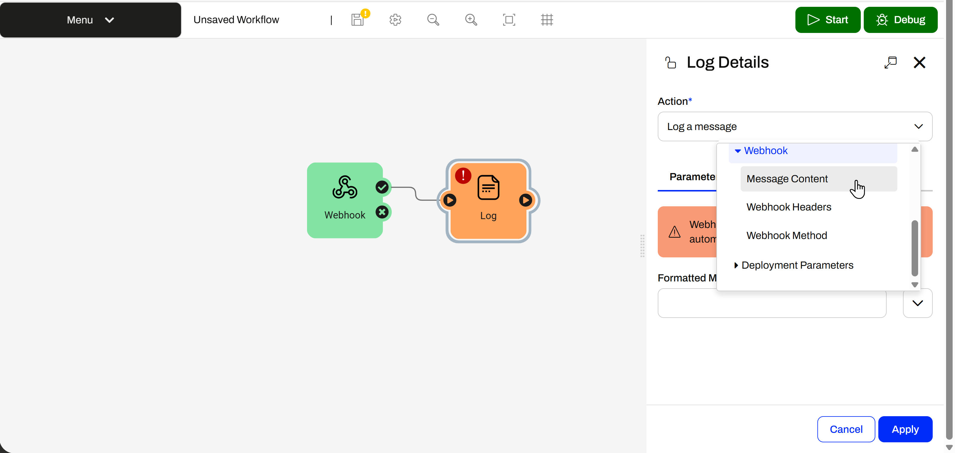

Set the Trigger to Webhook (triggered) and click Apply. Attach a Log a Message Action to the Success port (the checkmark) of the Trigger.
Click the drop-down menu next to the Formatted Message parameter. From the Webhook dropdown, select Message Content. This will let us view the message received from the Portal webhook in our Automation Log.

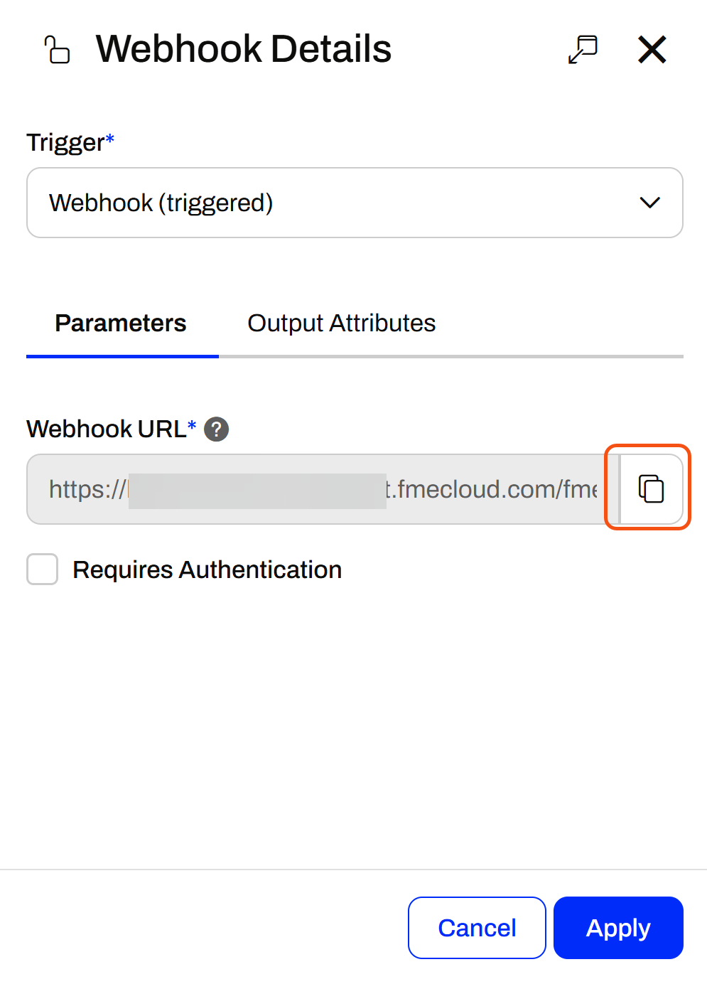

2. Get the Webhook URL
Save the Automation and give it a name (E.g., “Portal External Sharing”). Once saved, double-click the Webhook trigger to reopen its Parameters. Copy the new Webhook URL to your clipboard. Later in the tutorial, this URL will connect our Automation to the ArcGIS Enterprise Portal webhook.

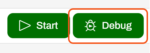

Start the Automation in Debug Mode. Here, Flow collects all log entries from an Automation into one place, making testing easier but reducing performance. Once testing is finished, stop the Automation and Start as normal.
In earlier versions of FME Flow, you may only see "Start Automation". Logging here works similarly to Debug Mode logging above.

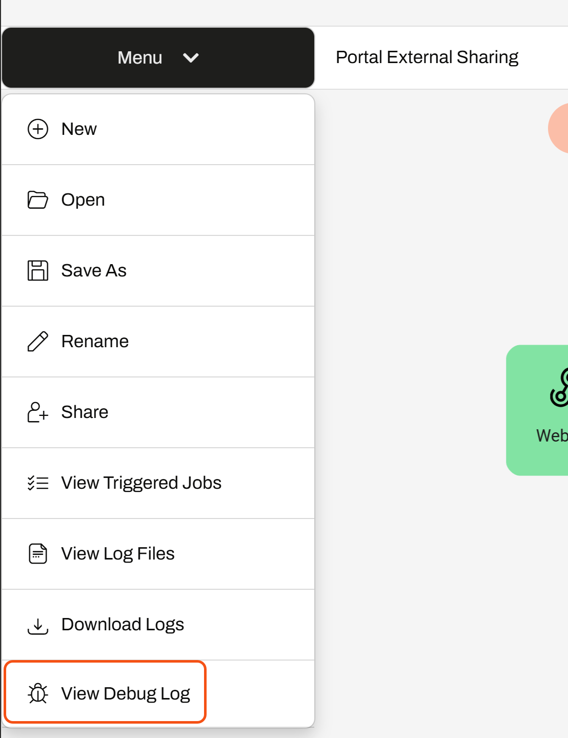

In FME Flow, view the Debug Log from within the automation we just created
In older versions without Debug logging, press View Log File.

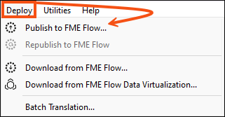

    1. Click Publish
    From the File menu, click Publish to FME Flow, or from the toolbar ribbon, click Publish.
    Toolbar Ribbon:
    File Menu:
    Deploy Menu (2025.1+):
