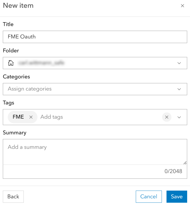

Choose ‘Application' and select Other application, then select Next.
Finally, fill in a Title and Tags if needed. Click Save to create the application.

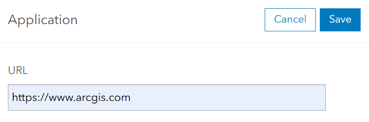

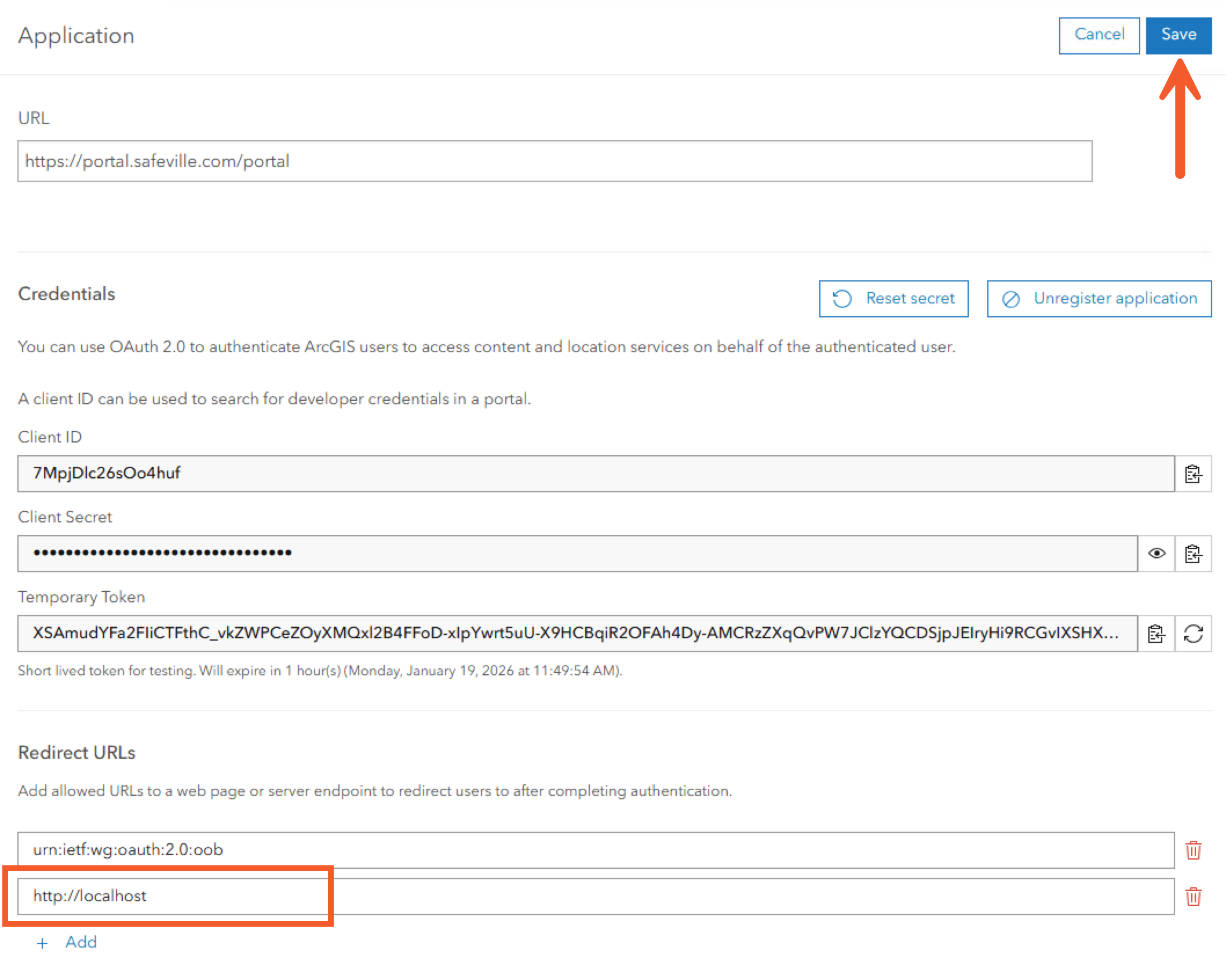

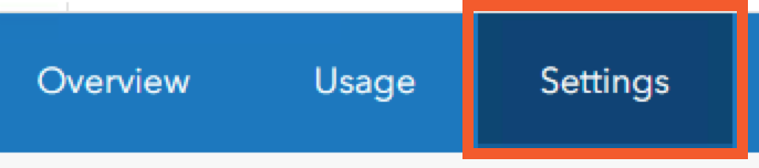

In the application, go to Settings (top right corner).
On the Settings page, scroll down to Redirect URLs and enter http://localhost
If you have enabled FME Flow Connection Storage in FME Form, then enter http://<yourFMEFlowURL>/fmeoauth instead.
For the Application URL, enter your portal URL. This field is not used by FME, but may be required, depending on your version of Enterprise Portal. Click Save.

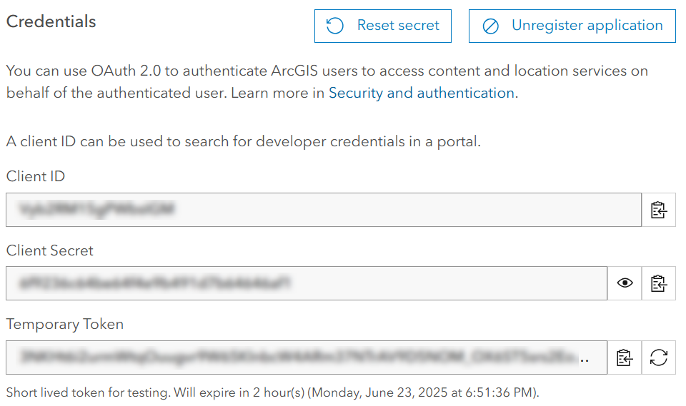

Keep this page open, as you will need to copy and paste the credentials into FME.

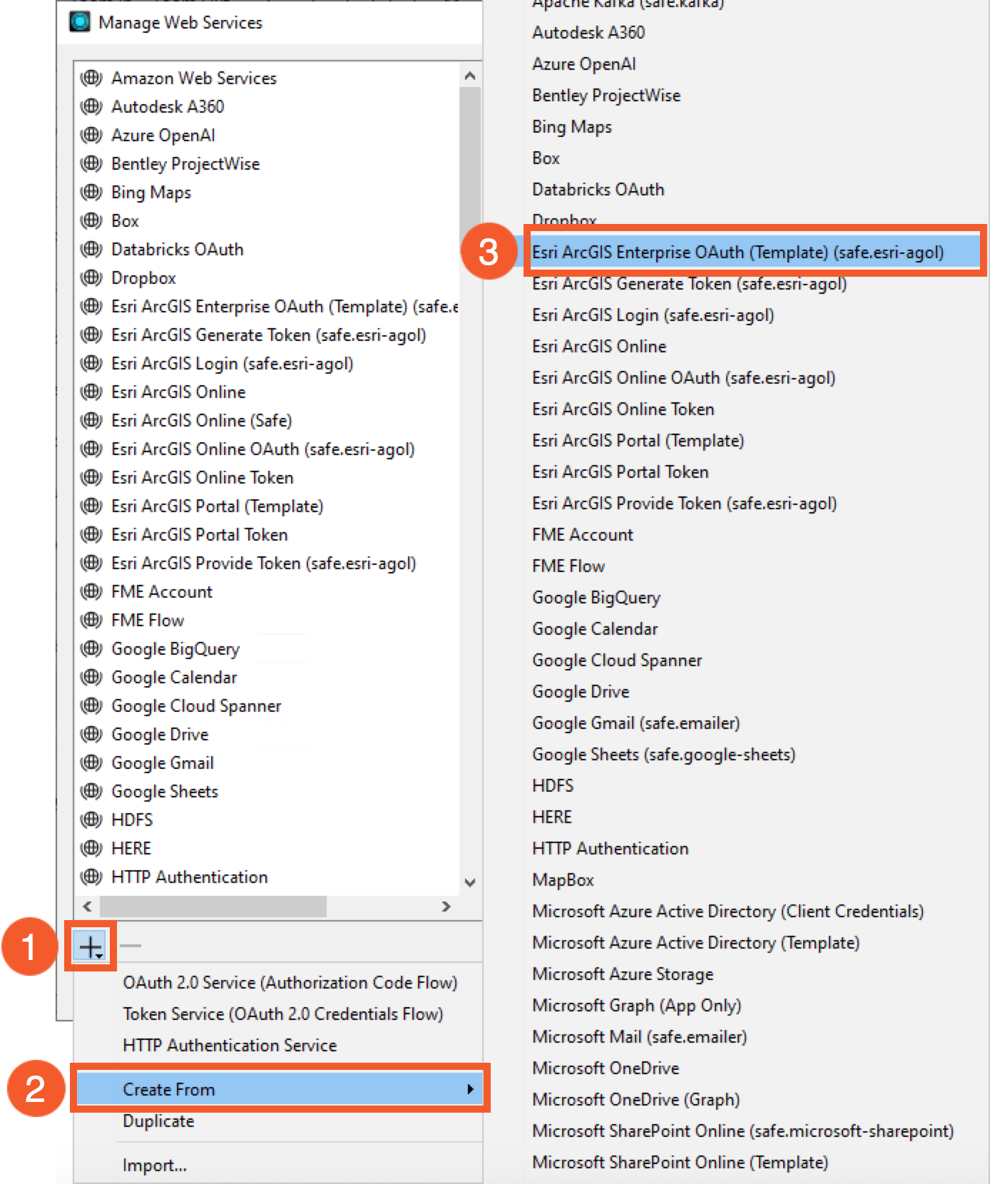

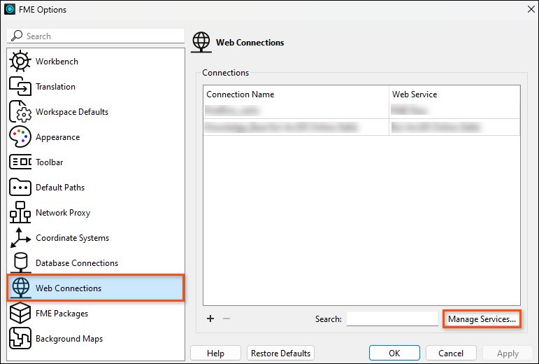

In FME Workbench, open the drop-down Tools/Utilities menu and select FME Options. Navigate to Web Connections, then click Manage Services.
Click on the "+" drop-down menu in the bottom left corner (1) and then Create From (2) > Esri ArcGIS Enterprise OAuth (Template) (safe.esri-agol) (3).

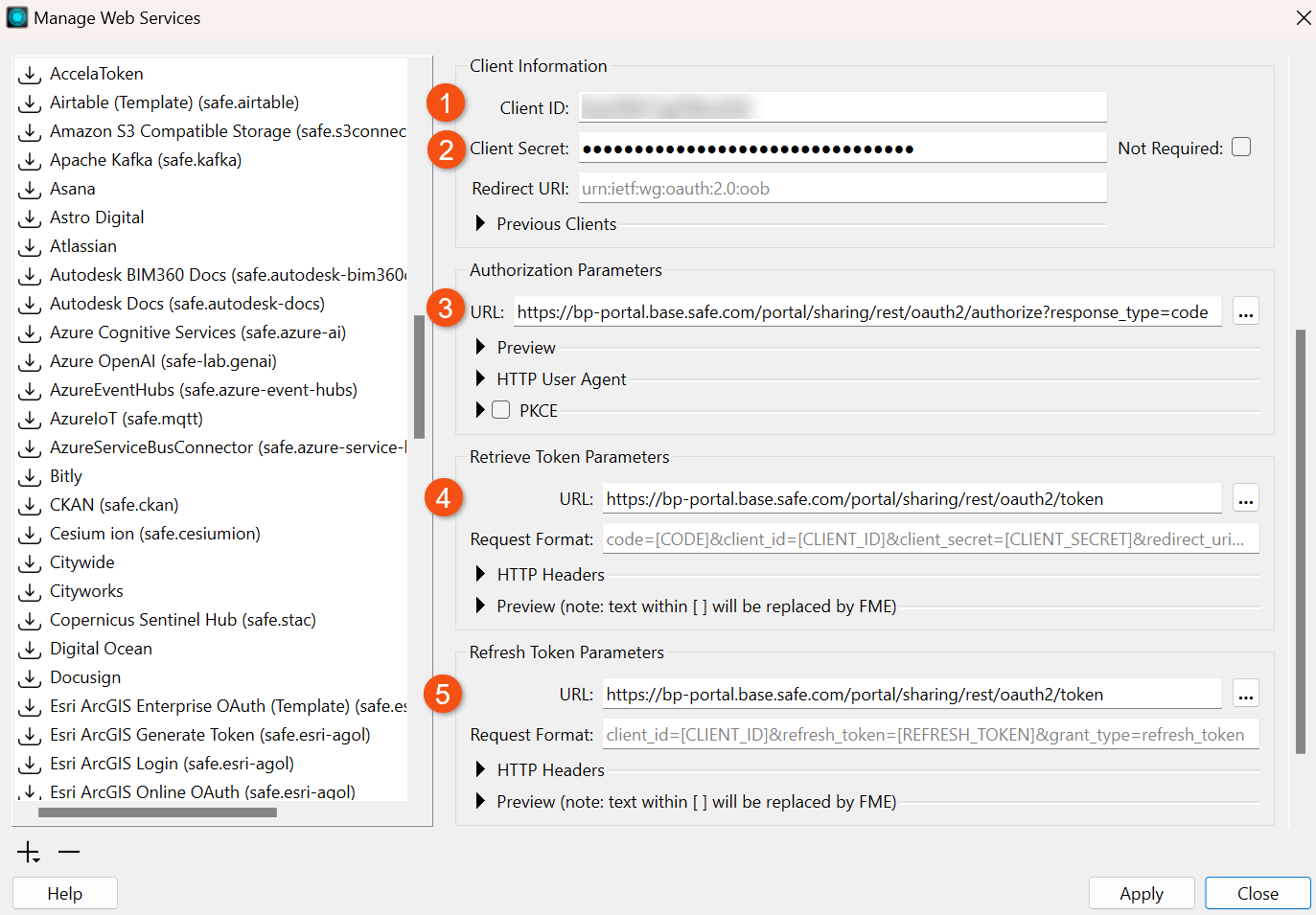

Add the web service information from the ArcGIS Enterprise Portal Application Settings page:
  1. Web Service Name: Give the Web Service a name. It’s good practice to include the service, “Enterprise Portal”, in the name as well as the app name in ArcGIS Enterprise.
  2. Client ID: <copy from ArcGIS Enterprise Portal Settings page>
  3. Client Secret: <copy from ArcGIS Enterprise Portal Application Settings page>
  4. Redirect Strategy: This setting is only available for FME 2025.2 and later. Choose Loopback Interface Redirect. To learn more about redirect strategies, please read external browser authentication. For versions of FME before 2025.2, the internal FME browser is used.
  5. Redirect URI: The Redirect URI must match the one entered in the ArcGIS Online application (created in the first step). Enter http://localhost, or, if you are using FME Flow Connection Storage, enter http://<yourFMEFlowURL>/fmeoauth.
  6. Authorization and Token URLs:  replace [PORTAL_HOST] with your Portal hostname. For example, under Authorization Parameters URL, the URL is currently:
https://[PORTAL_HOST]/sharing/rest/oauth2/authorize?response_type=code
If my Portal hostname is https://portal.safeville.com/portal, I would change it to:
https://portal.safeville.com/portal/sharing/rest/oauth2/authorize?response_type=code
The URLs to be replaced are:
  • Authorization Parameters
  • Retrieve Token Parameters
  • Refresh Token Parameters
Click Apply to save your settings. Click Close.

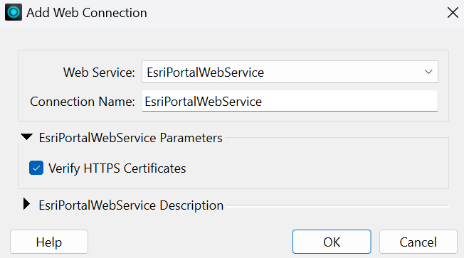

Click on the + sign to add a new connection.
Select the Web Service created in Step 2 and give your web connection a name. Click OK.

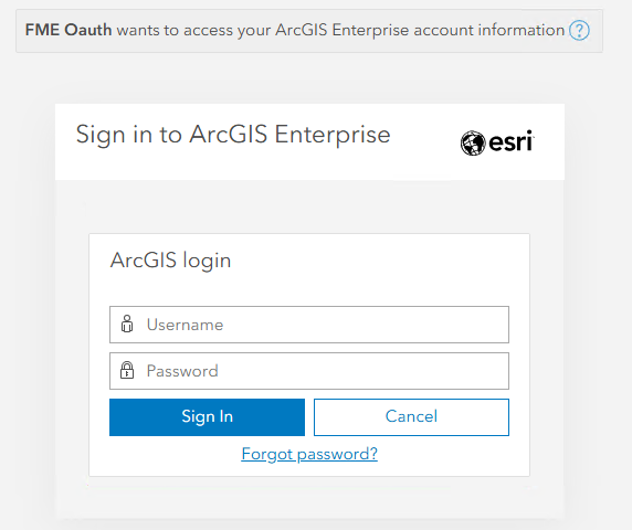

You will be redirected to your browser to enter your ArcGIS Enterprise Portal Credentials and authorize the web connection. Enter your credentials and click Sign In.
After successfully signing in, return to FME and confirm the authorization was successful. Click OK.
Your ArcGIS Enterprise Portal Web Connection is ready to use!

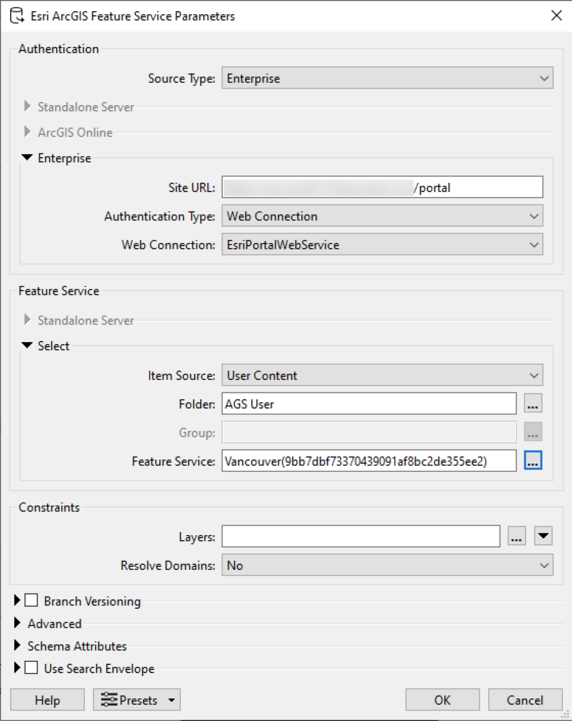

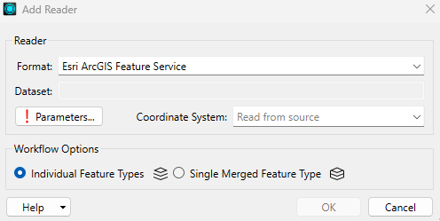

Add an Esri ArcGIS Feature Service Reader to the canvas and set the following fields:
  • Format: Esri ArcGIS Feature Service
  • Parameters:
    • Source Type: Enterprise
    • Site URL: https://<YourPortalURL>/portal
    • Authentication Type: Web Connection
    • Web Connection: <your portal connection>
    • Item Source: User or Group
    • Folder or Group: User Folder or Group selection available to you based on the Item Source
    • Feature Service: <any feature service available to you>
      • Click the ellipsis to select from your available feature service

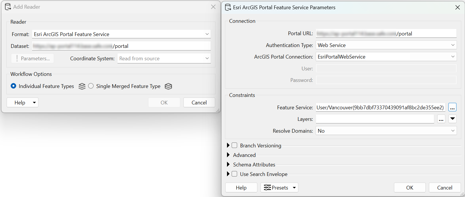

If you are using the legacy Esri ArcGIS Portal Feature Service instead of Esri ArcGIS Feature Service, refer to the prior steps to create a new web service and connection, substituting the Esri ArcGIS Portal (Template) web service for the Esri ArcGIS Enterprise OAuth (Template) (safe.esri-agol) web service. Follow the configuration below to test.
Add an Esri ArcGIS Portal Feature Service Reader to the canvas and set the following fields:
  • Format: Esri ArcGIS Portal Feature Service
  • Dataset: https://<YourPortalURL>/portal
  • Parameters:
    • Authentication Type: Web Service
    • ArcGIS Portal Connection: <your portal connection>
Click OK twice to create the reader.
Click Run to test that the reader works! Keep the workspace open; we will use it in Part 2.

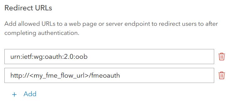

From the Content page in your ArcGIS Enterprise Portal, find the application created in Part 1. On the Settings page, scroll down to the Application panel.

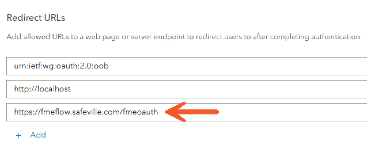

Scroll down to Redirect URLs and click Add. Add the Redirect URL for your FME Flow server in the format <my_fme_flow_url>/fmeoauth. For example:
Scroll to the bottom of the page and click Save to apply the changes.

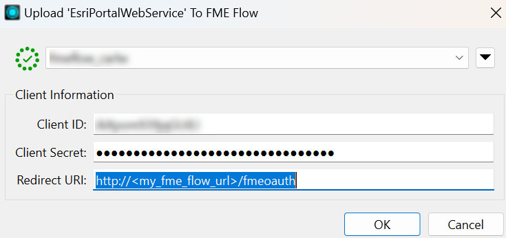

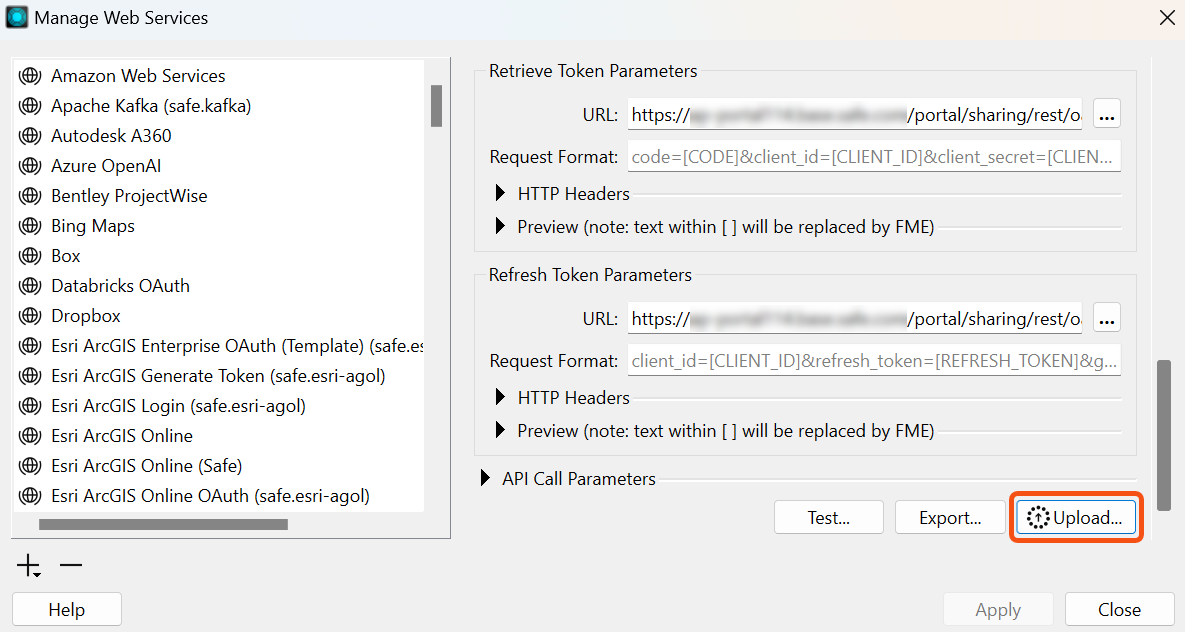

2. Upload the Web Service to FME Flow
Back in FME Workbench, navigate to Tools/Utilities > FME Options… > Web Connections > Manage Services… and then select the Web Service you created in Part 1
Scroll to the bottom of the parameters and click Upload.
Enter the Client ID and Client Secret from the ArcGIS Enterprise Portal Application. Next, add your FME Flow URL in the Redirect URI field in the format http://<my_fme_flow_url>/fmeoauth
Click OK. This will upload the web service to FME Flow.

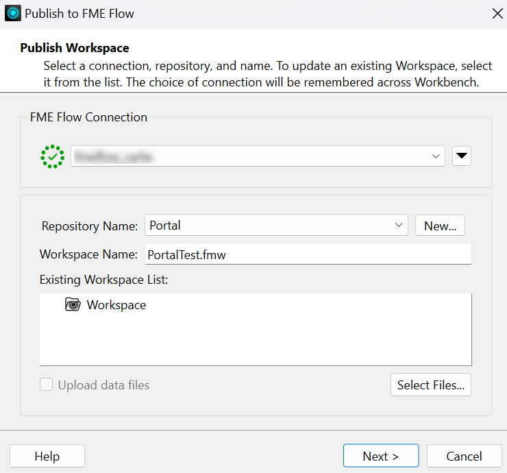

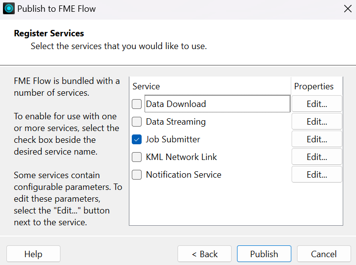

3. Publish the Workspace to FME Flow
Click File, and select Publish to FME Flow. Select your FME Flow web connection and click Next.
Create a new repository called Portal. Under Workspace Name, enter PortalTest.fmw and click Next.

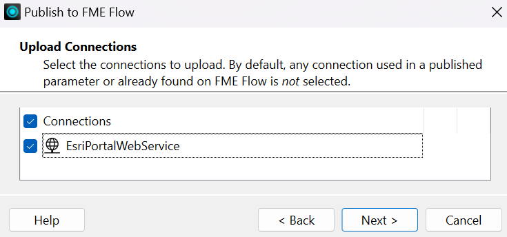

In the next window, upload the connection to FME Flow by selecting it and clicking Next.
Click Publish.

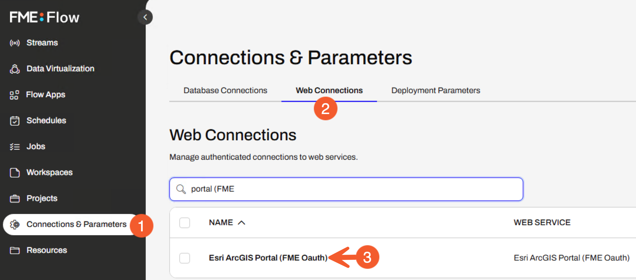

4. Authorize the Web Connection

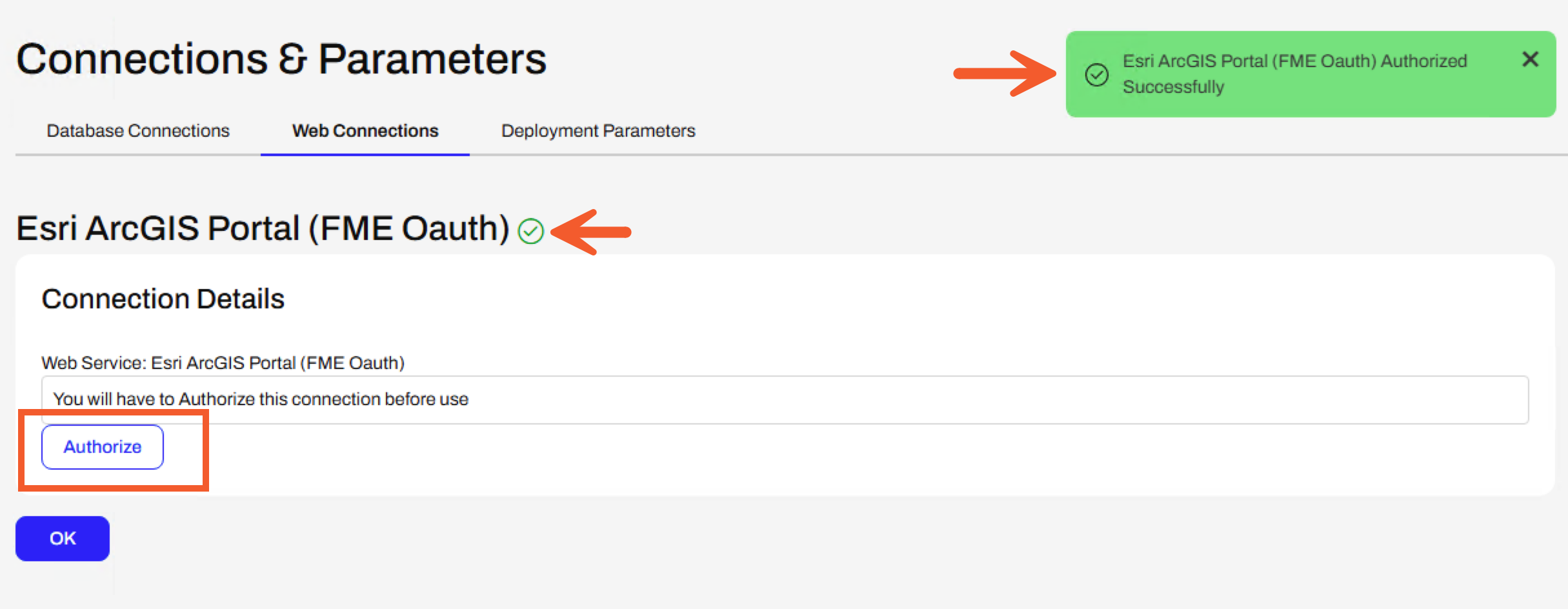

In FME Flow, go to Connections & Parameters, Web Connections, and then click your web connection name.
Click Authorize and enter your ArcGIS Enterprise Portal credentials when prompted. After successfully authorizing the connection, there should be a green check mark.
