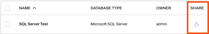

Connection owners can share their connections after they have been created. Users with permission to manage connections can also share connections they have been granted Write access to. In FME Flow, click the share icon next to the connection you want to share.

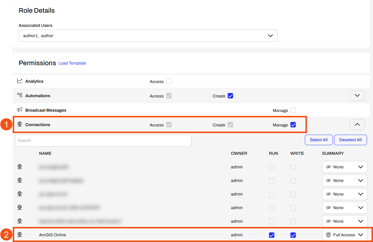

Prevent authors from creating, editing, or removing connections on FME Flow

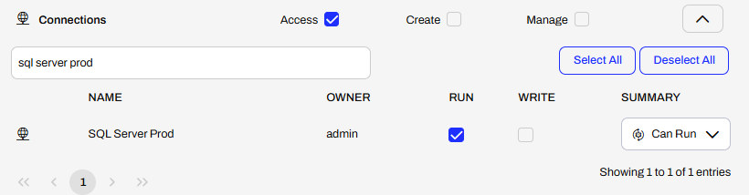

By default, the fmeauthor role has permission to access, create, and manage connections. To restrict this, administrators can remove Create and Manage permissions.
Authors and other users can still run workspaces in FME Form and Flow with connections as long as they have Access permission and Run permission for the individual connection. For example:
This setup allows FME Form users to author and run workspaces with existing connections. However, without permission to create connections, authors need to switch to a personal or shared connection storage location in FME Form when needed. They will not be able to upload new connections to FME Flow from FME Options or when publishing a workspace to FME Flow. In this more restricted workflow, authors can provide their connection details to an FME Flow administrator who can create it on their behalf and grant the author Run permission.

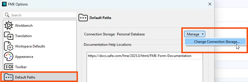

1. Open Utilities > FME Options > Default Paths
2. From the Manage menu, choose Change Connection Storage

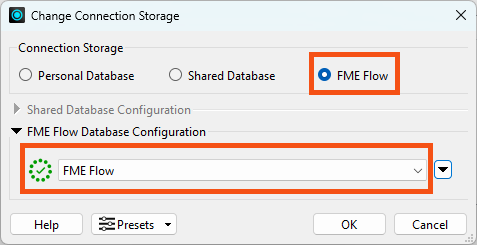

3. Choose FME Flow as the Connection Storage option
After choosing FME Flow, you can choose the FME Flow connection to use or create a new one. This connection will be created in your personal connection database, so it is not lost when you disconnect from FME Flow.
The account used in the FME Flow connection determines what permissions you will have for viewing, creating, or modifying connections.

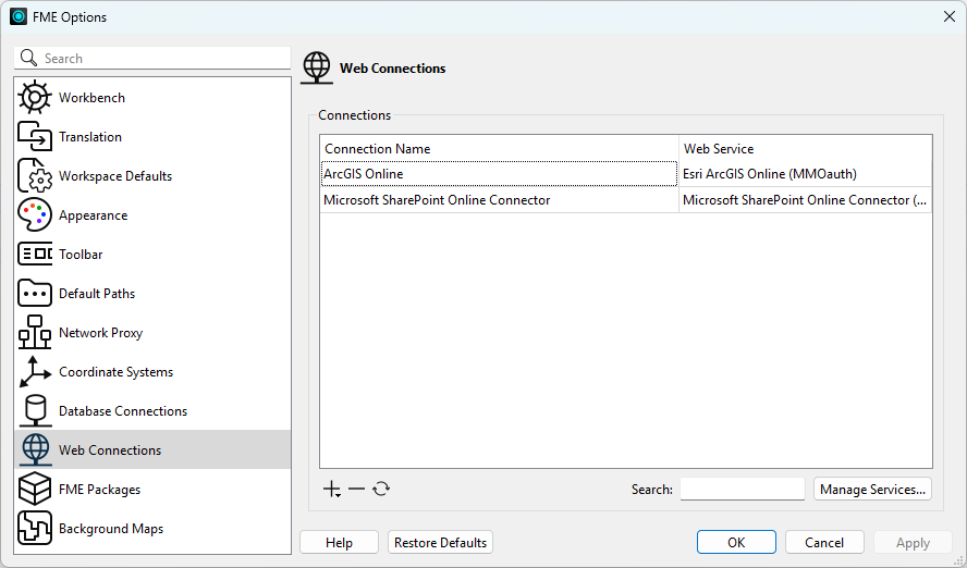

4. View Connections
Any database and web connections your FME Flow account has access to will be listed in FME Options under Database Connections and Web Connections, provided you are connected to the FME Flow instance.

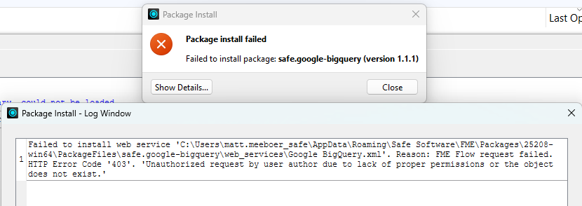

“I receive the error ‘Package install failed’ when I try to install a package.”
Click “Show Details…” and check the error details. If there is a 403 Unauthorized request, it’s likely because your FME Flow account doesn’t have permission to create connections, which means you can also not create web services.
Many packages include web service templates. When FME Flow is set as the connection storage location in FME Form, FME Form tries to install the web service template in FME Flow.
