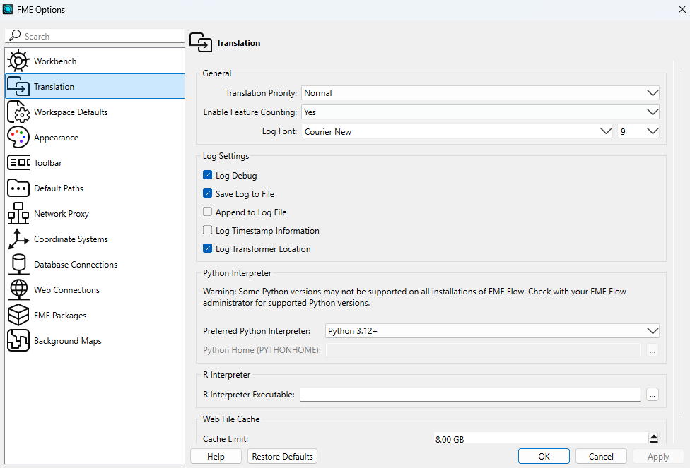

Enable Debug Logging in FME Workbench
Open the workspace in FME Workbench. In Workbench settings, turn on the Log Message’s debug filter. From Windows:
Main Menu > Tools > FME Options… > Translation > Log Settings
Log Debug is applied for all workspaces run in Workbench while the setting is enabled.

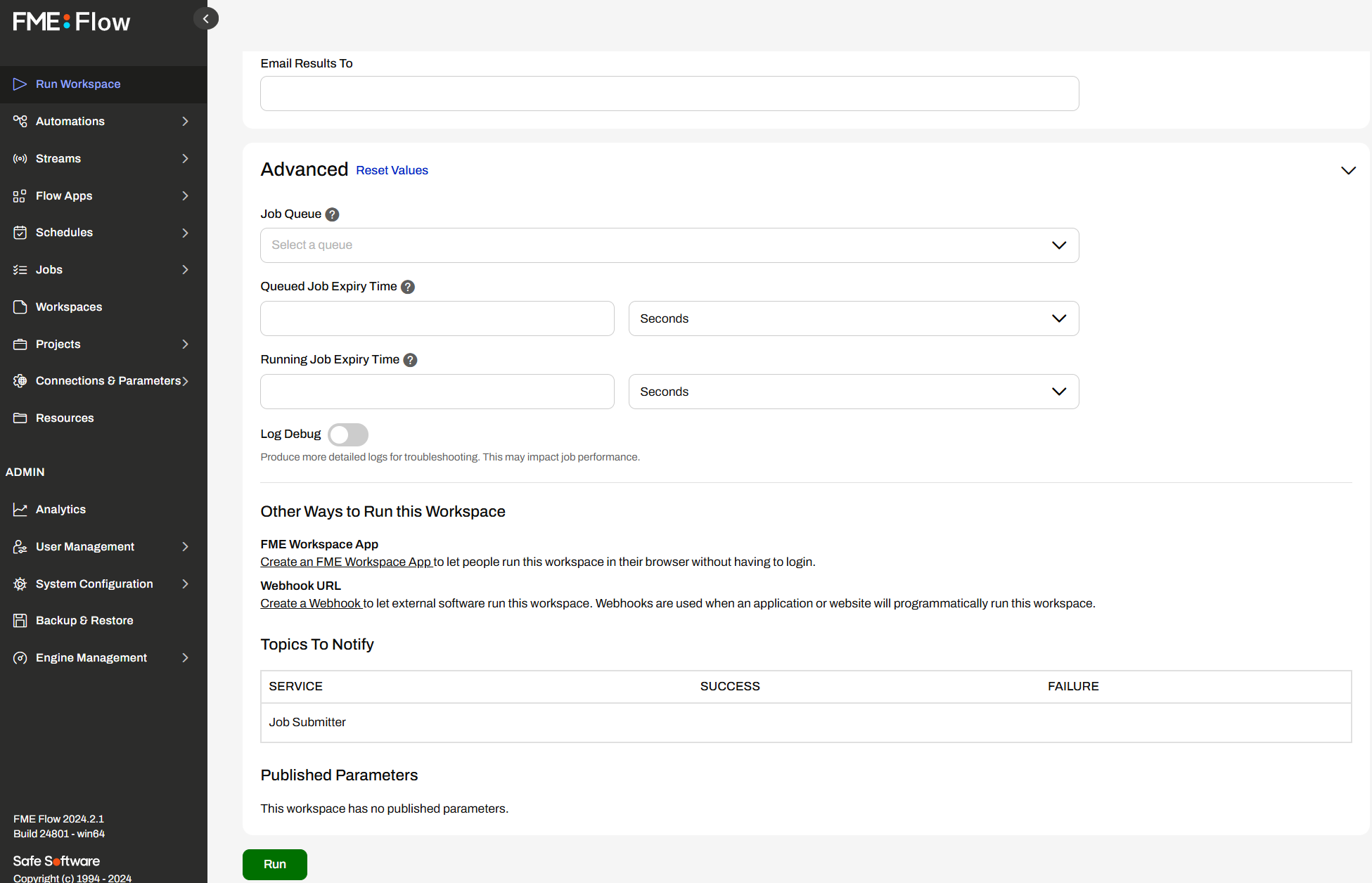

Enable Debug Logging in FME Flow
To enable debug logging for Run Workspace in FME Flow, log in to FME Flow and check the "Log Debug" option under:
FME Flow Homepage > Run Workspace > Advanced > Log Debug
To enable Log Debug for all jobs for the same workspace, republish the workspace to FME Flow with Log Debug enabled in FME Workbench.
Once Log Debug is enabled, a more detailed job log can be found under "Jobs > Completed" after running the workspace.

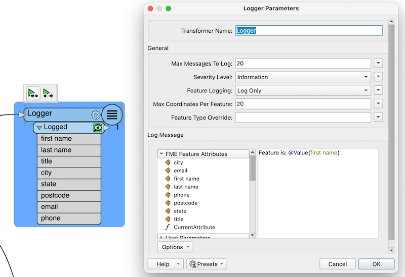

Logging Workspace Values
To log values at any point in a workspace, connect a Logger transformer to an existing output port. If you’re interested in just a specific attribute, select it in the Logger’s text editor.
Logger in Workbench
Republish the workspace to FME Flow and rerun the translation. In the job log, search for the “Logger” message. Are the attribute values expected or valid?
LoggedMessage.pngThe value for the “first name” attribute is recorded in the job log, in addition to the feature’s other attributes.

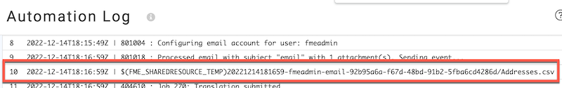

Logging Automation Values

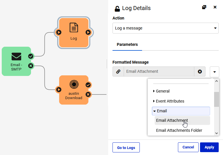

To log values at any point in an Automation, connect a Log Action to a success or failure port. Use the Log Action’s Formatted Message drop-down menu to select a single upstream value or use the Text Editor to log several values.
A Log Action is connected to the “Success” output port of an Email Trigger. The drop-down menu allows us to select the incoming email attachment value.
Trigger the automation and review the automation log. The logged value will follow the event.
