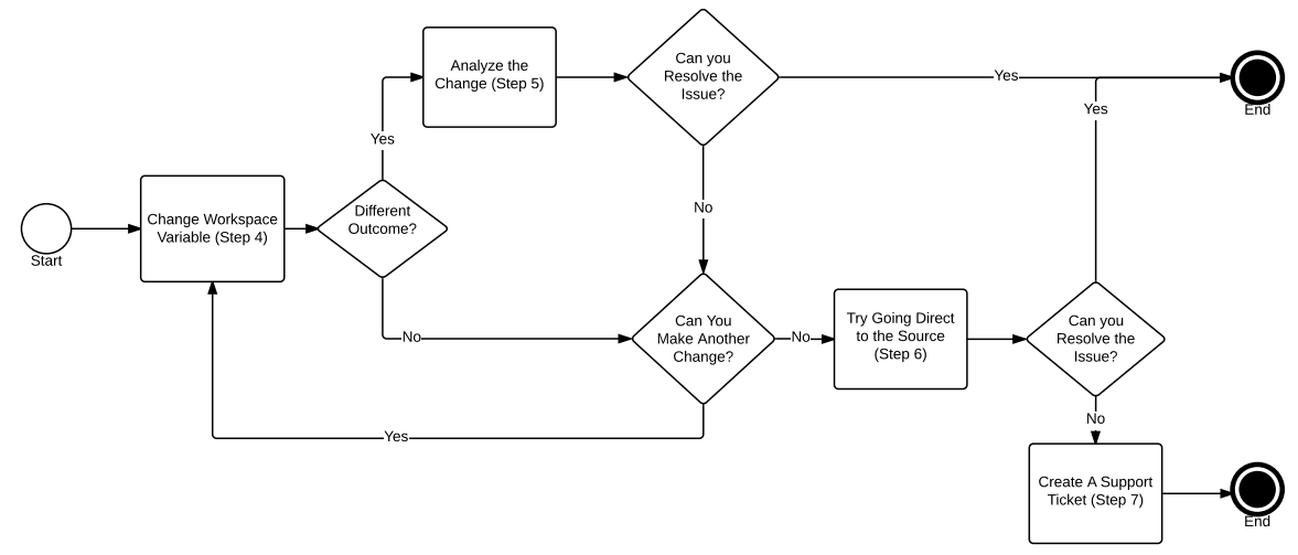

This step is designed to either resolve the issue or determine the next course of action. Here is a flowchart of the process:
Yc7A79fnCWnFa7-w5m2LJk_4OBapwWOGKoMnq3eYjn3Lk2IhEA40-LgnHUg0yYVpSZ1jbI8bsbfLt-H8zhGKwZ-BXzletpoCSoO2pn9kK0yA2MP2oTiTFNvZ9RjpdG42NYfcU370
When a specific change alters the workspace outcome, it should help you identify a possible root cause.

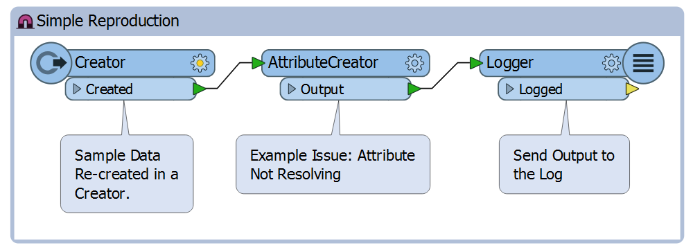

Example of a simplified reproduction:
TSxn5IsV_Pj-wlT2uZkECL44BYOdYX04KE7SYQMhS51IqkrN7bigKVt3m8TMW1GeJmuz3bMZeikdi_MfquxwuhKSmgsaQ0glfwY2b8M0m2E_5_rOiF1wxqMklGQy0fTyzltG4aiU
After each simplification step, ensure that the problem still exists. If during this process you discover that the outcome has changed, go back to step 5 above and analyse the new information.
