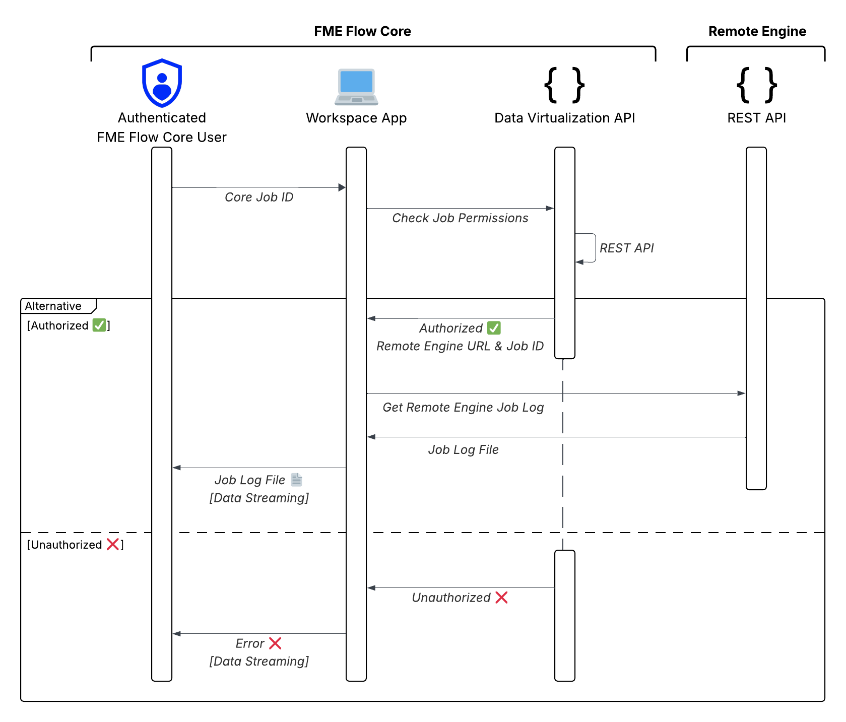

This article presents a solution for retrieving a remote engine job log using several FME Flow tools:
  1. A Workspace App for a user to enter a core job ID
  2. A Data Virtualization API to verify the user’s job permissions and get the associated remote engines service URL and job ID
  3. The FME Flow REST API to retrieve the job log from the remote engines service
The diagram below illustrates the flow:

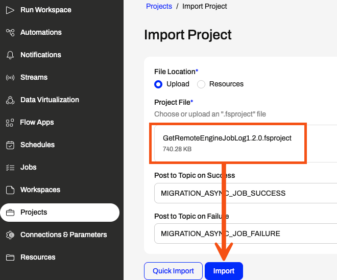

A sample FME Flow project has been created and attached to this article. To learn more about importing projects, please refer to the FME Flow Documentation. The basic steps are below.
To follow along with this tutorial, please download the GetRemoteEngineJobLog1.2.0.fsproject file from the Files section to the right of this article’s content.

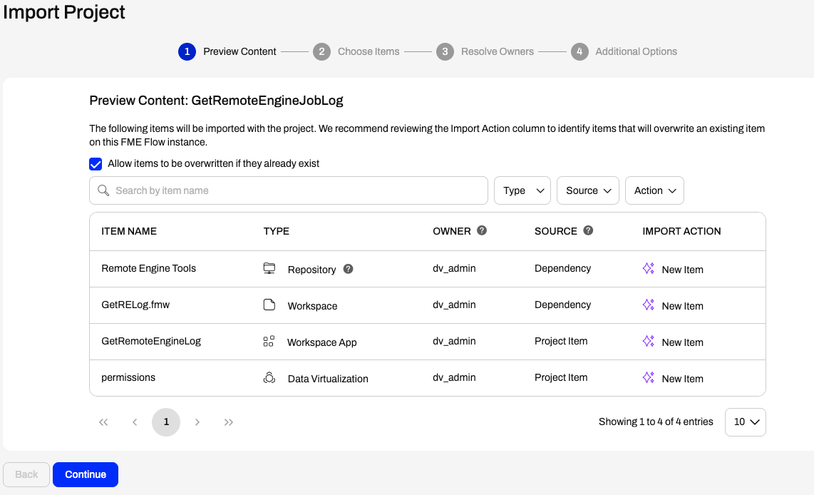

1. Import the Project
Log in to FME Flow as an administrator. Go to projects and click Import. Select the fsproject file you downloaded. Click Import.
2. Preview the Content
Provided you do not have items already in your FME Flow installation with the same names, everything should be imported as new items. The items are:
  • GetRemoteEngingLog Workspace App, along with its workspace and repository dependencies
  • Permissions Data Virtualization API
Click Continue.

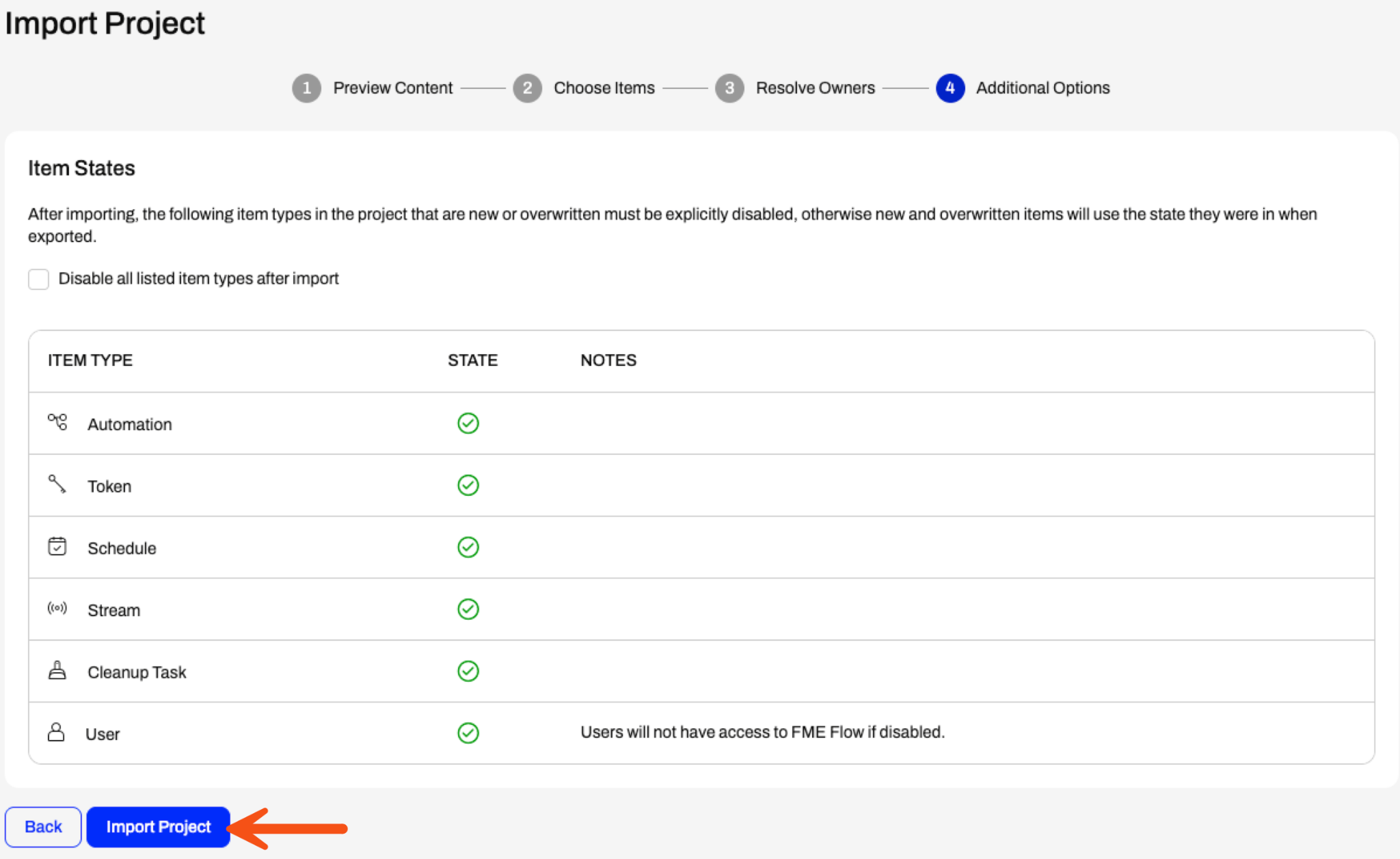

Finally, click Import Project to start the import.

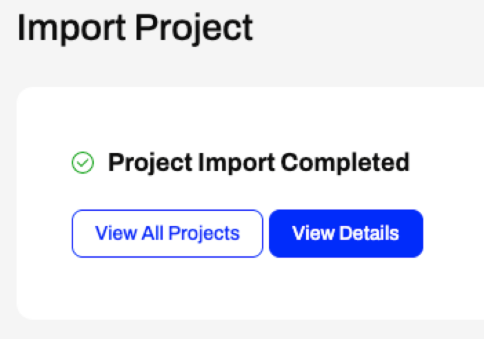

4. Confirm That the Project Imported Successfully
You should receive confirmation that the project import was successful. If not, click View Details to review the log for error messages.

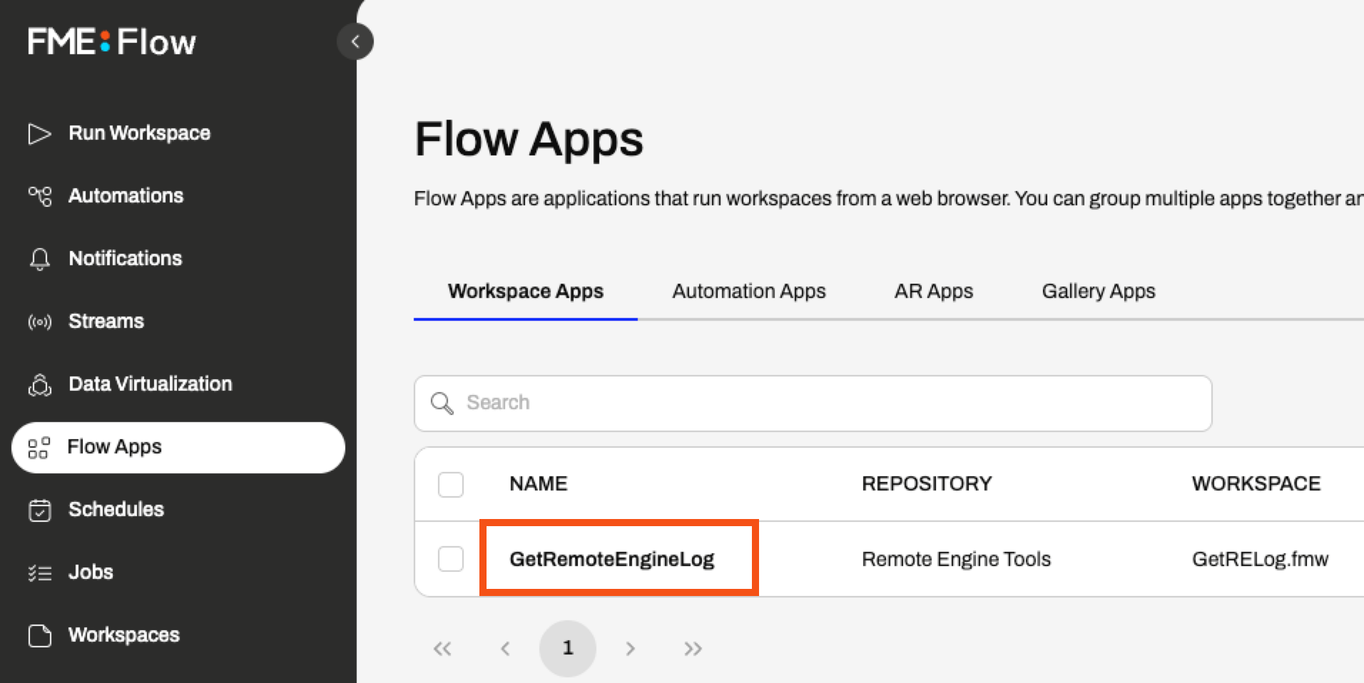

1. Open the GetRemoteEngineLog Workspace App
Go to Flow Apps, Workspace Apps, and click on GetRemoteEngineLog.

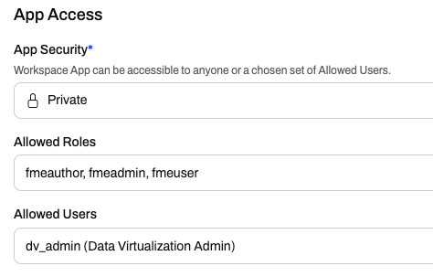

To verify if a user has access to a job, authentication has been enabled. The default FME Flow roles that can access jobs are allowed, but this can be changed depending on your installation and role permissions.
Role-based access control (RBAC) is always strongly recommended when managing access. As an owner, dv_admin appears in the Allowed Users list, but all other access is managed through roles.

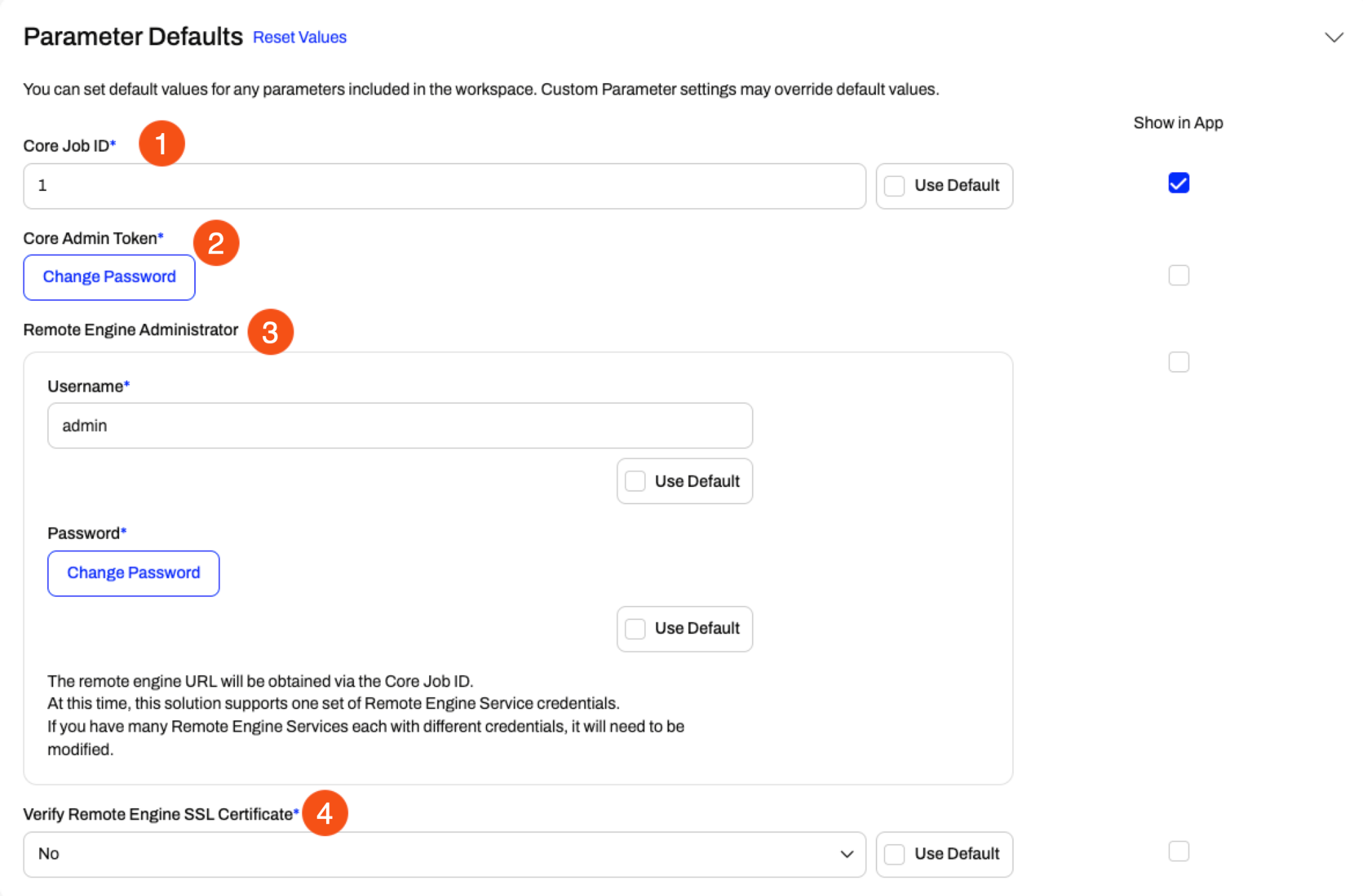

4. Configure the Parameter Defaults
Expand Parameter Defaults and update them as follows:
1. Core Job ID: This is the only parameter displayed to the user. Leave it as 1 or enter a different numeric value.

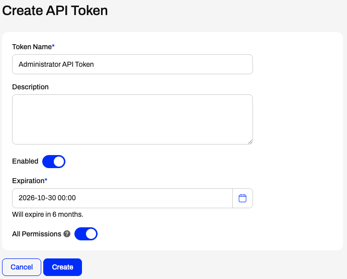

2. Core Admin Token: the API token used to check job permissions on the FME Flow core using the Permissions Data Virtualization API and FME Flow REST API. It must be a token created by an administrator user with ‘All Permissions’ enabled, including the new Permissions Data Virtualization API imported earlier. For example:
If you have not created an API Token before, please follow the steps here: Authorization in the FME Flow REST API | Token Management.
3. Remote Engine Administrator: Enter the admin credentials for your remote engines service. These are the same credentials used when adding the remote engines service in Engine Management. Note that at this time, only one set of remote engine service credentials is supported (if you have multiple). Also, remote engines services in Snowflake are not supported due to the extra layers of authentication required.
4. Verify Remote Engine SSL Certificate: If you’re receiving SSL errors, set this to No for troubleshooting. Otherwise, it should be set to Yes. If your remote engines service is not secured with a recognized CA cert, you may need to import the certificate into the core server before setting this to Yes.
5. Save
Save the changes you’ve made to the workspace app.

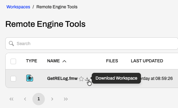

1. Download the GetRELog.fmw Workspace
The workspace is located in the Remote Engine Tools repository, which was created when the project was imported.

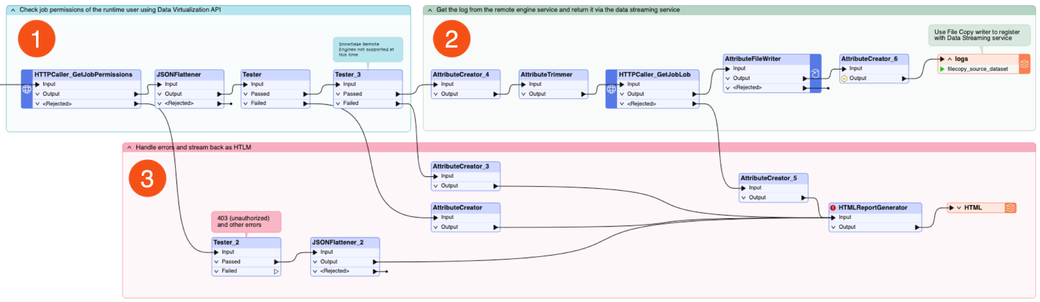

The workspace has three bookmarks:
Check job permissions
Get the log
Handle errors
We won’t review every transformer in each bookmark; we'll focus on the key ones.

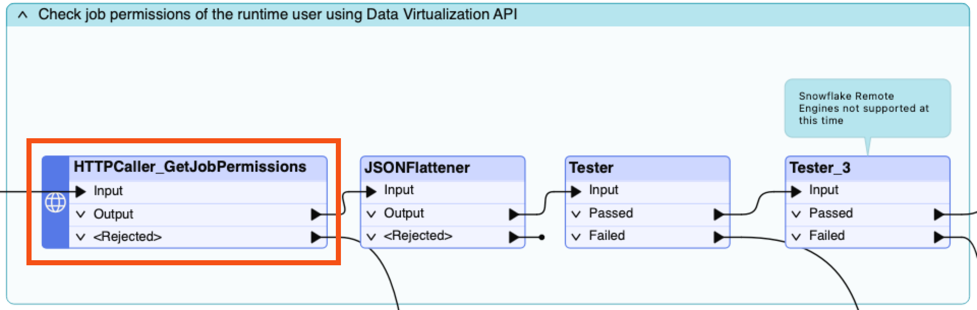

3. Review the “Check job permissions” Bookmark

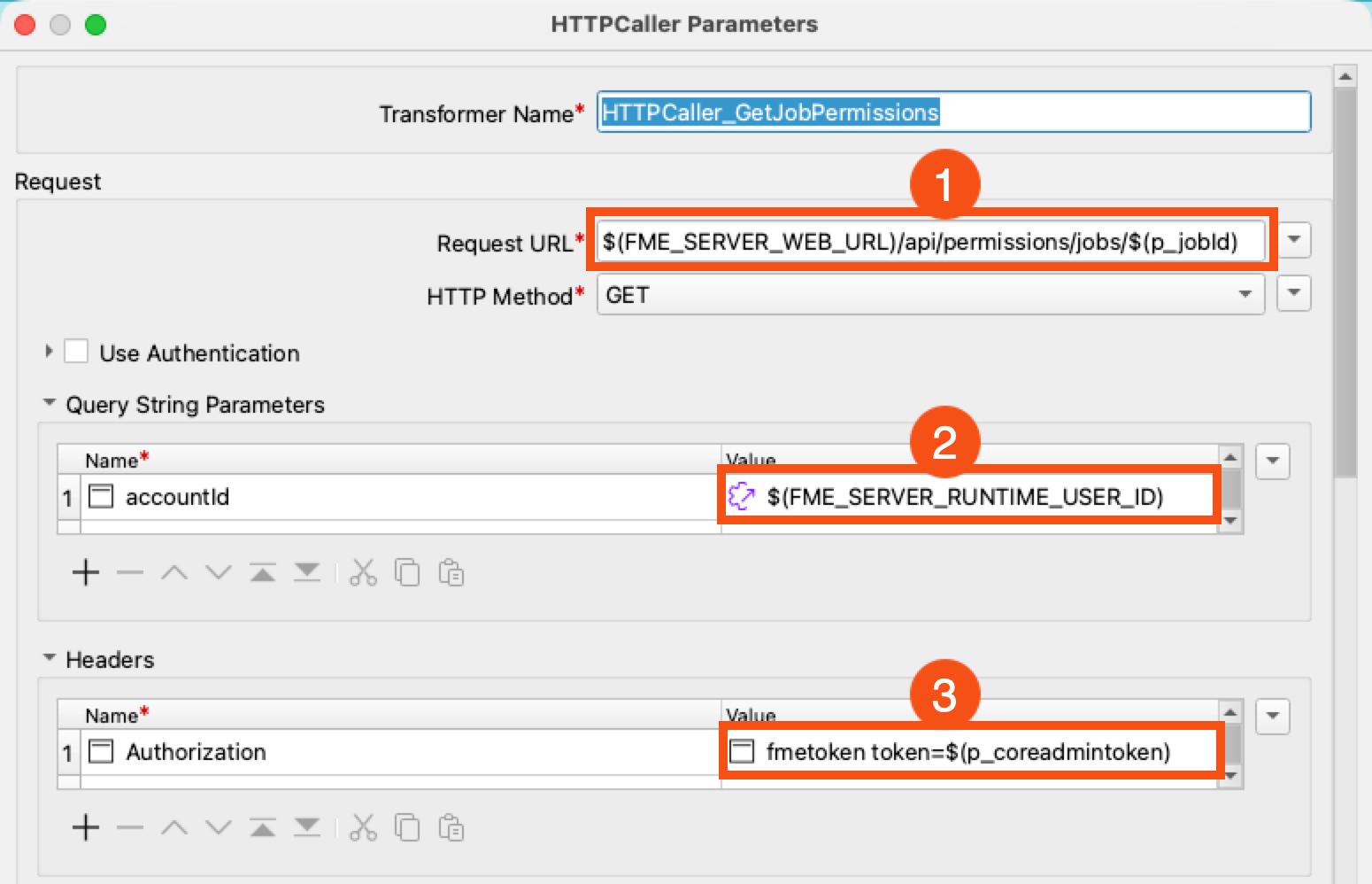

The “Check job permissions…” bookmark is the first light-blue bookmark on the top-right. The main consideration here is the HTTPCaller_GetJobPermissions.
The HTTPCaller_GetJobPermissions:
  1. Makes a GET request to the data virtualization endpoint /permissions/jobs/{id}, using the FME_SERVER_WEB_URL FME Flow parameter and passing the Core Job ID the user provides as a parameter.
  2. Supplies the user ID of the authenticated user who submitted the GetRemoteEngineLog Workspace App request via the FME Flow parameter FME_SERVER_RUNTIME_USER_ID
  3. Authenticates with the admin token you set up in Part 2
This call returns information about the core job and its associated remote engine job, including the server URL and jobId, or an error if the user is unauthorized.
We’ll take a closer look at how the Permissions Data Virtualization API works in the next part. If the request succeeds and the user is authorized to view the requested job log, the response JSON is parsed, and we proceed to retrieve the job log from the remote engines service.

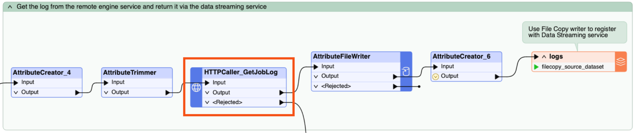

3. Review the “Get the log…” Bookmark

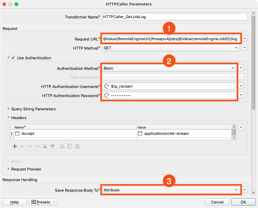

The “Get the log…” is the green bookmark on the top right. If the user has permission to view the core job log, then the HTTPCaller_GetJobLog will download the associated remote engines service job log.
The HTTPCaller_GetJobLog:
  1. Makes a GET request to the remote engines service’s REST API endpoint /jobs/{id}/log, using the URL and JobID from the /permissions/jobs/{id} response
  2. Authenticates with the remote engines service admin credentials, which are provided via parameters
  3. Returns the job log as binary data and saves it to an attribute

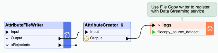

The log file data is written to the FME Flow Shared Resource Temp location, $(FME_SHAREDRESOURCE_TEMP)/RemoteEngineTools/logs, using the AttributeFileWriter. A FileCopy writer is used simply to register with FME Flow’s Data Streaming service, so that the job log can be streamed back to the user.
4. Review the “Handle errors…” Bookmark

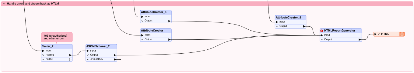

The last bookmark in the GetRELog.fmw workspace is the red “Handle errors…” bookmark. Any errors, such as unauthorized access, are logged here so they can be returned to the user as HTML.

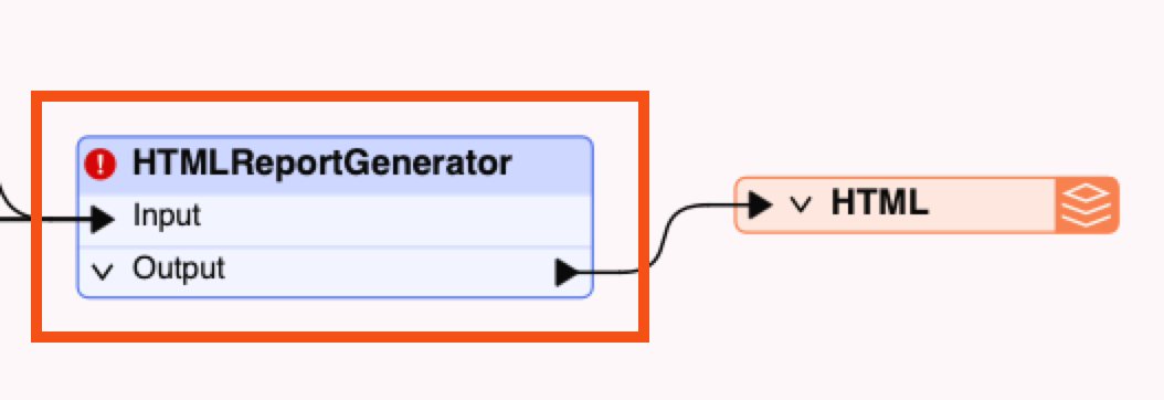

The HTMLReportGenerator formats the HTTP status code and any error message into HTML.
The HTMLReportGenerator includes CSS styles to improve the appearance of the error message streamed back to the user. You can revise this style later, if you’d like.
In the screenshot, this transformer is incorrectly flagged as incomplete due to a small bug that was unresolved at the time this article was written. The error can be ignored.

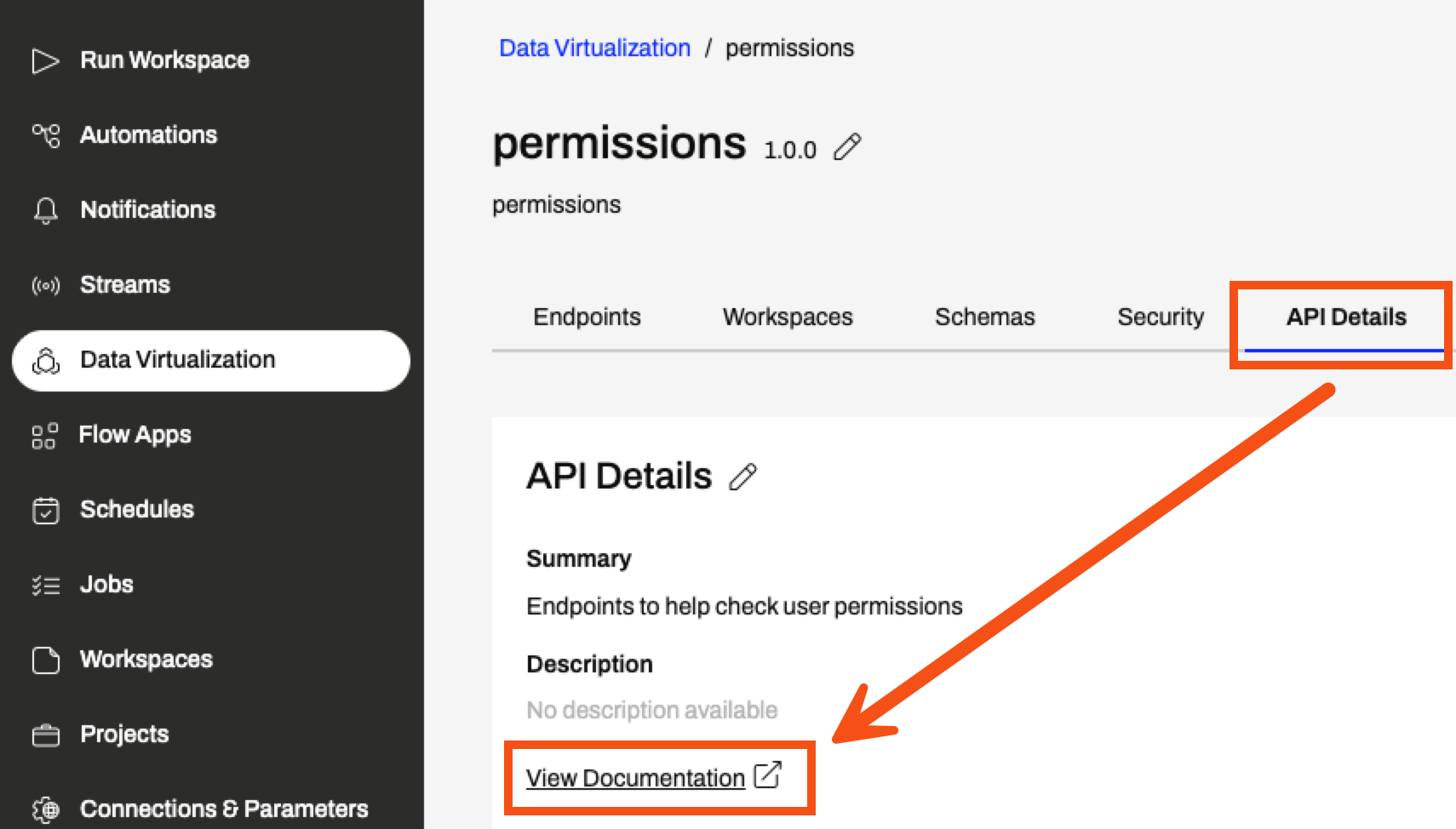

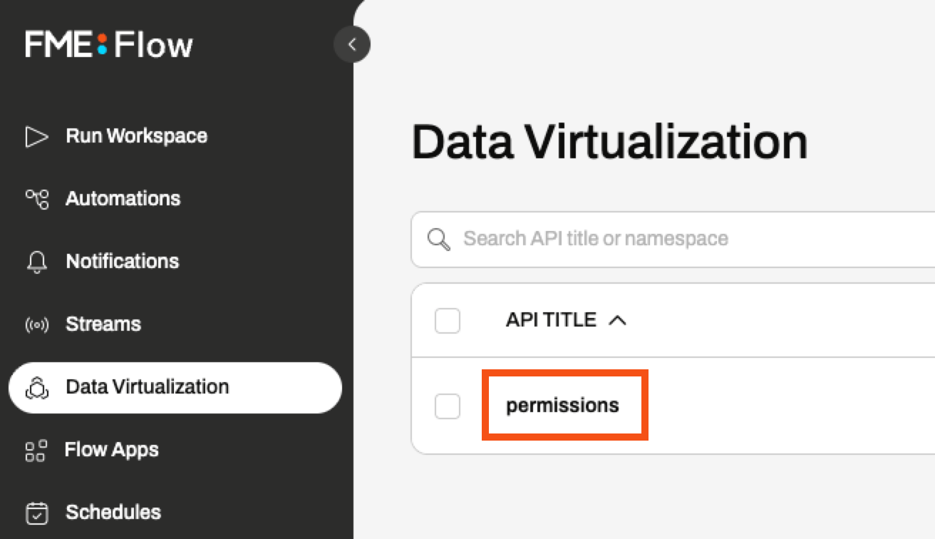

2. Open the Permissions API
Go to Data Virtualization, then click permissions.

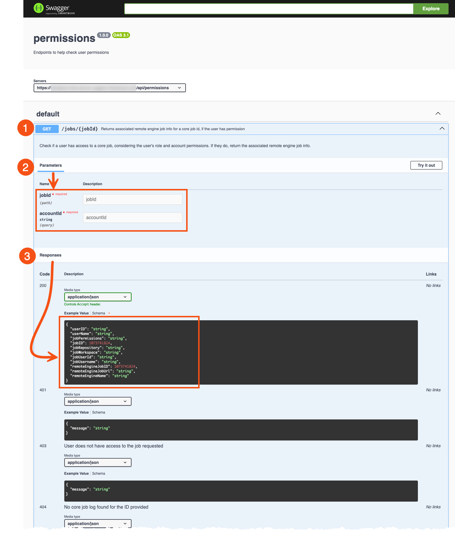

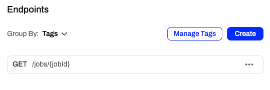

3. Review the /jobs/{jobId} Endpoint
This API has a single endpoint: /jobs/{jobId}
For the purposes of this article, we’ll review the Swagger API documentation generated by data virtualization. If you want to learn more about data virtualization, please see Getting Started with Data Virtualization. If you’re already familiar with data virtualization, you can use FME Form to download the workspace used by this endpoint.
To view the Swagger documentation, click the API Details tab, then View Documentation.
The Swagger documentation tells you all about the /jobs/{jobId} endpoint, including the:
  1. Type of method (GET) and the endpoint (/jobs/{jobId})
  2. Parameters this endpoint requires
  3. Potential responses and response schema
This information is used to create the request inside the HTTPCaller_GetJobPermissions transformer, which was reviewed with the GetRELog.fmw workspace in Part 3.

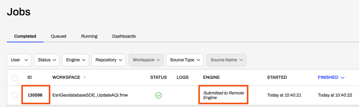

1. Submit a Job to the Remote Engine
Log in to FME Flow and submit a job to the remote engine.
Confirm that the job was submitted to the remote engine. Take note of the job ID.

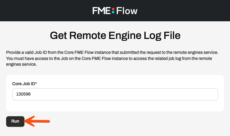

2. Retrieve the Job Log
Open the GetRemoteEngineLog workspace app:
<your FME Flow URL>/fmeserver/apps/GetRemoteEngineLog
Enter the Job ID and click Run.
The workspace app calls the data virtualization endpoint to check permissions, and if it’s successful, streams the job log back. Your browser should begin downloading it automatically. Note that the ID for the job log downloaded will be different than the core job log ID you entered.

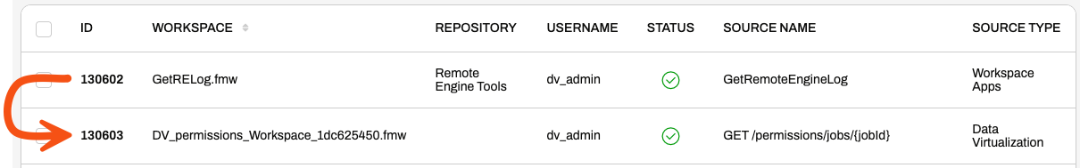

3. View Data Virtualization Jobs
Each time the workspace app runs, the Permissions Data Virtualization API is called, and its workspace is run. You’ll see this on the Jobs page in FME Flow:

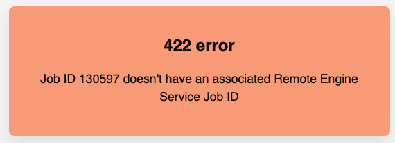

4. Test an Error Message
Try some other use cases to further test the app.

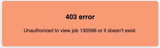

Log out of FME Flow and log in to the GetRemoteEngineLog app as a user in the fmeauthor role. The fmeauthor role only has Access job permissions, so users in this role should not have access to the test job submitted in the last step.
Try to get the job log. Since the user doesn’t have access, you should receive a 403 error:
Try to get a job log for a job that was not submitted to the remote engine. You should receive a 422 error:
