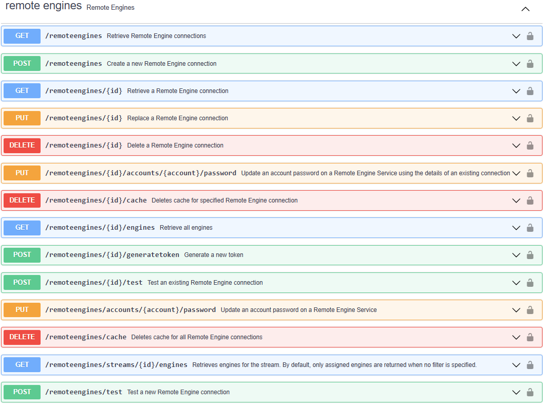

The service uses REST API for all communication between FME Flow core host and the remote engine host. A publicly accessible endpoint or opening additional ports is not required on FME Flow core [since all the requests originate from the core side]. Only the HTTP/HTTPS port must be opened on the Remote Engine host to be publicly accessible. You can install the remote engine service on multiple environments [on-premise, FME Flow Hosted, or other cloud platforms] and connect it to the same core host.
Below is a screenshot of all the remote engine-related API calls in FME Flow REST API V4, which has officially been released in FME 2025.1. This would help integrate with an existing CI/CD workflow in your organization.
As of FME Flow 2025.1, the V3 REST API has been deprecated. The current API will remain accessible, but no new features or general bug fixes will be implemented. Starting with FME Flow 2026.1, the V3 API will be removed. We encourage all users to prepare their systems for this change.
The V4 REST API offers enhanced security and usability, including new and reorganized endpoints, as well as the removal of certain endpoints. For information on migrating from V3 to V4, please see the FME Flow REST API V4 documentation and click on the heading Migrating from REST API V4.
The service supports two types of clients: FME Flow and third-party Applications. Third-party apps can use the REST API public endpoints to run job workflows, such as POST /remote engines/jobs/submit.
There are also some hidden endpoints for configuration between the core and remote engine, since the core will be used to develop and deploy job workflows to the Remote Engine service.
