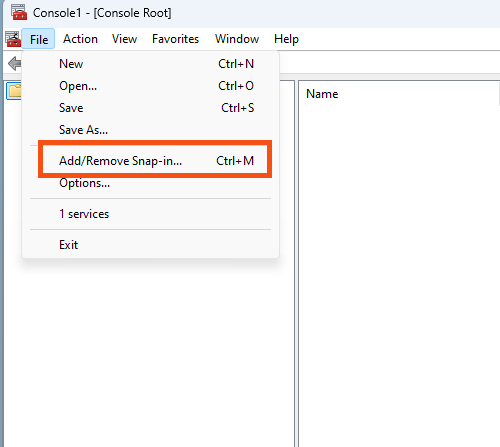

3. Add the Certificates Snap-in
  • Select File > Add/Remove Snap-ins.

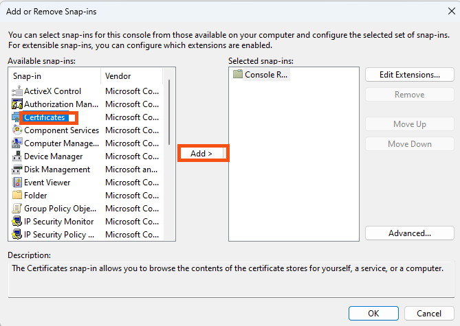

4. Click Certificates, then click Add

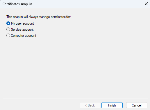

5. Select My User Account.
  • This step is unnecessary if you are running mmc.exe as administrator and FME Flow's services are run under "Local System"

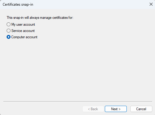

6. Click Add again, and this time select Computer Account.
