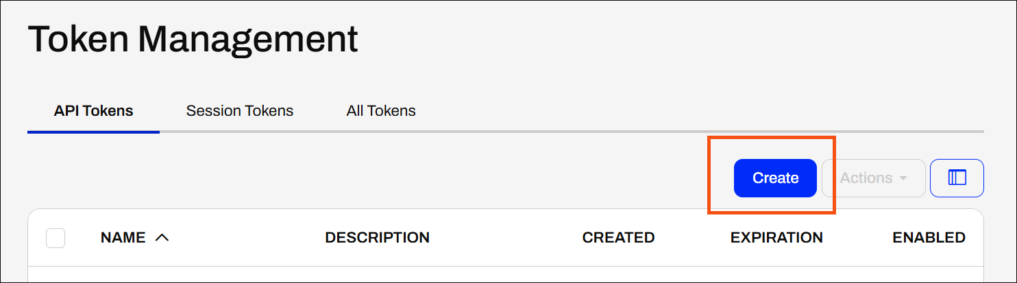

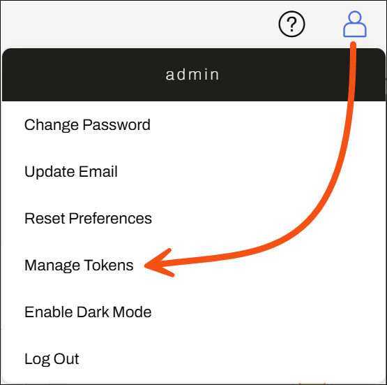

2. Open the Tokens Management Page
In the top-right corner, click on the user icon, and from the drop-down select Manage Tokens.

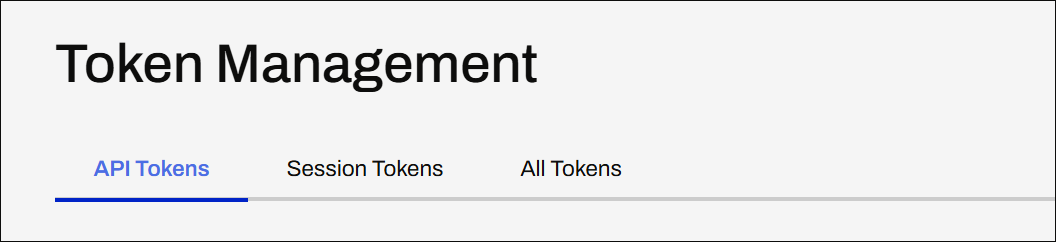

Depending on your level of permissions, you may see API Tokens, Session Tokens, All Tokens as tabs across the top of the Token Management page. For this demo, we will be focusing on API tokens. To learn more about the other options, see the documentation.
3. Create a New Token - Metadata
In the API Token section, click on New to create a new token.

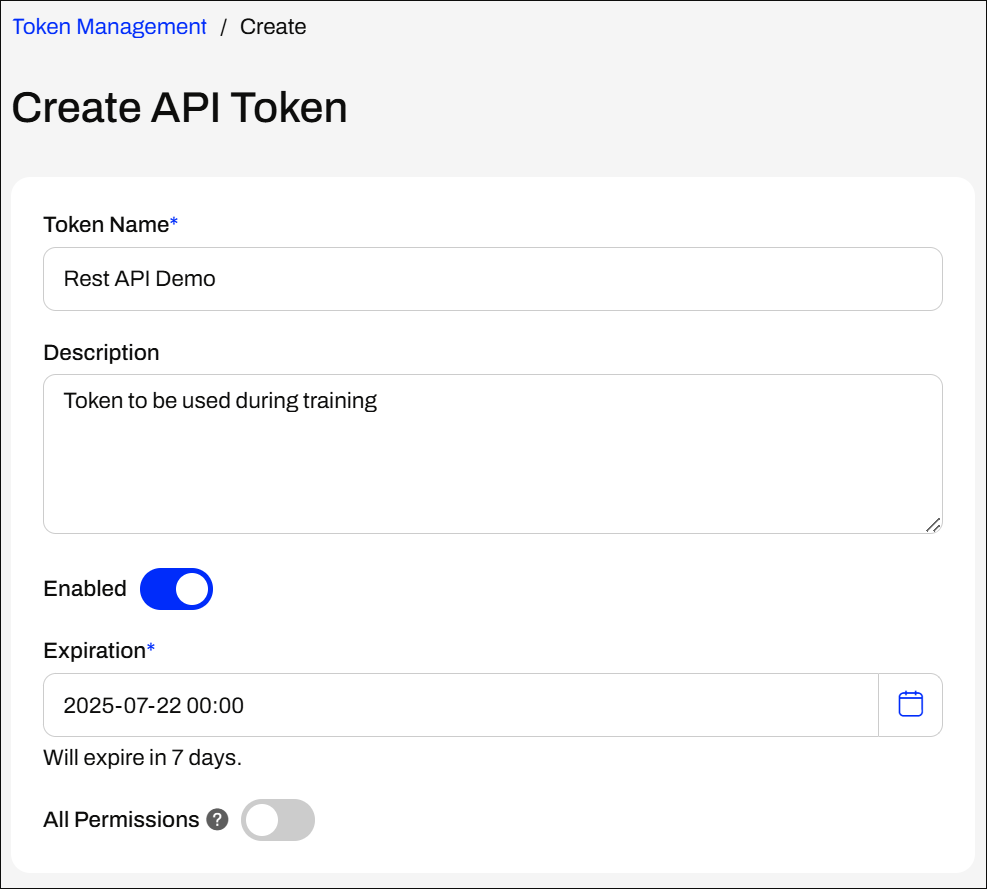

On the Create New API Token page, enter the following parameters:
  • Token Name: REST API Demo
  • Description: Token to be used during training
  • Enabled: On
  • Expiration: 1 week
  • All Permissions: Off

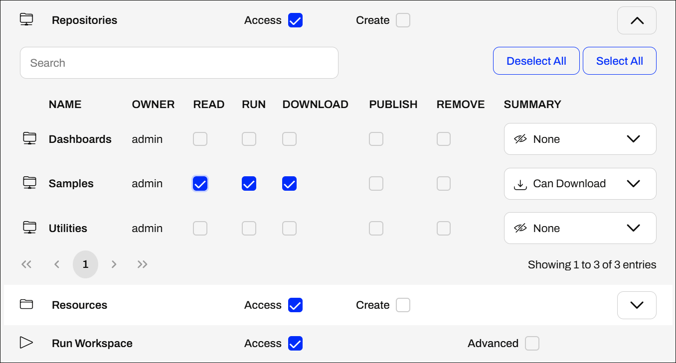

4. Assign Permissions to Token
Next, we need to assign permissions to the token. This token can list, download, and run workspaces in the Samples repository. Other tasks need different permissions. See Permissions by Task later in this article, and set the permissions for your specific use case. To learn more about what each permission includes, see the documentation: expand To Create an API Token > About permissions in FME Flow, then expand the permission of interest.
Permission Level of Permission
Repositories Access
Individual Repositories - Click the drop-down arrow to expand the section Samples = Download, Read, Run
Resources Access
Run Workspace Access
If you are creating a web application, the permissions for the token should be limited to a specific repository.
This baseline lets a token list, download, and run workspaces in the Samples repository. It does not cover every task in the REST API articles. For example, with this baseline, viewing a job's status or result returns a 403 error. Those requests need Jobs > Manage. See Permissions by Task later in this article for the minimum permissions for each task.
Once the permissions have been set, click Create.

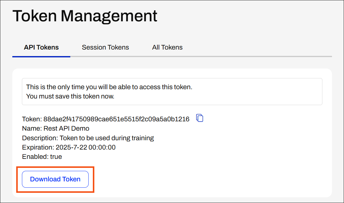

5. Download Token
Once the token has been created, you will see a page with your token visible. This is the only time you’ll be able to see this token within FME Flow. To access it later, click the Download button to download the token.
The token is downloaded in an unsecured text (.txt) file.

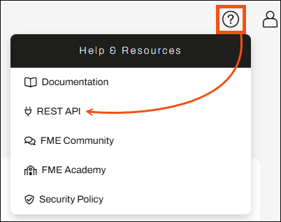

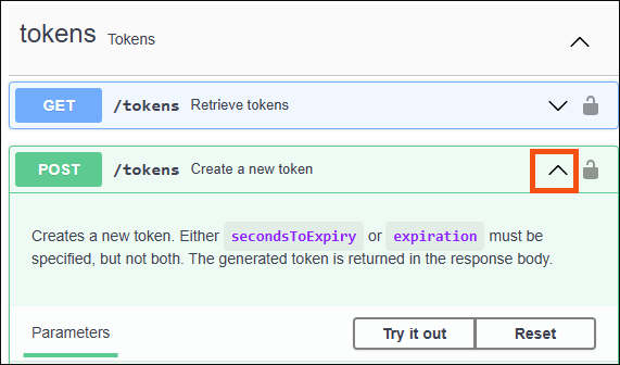

To test this API call, you can access the API documentation through your FME Flow web UI. On the homescreen, click the question mark icon at the top right corner and select REST API.
Select API Endpoints, and scroll to the Tokens header. Click the arrow to open all the token endpoints and select POST /tokens. Next, click Try it out, and you'll be prompted to log in to your FME Flow. After you enter your credentials, click Execute, and the responses will be shown below.

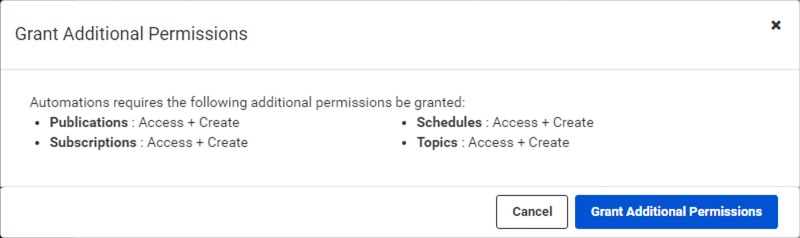

Grant Additional Permissions
There are many intertwined features within FME Flow that rely on permissions for other features to work, such as Automations. After clicking OK, depending on which permissions were set, a pop-up dialog may appear asking to grant additional permissions for other features. When creating the token, it is important to evaluate whether or not the token user will actually need access to these features.

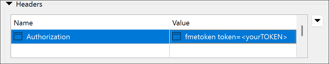

Tokens can be included in the authorization header or in the query parameter
Authorization Header
Including the token inside the Request Header is the preferred method. This is because the token will be hidden inside the call.
The name of the header would be Authorization, and the Value would be:
fmetoken token=<yourTOKEN>
Replace everything after the = with your token that you downloaded from FME Flow.
