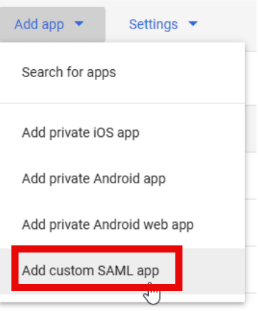

  2. Click Add App > Add custom SAML app.

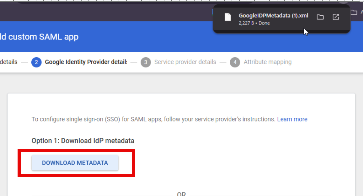

  3. On the "Google Identity Provider details" page, download the IdP metadata file to be uploaded to the FME Flow Web user interface later.

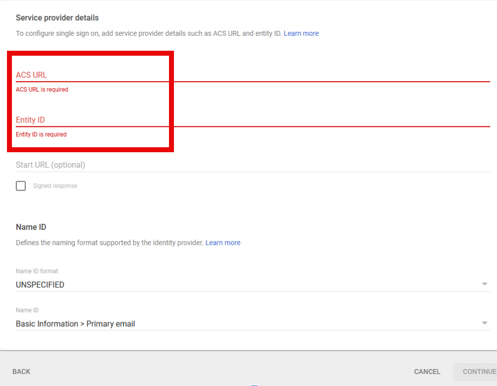

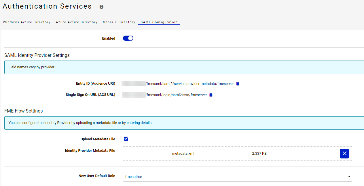

  4. In the "Service Provider details" section, provide the Entity ID and ACS URL displayed on the "SAML Configuration" webpage of your FME Flow instance.

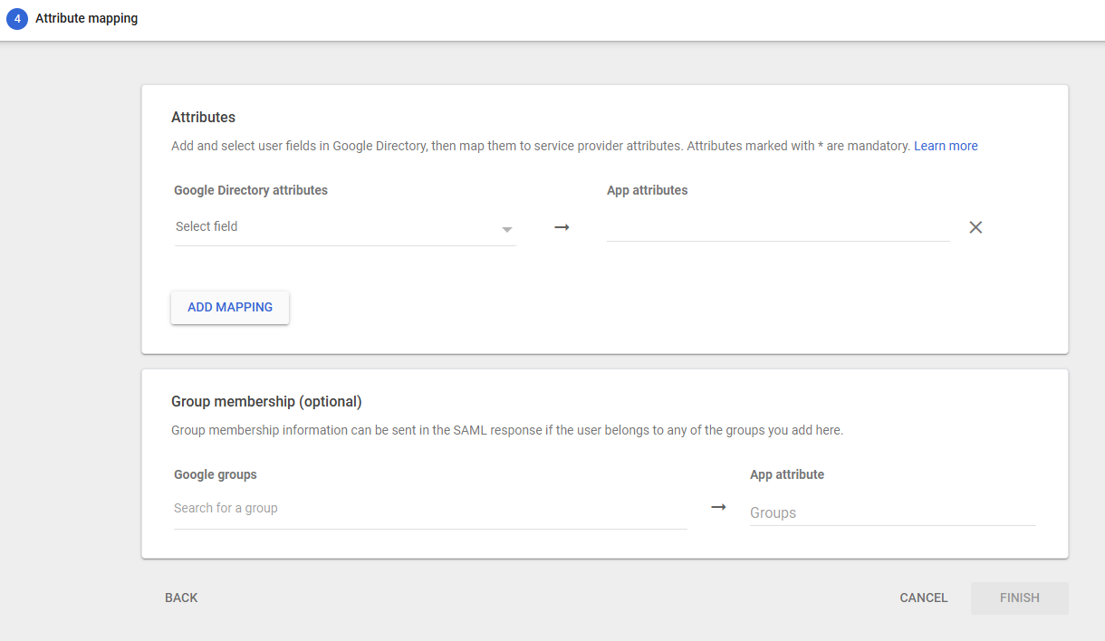

  5. [OPTIONAL] To assign FME Flow user attributes to new users according to a specified mapping, configure this "Attribute mapping" section. You can add attributes that correlate with information under a user's account, or with their Group memberships.

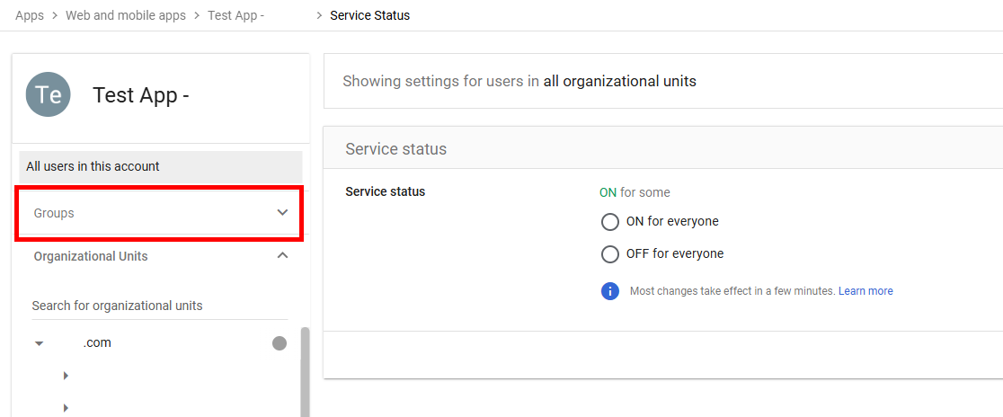

    1. In the app settings, go to the User Access section.
    2. To turn a service on or off for everyone in your organization, click On for everyone or Off for everyone, and then click Save.

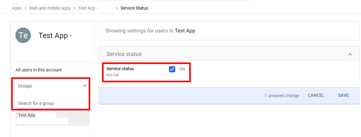

    3. Instead of turning it on for the whole Org Unit, use the Groups filter on the left. Search for your relevant Google group. Set the Service Status to ON for that group only.
Part 2: FME Flow Configuration
1. Open FME Flow
Open and log in to FME Flow. Navigate to User Management  SAML Configuration
2. Import SAML
Import your IdP Metadata or provide the certificate and values.
Select the default user role you wish users to have when they log into FME Flow. FMEFlowMetaData.png

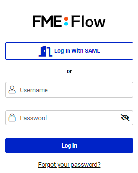

Log out of FME Flow, and you should now have the option to Log In With SAML.  Once selected, you should be prompted to the Google Sign-in page; enter your credentials, and if the configuration is correct, you should be redirected back to the FME Flow home page.
Confirm that the user can log in and that the role and user information are as expected.
