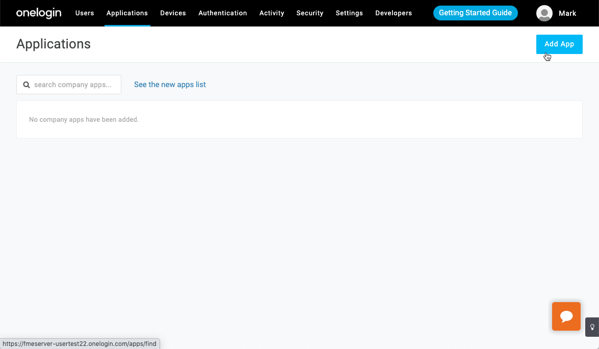

In OneLogin, go to Applications on the top menubar, and click Applications. On the top-right, click Add App.

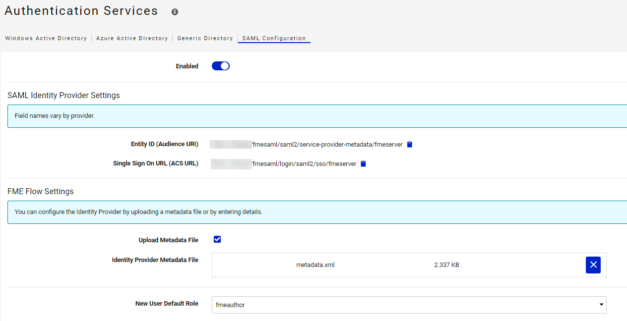

Open and log into FME Flow. Navigate to User Management → SAML Configuration.
2. Import SAML
Import your IdP Metadata or provide the certificate and values.
Select the default user role you wish users to have when they log into FME Flow.

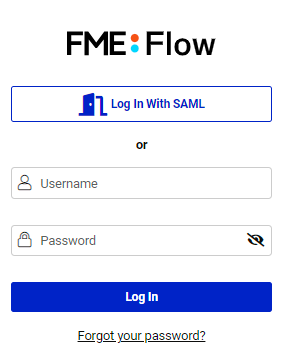

Log out of FME Flow, and you should now have the option to Log In With SAML. Once selected, you should be prompted with the OneLogin Sign-in page. Proceed with entering your credentials, and if the configuration is correct, you should be redirected back to the FME Flow home page.
