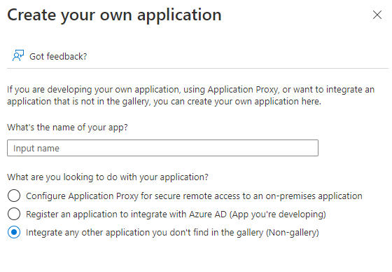

In Microsoft Azure, create a new app. Choose enterprise application in the left-hand navigation and then choose → New Application → Create your own application.
Select  “Integrate any other application you don't find in the gallery (Non-gallery)”

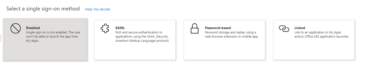

2. Enable Single Sign On
Under the App navigation click on Single Single-On and choose SAMLAzureAD_SAML.png

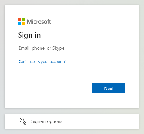

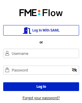

Log out of FME Flow and you should now have the option to Log In With SAML.  Once selected you should be prompted with the Azure AD Sign-in page, proceed with entering your credentials and if the configuration is correct you should be redirected back to the FME Flow home page.
Confirm that the user can log in and that the role and user information is as expected.
