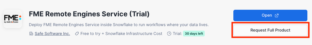

Trial Use
If you have found the FME Remote Engines Service trial on the Snowflake Marketplace, you can launch it free for 30 days. In order to use the FME Remote Engines Service, you must also have FME Flow available and licensed.  FME Flow is required to orchestrate when the Remote Engines Service will run jobs.  FME Form, the authoring tool, is also necessary in order to create workspaces and publish them to FME Flow.  When the 30-day trial expires, the App will be removed from your account.
Production Use
If you wish to use the FME Remote Engines Service in a production-related environment, please contact your Safe Software Account Executive. This will allow our team to confirm the requirements and ensure the best experience.

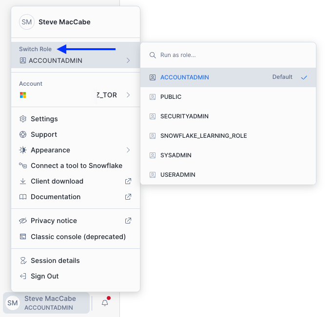

6. Must have access to Snowflake Snowsight with an ACCOUNTADMIN Role to replicate, launch, and configure the Snowpark Container Services.

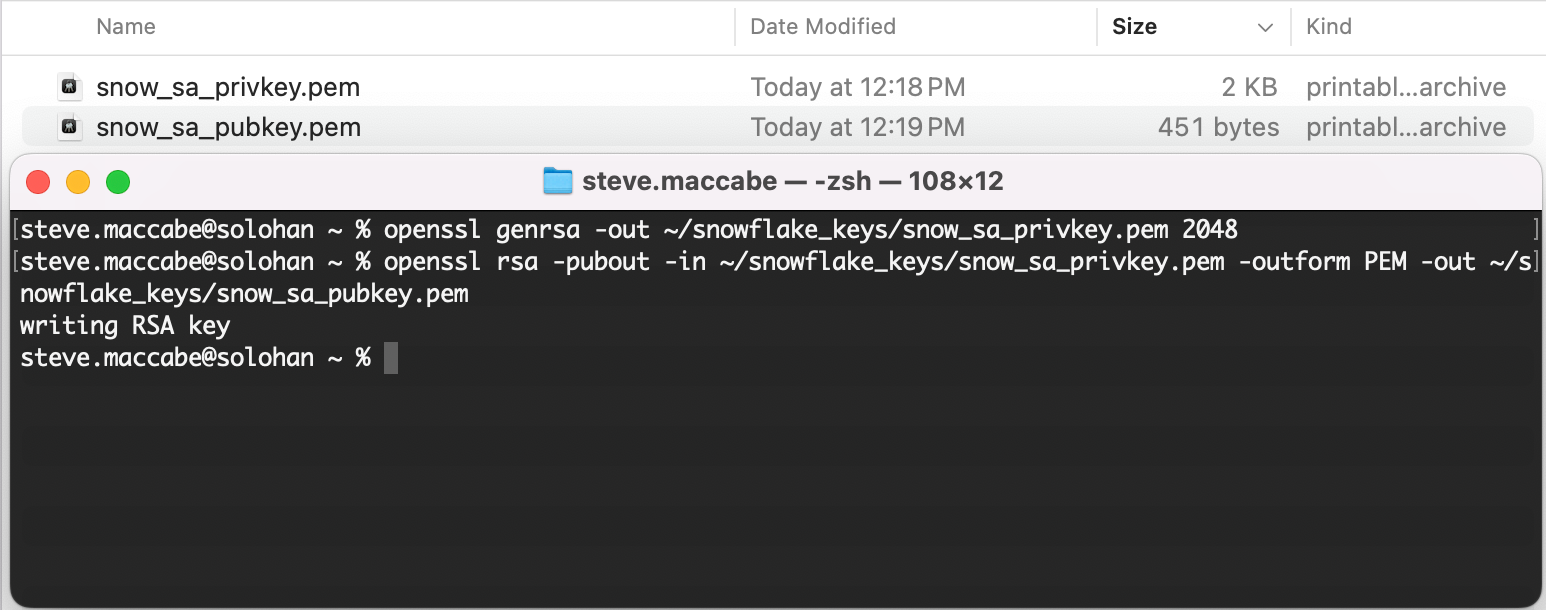

7. You must have a Snowflake user account of type=service configured with key pair authentication. The private key must not have a passphrase associated with it.
  • If you do not have access to the OpenSSL command line, you may use https://www.cryptool.org/en/cto/openssl/ tool with the following commands:
    1. openssl genrsa -out privkey.pem 2048
    2. openssl rsa -pubout -in /privkey.pem -outform PEM -out /pubkey.pem
Step 1 creates the private key file (without a passphrase), and Step 2 creates the public key.
The public key will be used in Snowflake to set the RSA_PUBLIC_KEY of the service user.
  • Example SQL: ALTER USER myappuser SET RSA_PUBLIC_KEY='MIIBIjANBgkqhkiG9w0...AB';

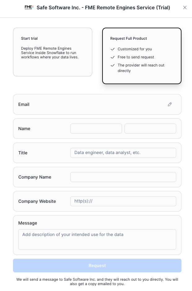

FME Flow Remote Engines is available as a trial and as a private listing. You can launch the trial directly from the marketplace.  To obtain the private listing, you can contact your Safe Software Account Executive to have it shared with your Snowflake Account.
The trial is designed to test and validate the FME Remote Engines Service with your account. The trial version will be updated regularly.
The private listing is meant for development to production environments and is version-dependent based on your FME Flow environment. It will also have a longer life cycle that aligns with your FME Flow upgrade cycle. This ensures nothing changes in your FME Remote Engines Service App until you decide.

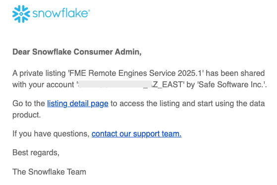

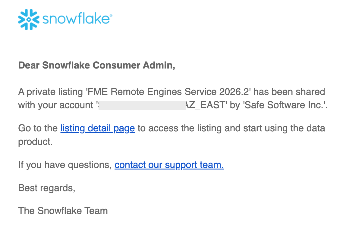

If you chose the trial, your Snowflake Administrator will receive an email with the subject Snowflake Marketplace: Request Fulfilled for Listing 'FME Remote Engines Service (Private Trial)' from no-reply@snowflake.net indicating that the trial is now available in your account.

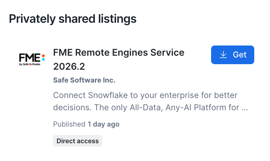

If you chose to have the private listing shared with your account, your Snowflake Administrator will receive an email with the subject Snowflake Marketplace: Request Fulfilled for Listing 'FME Remote Engines Service 2025.1' from no-reply@snowflake.net indicating that the private listing 'FME Remote Engines Service 2025.1' has been shared with your account. The link in the email received can be used to access the listing.

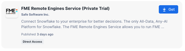

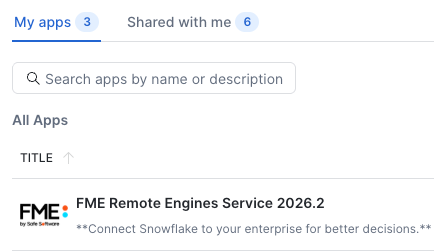

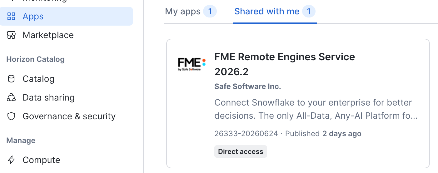

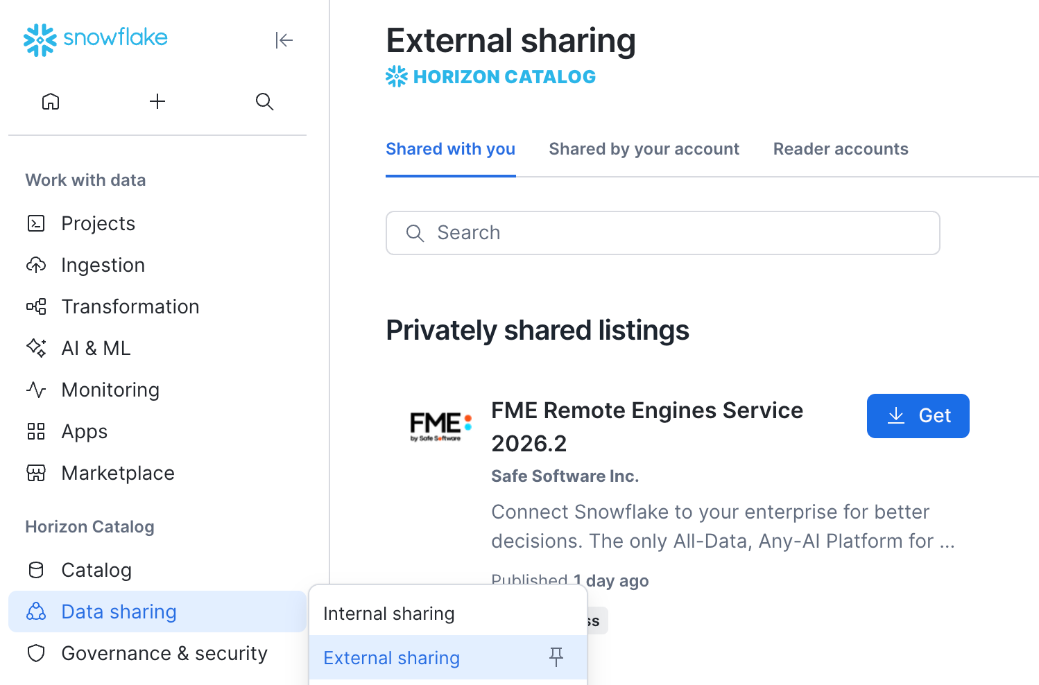

You may also return to Snowflake, log into your Snowflake Account (as an ACCOUNTADMIN),

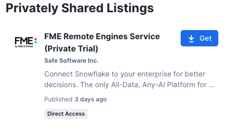

Click on Data Products > Private Sharing > Shared with You, and you should see the Listing.
Replication of FME Remote Engines Service

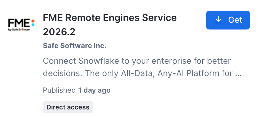

1. To begin the installation of the application, click the Get button.

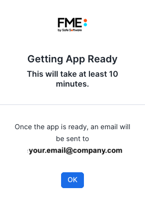

The Getting App Ready dialog will appear.

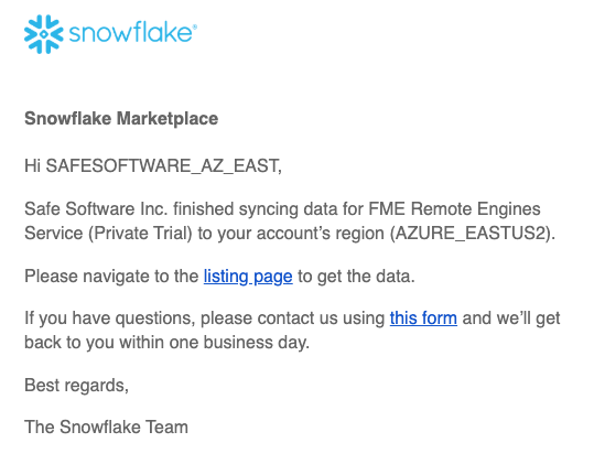

2. This will begin the replication from Snowflake AWS West Region to your region.  Please allow up to two hours for this process to complete. Please monitor your email for notifications from no-reply@snowflake.net.
You will receive an email indicating that the App has been installed and is ready. This can take up to 30 minutes, depending on the region the application is being replicated to.  Please wait for the App to replicate and for the email to be sent to the email address listed in the pop-up before proceeding to the next step.
3. Once you receive the email, you can revisit the Data Products > Private Sharing > Shared with You page and see that the listing is available.
Click on the Get button again.

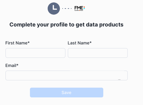

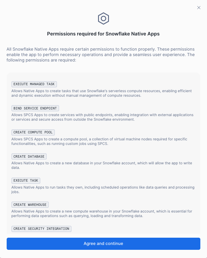

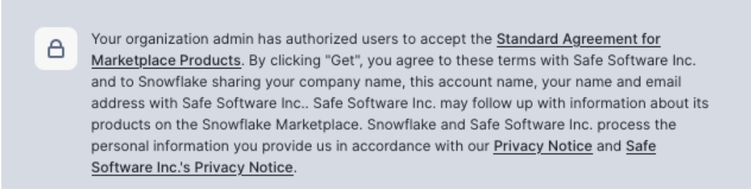

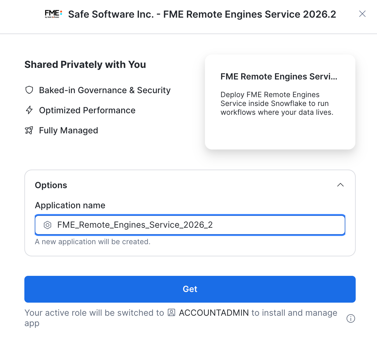

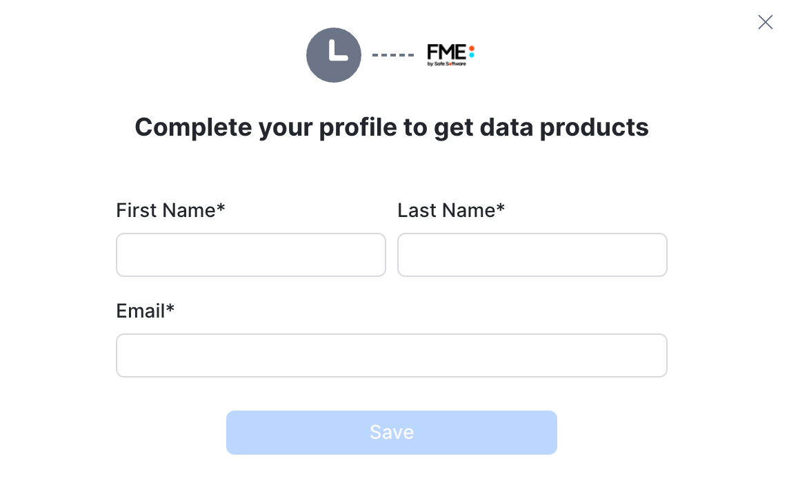

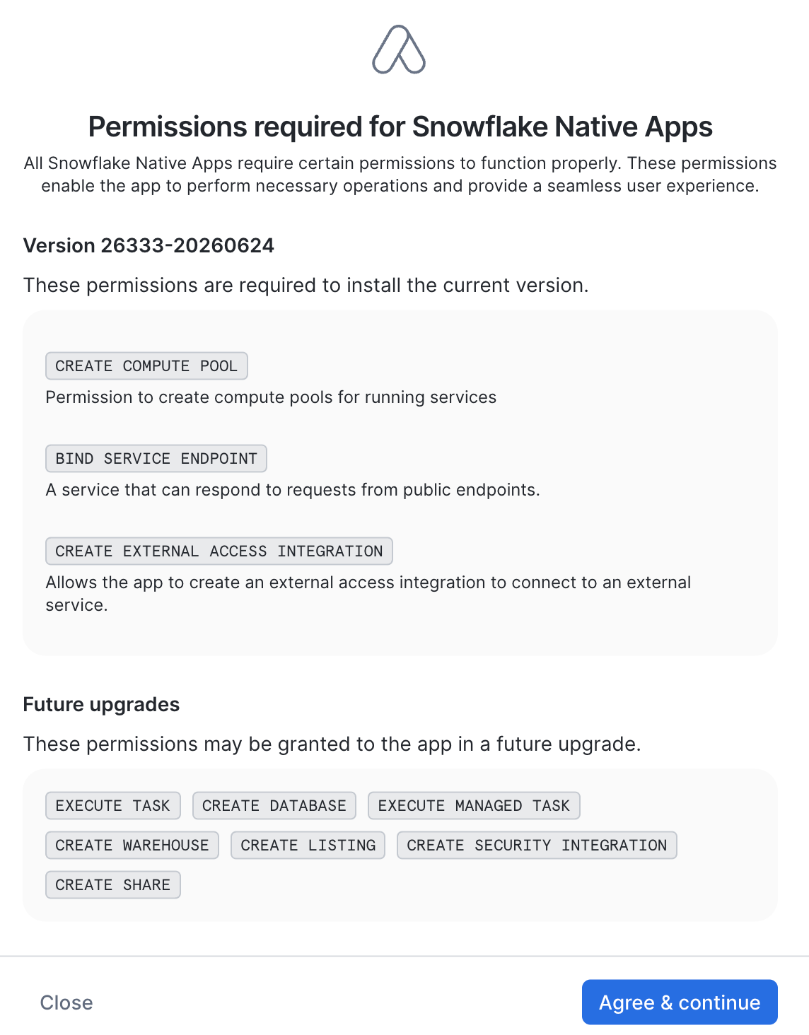

If this is the first time installing a Snowflake App,  you may be asked to complete your Snowflake Profile by providing your name and email address.  If this happens, you must validate your email address with the link sent to your email.

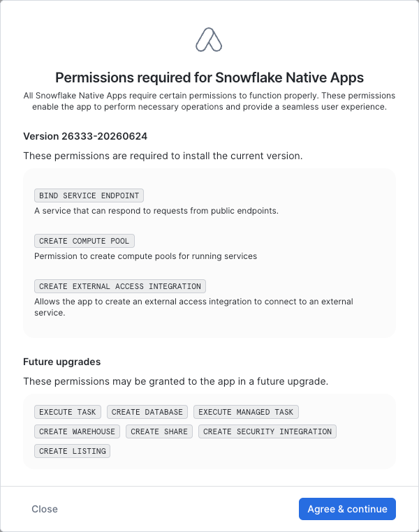

4. Agree and continue to the required permissions for Snowflake Native Apps.
5. Click the Get button to agree with the terms and conditions and start the installation of the App to your account.

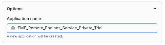

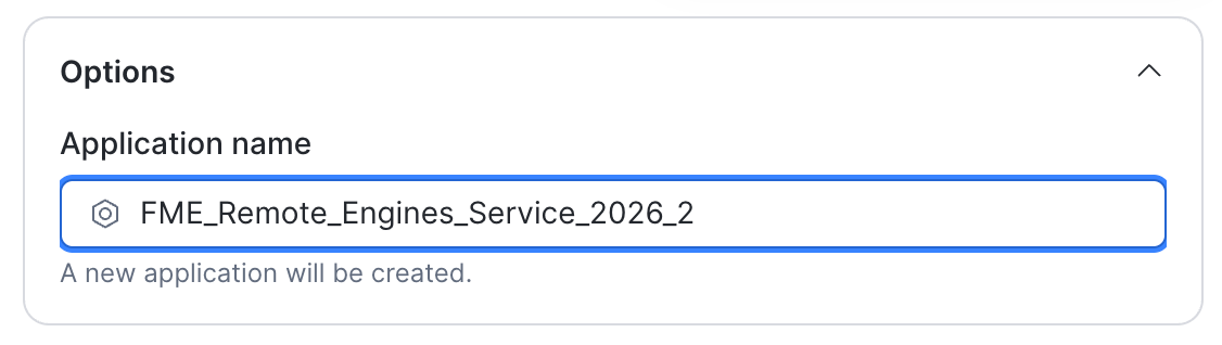

Optional: You may expand Options to see the name of the App that will be created.

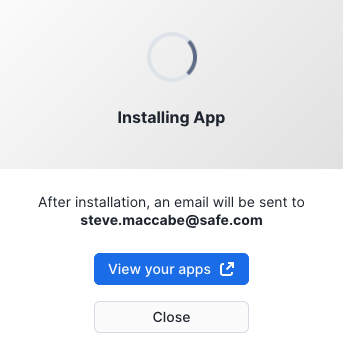

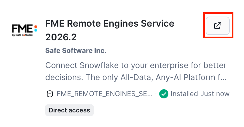

6. Next, you should see confirmation that the App is being installed.

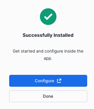

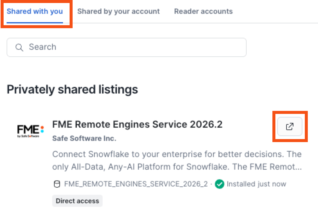

Next, there will be a confirmation that the App was successfully installed.
Congratulations, you have successfully installed the FME Remote Engines Service into your Snowflake Account.

1. Next, you can click on the Configure button in the previous step or go back to Data Sharing > Shared with You and under Privately Shared Listings, click on FME Remote Engines Service (Private Trial).
2. Click on the Expand Button to open the App

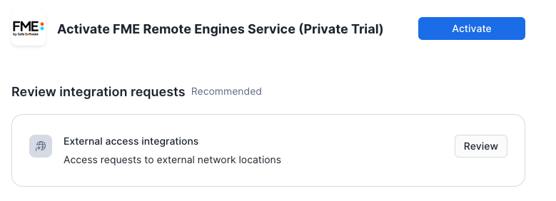

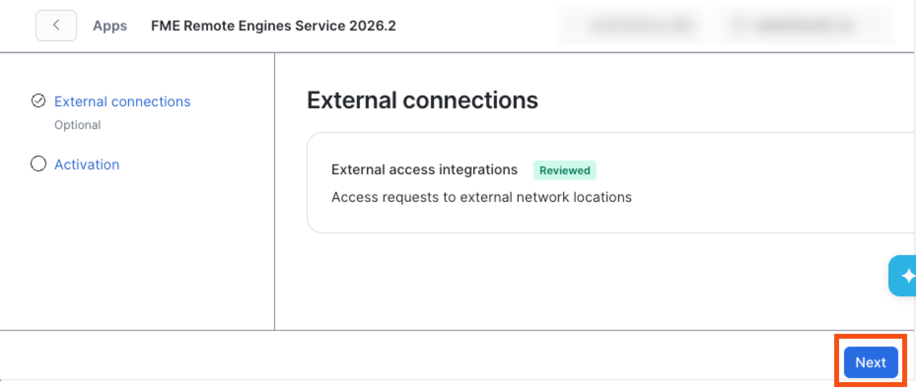

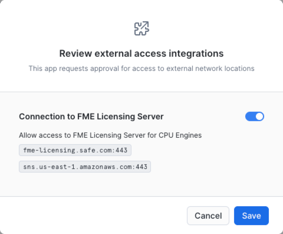

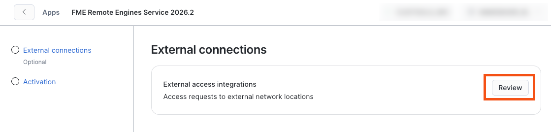

Review the External access integrations to see the two endpoints that will be accessed.
The integration provides access to the FME Licensing service at fme-licensing.safe.com:443 and a Simple Notification Service (SNS) on AWS, both of which are related to licensing. These two endpoints are the only external access the App has at launch time. They are required for the FME Remote Engines Service to process jobs.
3. Click on the Save button to dismiss the integrations dialog.

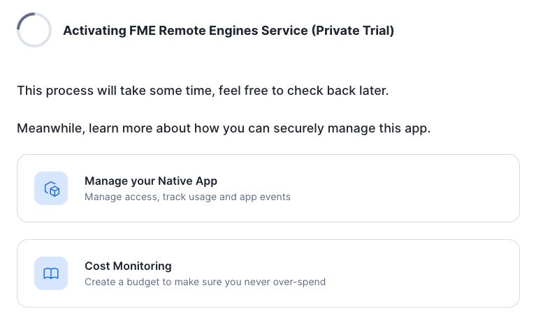

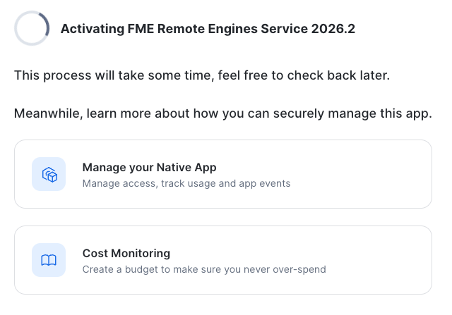

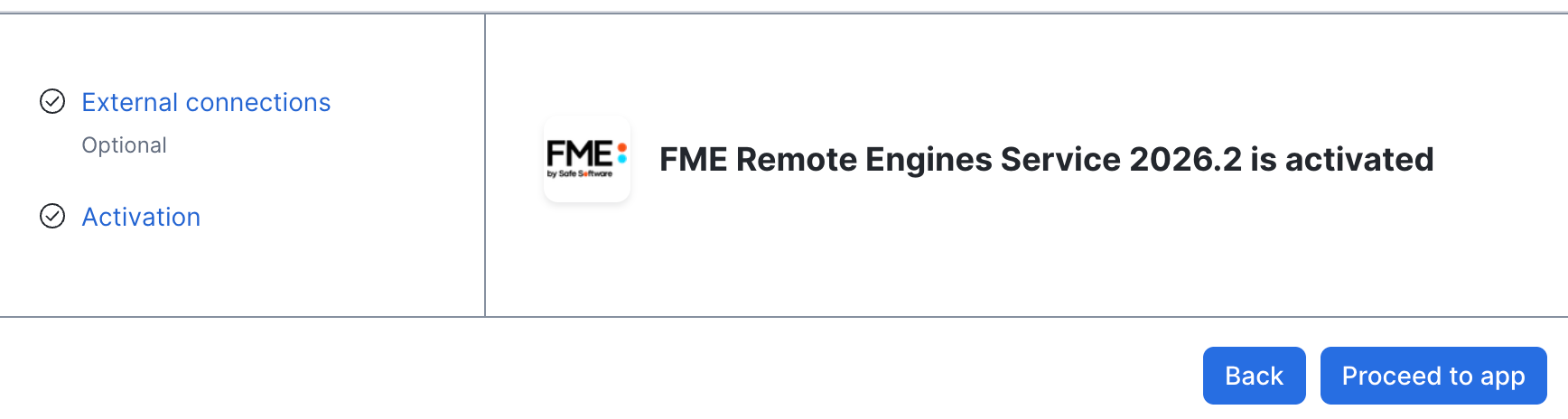

4. Click on the Activate button to activate the App.
You’ll be presented with the Activating FME Remote Engines Service (Private Trial)
This will take several minutes to complete. You can revisit this page later.
Wait for the Application to finish deploying.  This will take around 10 minutes. You may revisit the Data Sharing > Private Sharing > Shared with You page.
  • On the Shared with You page, click on the ‘Expand’ button to check the deployment's progress.

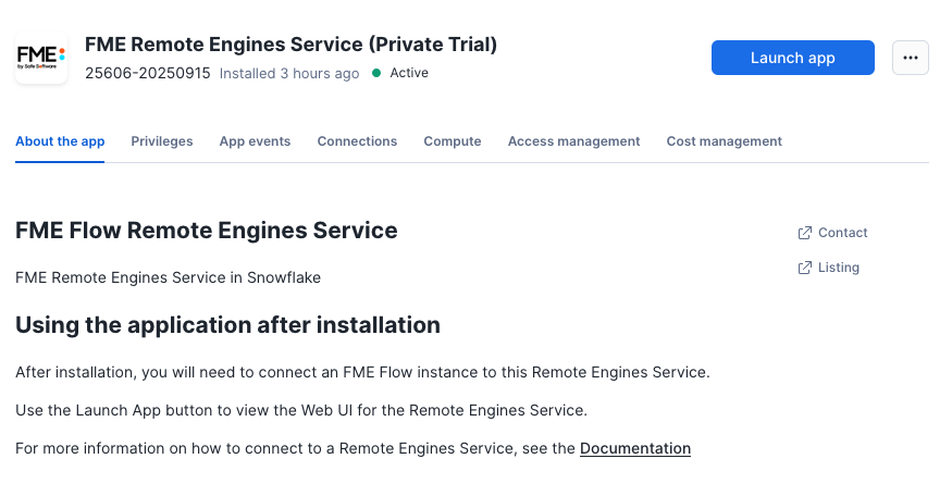

5. If this App has been deployed, you’ll be presented with this page.

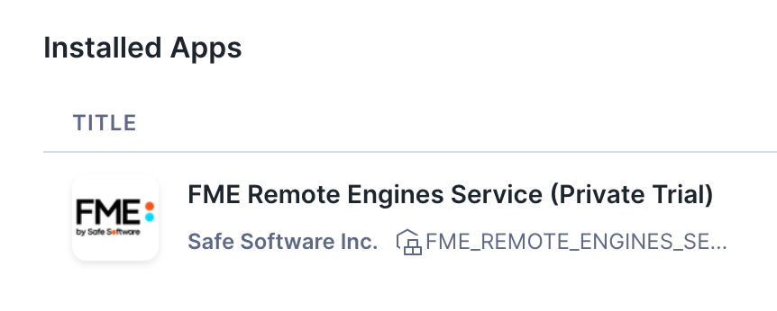

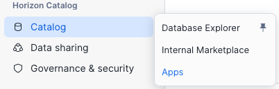

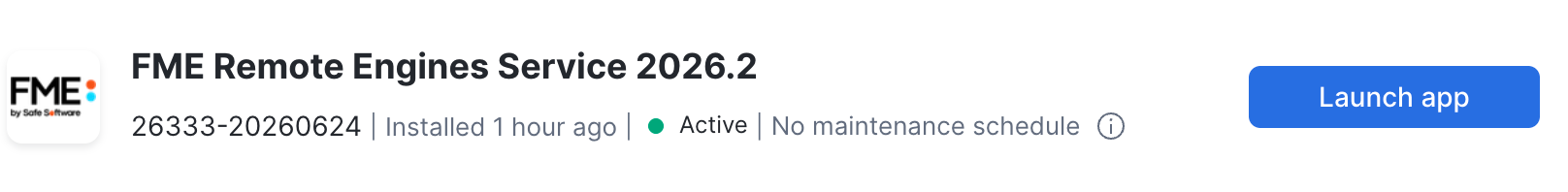

You can also get to the App using the Catalog > Apps link

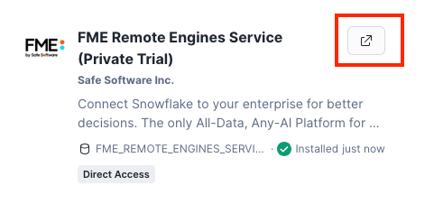

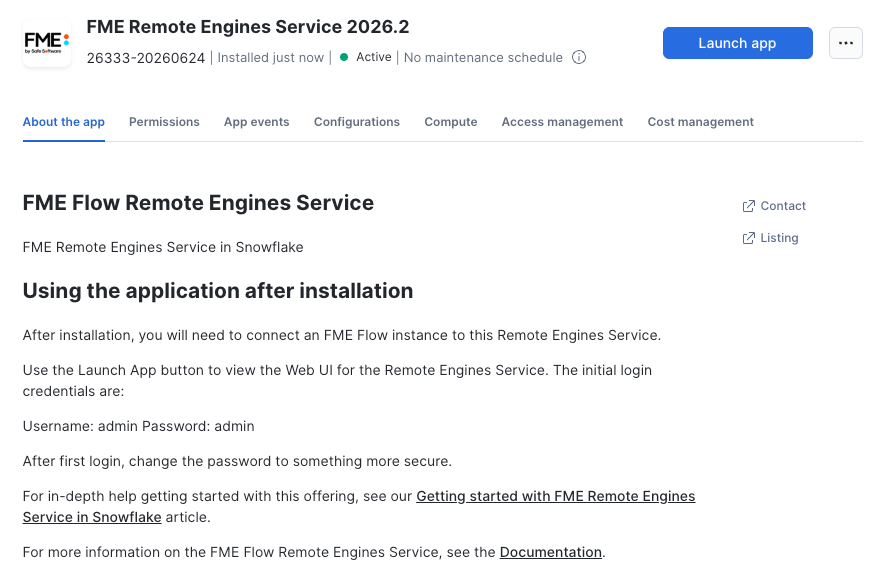

The App will be listed under "Installed Apps".

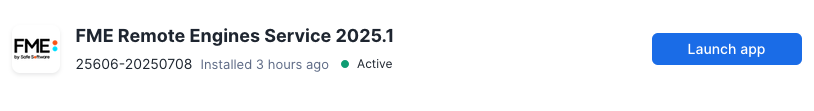

The presence of the Launch app button indicates your Application has deployed correctly.
Part 3: Accessing the Container

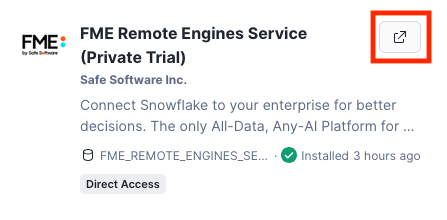

Continuing from Step 2, you’ll now have the option to launch the application. When you complete this step, you’ll be able to log into the Web UI of the FME Remote Engines Service.
1. If the Launch app button is now present, click it. If it is not available, please revisit the steps in Part 2. After launching the app, sign into your Snowflake account.

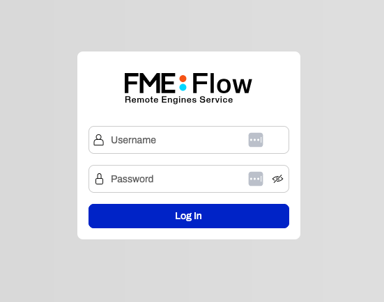

2. Next, the FME Remote Engines Web UI will be presented. Please log in with the default install credentials
  • Username: admin
  • Password: admin

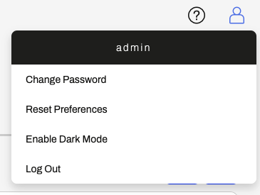

Please note the URL in the browser address bar. This will be used in Part 5 to register the FME Remote Engines Services. Ex:  https://ktiros-mycompany-mycompany-az-east.snowflakecomputing.app/fmeserver/
It is recommended that you change the password to something more secure before connecting the FME Flow Core to the FME Remote Engines Service. You can do this by accessing the User Profile icon at the top right corner.  When doing this, please enter a new password that matches the password policy on the FME Flow Core system.

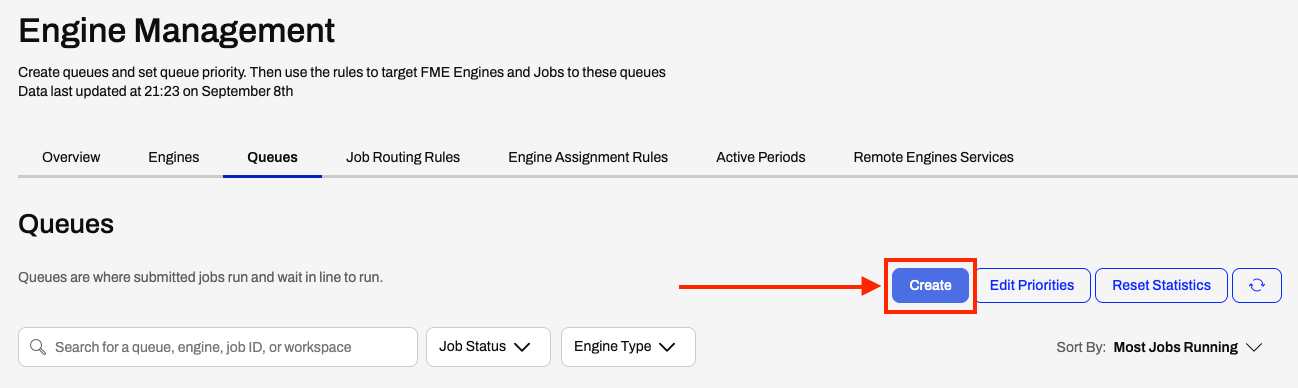

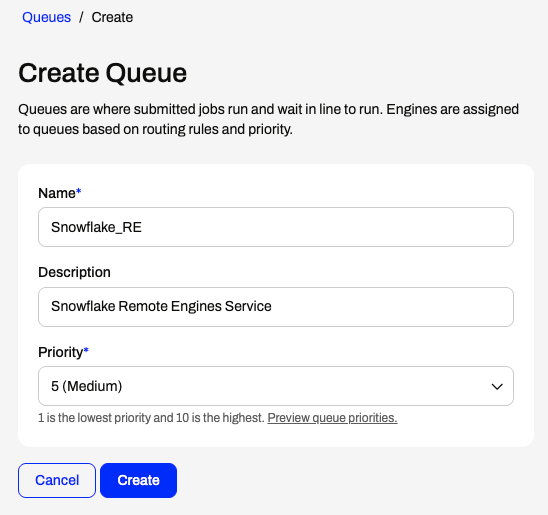

2. Create a new queue for the remote engines service. Go to Engine Management in the Web UI  and click on the Queue tab. Create a new queue to assign engines to.  You’ll assign this queue to the Remote Engines Service running in Snowpark.
Make a note of the queue name as it will be needed in Step 6.

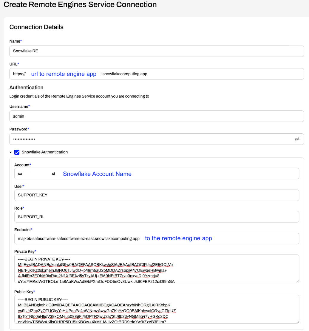

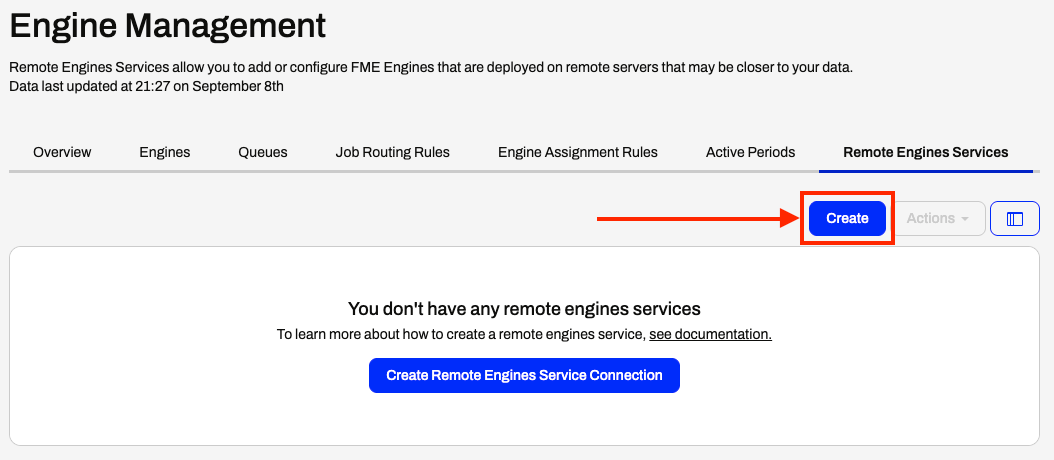

3. Configure the Remote Engines Service. Go to Engine Management in the Web UI and click on Remote Engines Service.

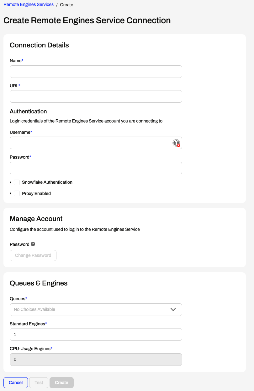

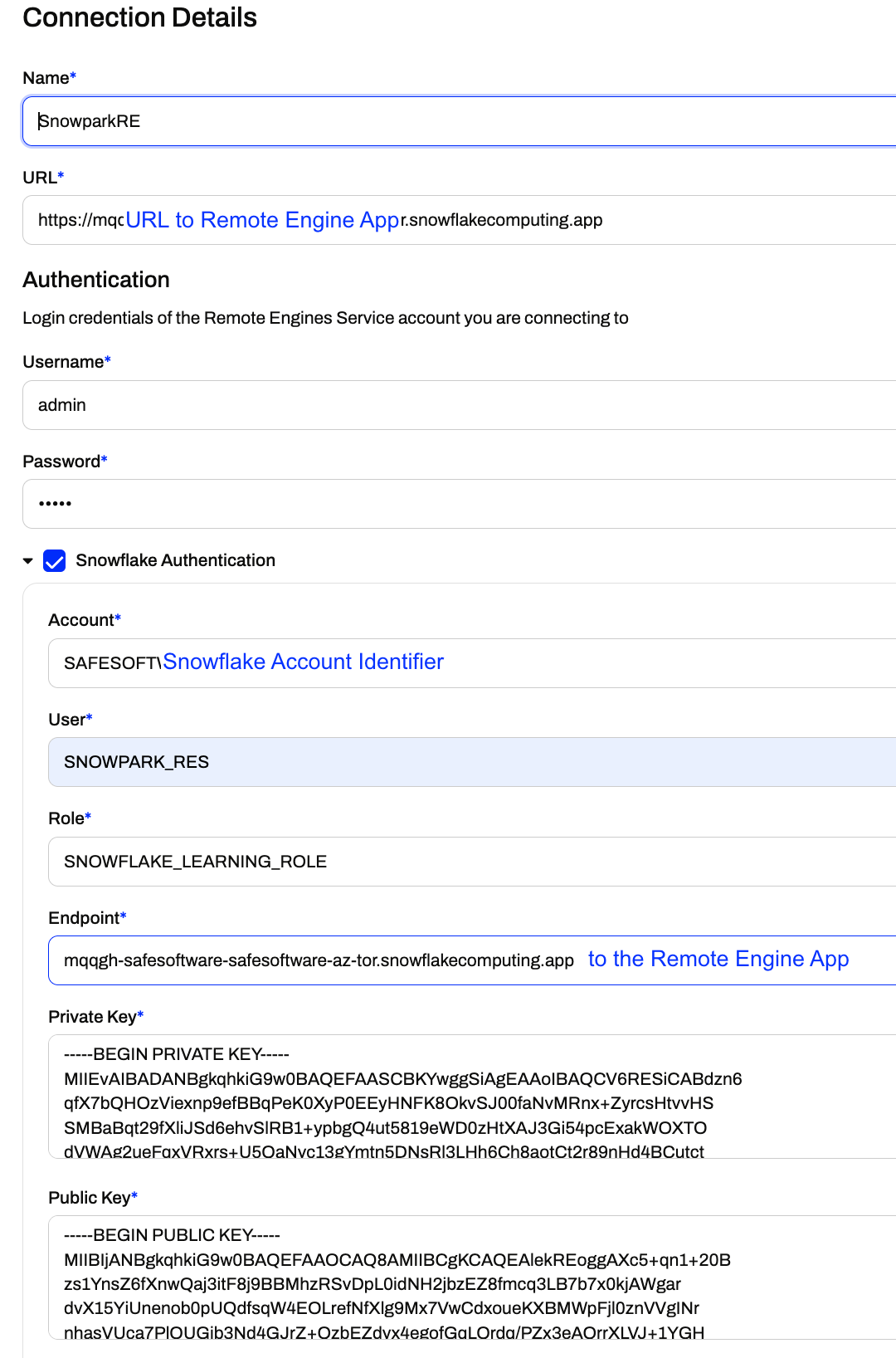

4. Click on the Create or the Create Remote Engines Service Connection button. The following page will present.
5. Enter all details in the Create Remote Engines Service Connection page.
Next, provide the Snowflake Authentication details, and click the check box to enable the Snowflake Authentication.
  • Provide Account (take from URL)
    • Ex. mycompany-mycompany-az-east
  • Provide Username
  • Provide Role (this is the role used in Part 4, “Granting Permissions to the Application”)
  • Endpoint is similar to the URL without https:// in the value.
    • Ex. fme123-mycompany-mycompany-az-east.snowflakecomputing.app
  • Private Key as generated.
  • Public Key as generated and applied to the Snowflake User (Username).
Example Details

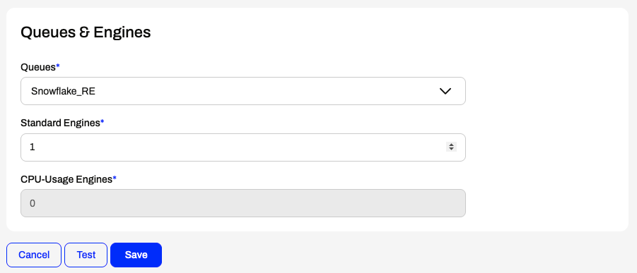

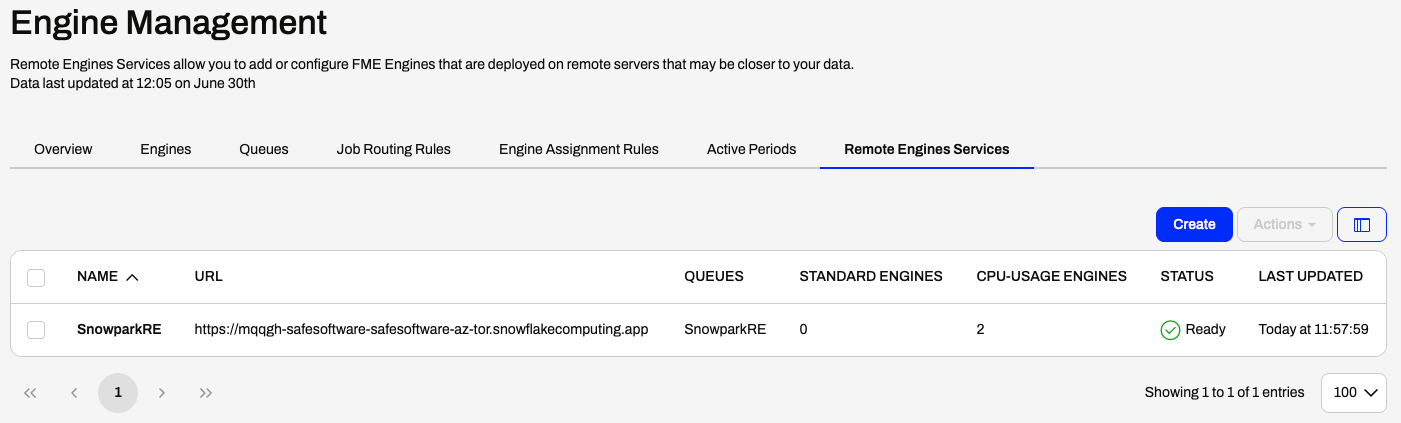

6. Select the Queue created in Step 2 above. Click on the Test button to ensure the information is correct.
You should see a Successful pop-up in the top right of the Web UI.
If you have any errors, please review the Troubleshooting section at the bottom of this article.

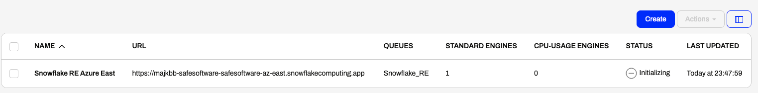

7. Next, click on the Save button to save the FME Remote Engines connection information. The Status will be set to “Initializing”.
After a few minutes, the Status will change to “Ready,” and you’ll be ready to test submitting a job to the FME Remote Engines Service.

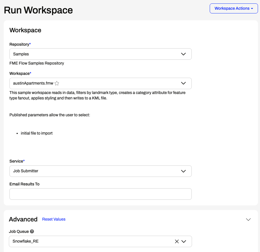

Part 6: Testing the FME Remote Engines Service by Running a Job
Next, let’s test that we can submit a job to the Remote Engines. Ensure you run a Samples workspace and select the Job Submitter Service.
As seen in the screen grab below, ensure you set the Service to Job Submitter and in the Advanced section select the Job Queue assigned to the Snowflake Remote Engines Service. In this case, the example job queue is set to Snowflake_RE.
Once the job has been submitted, you can review the Jobs page to see the job request in the Completed Jobs tab. The Remote Engines Service Job log can be found at the REMOTE LOG URL as seen below.

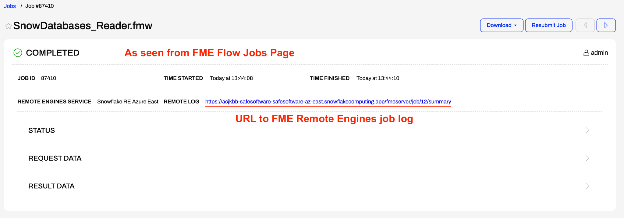

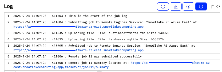

When you submit a job to the Remote Engines Service, the FME Flow environment displays the following logging, indicating that the job has been submitted to the Remote Engines Service and where to review the remote job log.
           The Job Log is only accessible using the FME Remote Engines Service Web UI.
You can now view the job submitted to the FME Remote Engines Service.
Reviewing Jobs submitted to the Remote Engines Service
When a job is submitted to the Remote Engines Service, the job request is passed to the Remote Engines Service App in the Snowflake environment.  The FME Flow Core cannot view the job logs of the FME Remote Engines Service directly.
Therefore, to view job logs for jobs run on the FME Remote Engines Service, you must log into the Remote Engines Service App Web UI. This URL is the same URL presented in Part 3 and used in Part 5 to register the FME Remote Engines Service.  You can also view the Job Log URL in the FME Flow environment by reviewing the job submission (see the previous section).

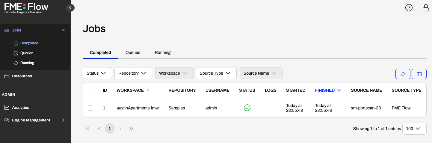

Log in to the FME Remote Engine Services and click on the Jobs page (left side of Web UI).

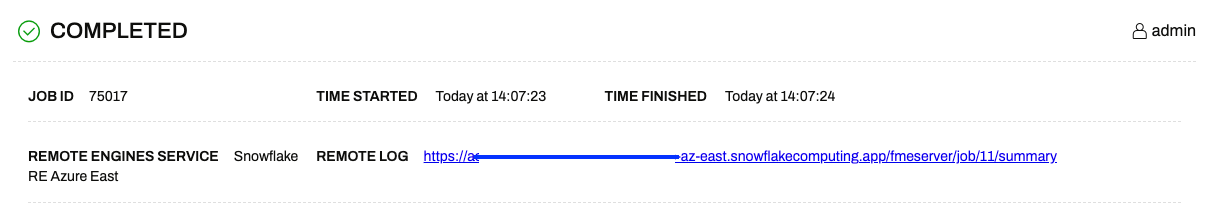

Click on the Completed Jobs to view the jobs that have run on the Remote Engines Service.  From here, you can view the job status, view the job log, or download the job log.
Confirm that the Samples Job ran on the Remote Engines Service (as seen below).
You may click on the line item to view the Job Log.
A successful run confirms that the FME Flow environment can submit jobs correctly to the Remote Engines Service in Snowflake.

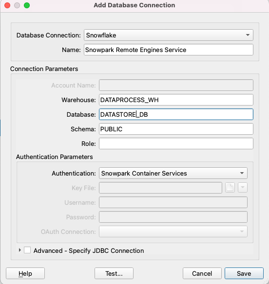

Part 8: Authoring Workspaces for Remote Engines Service
As with all Workspaces that run in FME, it is necessary to develop the workspace with FME Form.  Once you have tested the Snowflake Database Connection in FME Form and FME Flow, you are now ready to publish the workspace using the Snowpark Container Services authentication type. It will be necessary to ensure that, before publishing to FME Flow, any workspace you wish to run in FME Remote Engines Service in Snowflake, you swap the database connection to a Snowpark Container Services authentication type.  This will be necessary for any Snowflake Readers, Snowflake Writers, SQLCreator or SQLExecuter using Snowflake, FeatureReader and FeatureWriters Transformers that are using Snowflake.

Publishing and Running the Workspace
1. Publish the Workspace to the FME Flow environment as usual, ensuring the correct database connection is selected and uploaded during the publishing. Once the workspace has been published, it can be tested by running the workspace.
2. Ensure the correct Queue is assigned when submitting the job. When the job is submitted, the Web UI confirms on the Competed Jobs page that it has been submitted to the FME Remote Engines Service.
You can easily access the Remote Engines Service Web UI by visiting the Completed Jobs page, locating the job, and then clicking on the URL.  This will take you to the login page for the FME Remote Engines Service Web UI, where you can review the job log.
Reviewing the job log for the remote engines was covered in Part 6.
Confirm the results of the workspace by opening the job log and confirming the correct database connection type was used. Example:
Snowflake Reader: Creating connection using connection string 'jdbc:snowflake://mycompany-az-east.east-us-2.azure.snowflakecomputing.com' and properties '{schema="SUPPORT", tracing=OFF, application=SafeSoftwareFME, GEOGRAPHY_OUTPUT_FORMAT=WKB, warehouse="SUPPORT_WH", authenticator=oauth, account=MYCOMPANY_AZ_EAST, db="SUPPORT_DB", GEOMETRY_OUTPUT_FORMAT=EWKB, token=************}'
In the connection string above, you’ll see the following connection parameters: authenticator=oauth and token.  There will be no user parameter present.  This confirms the workspace connected to the database from within the Application in Snowpark.
3. A successful connection will confirm that the FME Remote Engines Service has been able to connect to the database using the provided connection parameters.

1. Creating a database connection for use in Snowpark
  • When creating a database connection for use with the FME Remote Engines Service, ensure that the Authentication Type is Snowpark Container Services. Also, ensure that the Warehouse, Database, and Schema are all correctly set.
2. Do not set the Role in the database connection.
  • The Snowpark Database Connection will rely on grants given directly to the FME Remote Engine Service Application, as explained in Part 7.
  • The Container does not use a username or password to access the databases.
  • Running a workspace with the FME Remote Engines Service that uses a Snowflake Database Connection with an Authentication Type other than Snowpark Container Services will fail and is not supported.

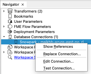

  • In FME Form, you can swap a Database Connection by right-clicking on it and replacing it with the Database Connection that contains the Snowpark Container Services authentication type.
3. When authoring a workspace, consider that your client system will use a different database connection than when it is published to the FME Flow environment, where it will run on the FME Remote Engines Service within Snowpark. Therefore, permissions and privileges can vary; therefore, work closely with the Snowflake Administrator and DBA.
Part 9: Snowflake Database Connections with Remote Engines
When creating a database connection that will be used by the FME Remote Engines Service in Snowflake, ensure that you set the Authentication type to Snowpark Container Services, as seen below. This connection type is only compatible with the FME Remote Engines Service App in Snowflake.
NOTE: Leave the Role parameter empty.

When launching the FME Remote Engines Service App, one Egress Access Integration is created. The integration provides access to the FME Licensing service at fme-licensing.safe.com:443 and a Simple Notification Service (SNS) on AWS, both of which are related to licensing. These two endpoints are the only external access the App has at launch time.
If other external endpoints are required, for example, another public API is needed to pull data from, it will be necessary to create a new network rule, a new external access integration, grant this access to the FME Remote Engines Service App, and call a procedure to enable the external access integration.

Where <APP_NAME> will be FME_REMOTE_ENGINES_SERVICE_PRIVATE_TRIAL (unless a different name was entered in Part 1, step 7).

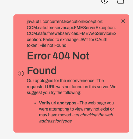

Can’t register Remote Engines
Example 1: Error 404 Not Found
The user must be assigned the correct role for this step to work.
GRANT APPLICATION ROLE FME_REMOTE_ENGINES_SERVICE_2025_1.APP_USER to ROLE FME_APP_ROLE.
This role, FME_APP_ROLE, is then assigned to the user being configured to access the Remote Engine Service.
The above grants will allow the FME Flow Core environment to connect to the Remote Engines Service and submit jobs.

Probable causes are related to the URLs used to register the Remote Engines Service.  Carefully review the URLs and the Account Name value used in Part 4, Step 3.    The Account Name should be contained within the URL provided by the Snowflake App when you launched the FME Remote Engines Service App in Part 3: Launching Container.

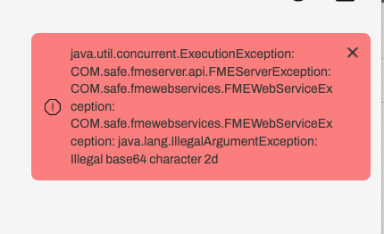

Illegal Argument Exception: Illegal base64 character
This is likely caused by the private key requiring a passphrase or another issue related to decrypting the private key. Review how the public and private keys were created, ensuring that you followed the instructions in the Section above, called Requirements and Prerequisites, bullet 7.
