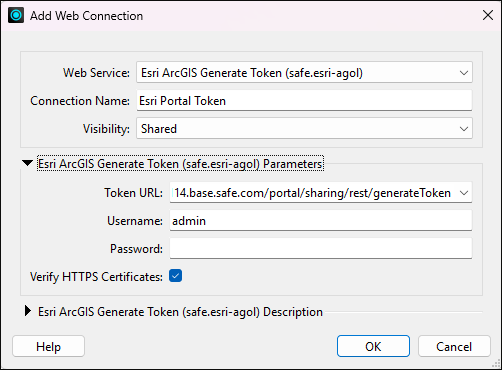

ArcGIS Portal
  • Web Service: Esri ArcGIS Generate Token (safe.esri-agol)
  • Connection Name: <Your own name for the connection>
  • Visibility: Shared
  • Token URL: <Your Esri Portal>/portal/sharing/rest/generateToken
  • Username: <your username>
  • Password: <your password>
Click OK to save the web connection details
