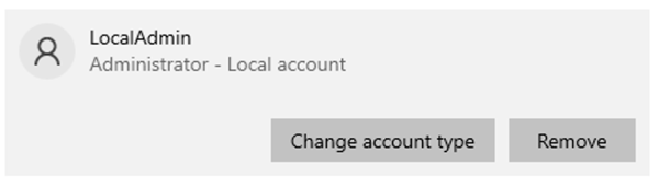

For FME to access the ArcGIS Pro, the application must be installed using an administrator account. Use the following instructions to Log into the machine with an administrator account.
Windows Local Admin Account

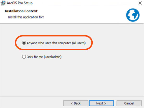

Launch the ArcGIS Pro Setup installer.
Install the application for “Anyone who uses this computer (all users)”. This specifies a per-machine installation rather than a per-user installation.
ArcGIS Pro Setup Installation Context Options
You can follow the dialog to complete the ArcGIS Pro Setup and finish installing the application.

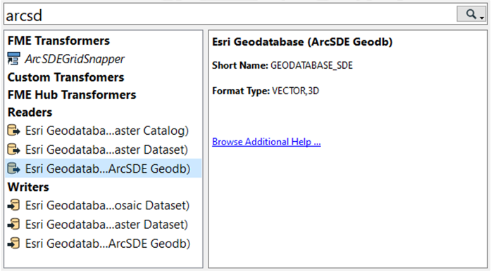

To confirm access to an ArcGIS license, verify that Esri-dependent formats are available.
Esri Formats in FME
Run a simple FME workflow using an Esri-dependent format.
