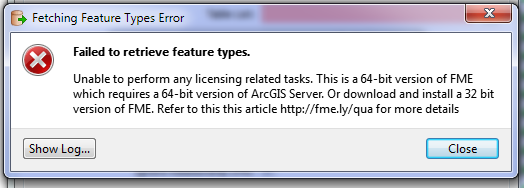

Running a workspace fails with a licensing error. The error states that the software version being used is 64-bit:
If you try and run an existing workspace using FME64bit then you may get the error: Failed to Retrieve feature type as shown above.

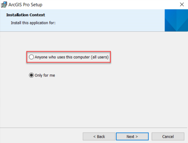

ArcGIS Pro and FME
Ensure ArcGIS Pro is installed for everyone, otherwise FME will be unable to find an ArcGIS Pro license. If you are unsure whether ArcGIS was installed with the "Anyone who uses this computer (all users)" option, try checking the location of the ArcGIS Pro install directory. If Pro is installed for all users, the installation directory will be located in "C:\Program Files\ArcGIS\Pro".
ArcGIS Pro needs to be installed for all users
