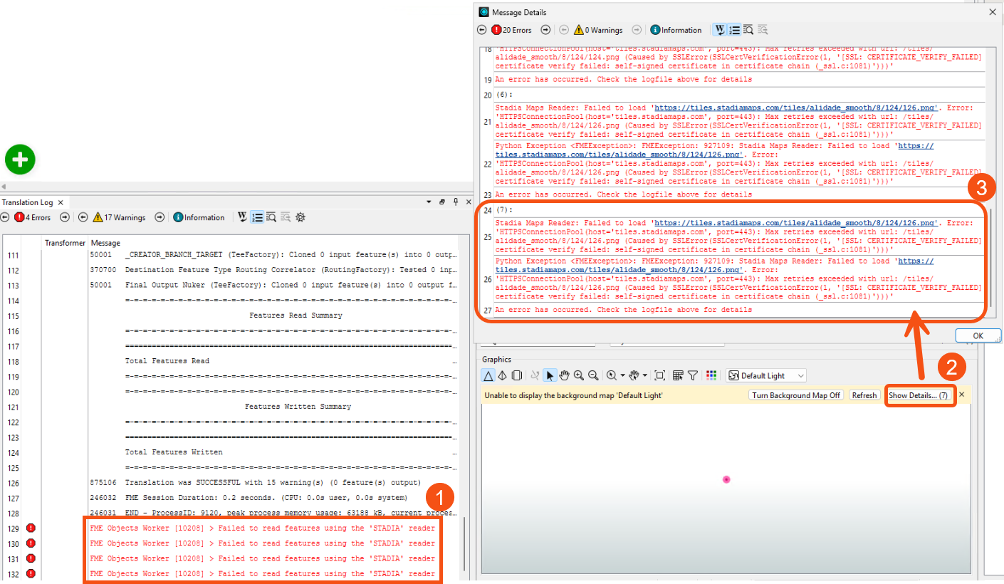

Translation log:
FME Objects Worker [<ID>] > Failed to read feature using the "STADIA" reader
Data Preview Graphics log:
Stadia Maps Reader: Failed to load
'https://tiles.stadiamaps.com/tiles/alidade_smooth/0/0/0.png'.
Error: 'HTTPSConnectionPool(host='tiles.stadiamaps.com', port=443):
Max retries exceeded with url: ...
(Caused by SSLError(SSLCertVerificationError(1,
'[SSL: CERTIFICATE_VERIFY_FAILED] certificate verify failed: ...')))'
