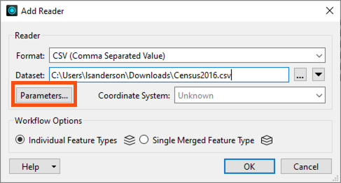

1. Start FME Workbench and Add CSV Data
Start FME Workbench, and click on New to open a blank workspace.
First, we need to add a source dataset. Click on the Add Reader button. In the Add Reader dialog, enter the following:
  • Format: CSV (Comma Separated Value)
  • Dataset: Census2016.csv
    • Click on the ellipsis and browse to the downloaded dataset
  • Parameters:
    • Feature Type Name(s): From File Name
    • Field Names Line: 5
Then click OK.
CSV datasets often begin with additional information prior to when the data actually starts. In the parameter Preview section, you can see that there is some metadata about where the dataset originated from before the field names begin on Line 5. Updating the Field Names Line parameter to 5 will update the preview and read the data in correctly. While in the parameters, change the Feature Type Name(s) to From File Name to have the file name shown on the canvas.

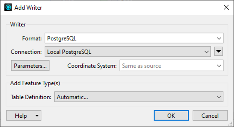

Click the Writer button and in the Add Writer dialog, enter the following:
Then click OK.

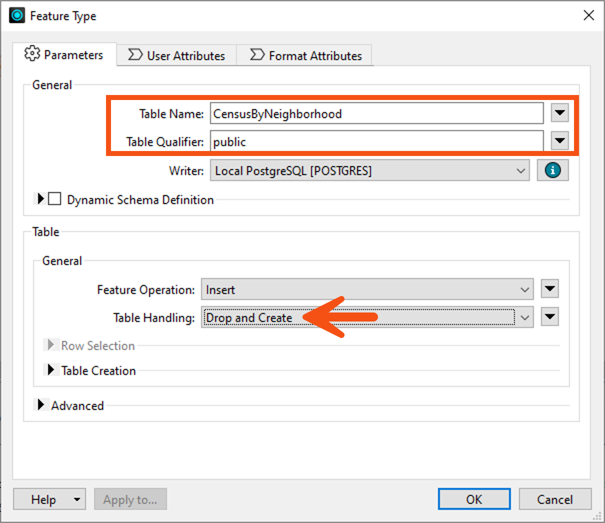

In the Feature Type parameters, set the following:
  • Table Name: CensusByNeighborhood
  • Table Qualifier:  public
    • Your database may have a different table qualifier.
  • Table Handling: Drop and Create
Then click OK.

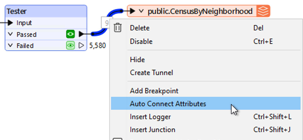

After clicking OK, connect the CensusByNeighborhood writer feature type to the Tester Passed output port.
In FME 2025.0, the PostgreSQL writer now automatically maps attributes of any case or if their are spaces to lowercase or underscores that PostgreSQL requires. If using FME 2024.2 or older, right-click on the connection line between the Tester and PostgreSQL writer feature type and click Auto Connect Attributes.

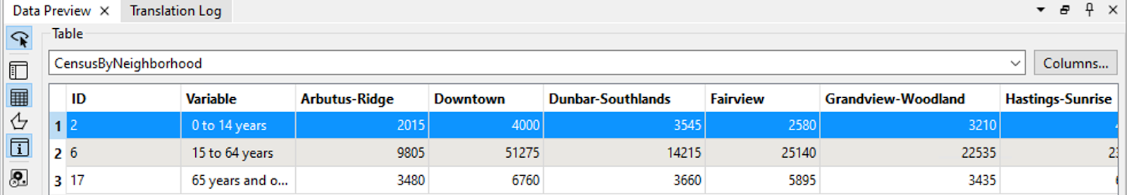

4. Run the Workspace
Run the workspace and view the output PostgreSQL table in either PG Admin or Data Preview.

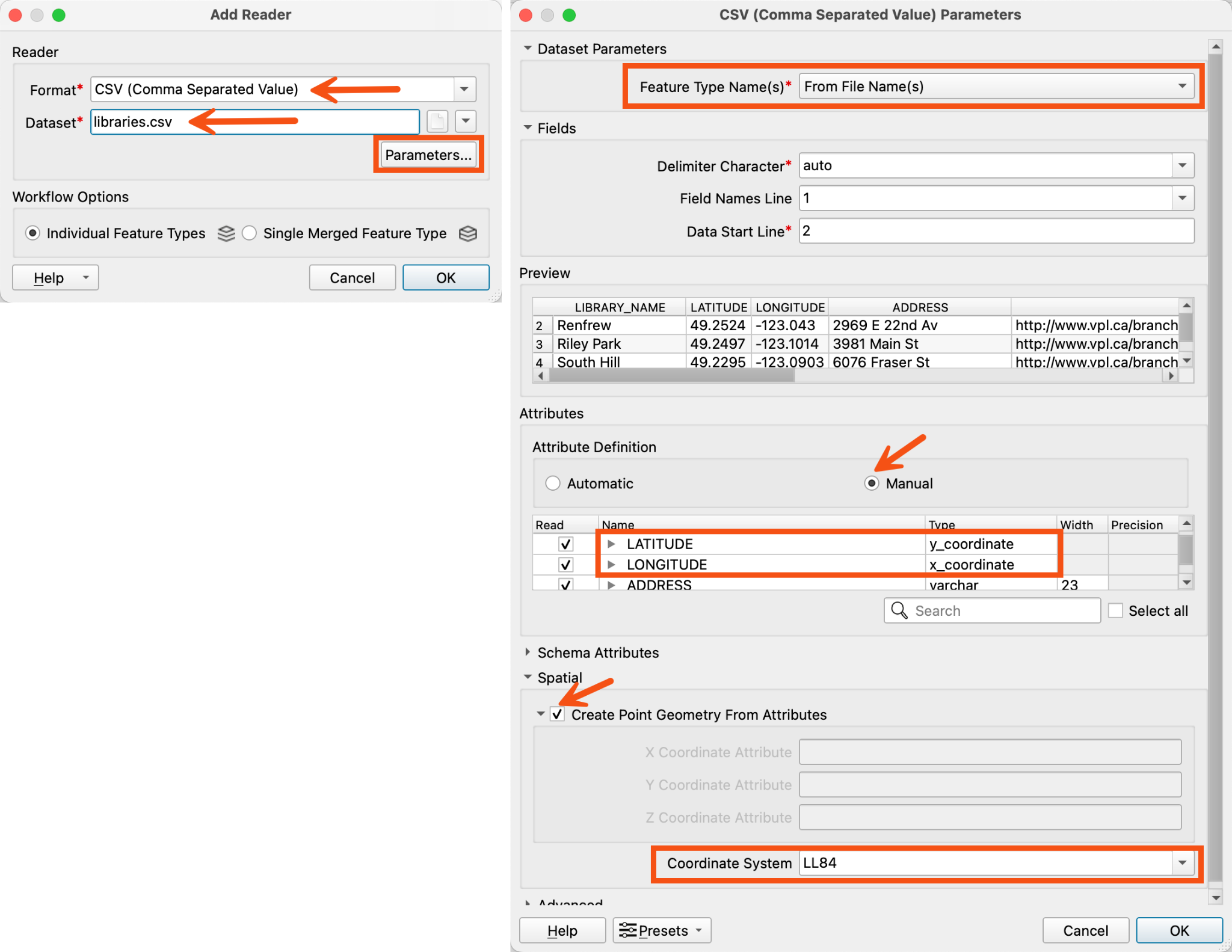

Part 2: CSV to Spatial PostGIS or SpatiaLite
As of FME 2025.2, the Coordinate System parameter is now configured within the Parameters dialog of each reader/writer format. For more information, including details about the change and affected transformers, please see Coordinate System Parameter Location Change.

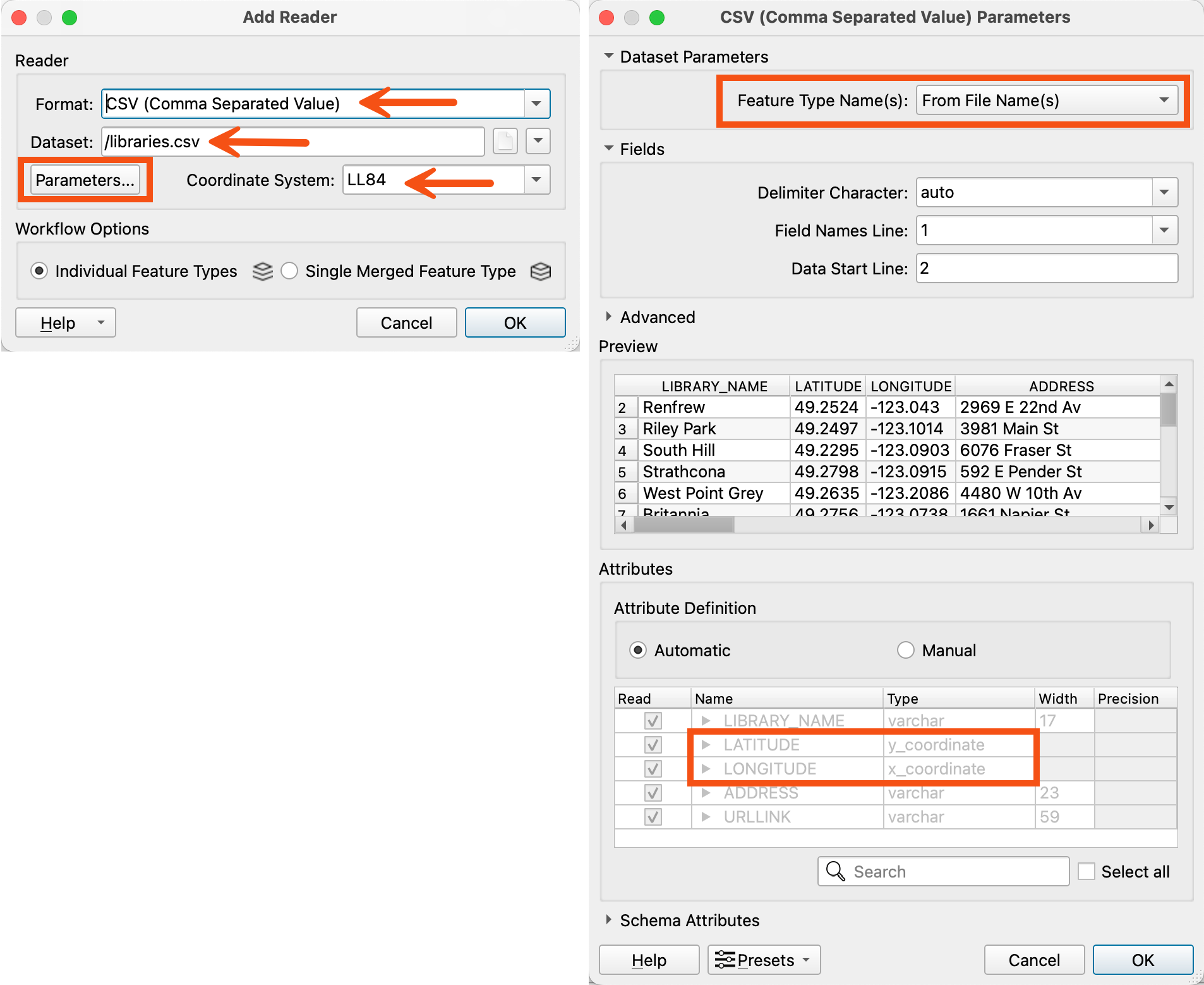

  • In a new workspace, click the Add Reader icon in the Toolbar and add a reader with the following parameters:
      • Dataset: /libraries.csv
    Click the Parameters button to set the coordinate system:
      • Feature Type Name(s): From File Name(s)
      • Attribute Definition: Manual
    Name Type
    LONGITUDE x_coordinate
    LATITUDE y_coordinate
      • Create Point Geometry from Attributes: Enabled
      • Coordinate System: LL84
    ReaderCSV2025.2
    Click OK to add the reader to the workspace.
    Click the Parameters button and set the feature type name:
    Before adding the reader to the canvas, confirm that the LONGITUDE and LATITUDE attributes are set to x_coordinate and y_coordinate, respectively. If they are not, change the Attribute Definition to Manual, then manually set. FME will automatically create points from these attributes.
    ReaderCSV2025.1

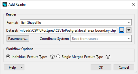

2. Add Neighborhood Boundaries
Now we need to add in the neighborhood boundaries. Add another reader to the canvas.
  • Format: Esri Shapefile
  • Dataset: local_area_boundary.shp
 Then click OK.

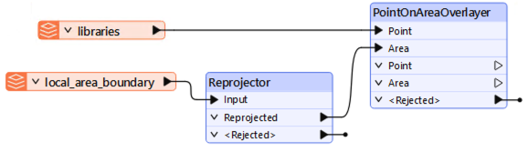

3. Reproject the Neighborhood Boundaries

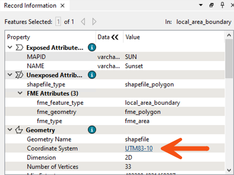

If you inspect the local_area_boundary shapefile, you will notice that it is in the UTM83-10 coordinate system. We will need to reproject this into LL84 to match our libraries CSV file.

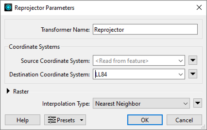

Add a Reprojector transformer to the canvas and connect it to the local_area_boundary feature type. In the parameters, set:
  • Destination Coordinate System: LL84
4. Retrieve the Attributes from Neighborhoods and Add them to the Libraries

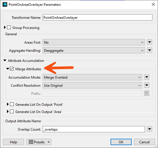

Each library falls within a Vancouver neighborhood, to add this neighborhood attribute to the libraries, we will use a PointOnAreaOverlayer transformer. Add a PointOnAreaOverlayer transformer to the canvas, then connect the Point input port to the libraries reader feature type, and the Area input port to the local_area_boundaries reader feature type.
In the PointOnAreaOverlayer parameters, set:
  • Attribute Accumulation:
    • Merge Attributes: Checked

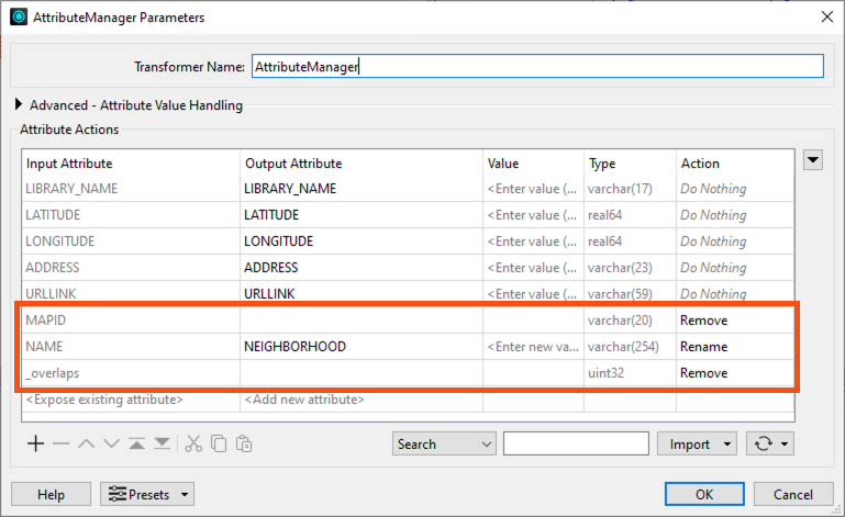

5. Clean up the Attributes
We need to clean up the attributes before we write out to the database. Add an AttributeManager transformer to the canvas and connect it to the Point output port on the PointOnAreaOverlayer. In the parameters, set:
  • Update Attribute:
    • Input Attribute: NAME
      • Output Attribute: NEIGHBORHOOD
  • Remove Attributes:
    • Input Attribute: MAPID
      • Action: Remove
    • Input Attribute: _overlap
      • Action: Remove

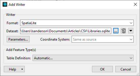

If you do not have access to a PostGIS database with write permissions, use SpatiaLite:
  • Format: SpatiaLite
  • Dataset: .\Libraies.sqlite

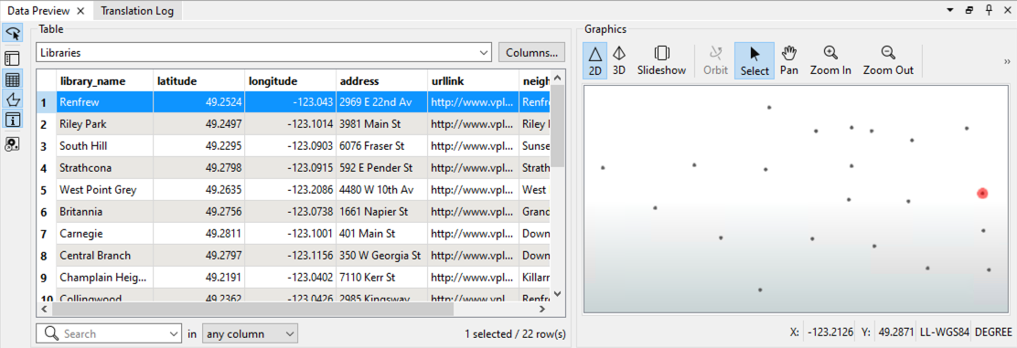

7. Run Workspace
Run the workspace and view the output in Data Preview.
