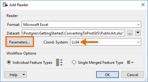

1. Add a Microsoft Excel Reader
Start FME Workbench and begin with a blank canvas. Add a Microsoft Excel reader to the canvas and browse to the PublicArt.xlsx file that is available from the Files section of this article. Set the Coord. System to LL84  and then click the Parameters button.
As of FME 2025.2, the Coordinate System parameter is now configured within the Parameters dialog of each reader/writer format. For more information, including details about the change and affected transformers, please see Coordinate System Parameter Location Change.

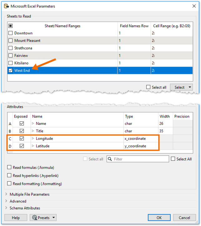

In the Parameters, we only need to read in the West End Excel spreadsheet. Uncheck all of the neighborhoods except West End. Next, double-check to ensure that the Longitude and Latitude attributes have the Type x_coordinate and y_coordinate, respectively. Depending on your version of FME, this may or may not set automatically. If it is not set, click the drop-down to switch the Type to x_coordinate or y_coordinate (you may need to set the Attribute Definition to Manual).
Having the Type set to x_coordinate or y_coordinate tells the reader to create points from the Excel data as it reads the file. Click OK twice to add the reader.

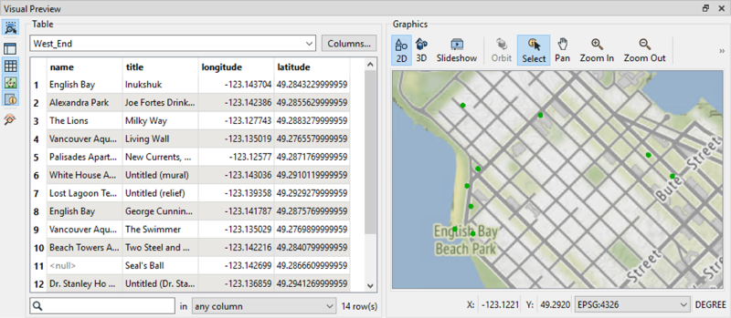

2. Inspect the Data
Now, let’s inspect the data to ensure the reader created the points. Click the reader feature type to open the mini toolbar, then select View Source Data to open Data Preview (formerly Visual Preview).
There should be 14 different pieces of public art, and there should also be points in the Geometry view.

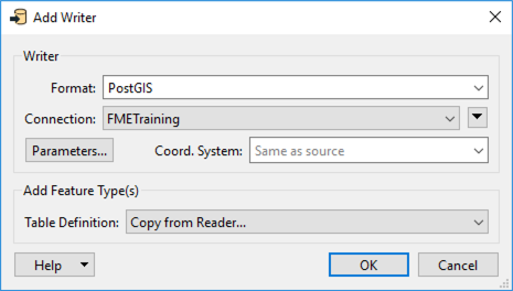

3. Add PostGIS Writer
Now, from the Writers menu, click Add Writer. For Format, select PostGIS, and for Connection, select the FMETraining connection created in Creating a PostgreSQL/PostGIS Training Database with FME.
For Table Definition, select Copy from Reader, so that the source schema is used to define the PostGIS table, then click OK to add the writer.

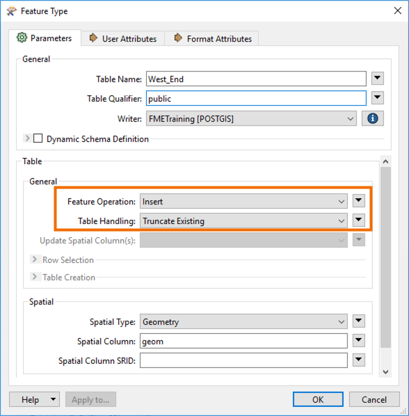

Once the writer is added to the canvas, double-click on the writer feature type to open the parameters.
Leave the Table Name as West_End. Set the Table Qualifier to public.
The Table qualifier is the same as the Schema for Table Listing in the PostGIS Reader parameters. It is specified per database table, as one could write to multiple schemas using the same database writer.

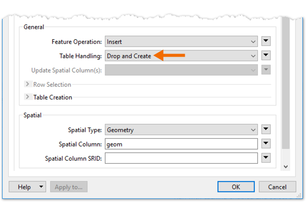

Next, we need to define how the table is to be handled. Since this table was included when the FMETraining database was created in Creating a PostgreSQL/PostGIS Training Database with FME, we need to either update the data or recreate the data. For this example, let’s recreate.
Set the Feature Operation to Insert, then set the Table Handling to Drop and Create. This will drop the existing public.West_End table, then create it again using the data from the Microsoft Excel spreadsheet.
If we weren’t sure whether this table already existed and were ok with appending more data if it did, we would use Create If Needed. Now, if we wanted to remove the old data, but were confident that the table schema was correct, we could use Truncate Existing, which will be covered in Part 2.

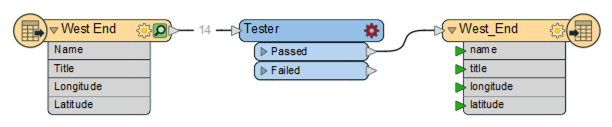

5. Map Attributes

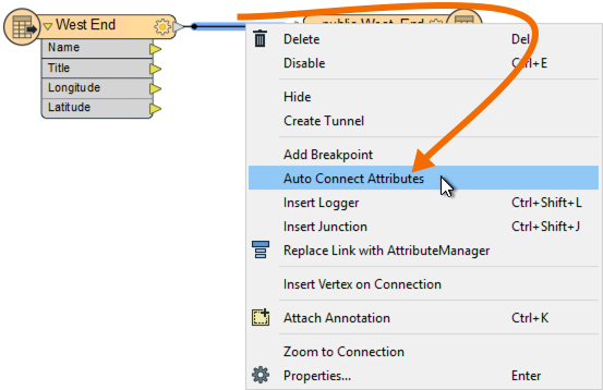

The reader and writer feature types must now be connected. Connect the West End reader feature type to the public.West_End writer feature type. If you click the drop-down arrow next to each, you will notice that the arrows are yellow and red, which means that the attributes are not correctly mapped. This is due to how PostGIS/PostgreSQL handles attributes: everything is lowercase, whereas the attributes from the Excel file are in Title Case.
To quickly correct this, right-click on the connection line and select Auto Connect Attributes. If you were planning to modify the attributes or further transform your data before writing it out, it is recommended that you use the Replace Link with AttributeManager option instead.

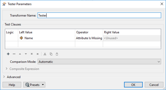

Continuing in the workspace from Part 1, add a Tester transformer between the reader and writer feature types.
In the Tester parameters, set the test to Name Attribute is Missing. We want to replace the entire table in the database with only the art pieces that don’t have a name.
2. Update PostGIS Writer Parameters
This database table will be used for a project to identify names for various art pieces across the City of Vancouver. Since we know this table already exists, and we only want to change the data, we will use Truncate Existing.
Double-click on the public.West_End writer feature type to open the parameters. Then change the Table Handling to Truncate Existing.

Run the workspace, then inspect the output in Data Preview. The attribute names should still be the same, but there is only one record.
