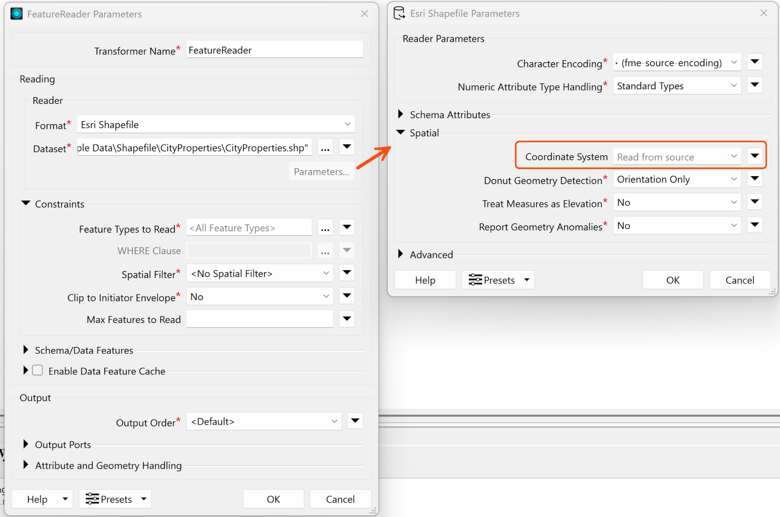

As of FME 2025.2, the Coordinate System parameter is now configured within the Parameters dialog of each format.
Where You’ll See the Change

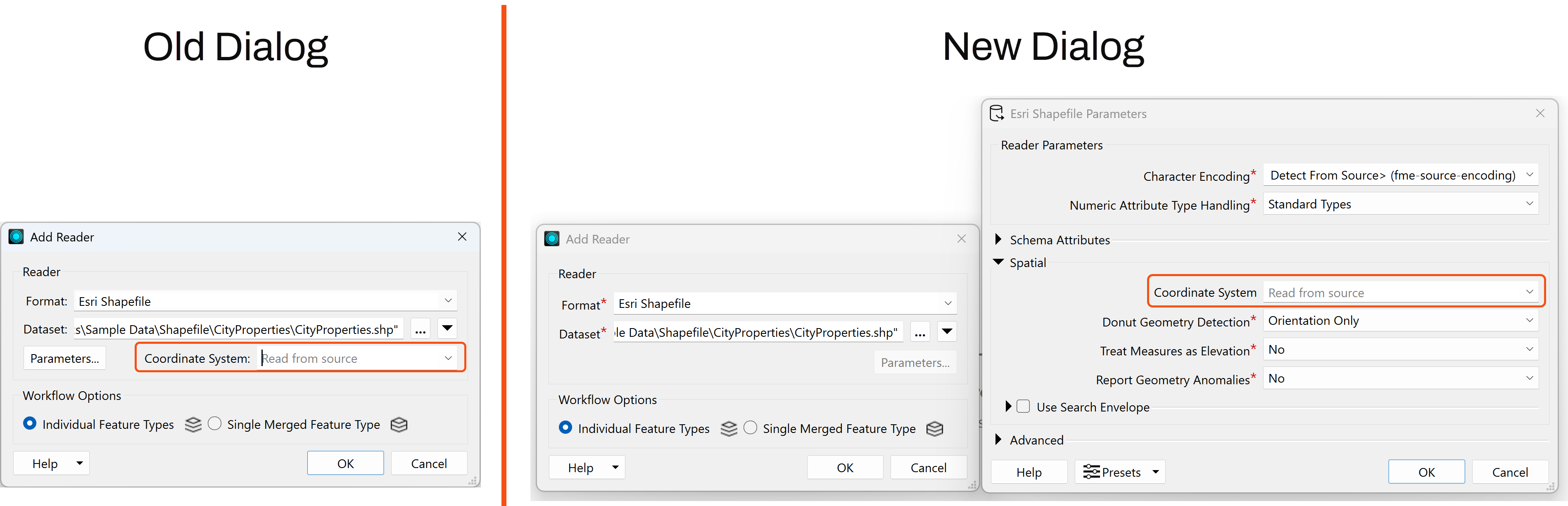

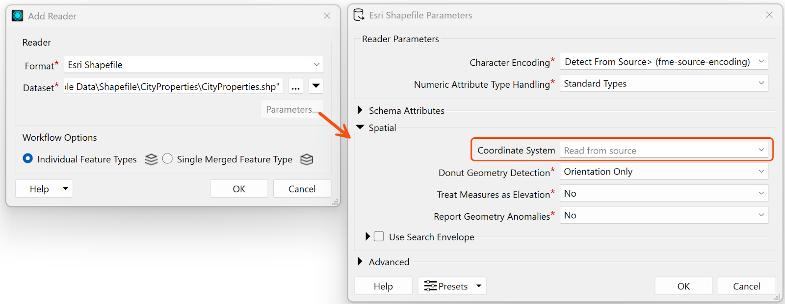

Add Reader / Add Writer dialogs:
  • The top-level Coordinate System field is no longer displayed.
  • To configure it in 2025.2+: Click Parameters > Navigate to the Spatial Group > Coordinate System
Old Dialog vs New Dialog
Transformers with format selection:

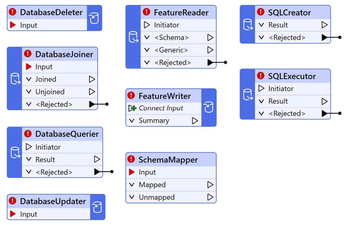

  • FeatureReader, FeatureWriter, SchemaMapper:
    • The Coordinate System is now available inside the Parameters dialog.
  • DatabaseDeleter, DatabaseJoiner, DatabaseQuerier, DatabaseUpdater, SQLCreator, SQLExecutor:
    • These transformers no longer include a Coordinate System setting. If you need to apply one, please use a CoordinateSystemSetter transformer after reading the data.
